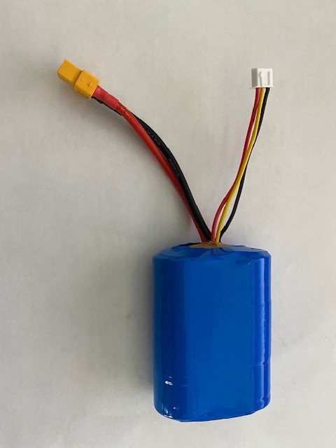

          For the HL 1:16 scale RC tanks, I use home made Lithium Ion packs because they have the best power density and is less likely to catch fire than the Li-Po pack. A 2 cells 26650 pack gives me 5000 mAh and a 4 cells 18650 6000 mAh power. Both pack fit the Heng Long battery compartment easily. In the picture below, you may also notice that I changed the battery plug from Tamiya plug to a more standard XT60 plug which is more secure. I do not like the Dean's plug which is hard to solder and disconnect.
          Click image for larger version  Name:	IMG_1511.jpg Views:	0 Size:	39.7 KB ID:	346208
          When you buy Lithium-Ion battery, avoid cheap low quality brands from China. Any seller advertising 18650 cell to be much higher than 3000 mAh or 26650 higher than 5000 mAh are for sure low quality imitation battery that will not hold much charge.
