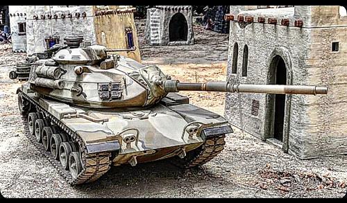

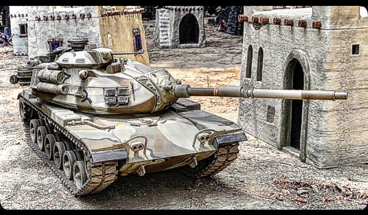

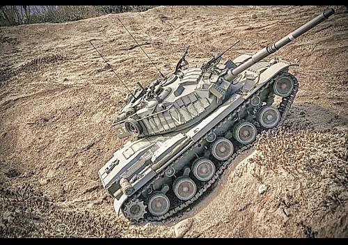

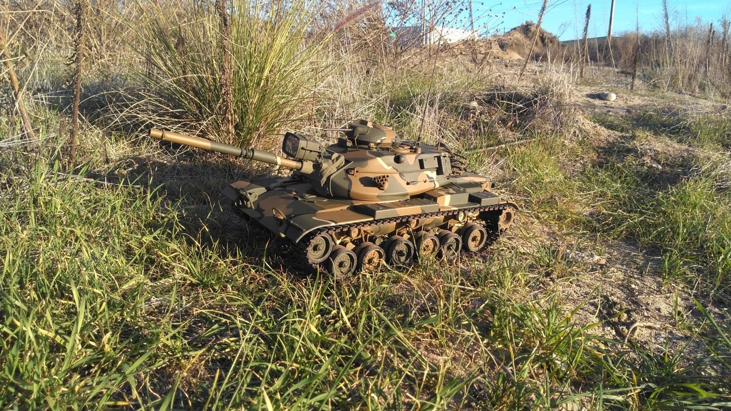

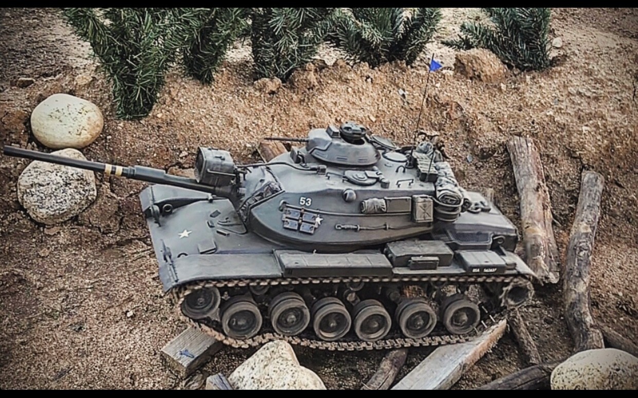

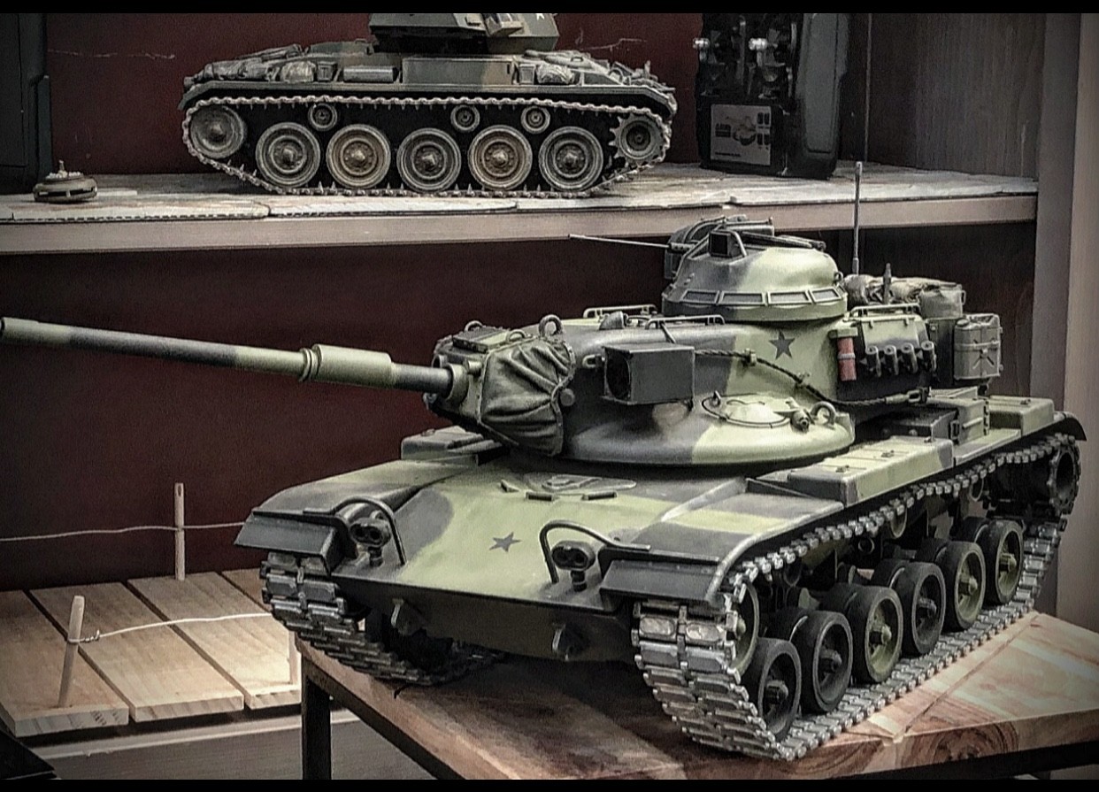

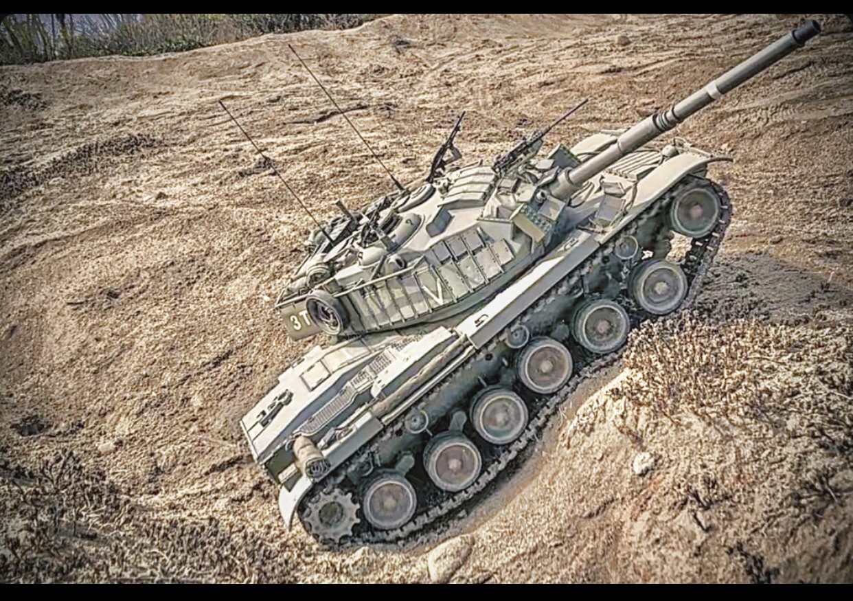

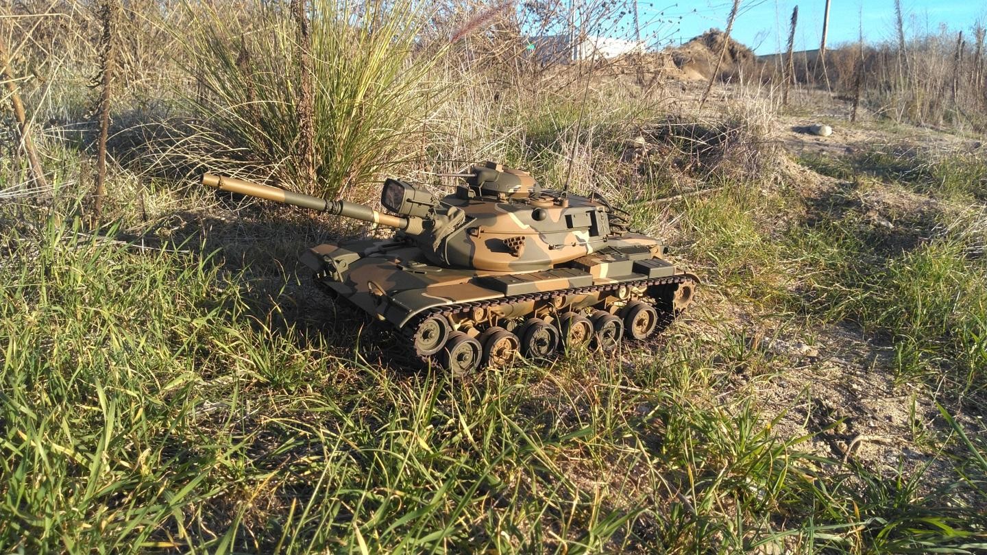

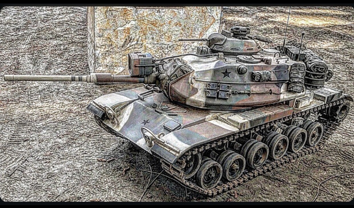

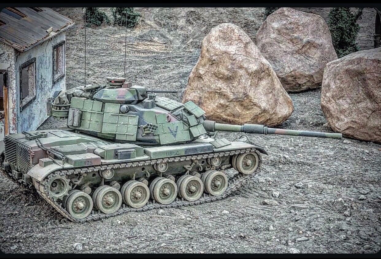

                    Yes the M60 with metal gearboxes is a good running tank with nearly endless options for paint themes and kitting out with crew accessories.
                    Personally I own several of them now. All very different from each other. The only common upgrade between them are new control systems, servo recoils, improved "faster" turret rotation units and upgraded more correct 105mm cannons.
                    To date myself and a few others have run our M60 over and trough many different types of terrain and the only terrain it has issues with is mud. But then no 1/16 RC tank does well in mud.

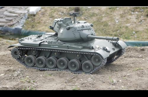

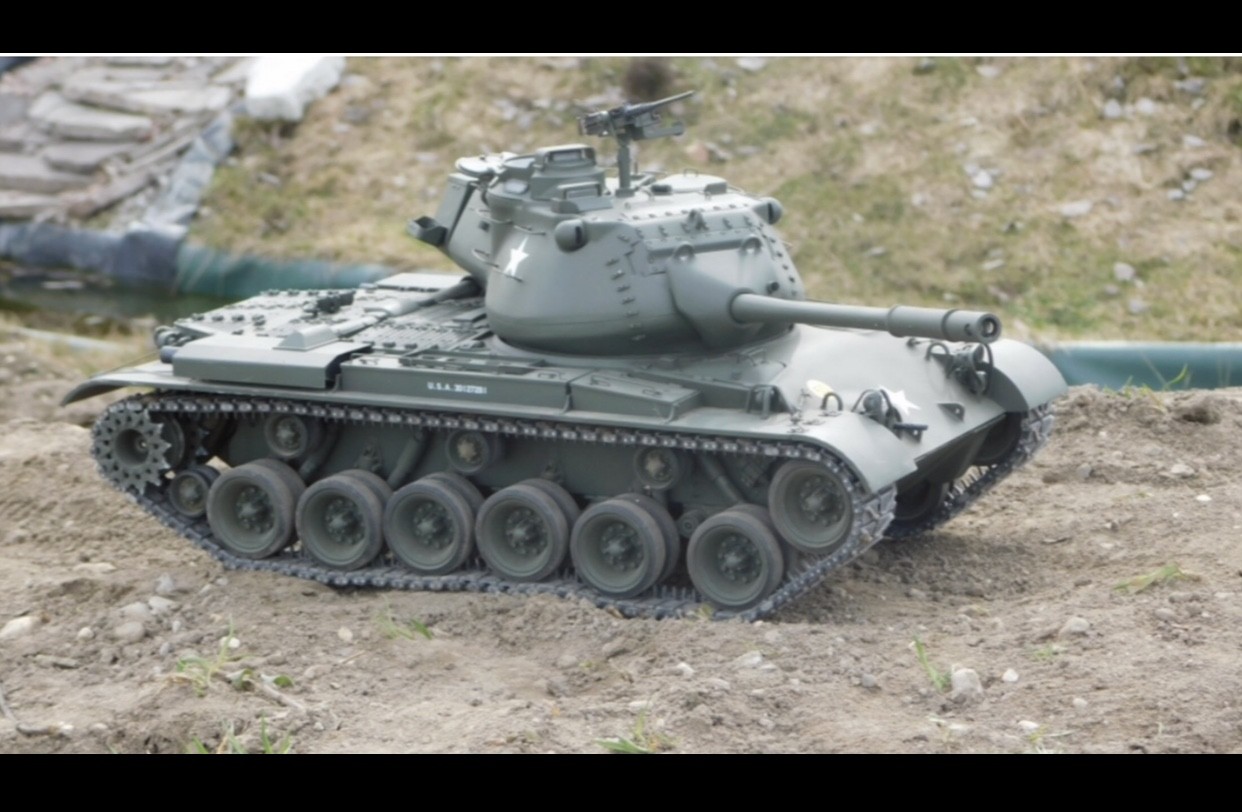

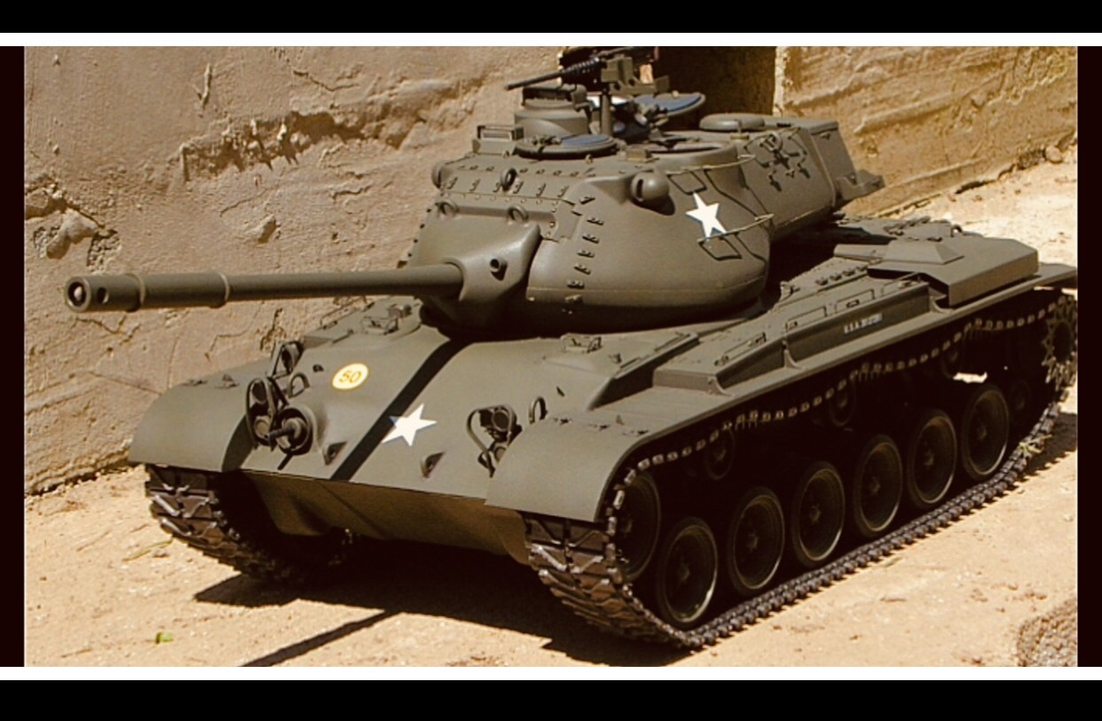

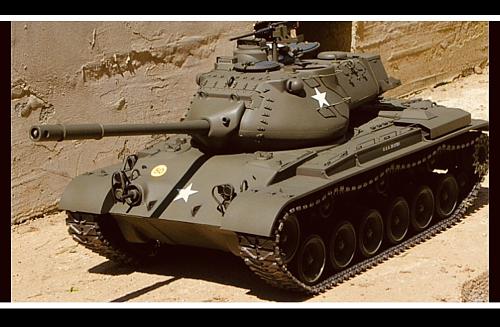

                                    Short answer is no. There have been folks that have built one offs but nothing really beyond that.
                                    I know with speaking to both HL and TD we have presented the the idea several times. HL was a definitive no, but TD said they might consider it in the future.
                                    Many of us believe the M47 would be a good selling tank given its rather wide use in Europe, Middle East and Asia.
                                    This one is one of those "one off" custom builds.
