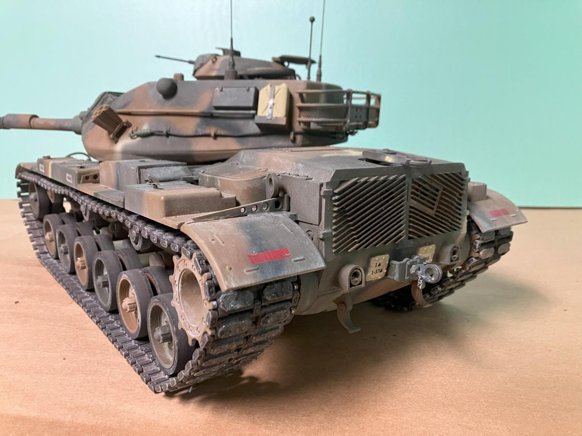

              Has anybody Click image for larger version
Name:	M60A3 Left Rear Quarter.jpg
ID:	404462 else out there tried to do anything about those awful grille-doors that come on the TD M60s out of the box? I made some new ones on Tinkercad and 3D Printed them, but they're not quite a perfect fit. Was wondering if there's something better to be had out there?

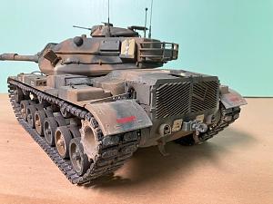

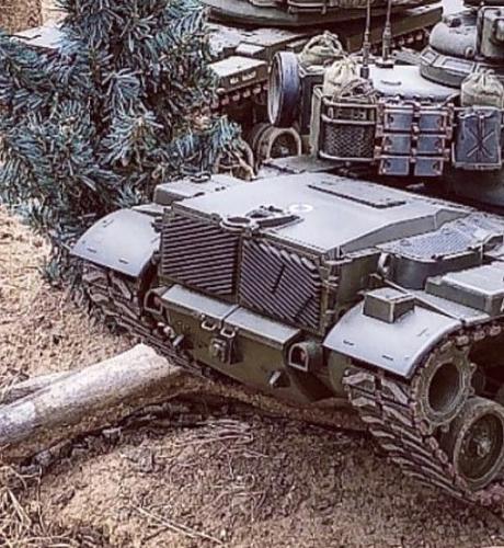

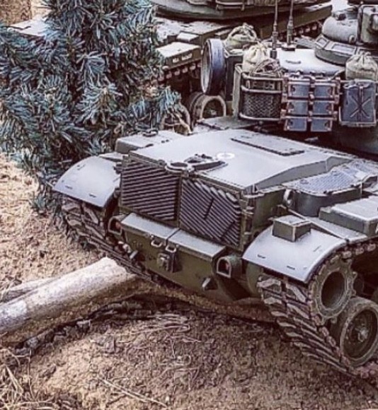

                Originally posted by AFT-CAP21
                Has anybody Click image for larger version  Name:	M60A3 Left Rear Quarter.jpg Views:	0 Size:	120.8 KB ID:	404462 else out there tried to do anything about those awful grille-doors that come on the TD M60s out of the box? I made some new ones on Tinkercad and 3D Printed them, but they're not quite a perfect fit. Was wondering if there's something better to be had out there?
                Yes DKLM RC has a detailing kit for the TD M60 which includes a completely new rear exhaust grill/panel. It's not listed on their web site as a stand alone detailing kit, you have to email them and ask for the kit separately.
                Shown below on my M60A2. The lower "box" on the grill panel is specifically an A2 part attached to the grill. The grill does not come with the A2 part attached.

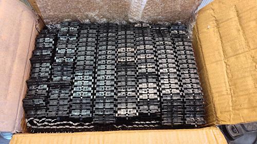

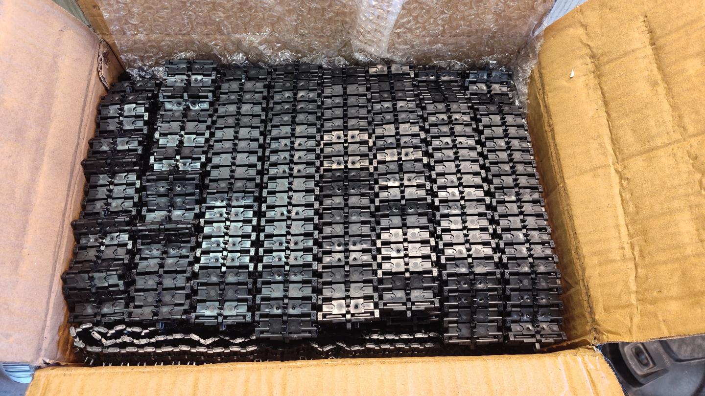

                                          I just received my restock shipment of plastic tracks for the Tongde M60 series. Both types hexagon and Chevron pads. $45 a set.
