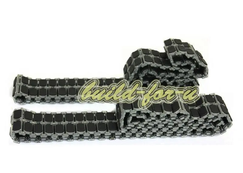

    Hello,
    Sorry for the late reply, we are on vacation now.
    This is a double pins track, and the pins are completely closed, the material is (aluminum) alloy.

    It's is sold under a few other names. DKLM and Toucan sell this track under their names. I have several sets of it and have run it very very hard. It is good tough track overall. It has a few issues that may or may not be a problem for some people.
    This first issue is the track guide teeth are a little short in height and as such do not hold as well against the sprocket track retaining rings as they could like taller like the Tamiya guides. So detracting at the sprockets can be more common then with Tamiya tracks.
    The second issue is the rubber used on the pads. It is soft and has a high coefficient of friction when used on hard packed surfaces or concrete/asphalt. It grips so well it actually can cause the tracks to pull off the idler and road wheels in a turn on the above surfaces. Tamiya uses a harder rubber compound and this greatly reduces the coefficient of friction so the "pulling off" issue is not a big of problem.
    Lastly the track is heavy and needs to be used with at least 390 motor upgrades if you want to turn with any authority.
    I have largely pulled this type of tracks "out of service" as the Tamiya tracks are functionally superior in every aspect.

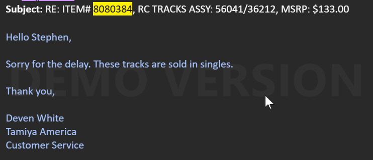

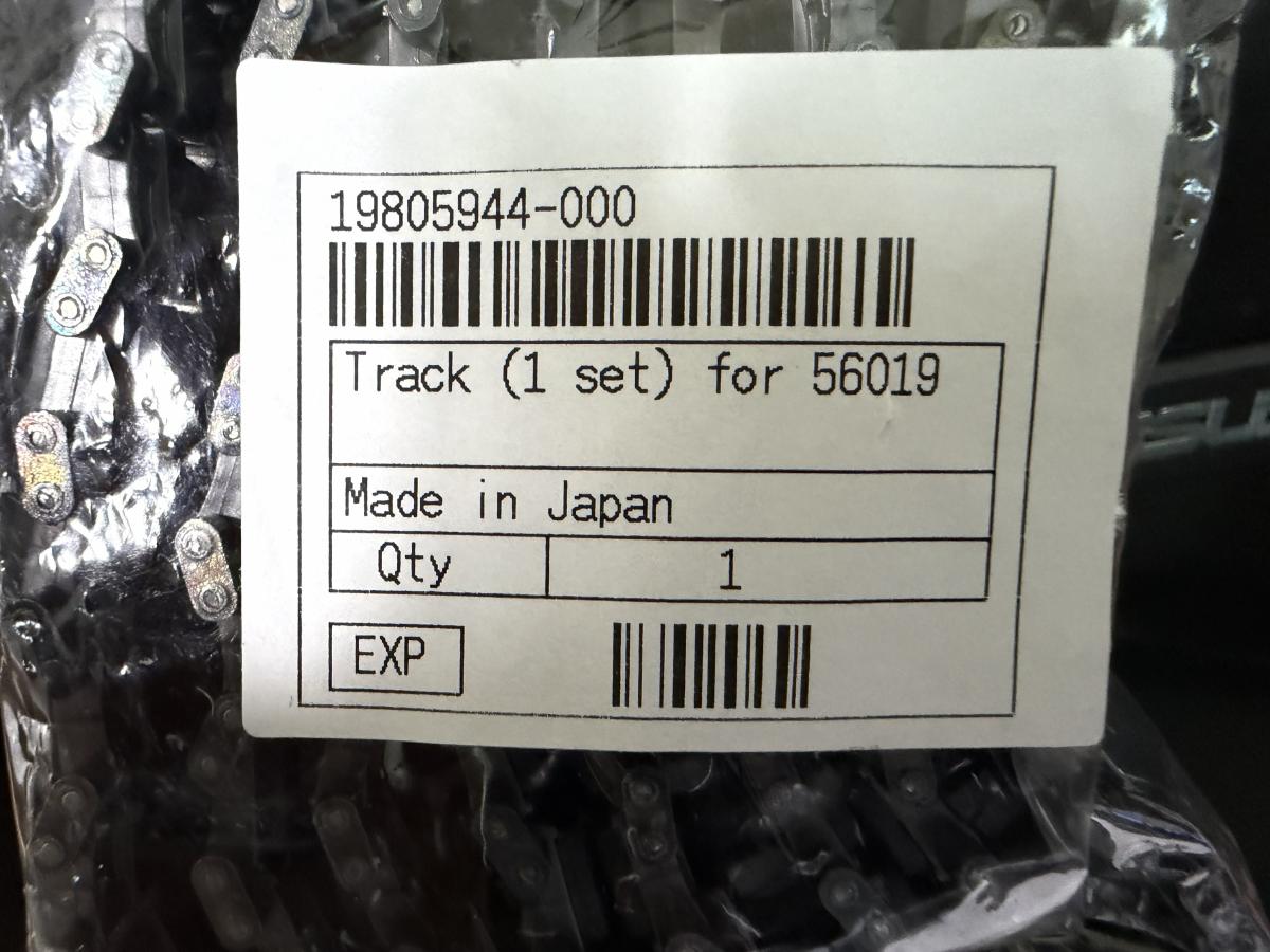

                        I inquired about these at Tamiya back in 2021 and this is what I was told, hence I went ahead and bought the Leo ones from AAF per Rubicon's suggestion:

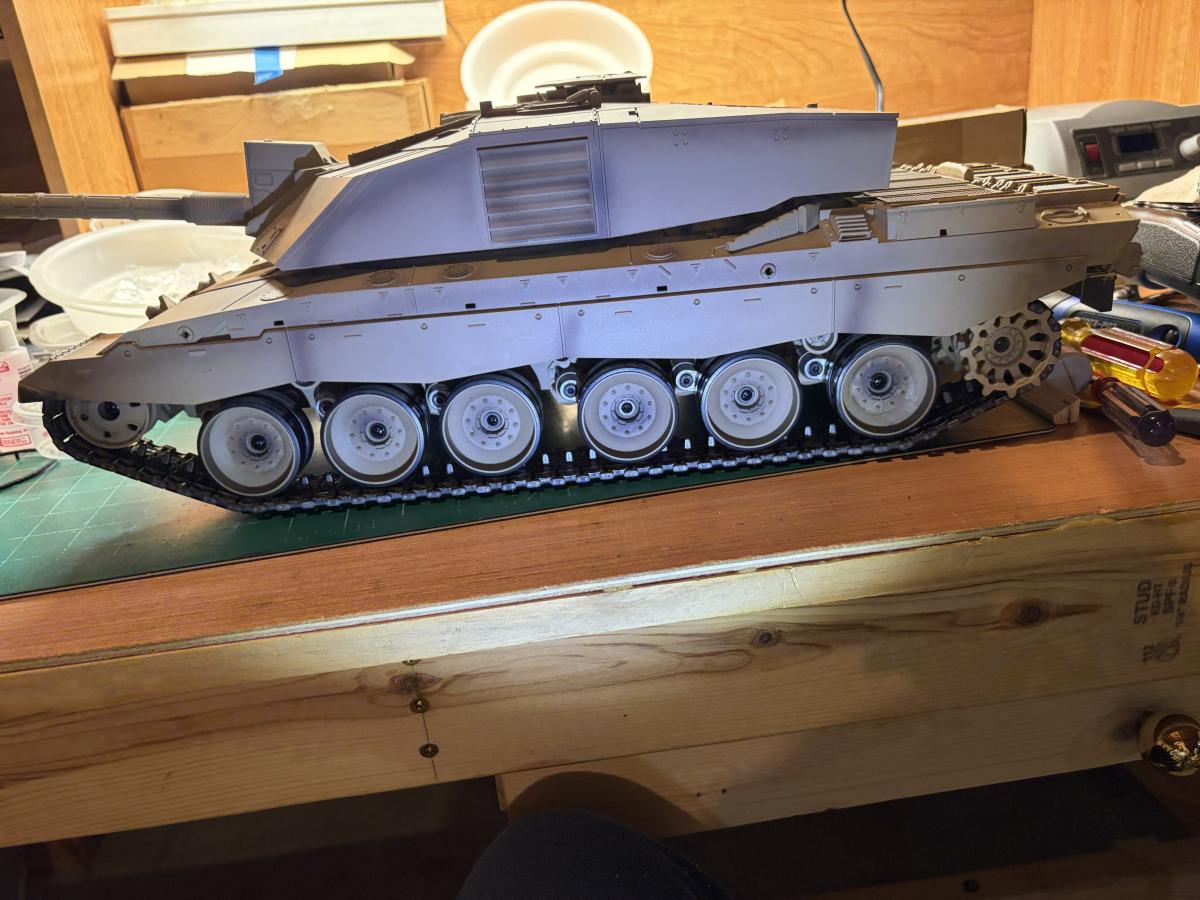

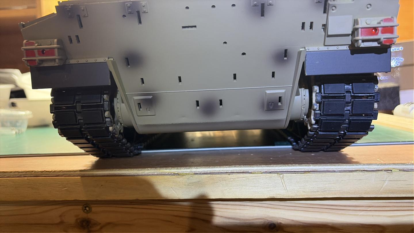

                            After a 2 years debate, I finally decided on the Heng Long Challenger 2 for my first UK RC tank model. It is a post cold war era MBT so I expected the metal upgrades to be similar to the Leopard and Abrams. The upgrades include ball bearing steel gearbox, sprocket and idealer wheel, metal tracks, drive motor shaft bearing, stronger suspension coil spring plus a high capacity lithium ion battery and 2.5" speaker. All pretty routine items.
                            Click image for larger version  Name:	IMG_0071.jpg Views:	0 Size:	90.8 KB ID:	452729 Click image for larger version  Name:	IMG_0072.jpg Views:	0 Size:	132.2 KB ID:	452728 Click image for larger version  Name:	IMG_0073.jpg Views:	0 Size:	111.1 KB ID:	452726 Click image for larger version  Name:	metalsprocket.jpg Views:	0 Size:	73.6 KB ID:	452723
                            My favorite gearbox is the Heng Xin with 390 motor. To my disappointment, The Heng Xin gearbox cannot be mounted with 390 motors because the Challenger2 chassis is 0.5 inch narrower than the Leo and Abrams. I use the Taigen/Torro black 380 for now.

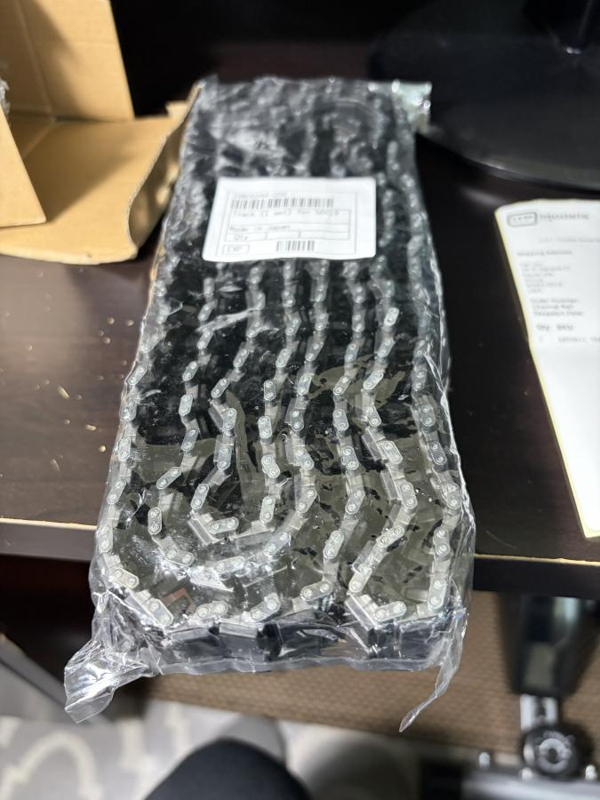

                            I found a paired Tamiya track set package at ttpmodels.com in England. The shipping is cheap and quite fast.
                            Click image for larger version  Name:	IMG_0065.jpg Views:	0 Size:	79.5 KB ID:	452727 Click image for larger version  Name:	IMG_0066.jpg Views:	0 Size:	125.7 KB ID:	452725 Click image for larger version  Name:	IMG_0074.jpg Views:	0 Size:	116.3 KB ID:	452724 Click image for larger version  Name:	IMG_0077.jpg Views:	0 Size:	137.4 KB ID:	452730

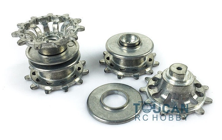

                              I run Tamiya Leopard 2 tracks on my Heng Long Challenger 2 but I was advised to get sprockets that were designed to be compatible with Tamiya tracks, which was what I did.

                                Tamiya is the grand daddy of 1/16 scale RC tank. Heng Long, Mato, Taigen/Torro are all careful in following the Tamiya scale. I have 3 sets of Tamiya tracks and they all fit perfectly on Heng Long tanks. Some with Mato sprocket.
                                The only exception is the Tongde brand. Their track width and pitch are both off. To use the Tamiya tracks on my TD M60A1, I have to change to the HL dual current drive system and use the HL Abrams sprocket. I learnt this from Rubicon99 . It works, but it is the main reason I stopped buying Tongde. Tongde use very soft metal on their case of the TD steel gearbox resulted in unsecured mounting and added to the switching to HL dual current drive system decision.

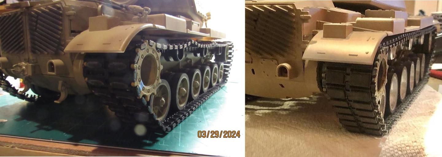

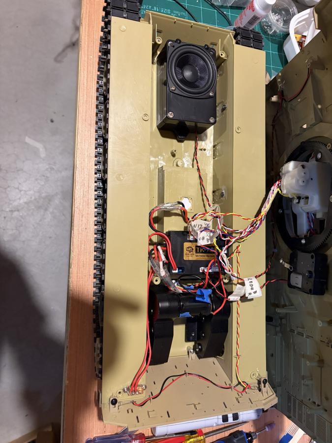

                                  While I do like the dual diff gearboxes and use them in like 6 of my tanks, the M60A2 I finally have battling has battled on the regular metal Tongde gearboxes just fine. I did create some braces that wedge between the gearboxes enclosures that doesn't allow them to move in toward the centerline of the tank. They are just sheet plastic "mistakes" from my 3D printer made out of ASA and glued together. Each one is just friction fit and easily removed for maintenance. It takes all the stress off of those side mounting screws.

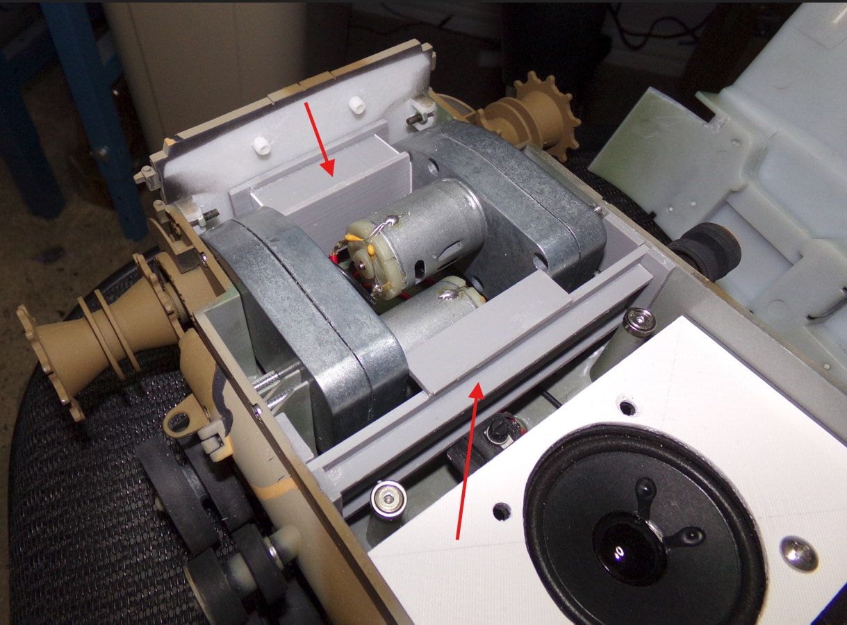

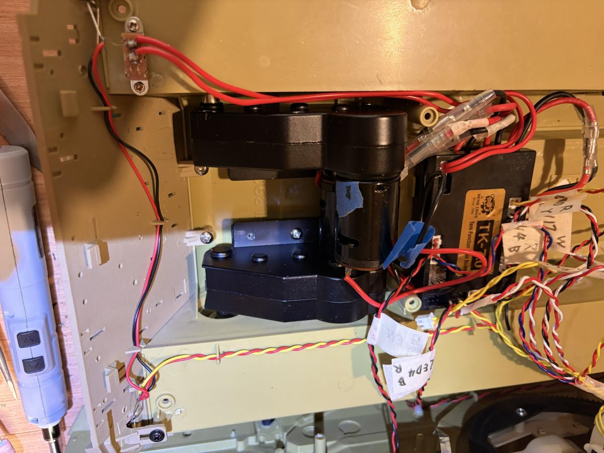

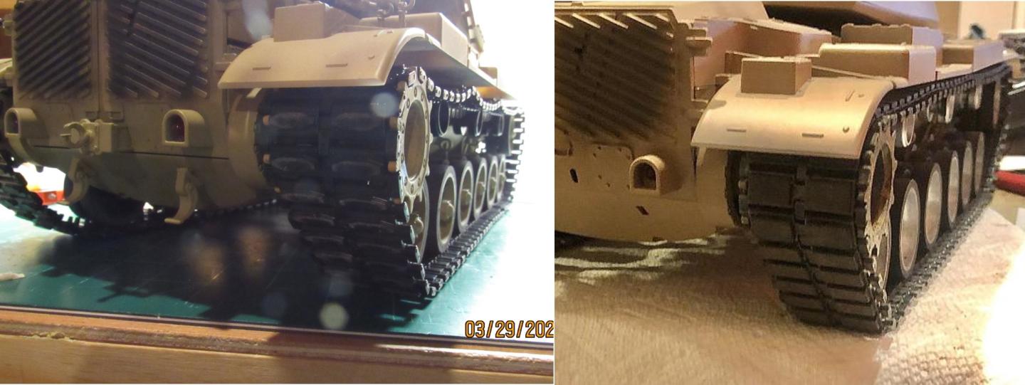

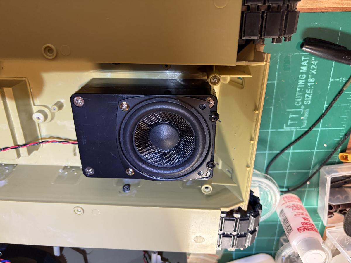

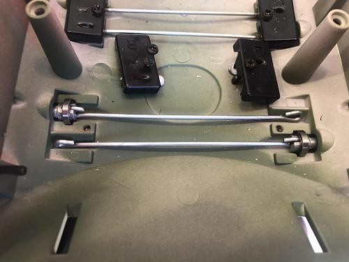

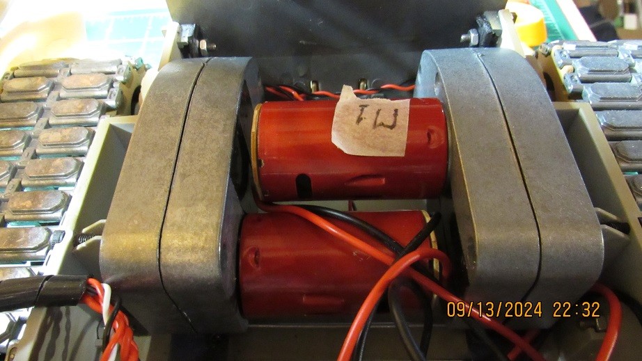

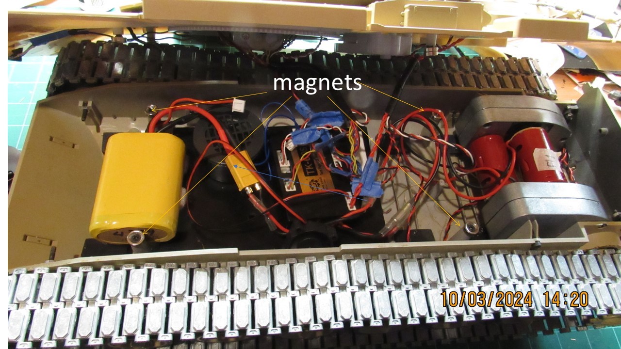

                                    Other things I don't like about the TD M60 are the thin walled chassis and fine gauge wiring. However, there are many other features to like about the TD M60. The torsion bar suspension is far superior to the coil spring in many HL suspension. I was able to add ball bearings to the torsion bar and the road wheels without other modifications.
                                    Click image for larger version  Name:	IMG_5380a.jpg Views:	0 Size:	242.2 KB ID:	452797 Click image for larger version  Name:	IMG_5378.jpg Views:	0 Size:	136.3 KB ID:	452796 Click image for larger version  Name:	torsionbar_bearing.jpg Views:	0 Size:	36.9 KB ID:	452800

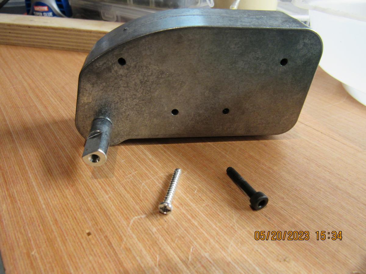

                                    I used a different approach to stabalize the gearbox. The TD use self tapping screw which is a poor approach to the soft metal gearbox case. I tapped the screw holes with fine thread for M3.5 machine screws. The job required fine workmanship with steady hand. I changed the motors to 390. The result is excellent. The TD M60 is the smoothest running tank compared to all my other HL. I tried but cannot modify the TD gearbox motor drive shaft to accept HL sprocket. Click image for larger version
