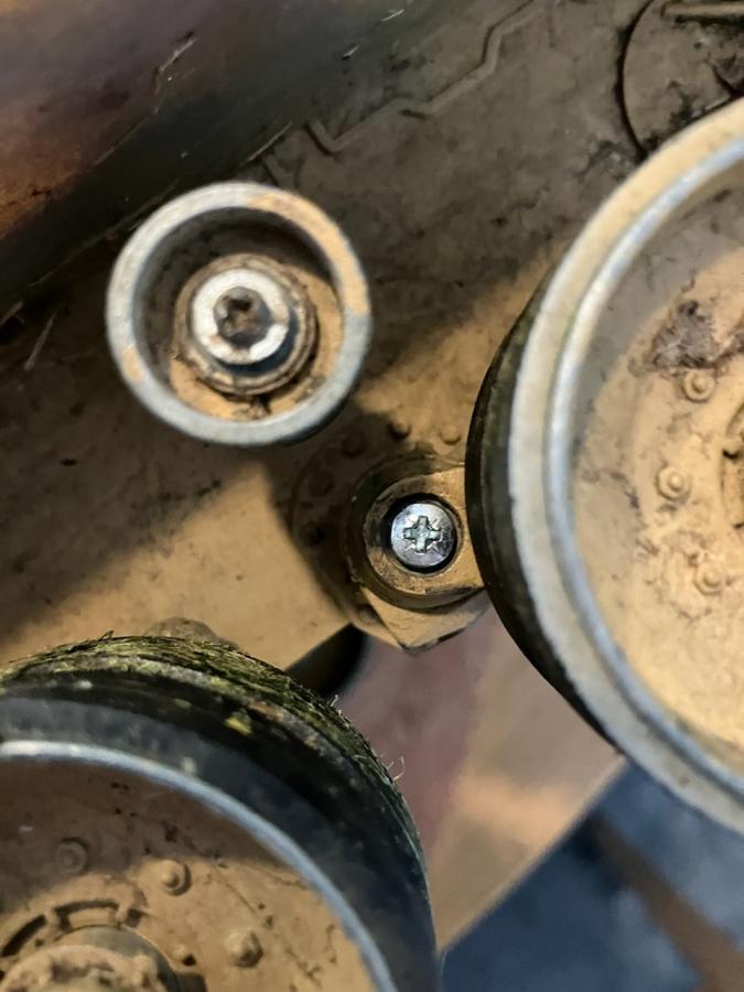

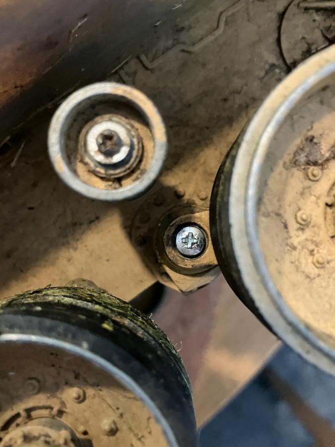

                Yesterday, my new 3S batteries arrived. This morning was a good day to give the Challenger a run. First run was with a 2S battery as a starting point. Then the battery was swopped out for the 3S. First run was with the speed set low. No appreciable speed difference was observed. Next was with the speed set high, a visual increase in speed was noticed. No speed or times were recorded on these runs. These runs were on the road and our drive. Grass was tried next, with tighter and tighter turns. A track was lost, and as usual on the problematic left side. This was due a loose road wheel, at the last station before the drive sprocket. This has been a problem for some time, but I haven’t really been bothered about dealing with it, as it means taking out the gear boxes. I will upgrade to 3mm stainless bolts which I will order on Monday.

                  Annnnd I broke it.

                      Annnnd I broke it.
                      Click image for larger version  Name:	FB4E5445-1AF4-4632-9975-1F56F996190E.jpg Views:	5 Size:	61.8 KB ID:	402187 Click image for larger version  Name:	B8C38957-1D67-4CF4-957D-2915DAF48178.jpg Views:	5 Size:	55.4 KB ID:	402188
                      Oh my. I was really worried about that on mine. The Abrams tensioner was only mounted by a tiny shoulder screw. Like 6mm of plastic holding the whole tank together. Did you impact something? Just raw power yank it off?

                        Well I was warned this would happen.
                        A new hull. Not likely. Tis but a flesh wound. All it requires is a sticky plaster.
                        All my own fault. I have a rear wheel suspension swing arm which keeps coming loose. I had forgotten about it, as it is something I had intended to investigate. My plan was to drill it out from 2mm to 3mm and fit stainless nuts and bolts. However this is next to the gearbox, so didn’t really fancy the prospect of dismantling the drive train to deal with it. These things need everything in alignment to help stop them de-tracking. The rear road wheel came out of alignment causing it to de-track, and break an already weakened part. This is all part of the evolution of this tank. It like anything. Upgrade one part, and the next weakest part will fail.
                        I did get 13kmh from it, before it let go.

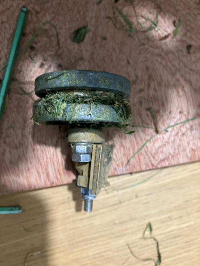

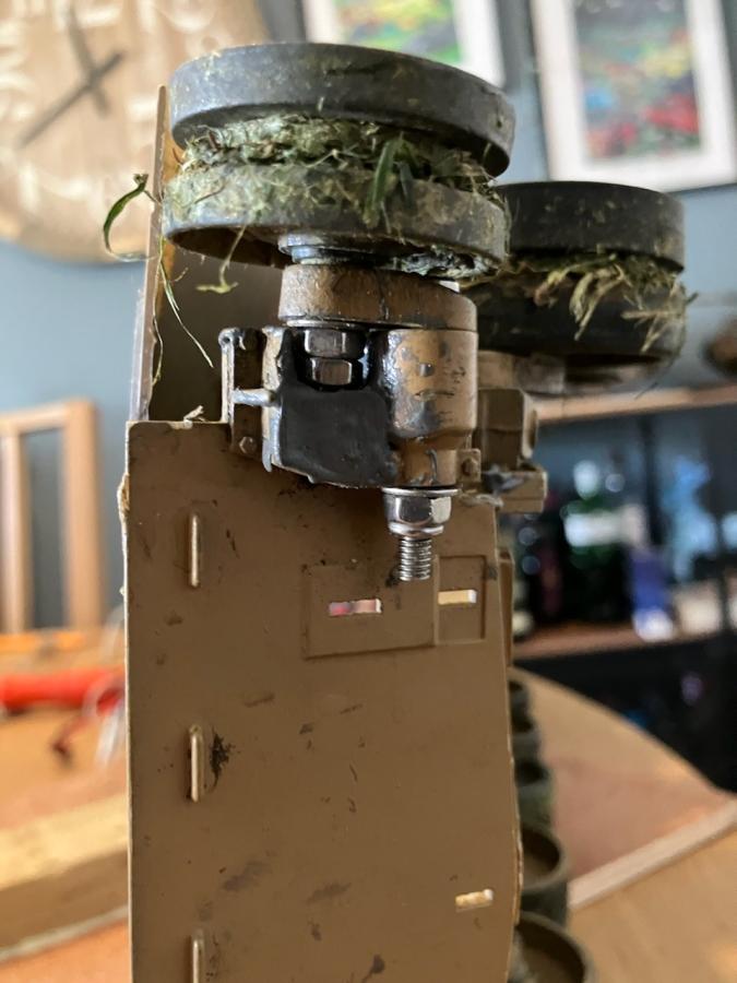

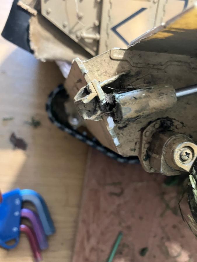

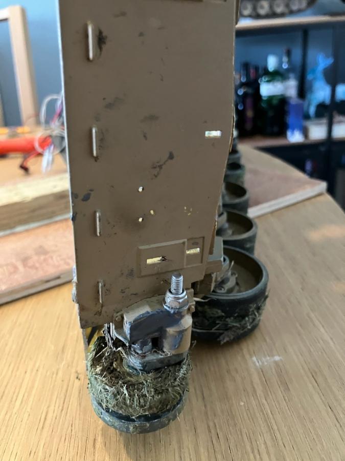

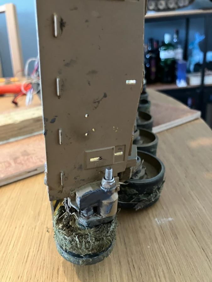

                            24h After it all went wrong. The beast is repaired. And the rear wheel station has been upgraded, with 3mm bolts, in place of the original 2mm bolts. The sussuspension has also been smoothed out with gentle filing. The front was repaired by glueing on the damaged part. This was then reinforced with my favourite glue, by filling all the voids with said glue. Over the next week small aluminium fillets will be made, and installed. These will virtually invisible when painted over as they are hidden underthe front armour.

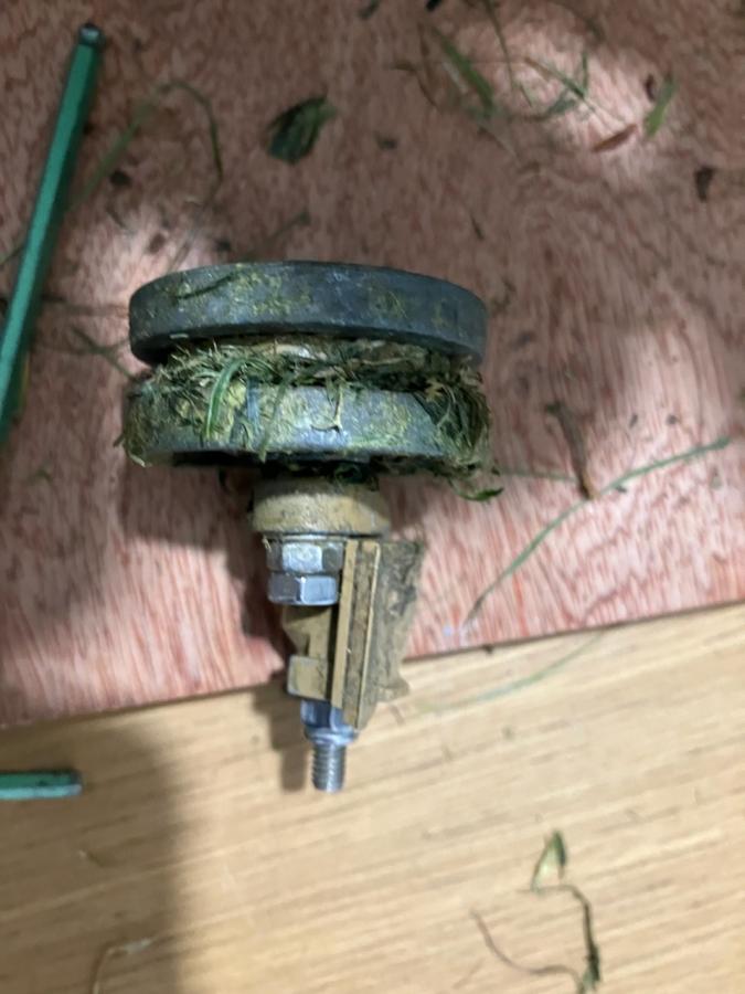

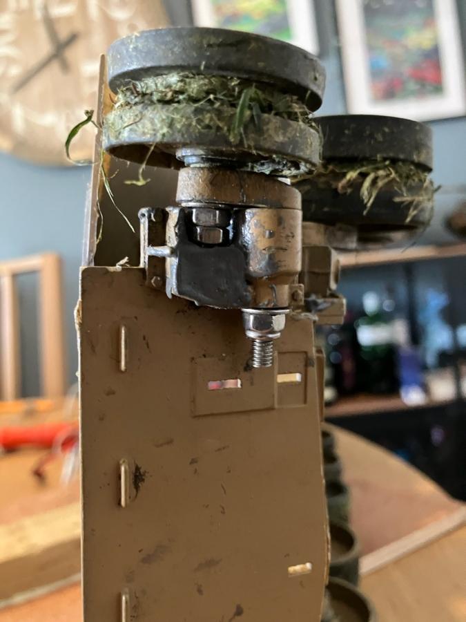

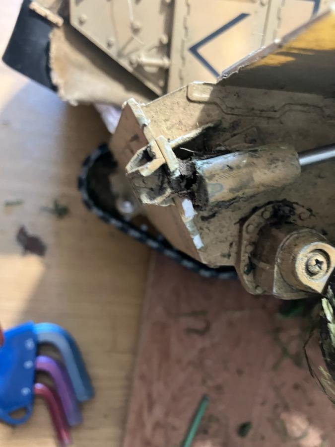

                              Cool! All fixed
