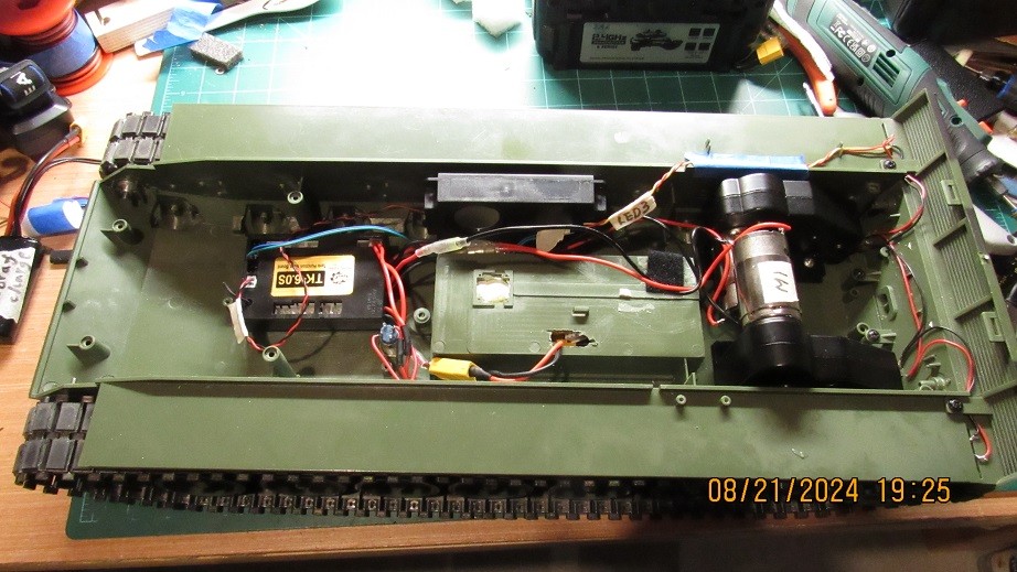

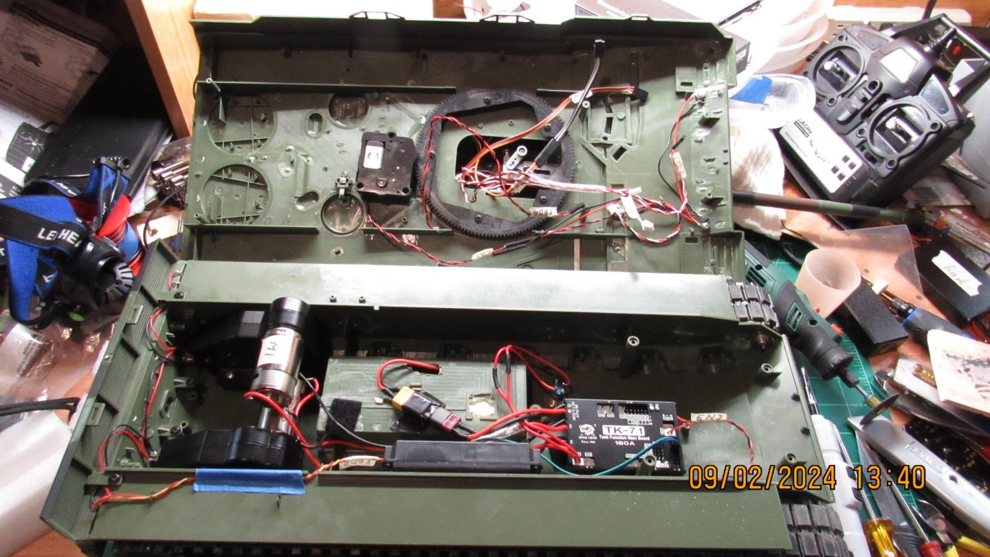

    The 2021 HL Metal Pro version Leopard 2A6 came with the TK6.0S radio. I took your advice to couple the Leo with the Tamiya track and replace the gearbox with a Heng Xin gearbox. It was a good running tank for 3 years until my upgrade bug hit me.

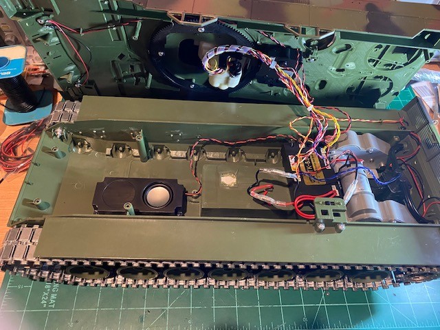

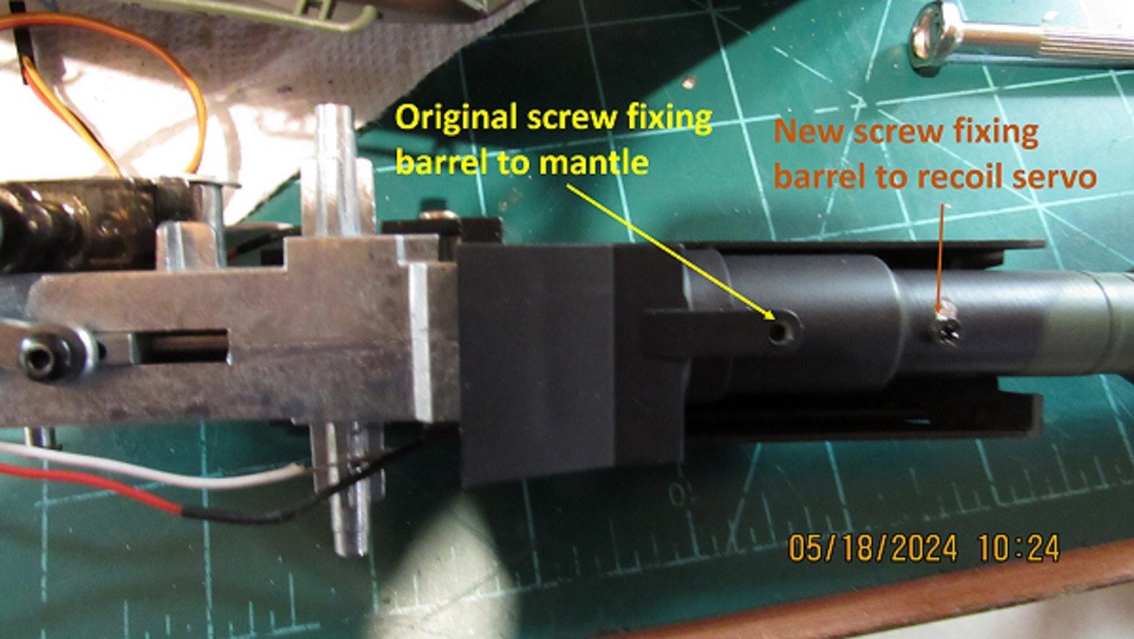

    1. The upgrade to TK7.1 is straight forward and simple.

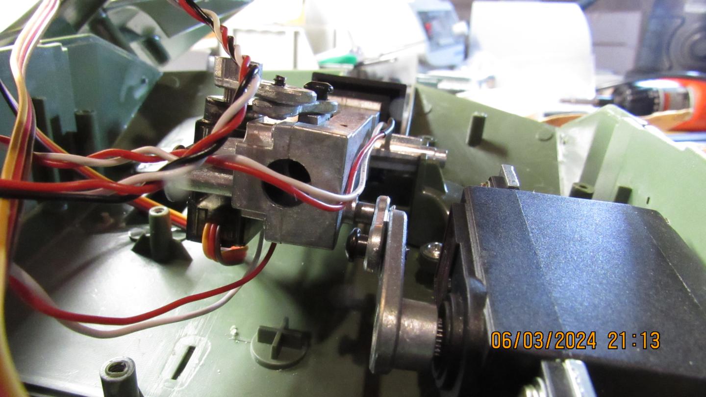

    2. The Can Shou servo recoil system is more a challenge. The elevation servo is moved to the opposite side of HL's. There is no picture or instruction on how to locate the elevation servo. It took me a few tries before I found the right position.
    Click image for larger version  Name:	IMG_5334-captioned.jpg Views:	0 Size:	175.5 KB ID:	412508 Click image for larger version  Name:	IMG_5344.jpg Views:	0 Size:	131.2 KB ID:	412509

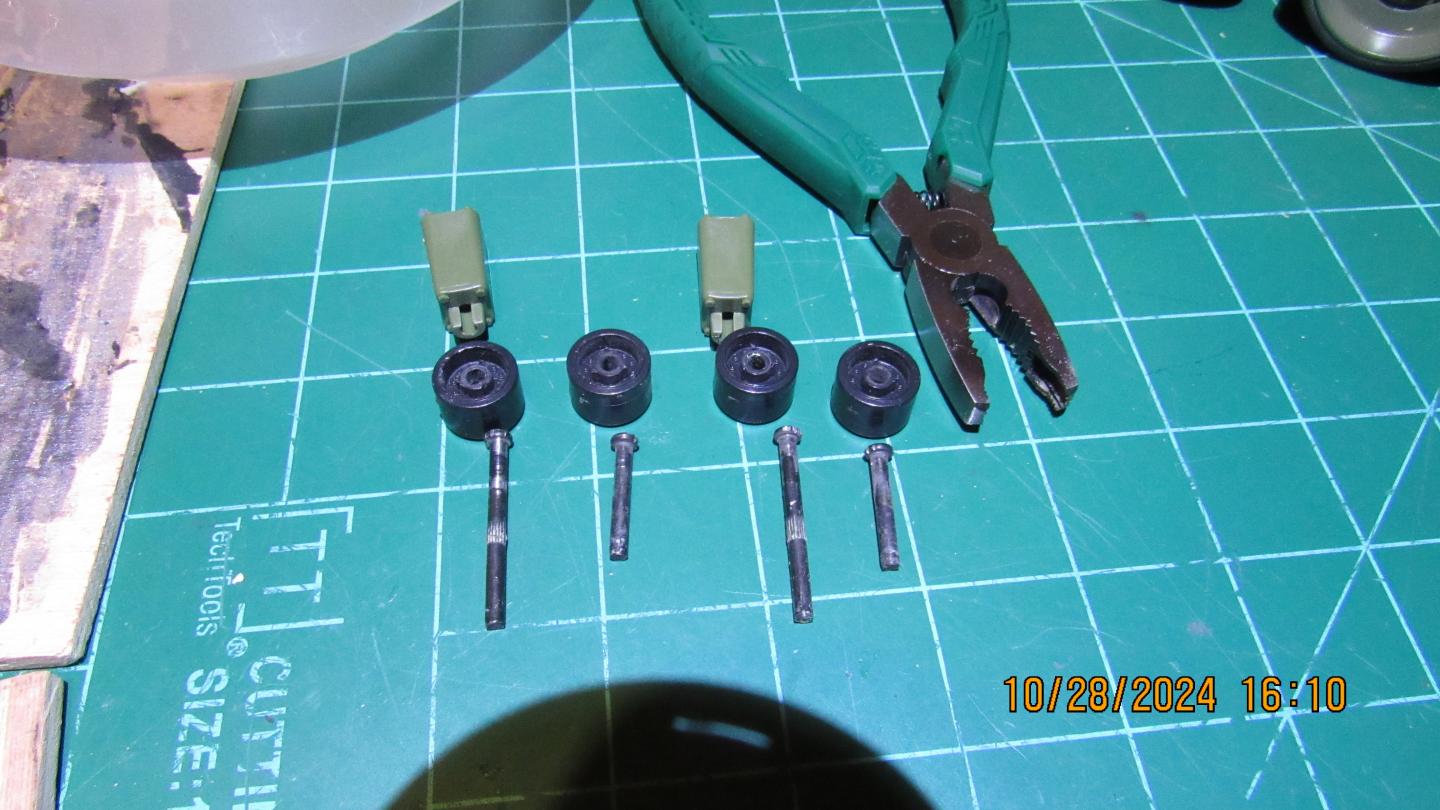

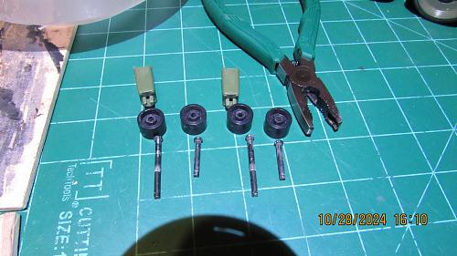

      I ended up buying a new tool with a unique jaw to grip on the pin head for the removal of the press fit pins. It is not too bad at ~$20.
      The pins are 20mm and 32mm long, the OD is just a hair bigger than the major diameter of a M3 screw. I decided to reuse the pins for the metal return rollers now that I have the removal tool. Do not expect to make roller return upgrade in the near future.
