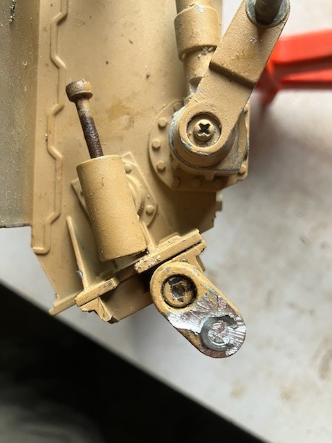

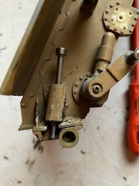

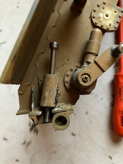

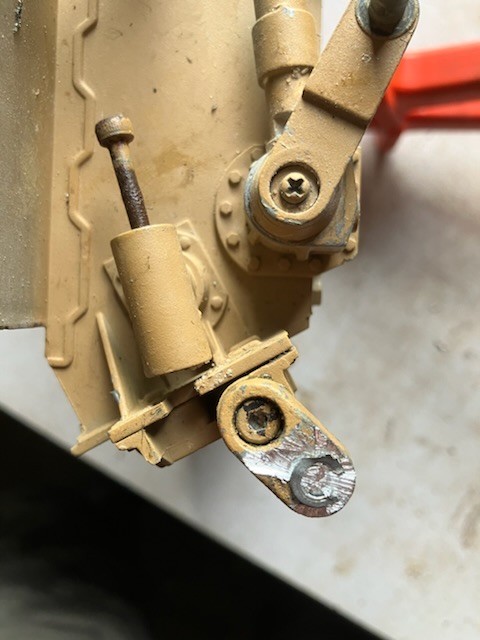

    You will have to remove the upper hull. At the front of the tank, you should see the track adjuster.
    This need adjusting in or out as required. Excuse the rust. This was during heavy maintenance, and repair. Click image for larger version
    You may also need to remove a track link as well.
