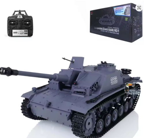

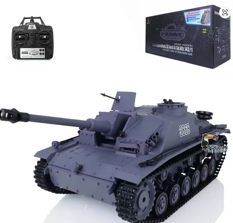

I’m disappointed in this Sturm III 7 promotion version not being able to fire BB’s - which is why it was brought. The box states it can but a sticker states not available on this model😔. Can I get a replacement BB enabled barrel? Any other options available?
Barrel on promotion version not firing BBs
There's more than the barrel needed. There would be a chute that feeds the pellets from a hatch on top. If your tank doesn't have that, a new barrel won't be enough. My guess is your best recourse is to return it, a real pain I know. Who was the seller?The more screws it takes to reassemble a tank, the more likely it is you left something out!Comment
If it doesn't shoot BBs and do IR, it's a really old version. The newer HL tanks do both. The old electronics are also not great as the driving characteristics aren't very smooth. Converting it to shoot BBs wouldn't be and easy thing for someone not familiar with RC tanks. It would be cheaper and much easier to return/sell it and get one that has that function.Comment
It is either an IR battle only version or not an Heng Long RTR tank. Heng Long have not made IR only tank for many years. As @Evan D pointed out, HL did not make a "Sturm(geschütz?) III 7" RC tank. It may be a different non-BB brand. Show some pictures if you are serious about getting help.
Please, also read @SoCalBobS reply on the recommended course of action to take.
This is an IR only version HL assault gun. Is it what you got?? It is not a tank. It is a tracked assault gun without the turret. Heng Long probably eliminate the gun elevation BB unit to save cost. They cut cost to make the very low promotional price. It makes sense. Get a HL RC tank if you want BB shooting.

A generic trigger motor barrel recoil is cheap and readily available. You will have to adapt your existing barrel from the StuG III.

I have the trigger motor recoil on most of my HL tanks. Good enough for me. The adaptation includes cutting the existing barrel and tap a screw hole. It is easy if you are mechanically handy.
Please separate top shell from bottom and post photos of underside of the top/turret assembly so we can see exactly what you have got. Posted photos will clear up all speculation of what you have exactly and what we can tell you what can or can't be done for your tank to shoot BBs.
