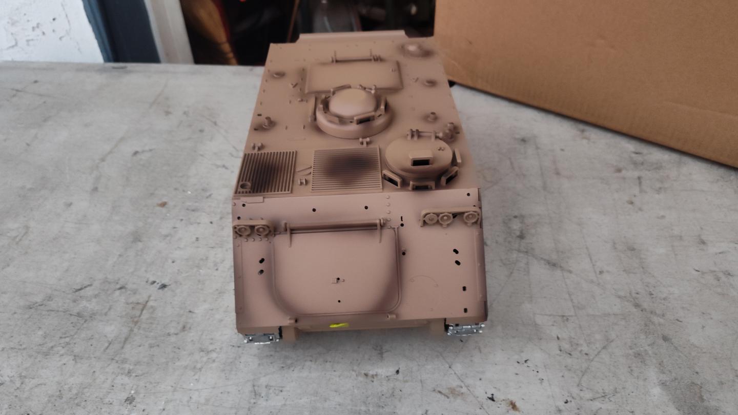

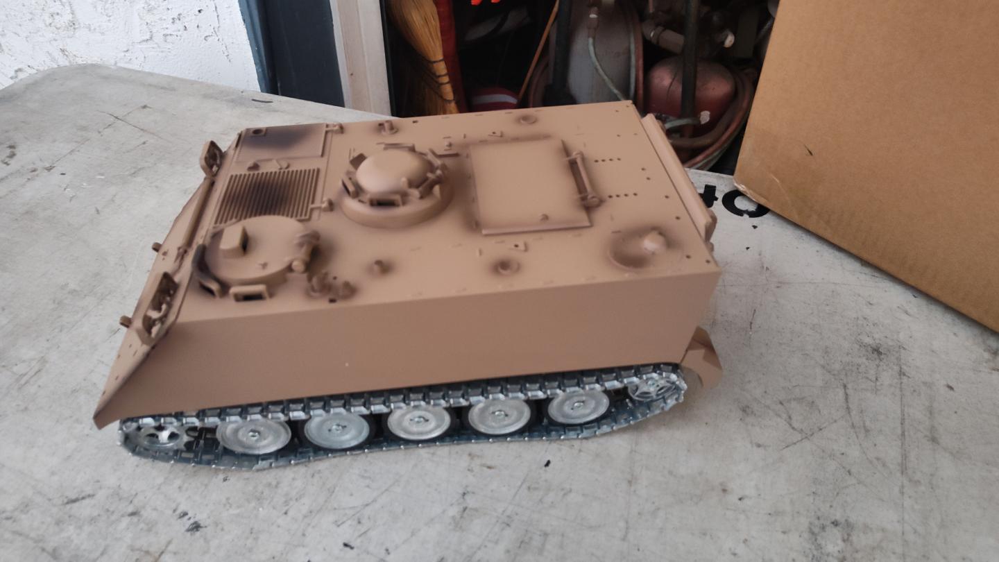

    I received my dealer sample of the new Tongde M113 today from DKLM. What a great RC model.
    Details to note, metal edition has bearings in the arms and wheels, rubber tires, metal tranys.
    Smoker for exhaust.
    IR projector in the blackout light, inner light driver side.
    I am currently working out the logistical options to import a case of each version of the M113 to market in the US like I did for the 1/16 WWII RC MB Willys Jeep
    See the rest in the video.

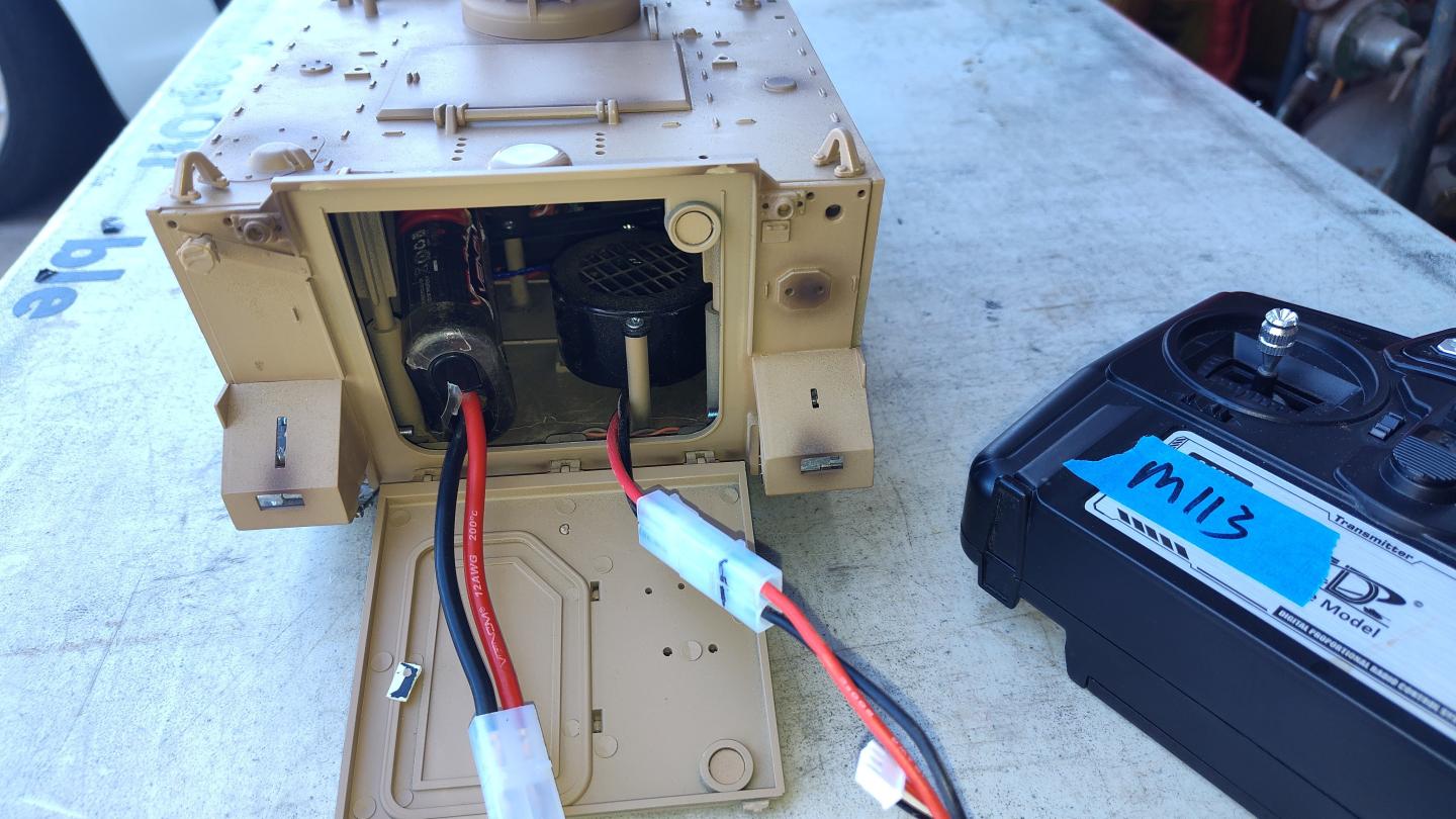

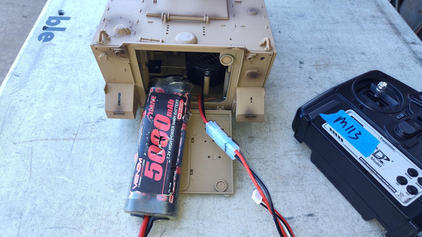

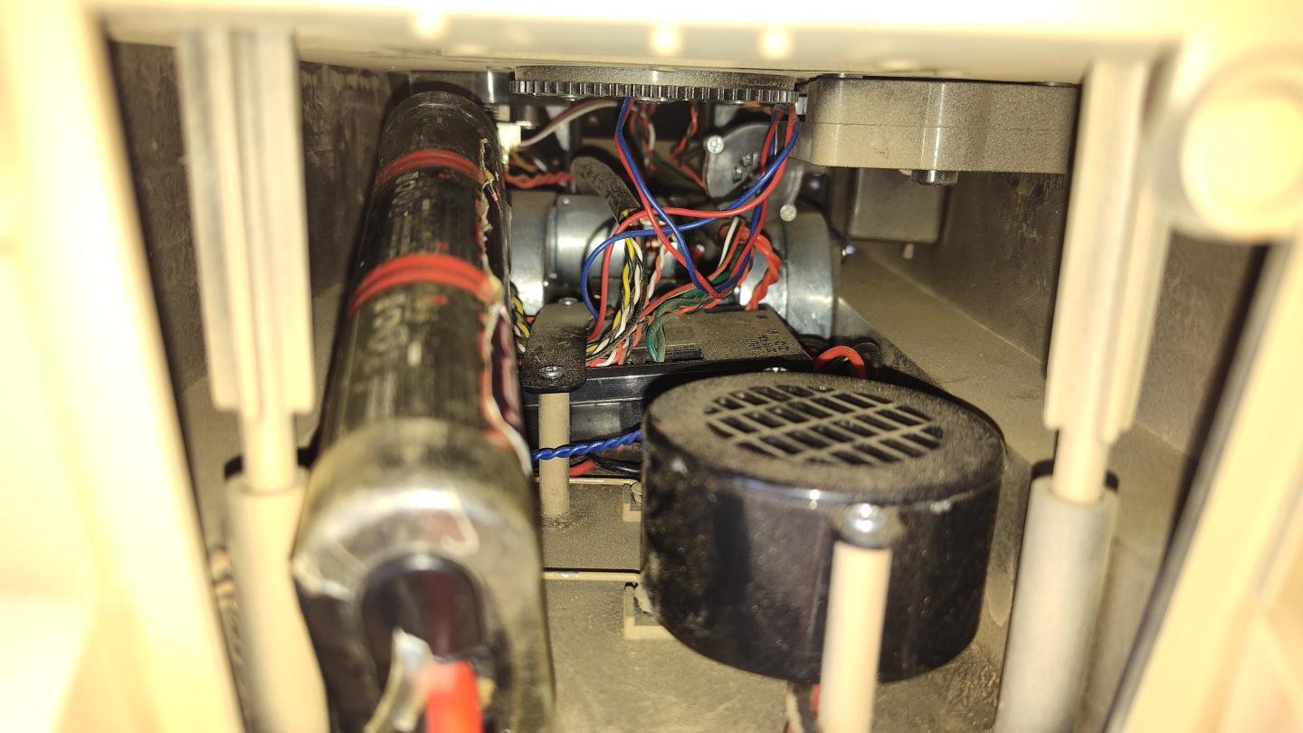

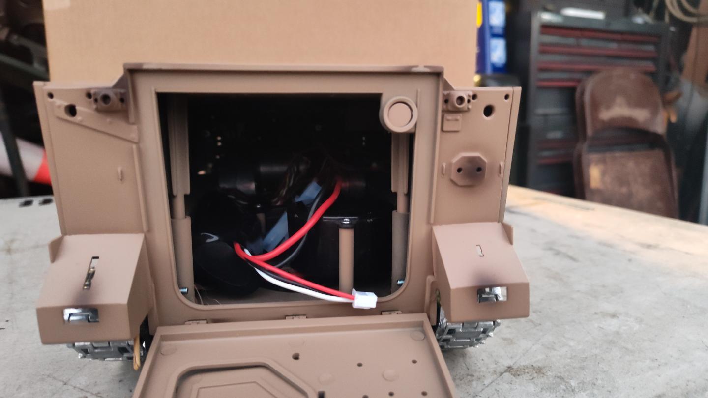

        The standard 7.2 RC car pack fits in easily.

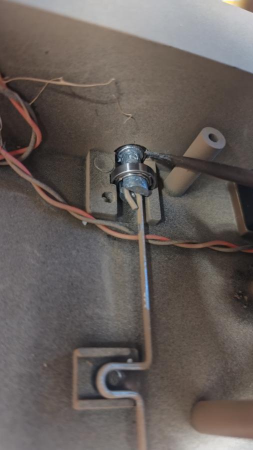

                  The driver's hatch is wonky the way it opens, but that's not hard to correct.
                  • RichJohnson
                    • 1276

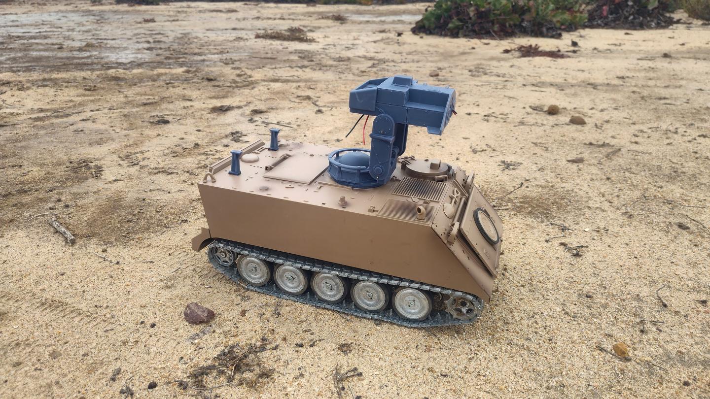

                    It slides open because they mounted the magnet for the ir receiver on it. Also probably cheaper.

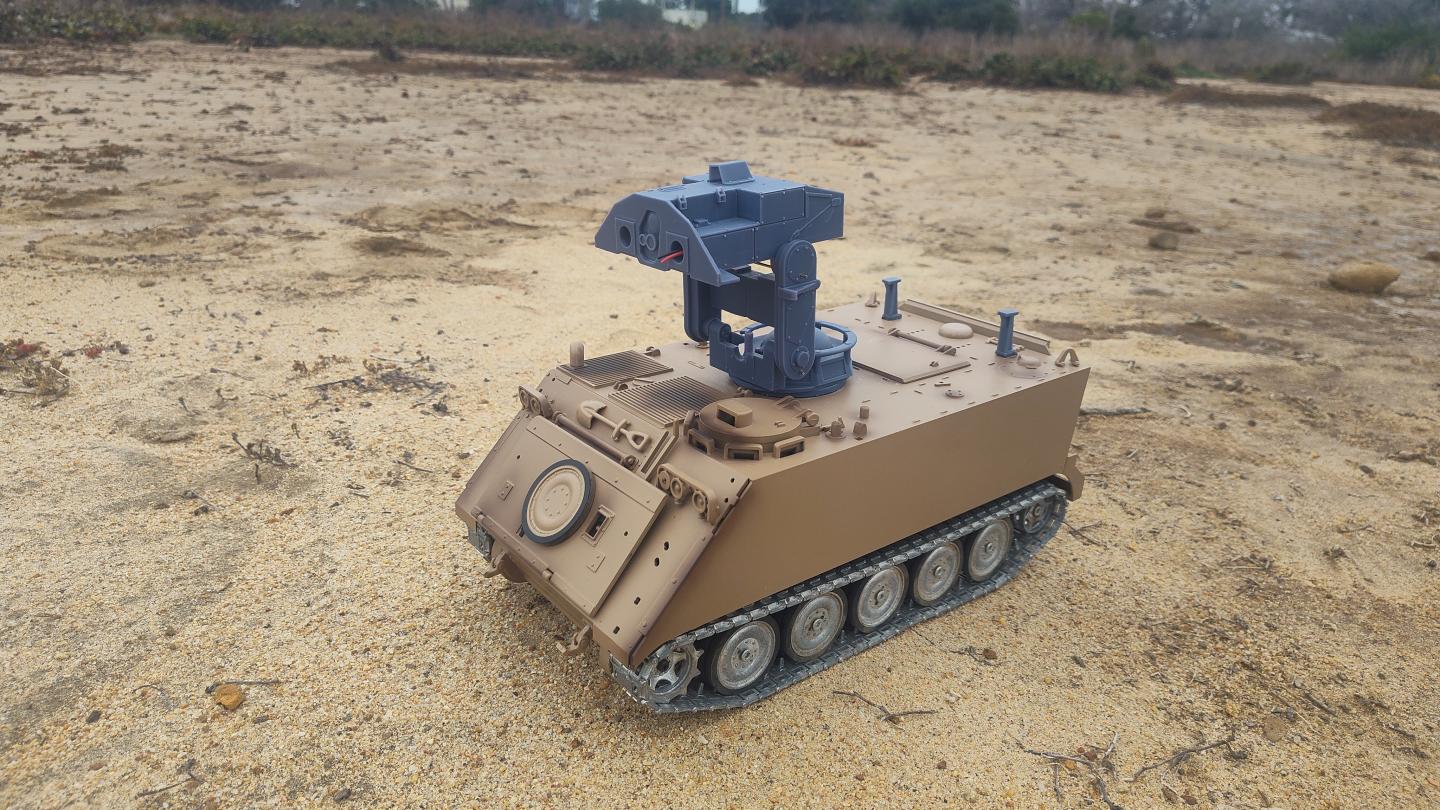

                    The benefit? For my M901 it makes it work like the real thing. On the M901 dual Tow launcher the hatch rotated open to clear the hammer head launcher.

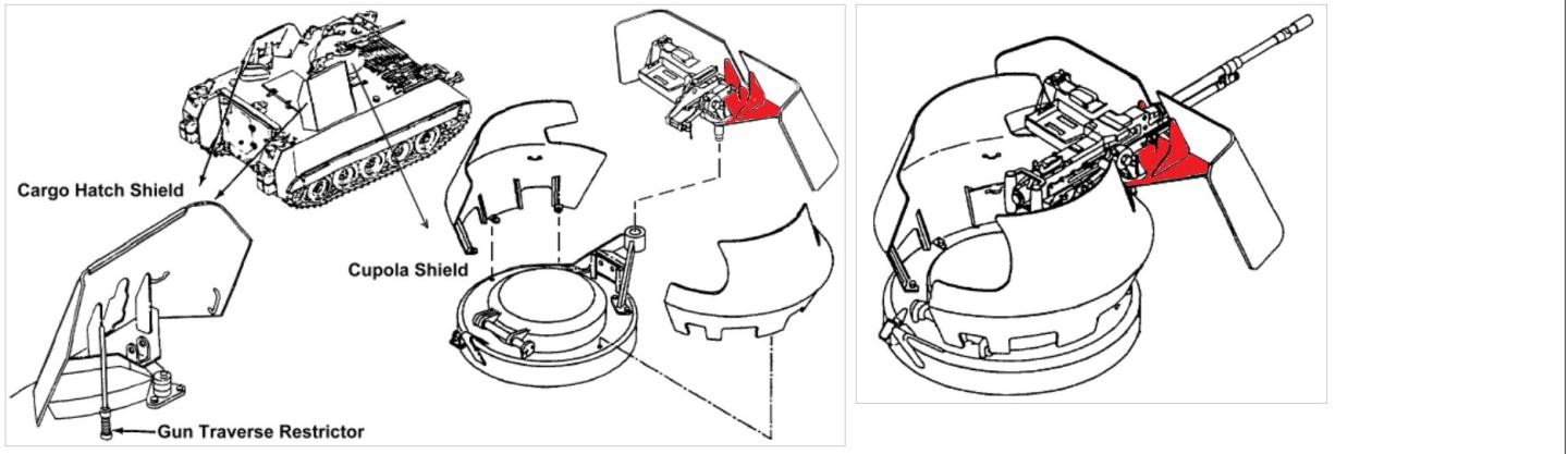

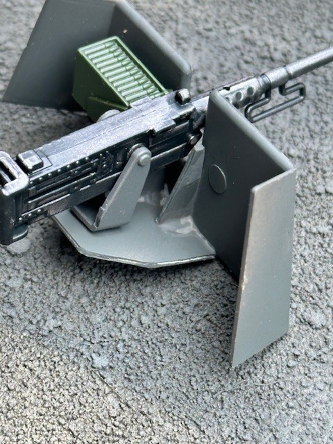

                      An issue:
                      The ACAV version supplies a shield for the main 50 Cal MG. However, there is no bracket for it, a major omission. The implication is that it is to be attached to the gun, an unsatisfactory solution. I checked the web for the correct method and found this:
Name:	Screenshot 2025-10-25 202044.jpg
                      it shouldn't be too hard to fashion the bracket from sheet styrene. It's too bad it's necessary.

                          TD is a quasi toy company and they bypass some details, like the swinging driver hatch. And the shield for the .50. They will do what looks good and is efficient for production aka cheaper. It doesn't distract from the model in any way but yes the shield keys into a tab on the .50 cal.

                            Per post #11, here is a mount for the 50 cal gun shield:

                              That came out great Bob and one of my customers told me he already copied your mount in his ACAV which arrived Monday from me.

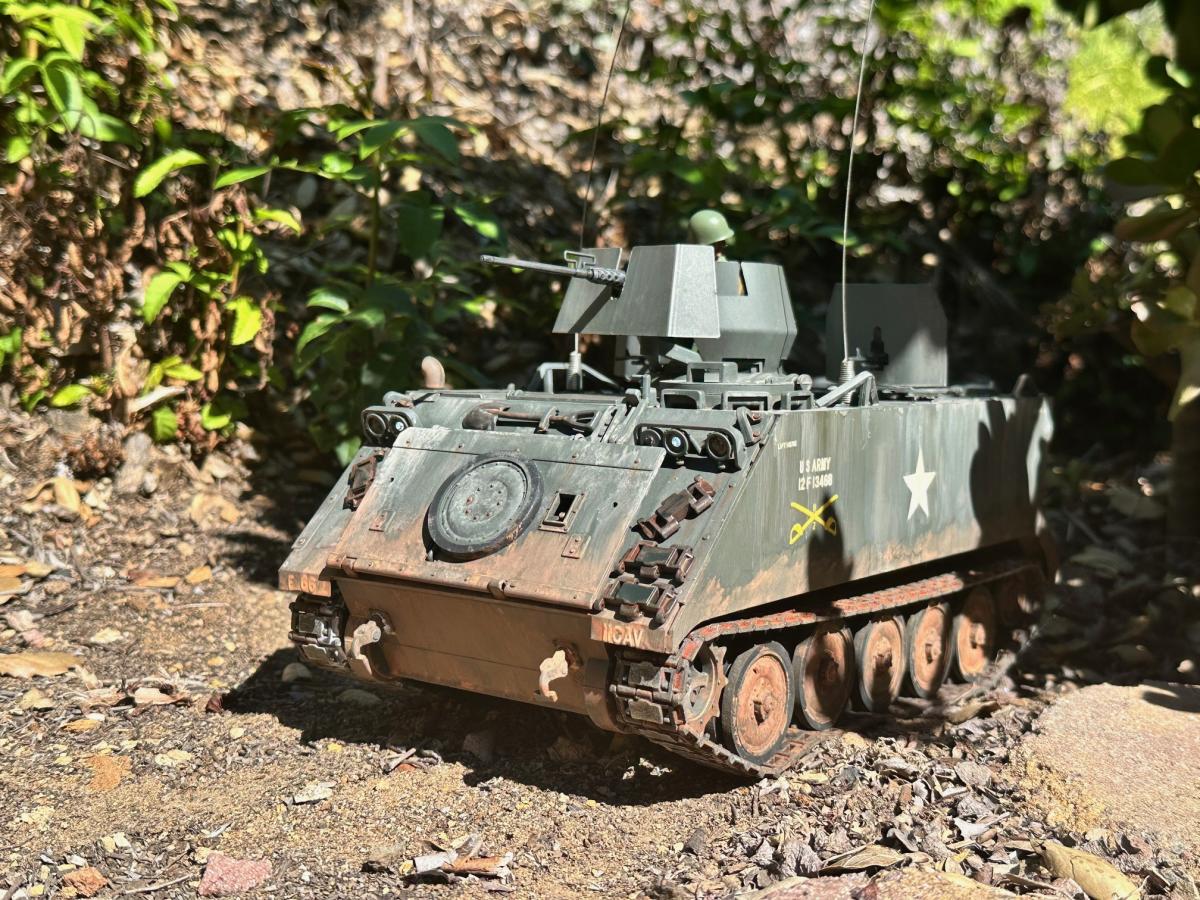

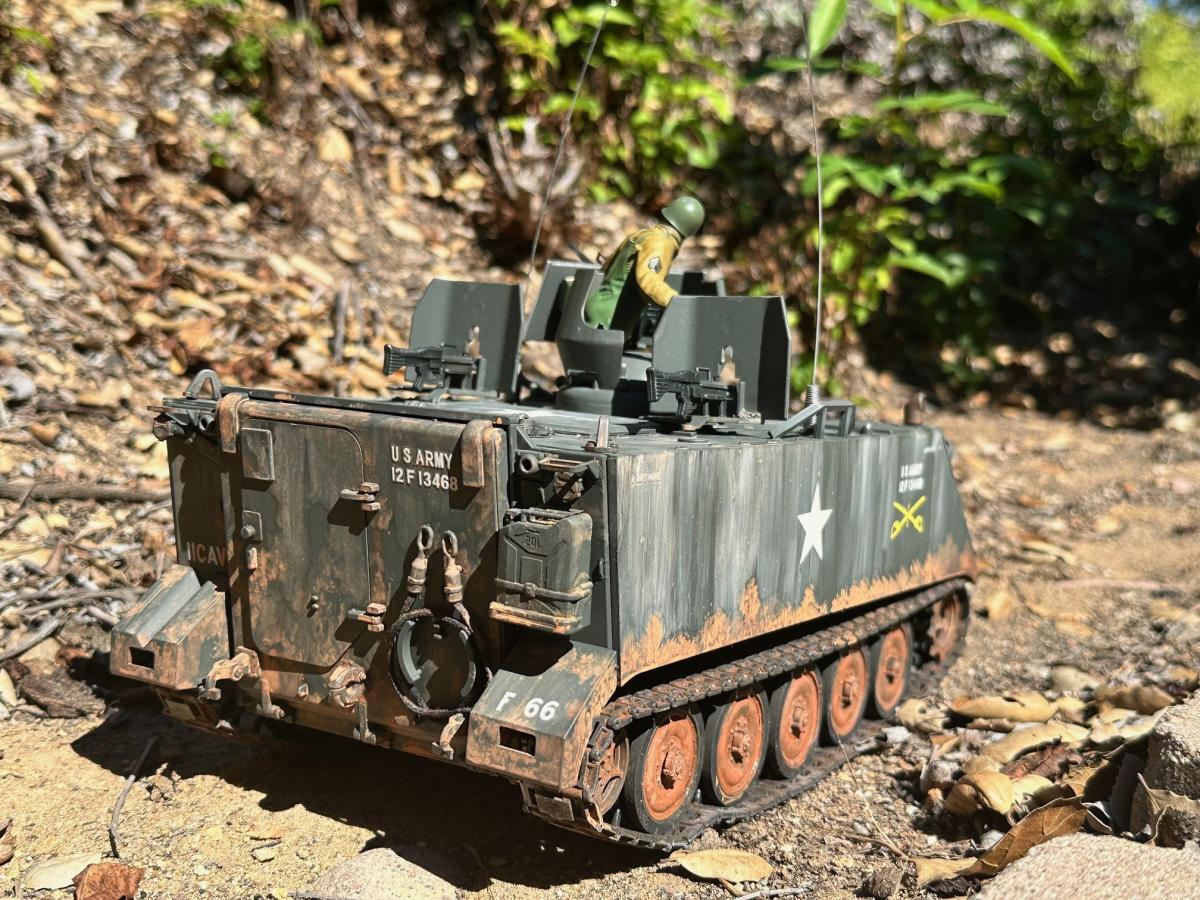

                                  Finished, at least for now. You might thinks there is too much streaking and splashing, but it reflects actual photos from Vietnam. Dry dust on top streaked by rains, red dirt below, from those same rains!

                                    That is a nice one. Thank you for sharing, Bob!

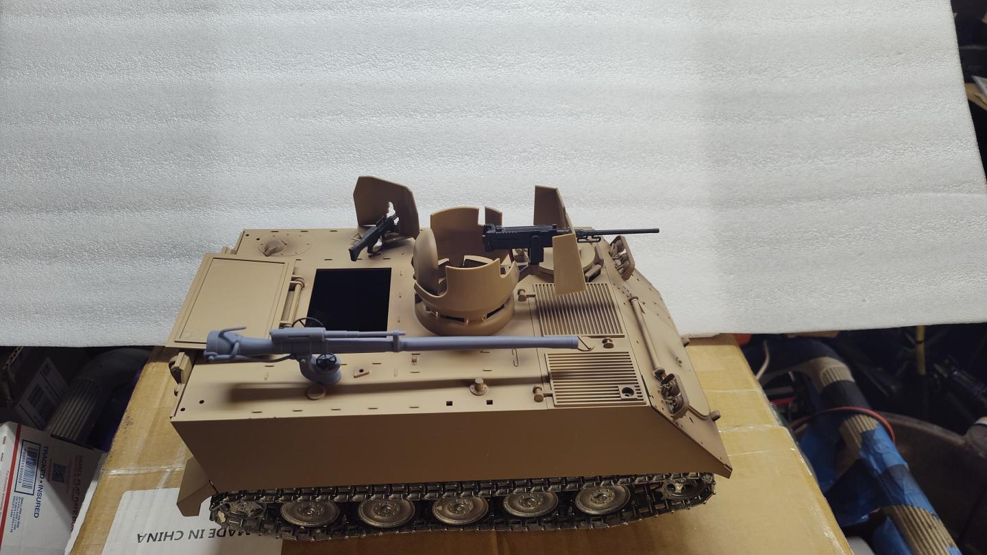

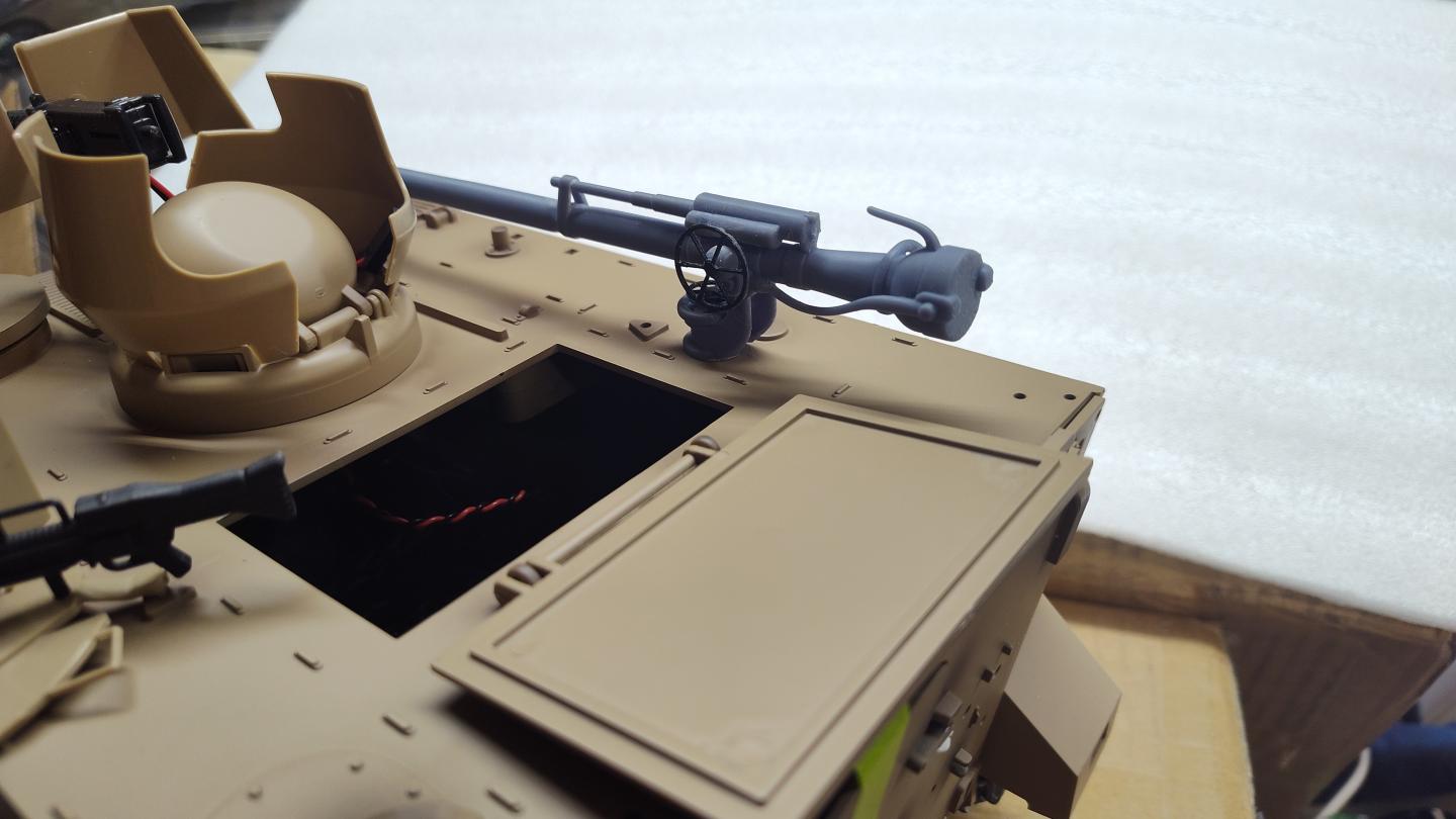

                                        In addition to the M901 Hammerhead TOW launcher kit I am producing for $95 I have now added a 106mm Recoilless Rifle for the Vietnam ACAV version.
                                        These were often added in Vietnam on the right hand side replacing the M60 machine gun.
                                        My kit comes with a brass tube in the barrel for support and a feed hole at the mount to run wires for a 3mm flash LED or to relocate the 3mm IR LED from the front of the M113. A savoy person could drill a hole and mount it on a shaft and use a servo inside on the elevation channel to make the gun traverse left and right. This gives a good reason for the APC to go boom and good use in an IR battle.
