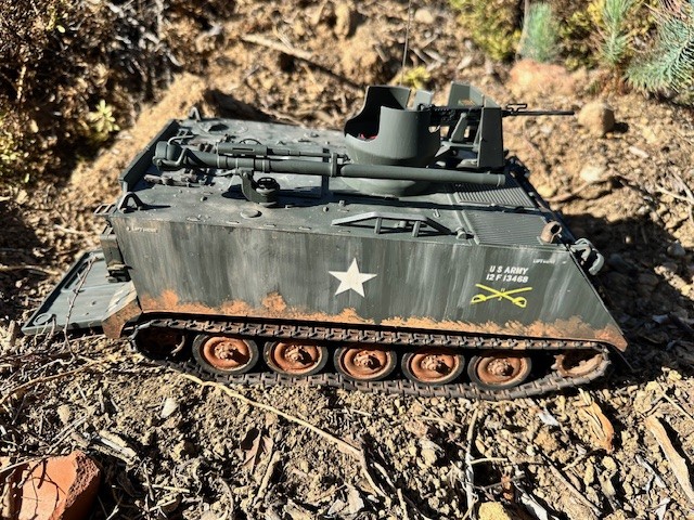

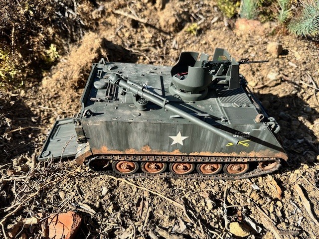

    I have added Rich Johnson's Recoilless Rifle (M40 I believe) to my M113. I have a spare IR bulb from another Tongde project that I will install in the barrel. TD's IR bulbs are 3mm in diameter, which fits in the barrel. The barrel comes with a 3mm brass tube, so wires will fit through it and out a small hole the RJ has incorporated in the M40 print. Traverse will be accomplished by a servo linkage activated by the slider on Heng Long's v.7.1 transmitter. The servo plugs into the CH5 port on the HL 7.1 board.
    The TD IR isn't as powerful as the aftermarket 6mm bulbs we use in our tanks, but is stronger than the stock HL IR bulbs. The effect of this is that the M113 will have to get closer to get a hit on a tank, making it vulnerable until it does, which can reflect it's relative weakness vs a MBT.

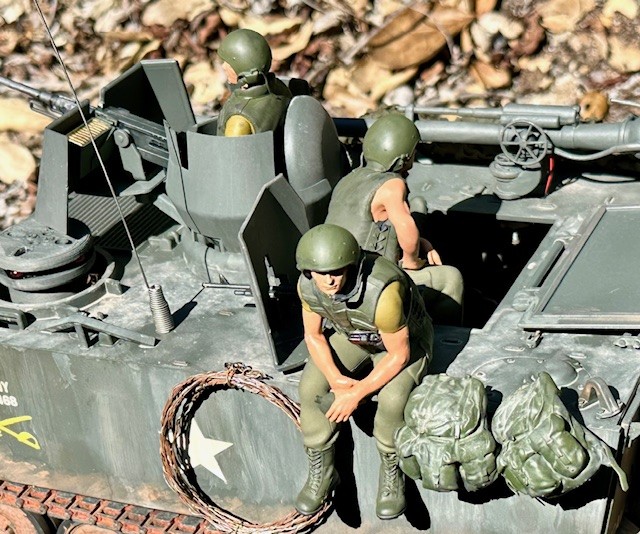

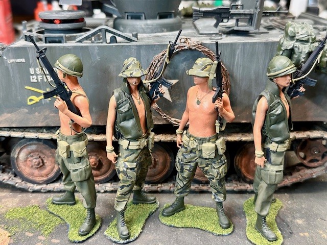

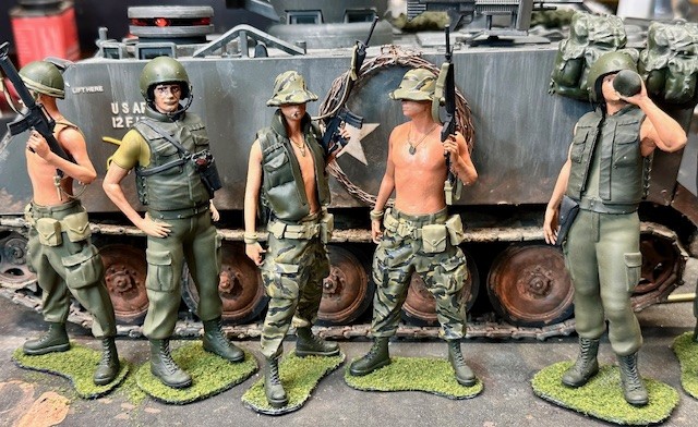

            I still have a few of each M113 in stock too.

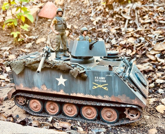

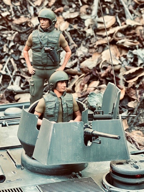

                  Finished my M113 . Photos taken at our RC flying field, a work in progress! Hardest part was finding a gunner that fit. Modified his arms to reach the gun. Very nice tank! Smoke tank was broken when I received it but was an easy fix Click image for larger version

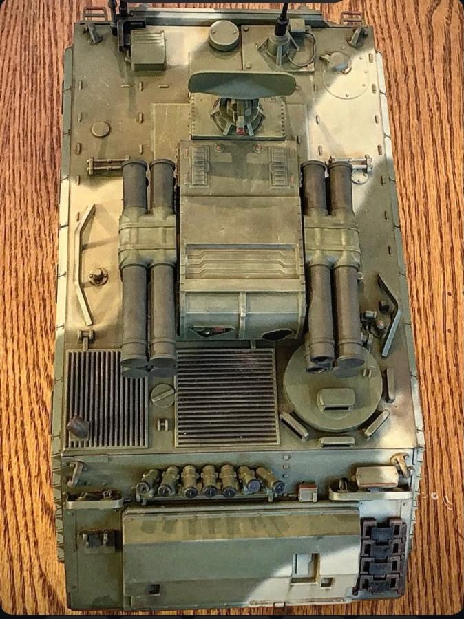

                    Some new products to customize the Tongde M113 into other tactical offensive battlefield AFVs.
                    Up first the M901 kit. A dual TOW middle launcher which gives an IR battle capable 113 the advantage of height over its IR Receiver and ability to hide behind cover and fire at tanks. Click image for larger version

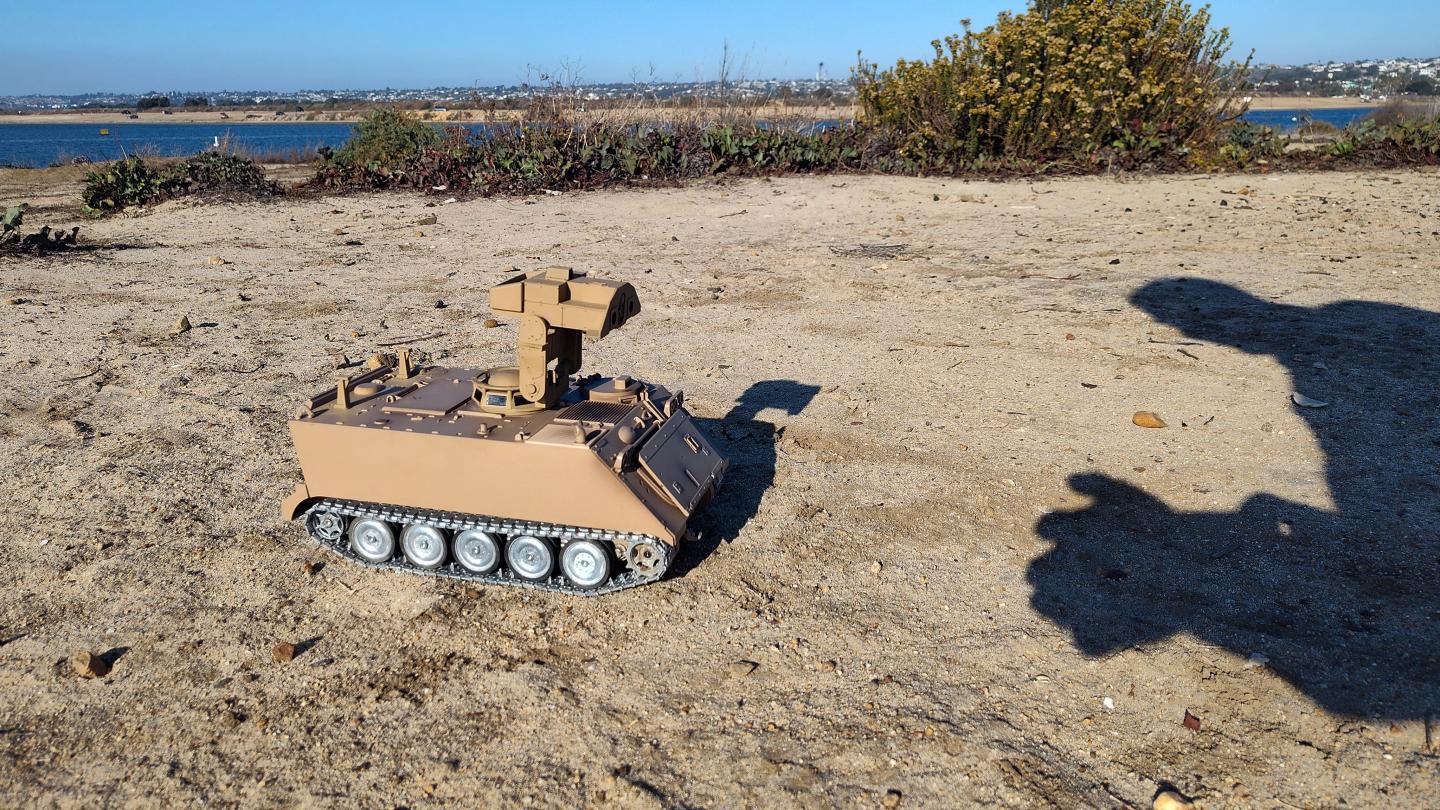

                    • #30
                      Up next is my new ADAT turret for the M113. That is an Air Defense Anti Tank styled closely after the product tested by the US Army and purchased by several foreign nations. It fired laser guided missiles similar to Stingers.

                        Nice build 👌🏻 Did you disassemble the M113 for painting? What color did you use?
                        • #32
                          Yes, i disassembled it. I used gun bluing on the metal tracks. Used rattle can green camouflage from Rust-oleum . Hardest was to paint the face on the gunner . I also dab a little green over the decals to simulate fading and chipping using a sponge .
                          • #33
                            Rust-Oleum 1920830?
                            • #34
                              279175 flat deep forest green
                              • #35

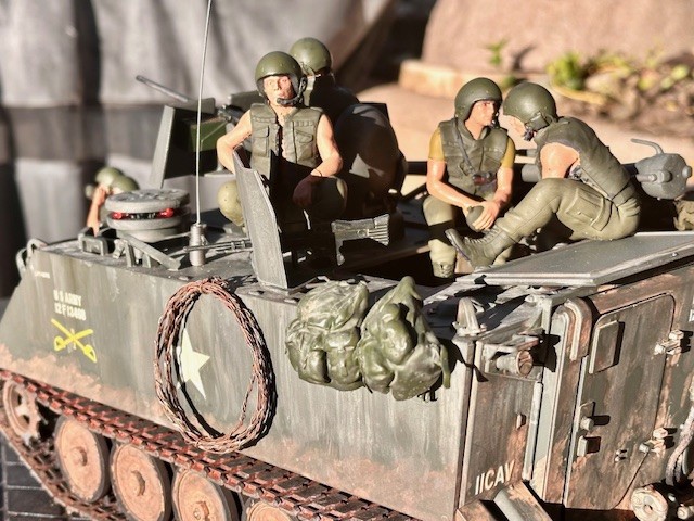

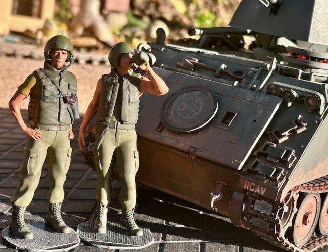

                                      I thought I'd posted these earlier, but not so here they are: what's an APC without soldiers standing around waiting to mount up?
