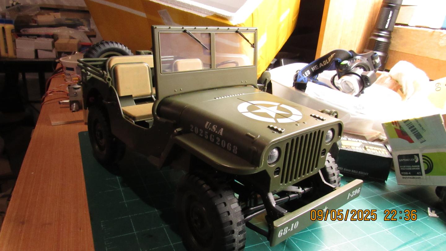

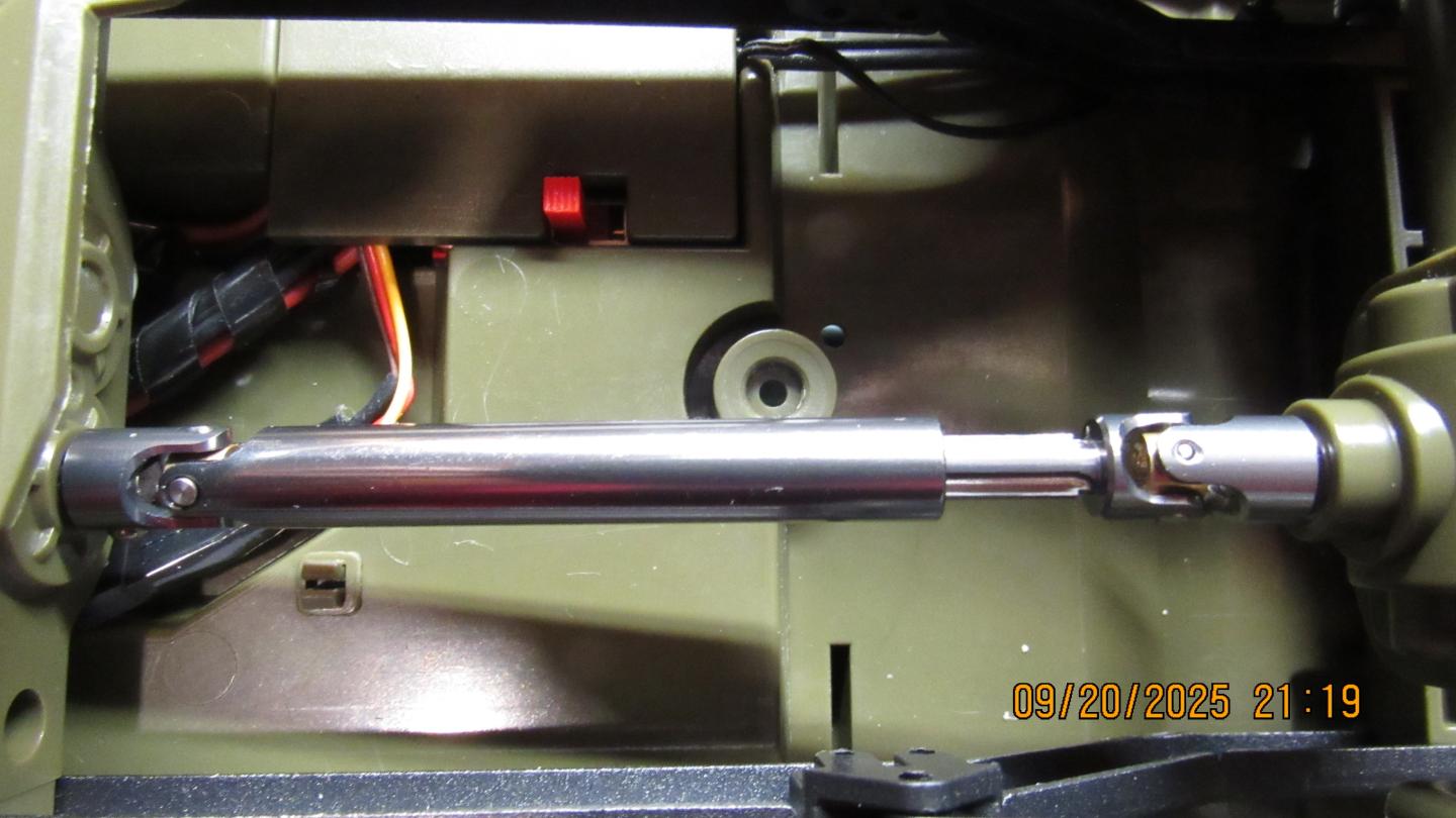

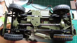

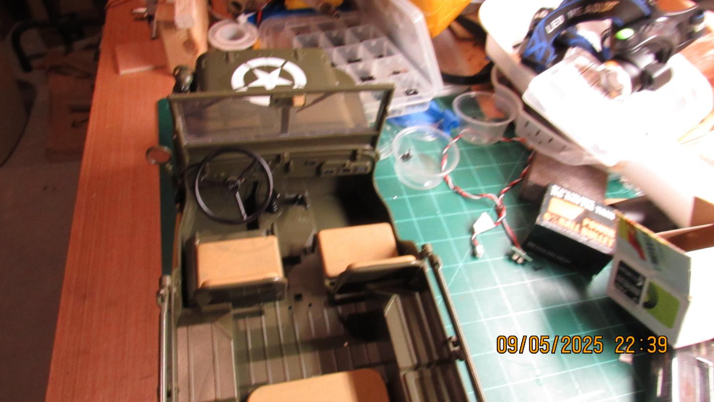

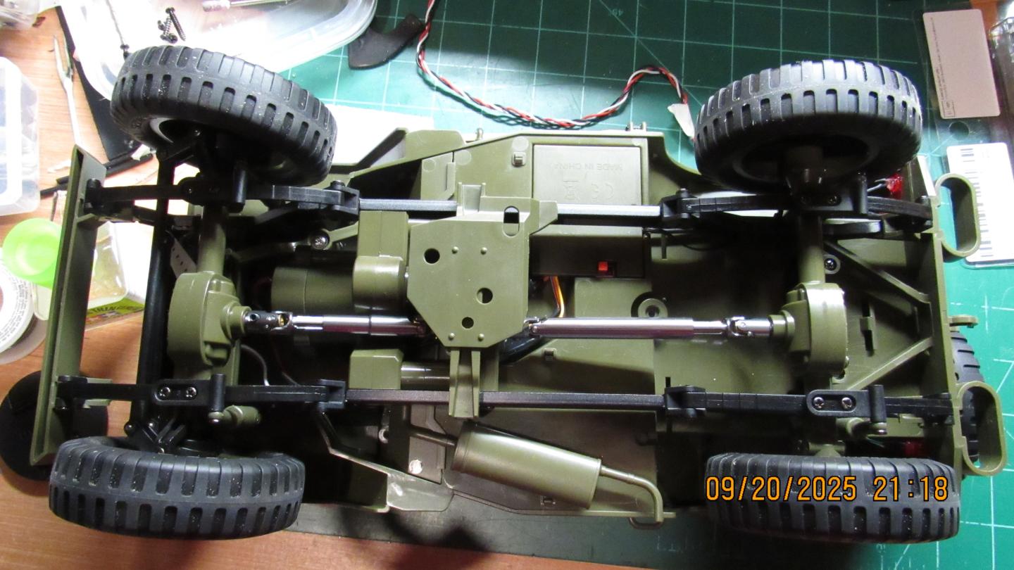

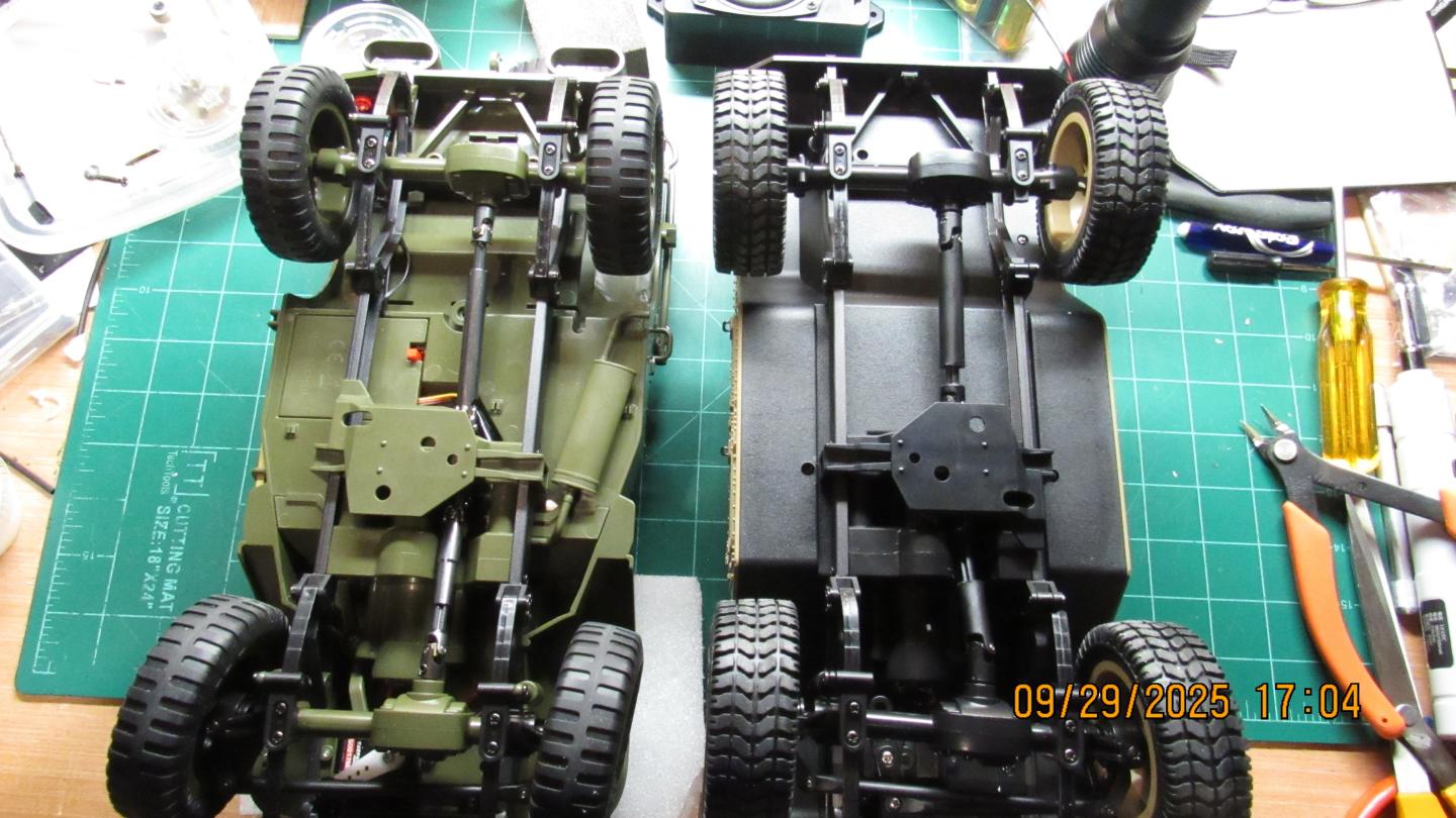

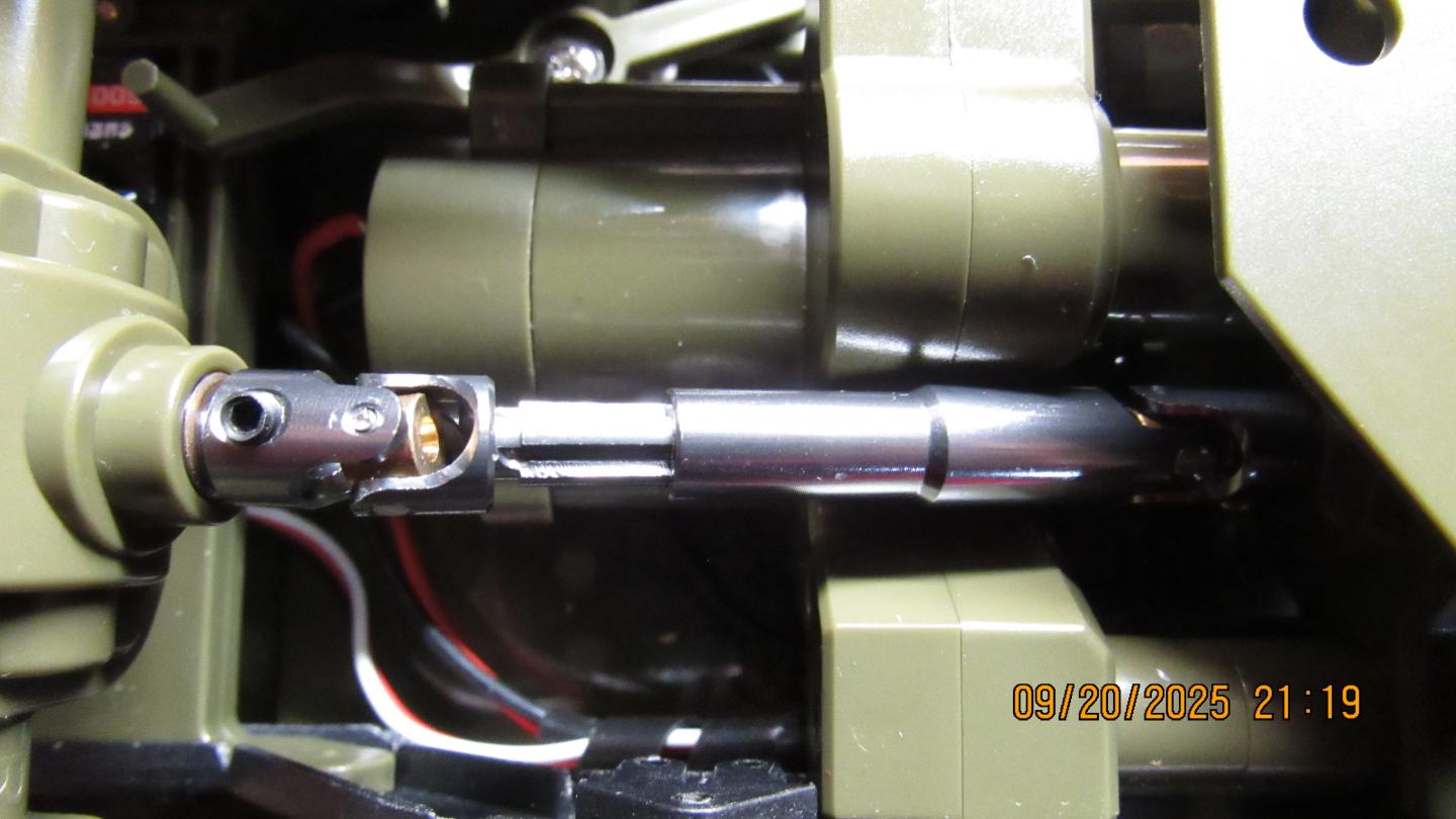

          After driving it for a few weeks, I consider the JJRC C8815 1/10 scale MB Jeep a very good runner as is. In general, it uses much better quality components compared to the JJRC Q75 1/16 scale 6WD truck that I acquired 2 years ago. I upgraded the Jeep's drive shaft to metal because it is so cheap (<$10). I decided to leave the motor, gearbox and steering servo as is.

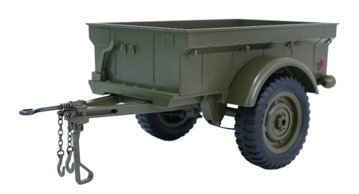

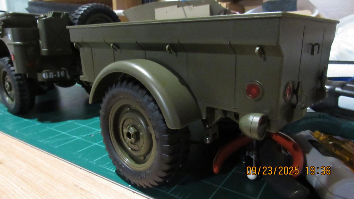

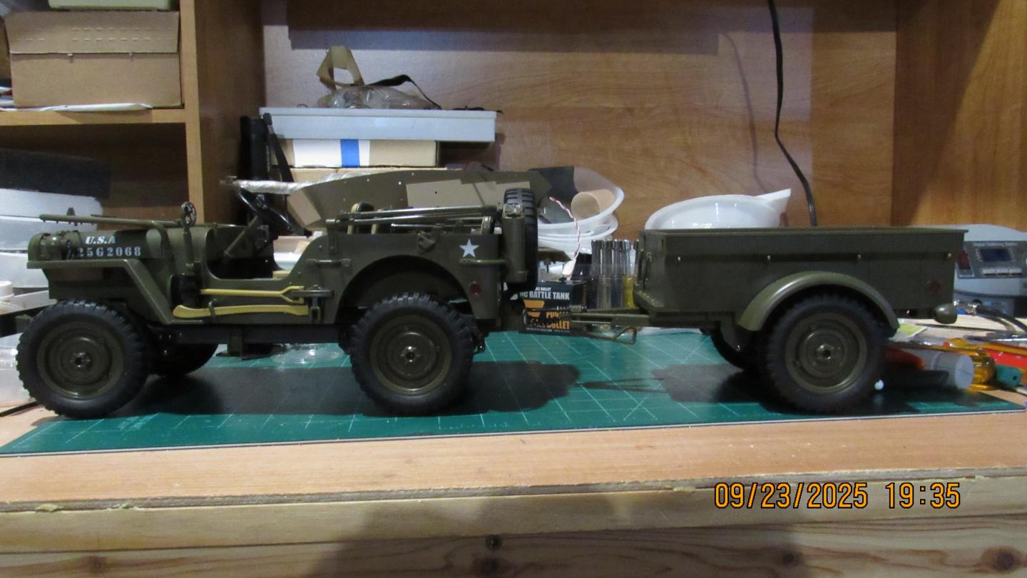

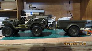

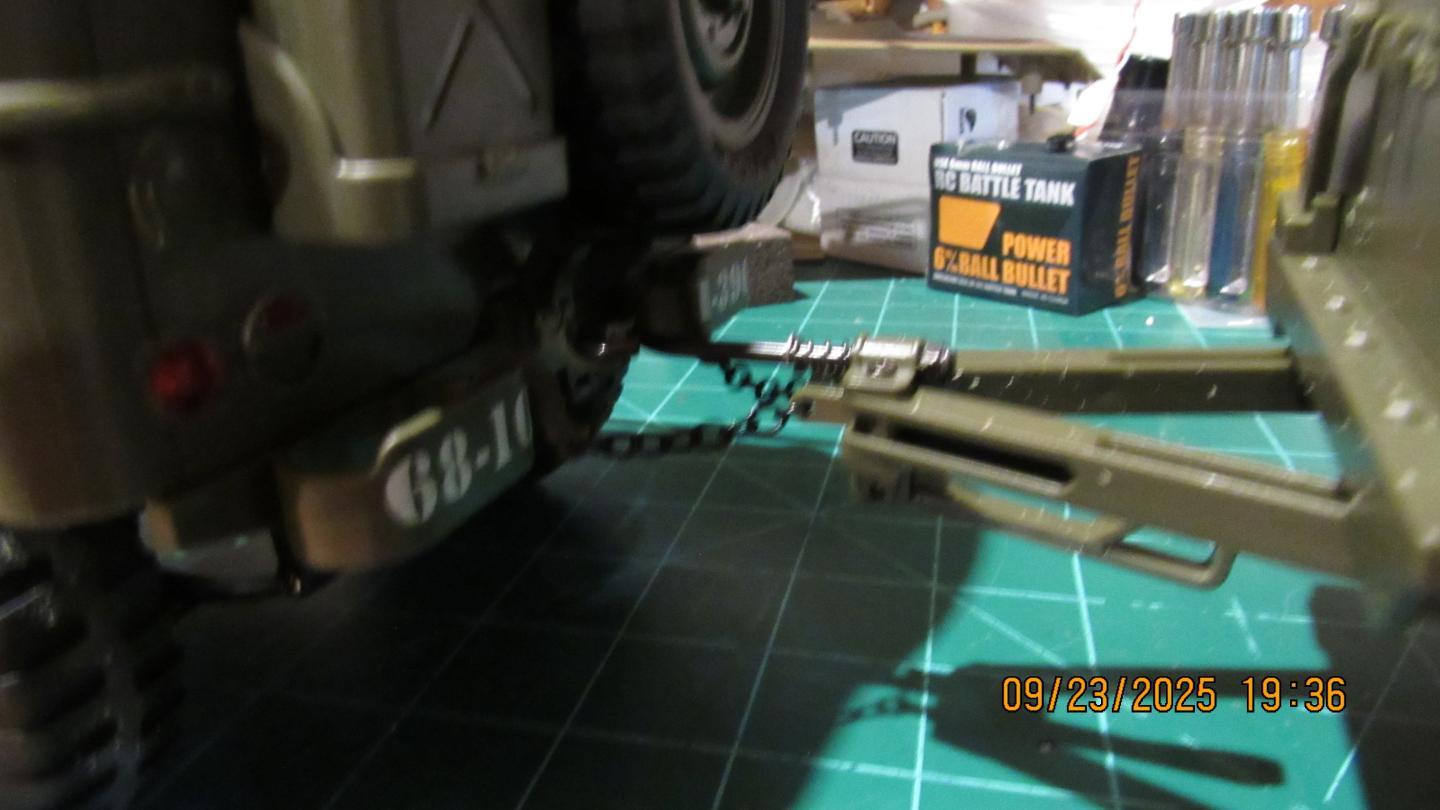

          I also get the JJRC Jeep trailer for $15. I was very pleasantly surprised by the quality of the trailer. Crisp mold lines, good details and heavy construction. This assembly is longer than any of the 1:16 scale tanks I have.

          I would have preferred the Jeep to tow a M3 anti-tank gun. The only candidate is the ROCHobby 1:12 M3 gun. It costs twice that of the Jeep/trailer assembly. I will wait awhile to see if JJRC offer a M3 anti-tank gun.

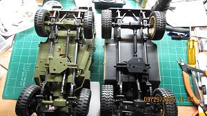

            JJRC C8835 Hummer arrived 2 days ago. Initial drive in the smooth basement floor shows it to have excellent proportional control in both acceleration and steering. It is not a fast running Hummer, but fast enough for me. I do not find any upgrade necessary. The chassis is almost identical to the C8815 Jeep. The physical length is the same. The Hummer has a half inch wider wheel base and larger tires. The tires are already foam filled, but a little softer than I prefer.
            Click image for larger version  Name:	IMG_5573.jpg Views:	0 Size:	169.1 KB ID:	433183
            I do not like the proprietary battery pack which is a 2S Lithium-Ion. Judging from the case size and capacity spec, it probably uses 2 14450 cells. The proprietary battery connection and hard shell pack make it difficult to upgrade to better quality packs. I may have to remove the upper cabin to rewire the battery connections to XT-60.
