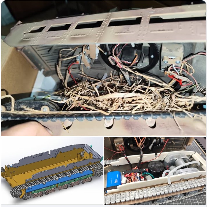

        Two quick observations: first, the turret traverse cable plug was loose and stopped moving. I opened it up (four screws) and re-seated it and it works. Second, and this is a characteristic of the subject model, not the r/c product; the tracks pick up debris and some of it ends up in the hull interior, more so than a tank with exposed return rollers. I suspected it would be the case because of the enclosing side skirts. It'll require more frequent after event cleaning.

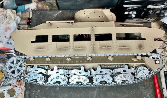

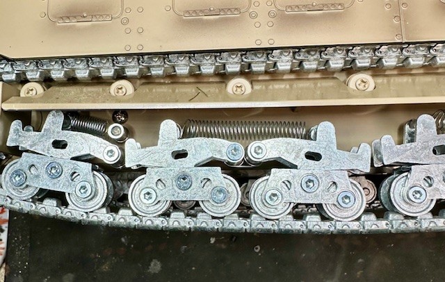

          Since I opened it, I took pics of the suspension. Complicated! Another reason to go metal. Imagine all those parts being plastic.

            Bob do the wheels have bearings or brass bushings?
            • #7
              Can't say for sure at this point, but they don't freewheel like it has a bearing. They'd need 24 of them if so. There is a thrust bearing on the drive shaft to the sprocket. That's a new one.

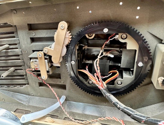

                Okay, I'm tracking the turret motor issue some more. The turret began to not turn again, intermittently. I tried another TD board and the same symptom appeared. Someone on the RCTW forum was sharing something similar. I then tried a HL board and there was no failure (at least not yet).
                The turret gearbox is not the standard one found in other TD and HL tanks. It is exposed, see attachment. I believe this was done because of the very limited interior space. One hypothesis is the gearing stalls the motor, only sometimes, which is why two boards acted the same. Anyway, I'll be running the HL board to see if the behavior repeats.
                Click image for larger version  Name:	IMG_2802.jpg Views:	0 Size:	113.8 KB ID:	443882
                If others encounter this, let us all know. At some point I'll be contacting TD about it, and more detail always helps.

                  That gear set up is closer to what Tamiya uses.
                  Bob was your TD Tx in LP mode. In LP mode the TD unlike HL reduces the turret power by 30%. This could be why it was stalling.
                  • #10
                    Hmm, possible. The Tx was however it was set up in China, although the issue showed up on two boards. I'll play with it some more.
                    EDIT: You could be right. Although I'd pulled out the TD board, I was able to plug in the turret motor into it on the bench. The motor sounded stronger, and I didn't get it to stall. I'll have to run it longer to be sure. If so, Tongde should be told, unless it's been done before.

                          Per post #9, check if you are in low or high power mode. Button T & Right Stick up and down will toggle this. High power will work the motor satisfactorily.

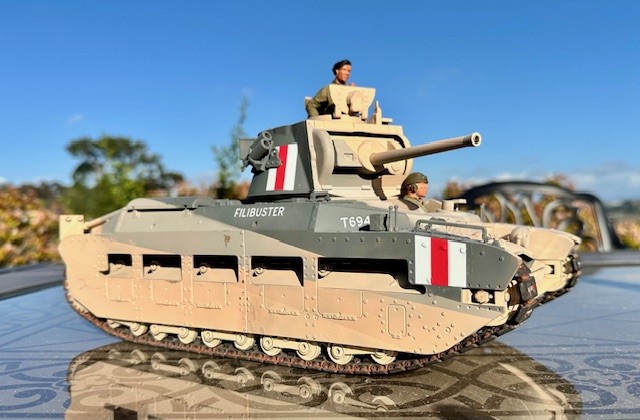

                              Paint progress. The basic scheme is in place. Touch ups, small parts, decaling, detailing and weathering still to do. No sky blue on this one!

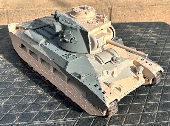

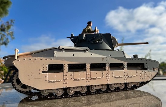

                                    Okay, different light, different angles. Decals on, and a driver fitted. They still need their faces painted.
Name:	Matilda III TongDe 17.jpg
ID:	444214 Click image for larger version
Name:	Matilda III TongDe 16.jpg
                                    So, something to share: The tank's interior is not walled off from the tracks when they return. This results in a ton of debris being dumped inside. So much so that DKLM RC is devising a set of partitions to stop this. DM'ing him about availability. This is his photo. I experienced the same.
Name:	grass invasion.jpg

                                      More progress;
Name:	Matilda III TongDe 20.jpg
ID:	444354 Click image for larger version
Name:	Matilda III TongDe 19.jpg

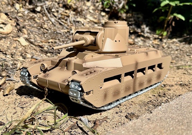

                                      • #20
                                        Same tank, I just got it out to our battlefield.
