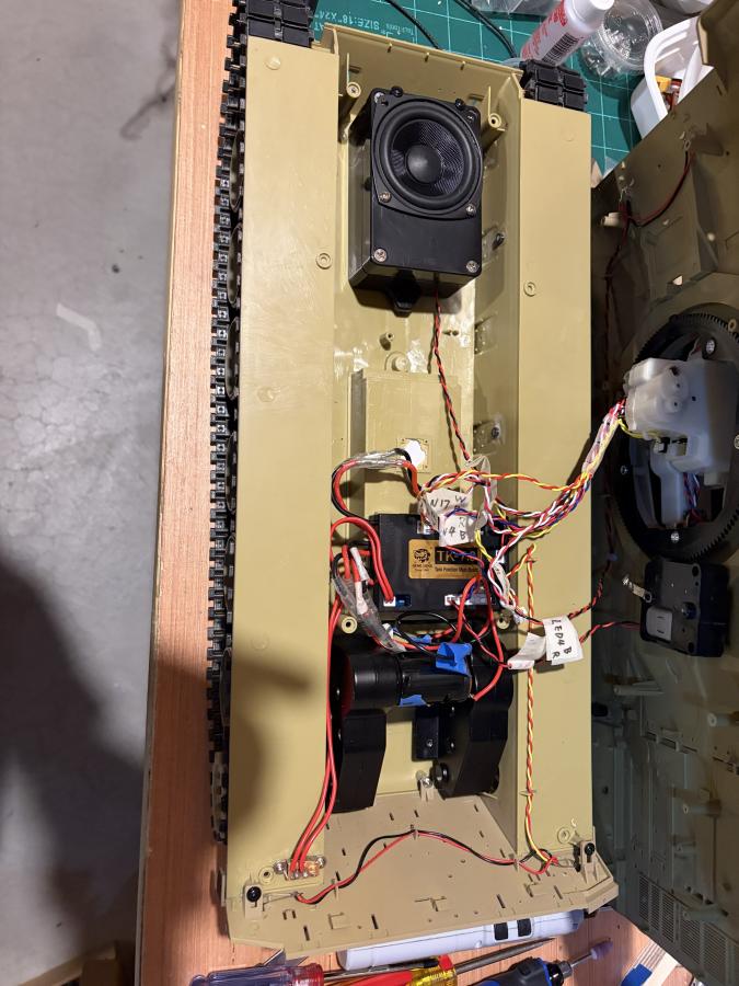

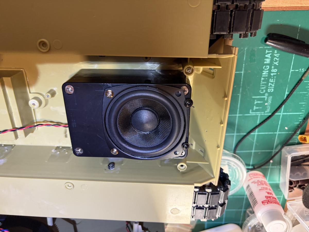

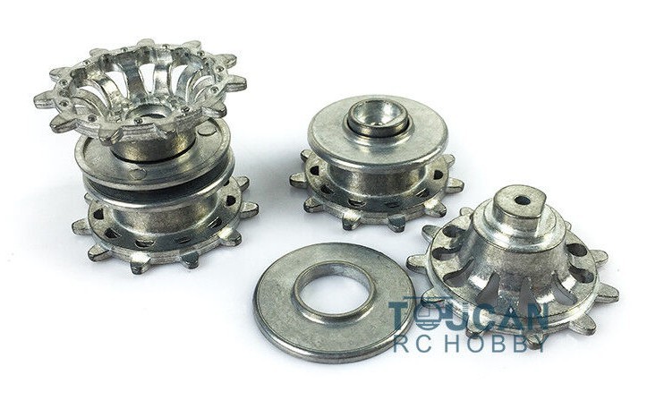

    After a 2 years debate, I finally decided on the Heng Long Challenger 2 for my first UK RC tank model. It is a post cold war era MBT so I expected the metal upgrades to be similar to the Leopard and Abrams. The upgrades include ball bearing stegearbox, sprocket and idealer wheel, metal tracks, drive motor shaft bearing, stronger suspension coil spring plus a high capacity lithium ion battery and 2.5" speaker. All pretty routine items.

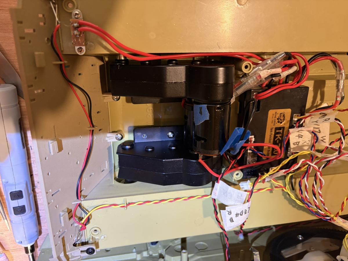

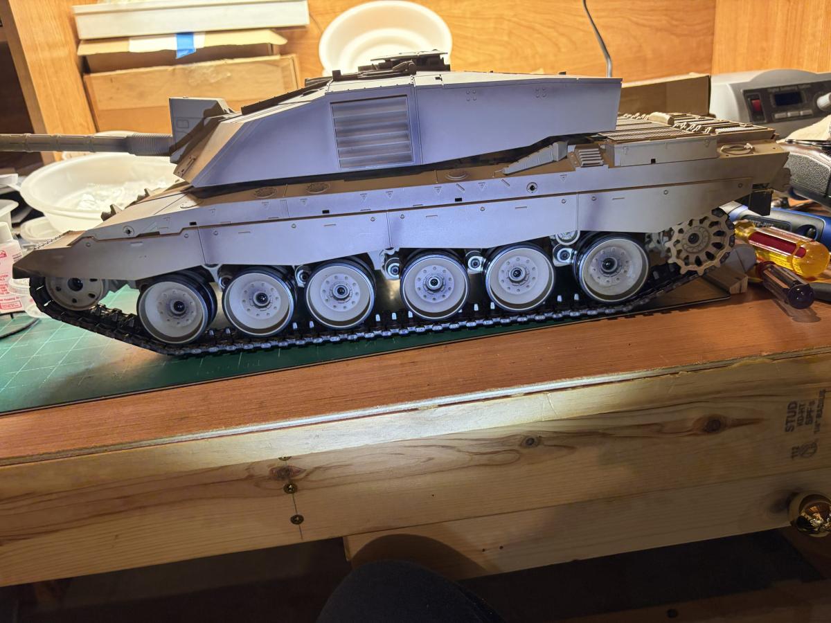

    My favorite gearbox is the Heng Xin with 390 motor. To my disappointment, The Heng Xin gearbox can be mounted with 390 motor only because the chassis is 0.5 inch narrower than the Leo and Abrams.

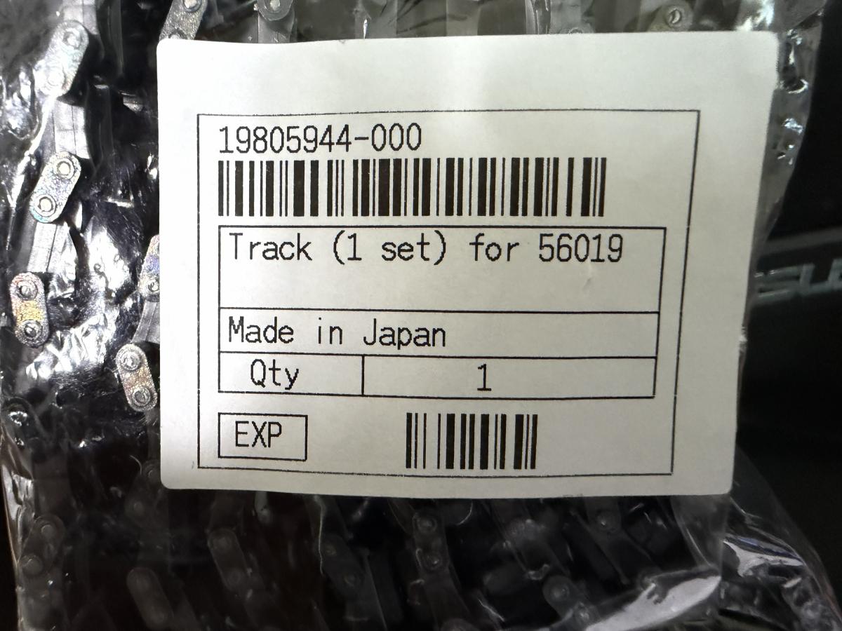

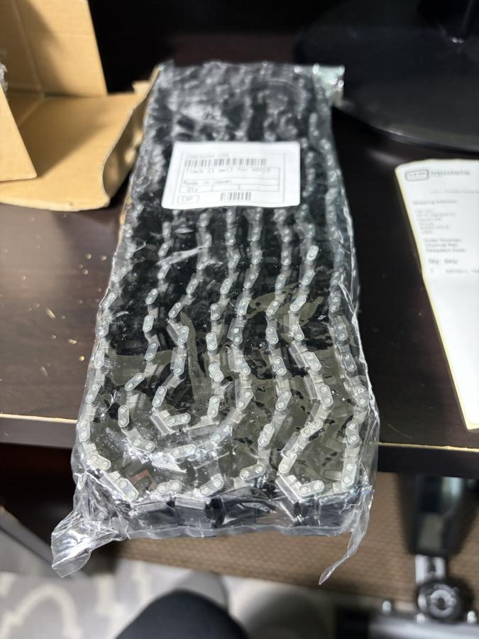

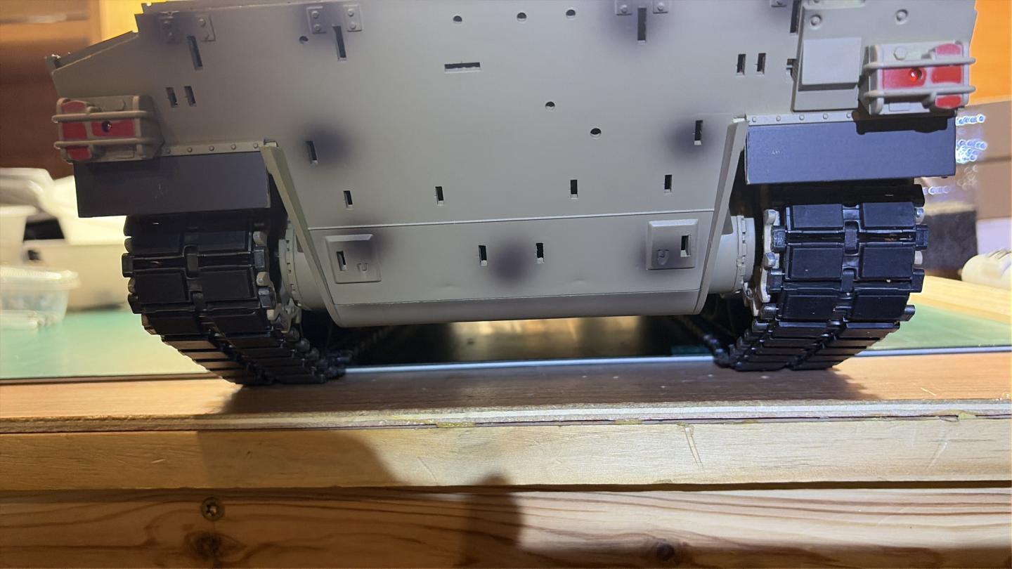

    I was planning on the DKLM metal track set because it is 1/3 the cost of what tamiyausa.com wants for the Tamiya tracks.
    Preferred metal track for 1/16 scale modern MBT - Hobby Squawk RC Forum for Airplanes, Boats, Cars, Helicopters, Tanks, and Trucks
    But the DKLM metal tracks are heavy and a poor match for the 380 motor. I searched for the Tamiya track in other parts of the world and found a paired Tamiya track set package at ttpmodels.com in England. The shipping is cheap and quite fast.

    I am waiting for delivery of a Taigen/Torro Series 2 gearbox with 390 motors

      I paid US$164, ($145 item, $19 shipping), for the pair of Tamiya tracks to TTP Models in England. Shipping takes about one week. There was some damage to the mailing package. TTP did a good job packing to protect the tracks.

        A correction post:
        Originally posted by keilau
        My favorite gearbox is the Heng Xin gearbox with 390 motor. To my disappointment, The Heng Xin gearbox can be mounted with 380 motor only because the Challenger2 chassis is 0.5 inch narrower than the Leo and Abrams.
