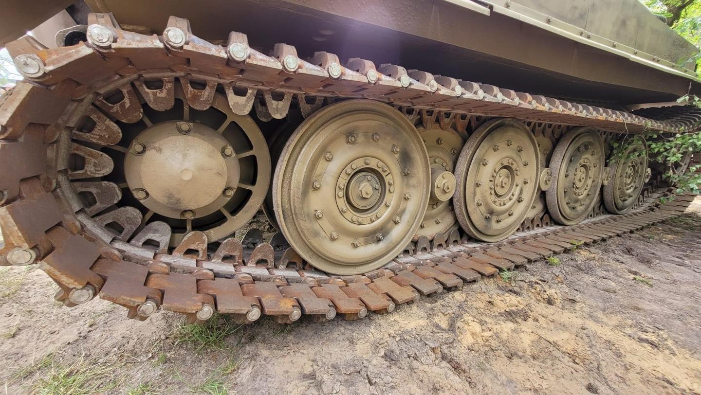

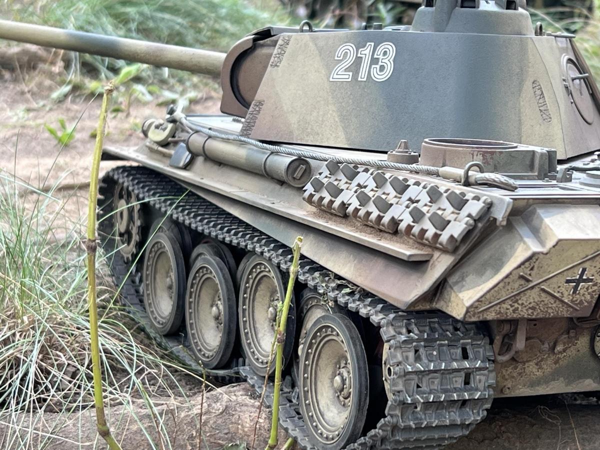

    Thanks guys. I thought that tank treads were black with steel bits that would be rusted.
    I do not usually rust things much here's a pic of metal tracks on my Panther G.
ID:	396341But during my research for my Tiger I build I've seen several real Tigers with their tracks an orange tan color and I tried to emulate this with this run of Tiger tracks-
    You can see the difference between the tracks in use and the spare tracks.
    And here is a super close up for the ones I was trying to emulate-

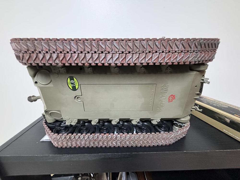

      Thanks for the help guys. I decided to go middle of the road with some dry brushed rust. I’ll wear some of it down once the weather cooperates. Click image for larger version

          #84
          One of your tracks is on backwards 🤔

            #85
            Thanks. I'll take a look at that tonight.

              #86
              On a full scale tank, the track is unidirectional to optimize traction and stability.
              On the Heng Long 1:16 scale, I've repeatedly saw the tracks installed in opposite direction. It seems to be done intentionally by the toy manufacturer. Anybody knows how it happened?
              • Scott Larkins
                • Jan 2024
                • 21
                #87
                I looked at a picture I took of my tank when I got it and yes, I put the right side track on backwards. Thanks guys.

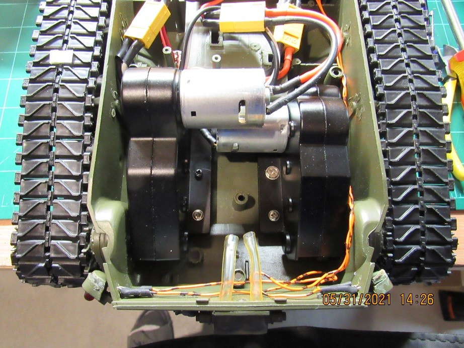

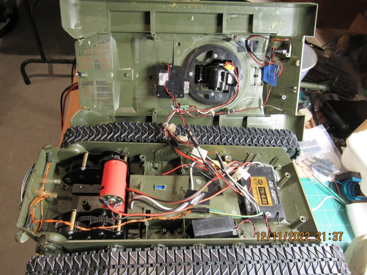

                                    The Pershing is a medium tank. It has not enough room for the Heng Xin gearbox with Red390. I want the higher speed with 390 motor for the Pershing. I ended up using the Taigen/Torro Series 2 gearbox with 390 motors.
ID:	439648 Click image for larger version
ID:	439651 Click image for larger version
ID:	439649 Click image for larger version
                                    But the Taigen/Torro gearbox are getting super expensive and difficult to find. I found this cheaper alternative that looks very good on paper, but I have no first hand experience with this seller:
