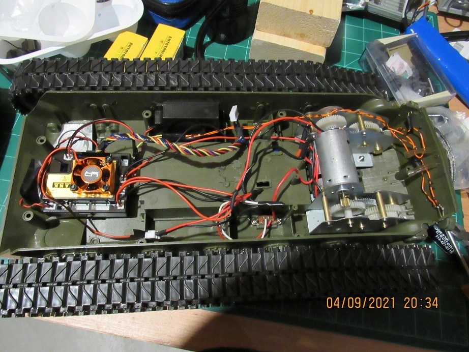

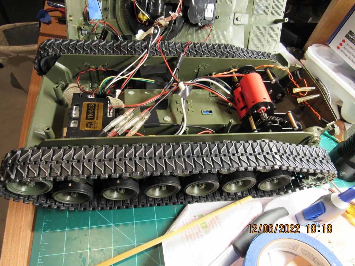

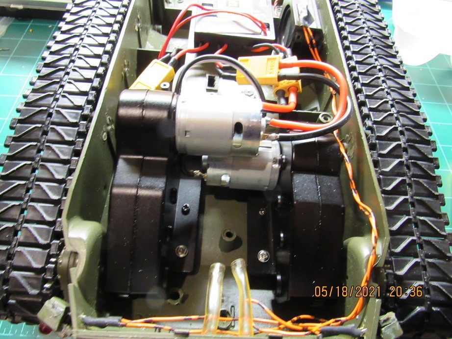

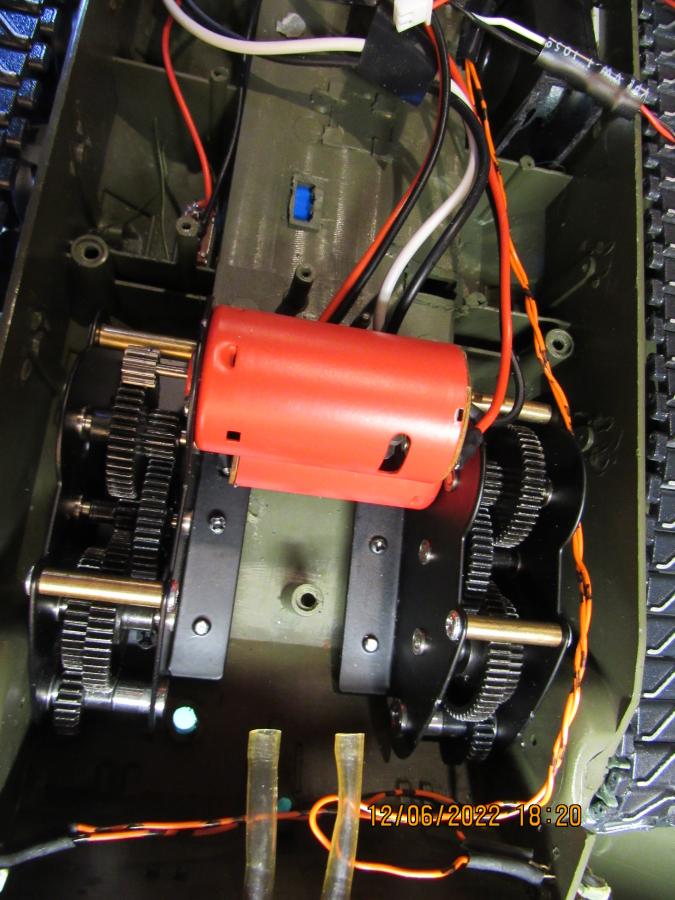

                    The Heng Long M26 Pershing is my second HL RTR I purchased in 2004 (plastic version only in those year). It went through 5 upgrades to make it to run smoothly and reliably in my backyard lawn. I found that grass lawn is tougher on the tank than sand. I never tried it in the mud. The mod is nowhere near the complexity of what tank_me, robicon and others post here. But I hope it to be a mutual encouragement to beginner tanker like us. I will post more description of the mod later.

                      Somehow the link pictures don't show in my computer, just the text. Also, did the red motors speed the tank up any noticeable difference?

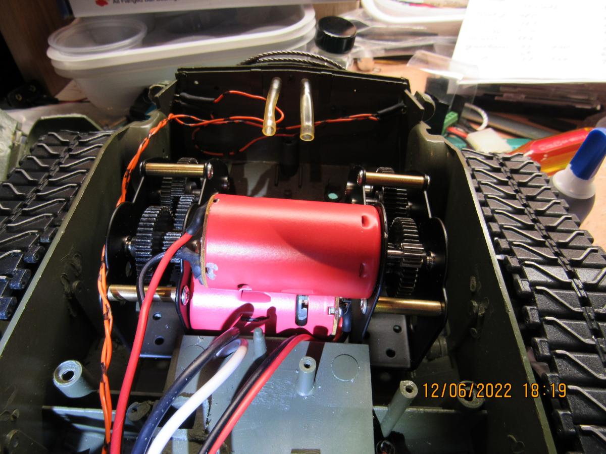

                          Yes, I used to have the Tamiya380 on the Pershing which gives it very good scale speed. I mostly run my tank in the backyard which has good open space. I missed the fun of running short straight dash so I changed to the red 390
                          I fired up the Taigen gearbox with the red 390 and get a scale speed of 36 mph. It is much faster than the real Pershing's 26 mph sustained and 30 mph dash. The previous Tamiya380 and Heng Xin gearbox got 26 mph. I found the Taigen gearbox much quieter and steadier than the Heng Long steer gearbox, almost approachs the quietness of the Heng Xin gearbox.
                          All the gearbox I tried use 39:1 gear ratio. No reason to change as long as it is the 380/390 series motor.
