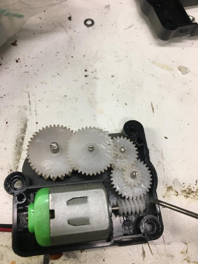

                                        #59
                                        Actually 4 gears Click image for larger version
                                        • Rubicon99
                                          • 3316
                                          #60
                                          Actually 4 gears Click image for larger version  Name:	A848F597-39CA-4D62-8C1F-090B2DFC3E1F.jpg Views:	0 Size:	56.3 KB ID:	395072
                                          Ok.....4 gears. It's been a while since I had to mess with one. The point is they are easy and uncomplicated to work on.
