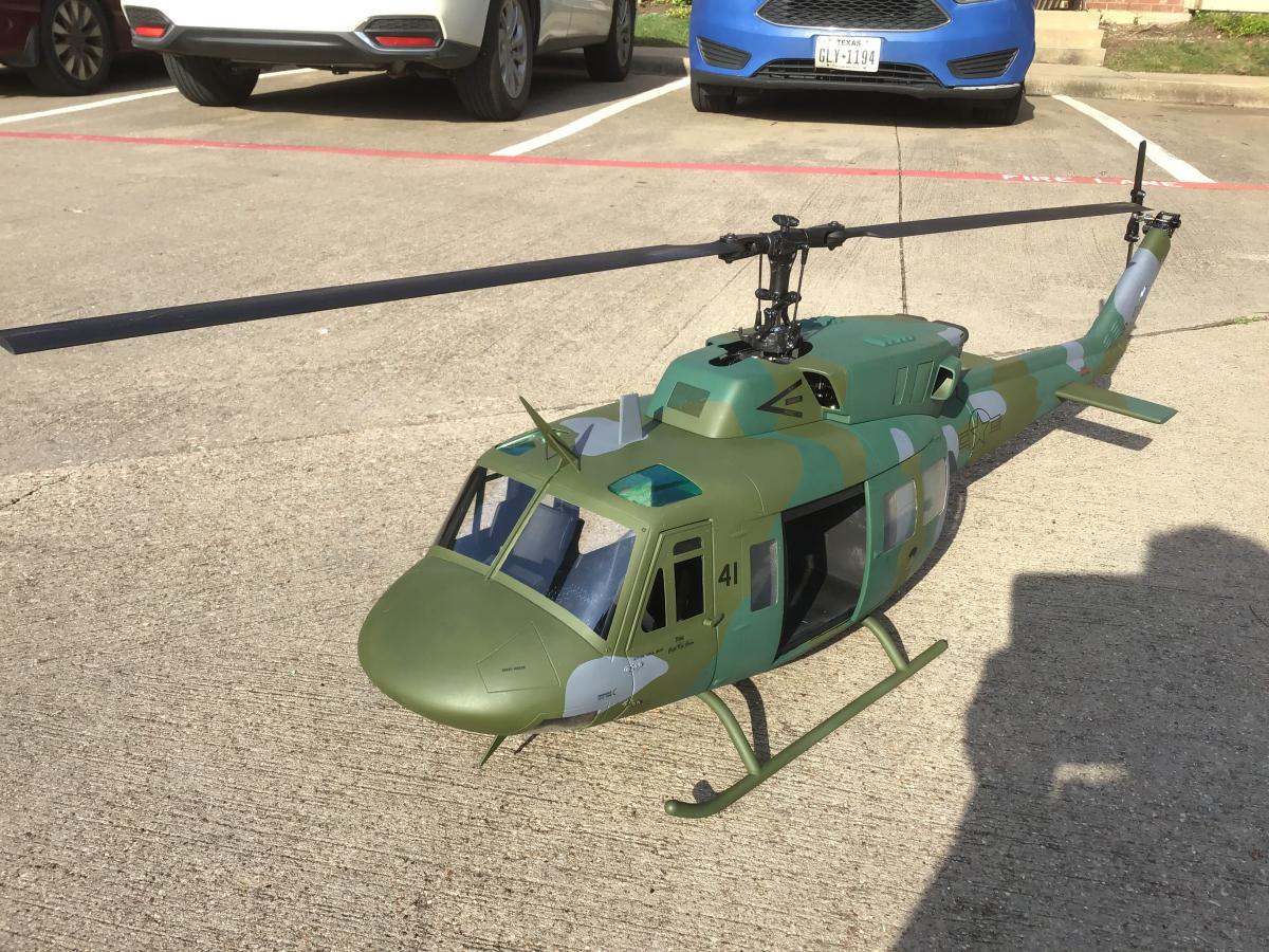

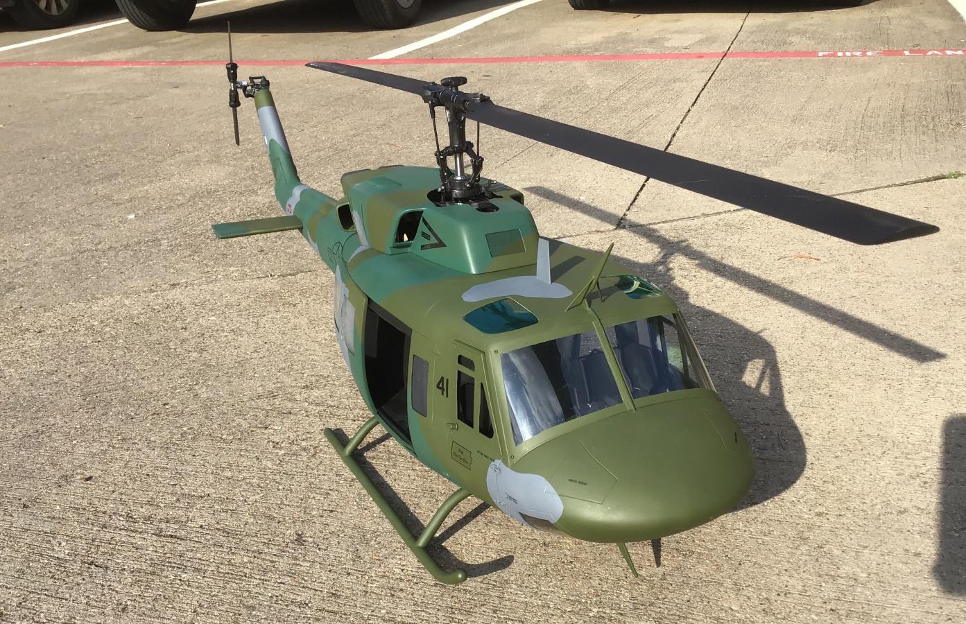

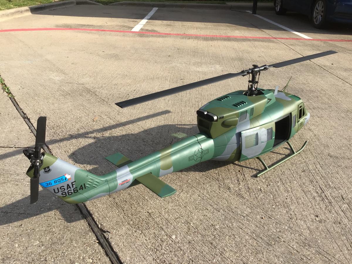

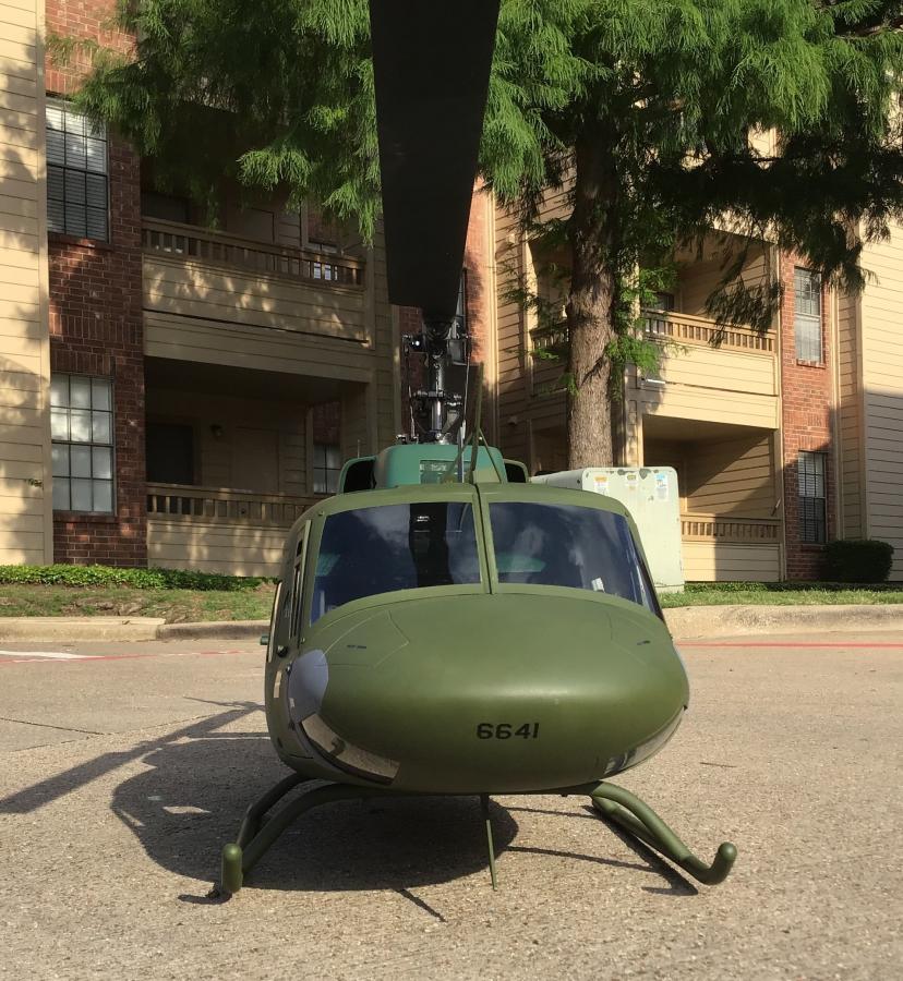

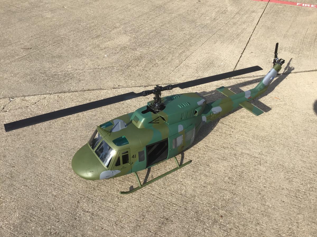

    Thanks Cyclone, it’s definitely been a rush to try to get it out (even for static) this weekend. I honestly think I’m maybe 50% through the build. I threw together the mechanics today, and will definitely need to completely redo them later. Also found a few issues with the servo linkage geometry that will require some rework. Anyways, after about 8 hrs of work today, here’s where it stands for static display:

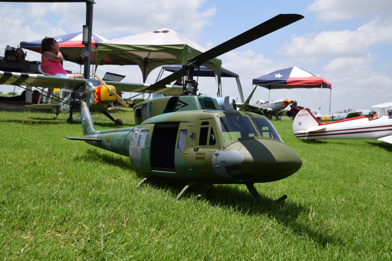

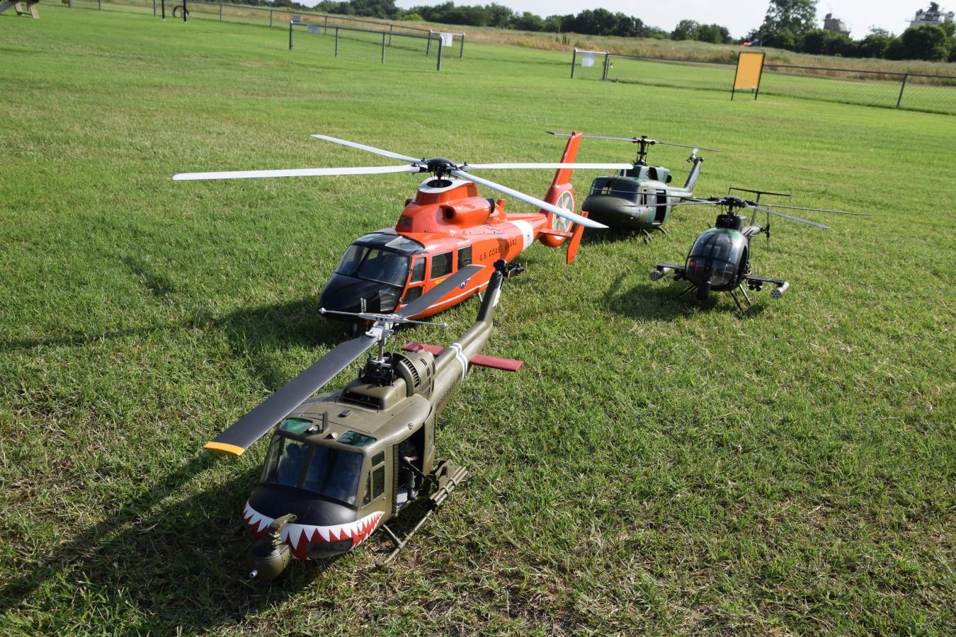

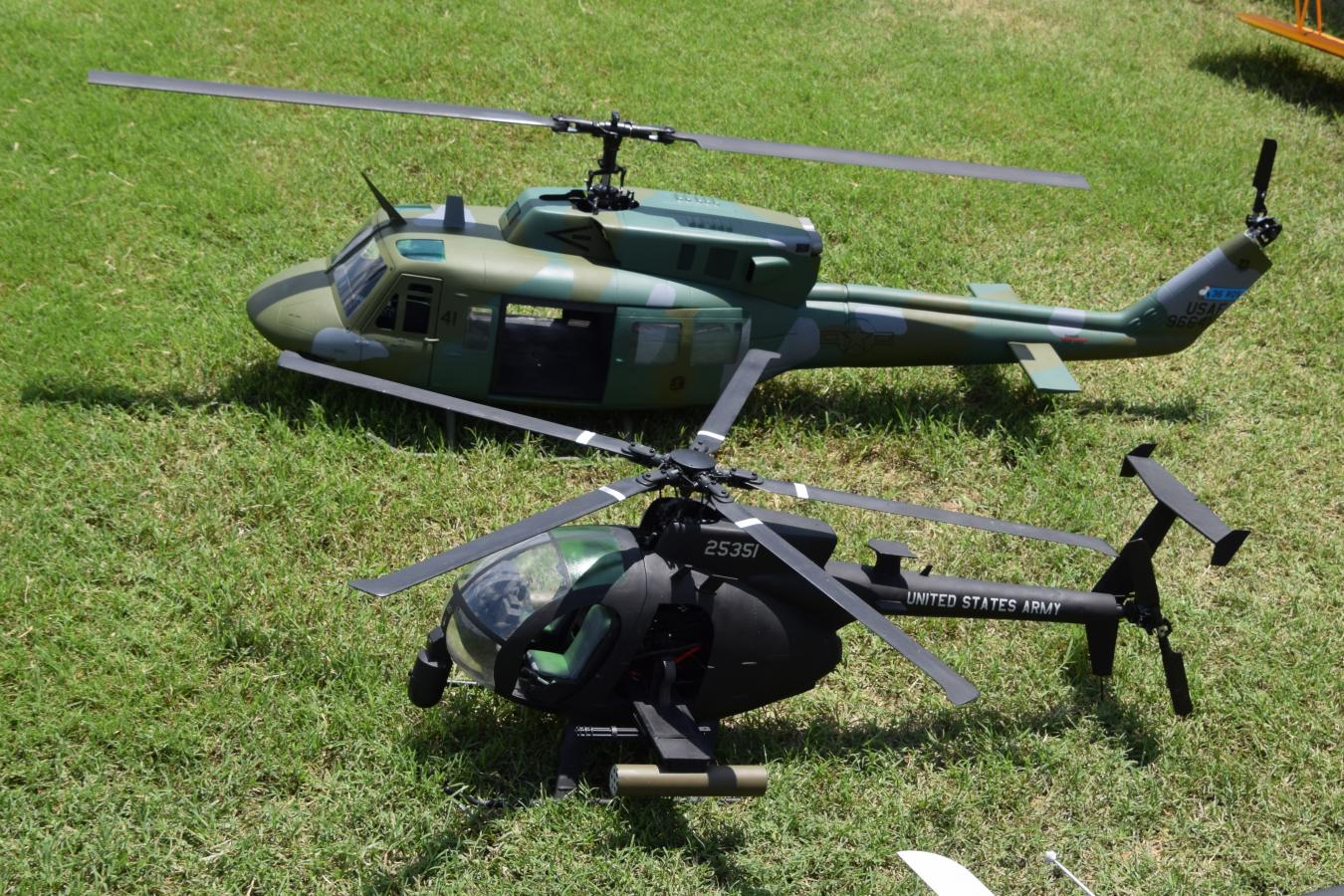

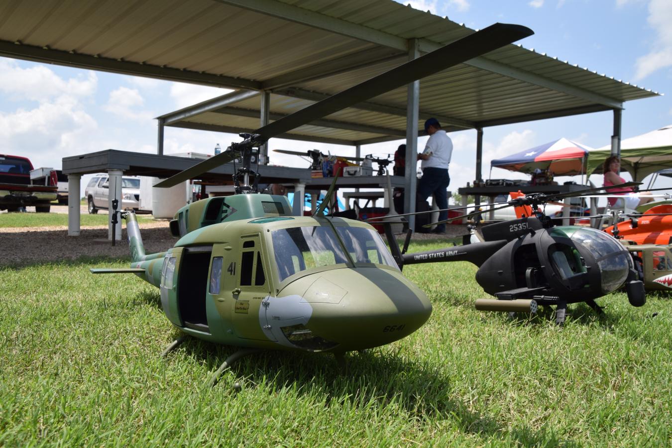

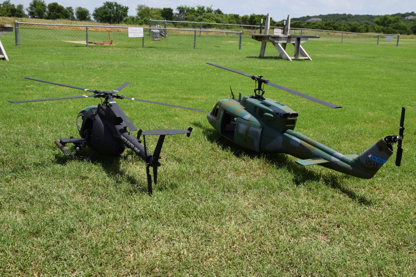

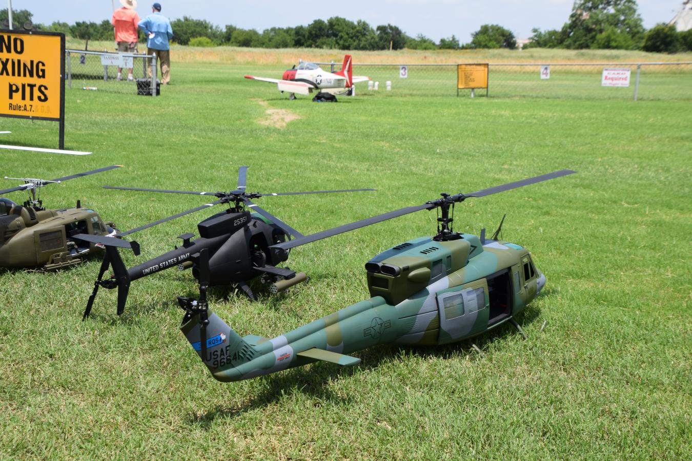

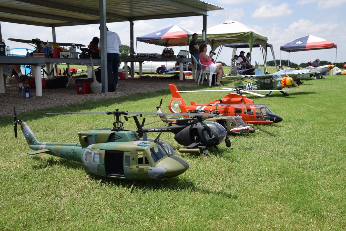

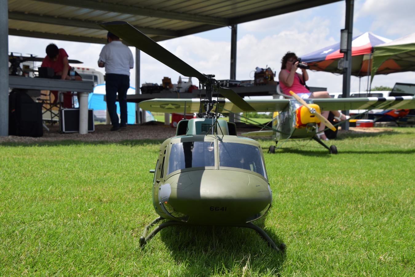

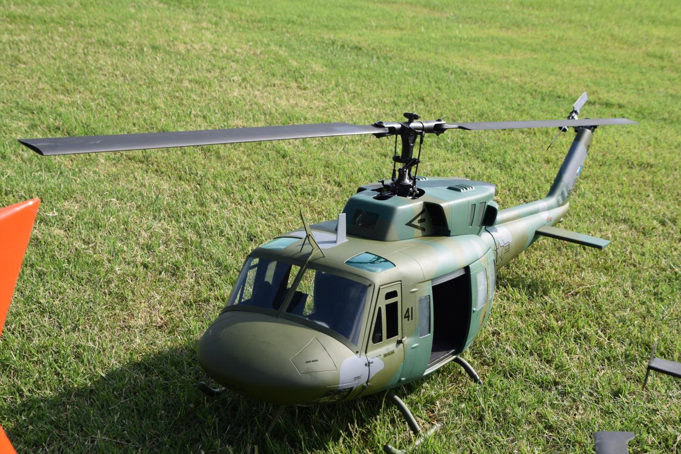

        So, I brought the UH-1N and the rest of the scale heli fleet out to the TX Scale Championships today, and it was great! Excellent weather, great people, and some incredible aircraft! Now just to get this machine finished!
