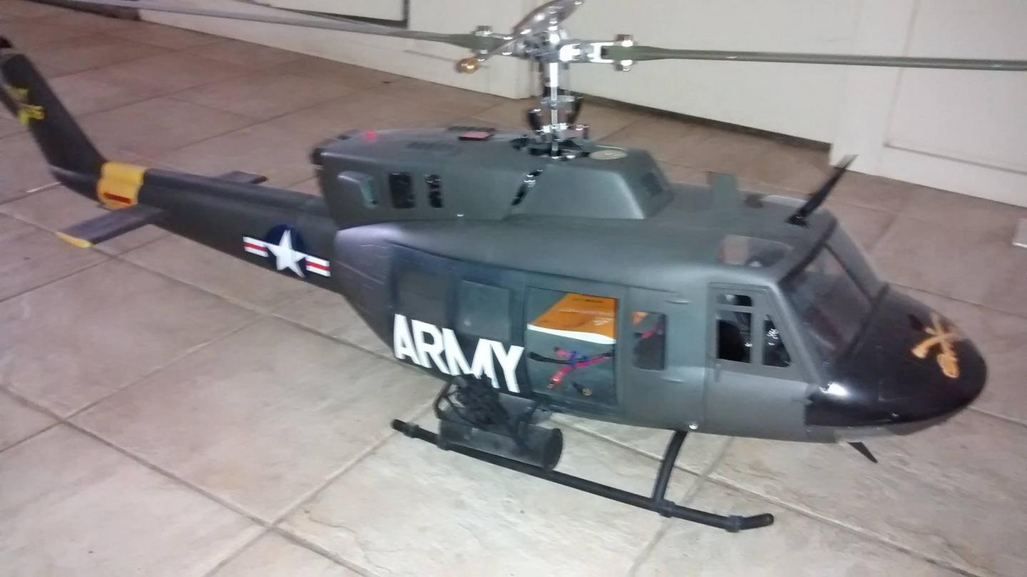

        This mine with a scale head.

          #44
          Any questions on your build, let me know.
