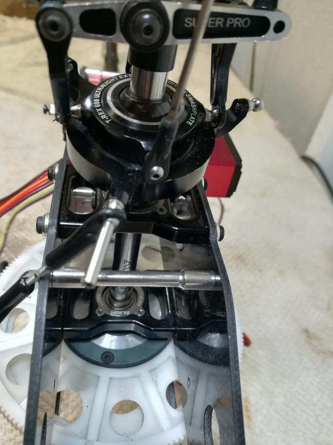

    I believe the spacers are for converting from the wider EFL or Pro versions of the Trex 600. If you used the ESP, you shouldn't need them. As for the umbrella gear, I moved to the bottom side after converting the one-way bearing for CCW rotation. Moving that umbrella gear keeps the tail rotating in the correct (and most efficient) direction when main gear rotation is reversed.

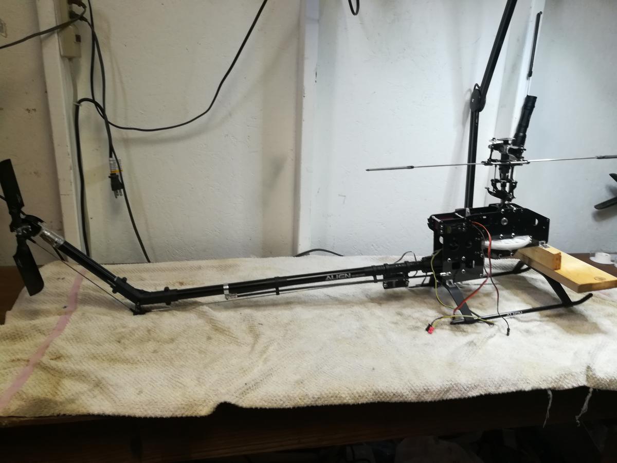

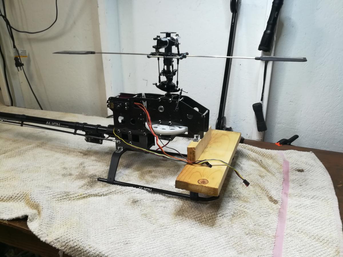

      Ok, I am trying to figure out something here, I bought the Roban 212 fuselage and using a Trex 600ESP, everything fit perfect and all that, I need to change my motor to a lower KV and realized my frames are 47mm and all the Scorpion motors I need and most other 600 size motors are 49mm and wider, so how did you get that Scorpion 1100 to fit in your frames, you have the Chaos 600?? which has wider frames and you bought the ARF bundle, correct?? I have the same spacers and all that like yours but is yours a whole different set of wider spacers?? I thought we would have the same spacing but maybe not. I can't fit any motors over 47mm, I just found this out this morning when I went to order my motor. Thanks
      Might be time to do some cutting on my frames..............

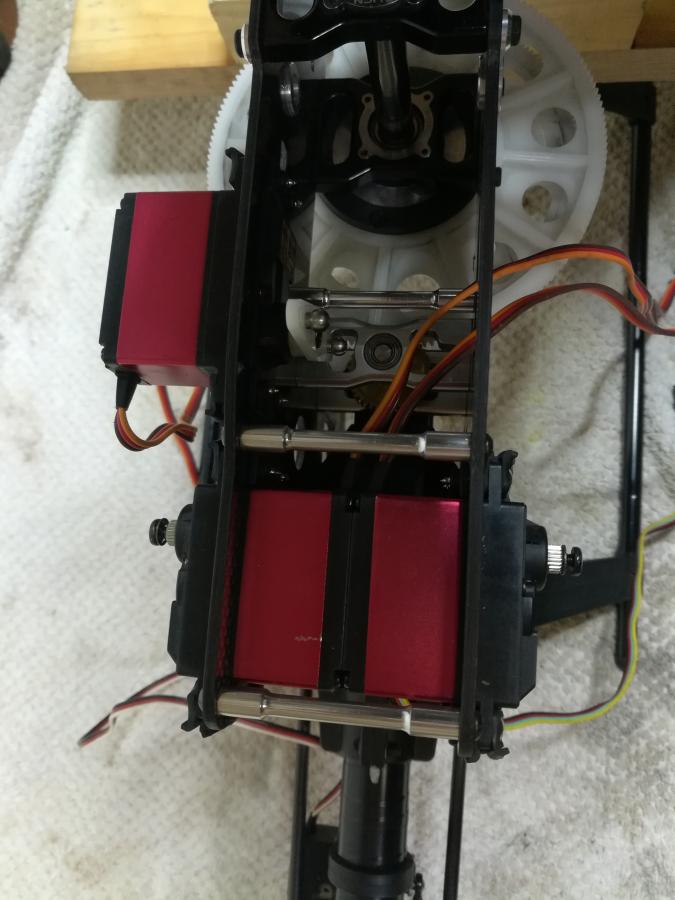

        The Chaos 600 is a clone of the EFL, so I have the wider frames on mine than the ESP. I had some spacers (only a few) included with the initial kit, but most were missing. After contacting customer support, they ended up sending me a full spacer kit that worked excellent.

          Okay, that is what I thought, still confused about the spacers, so your kit has the same parts as mine but yours came with wider spacers and bearing blocks? So on my kit conversion, all my spacers and bearing blocks were only 47" wide, I can't use the motors that are 49", now I got a problem trying to find a 1100 kv heli motor that will fit inside my frames. its like they made two different sets of spacers and bearing blocks.

            Yes, my bearing blocks and spacers were around 10mm wider than the ESP, using those parts from the Chaos kit. Can you dremel out a bit more space in the frames to accommodate a larger motor? I’ve had to do that on a few smaller builds.
