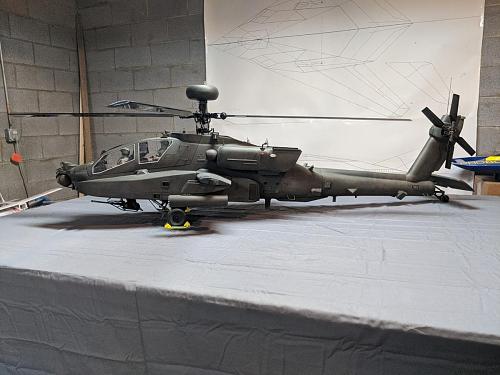

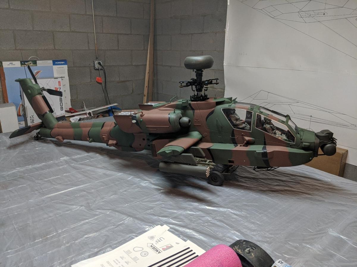

    All back together now and waiting on a 3 color NATO paint scheme.

      That is premier level, Steve! It looks so great just sitting there, chocks and all. I can't wait to see the finished result. Are you in the paint booth right now? Color me Impatient.

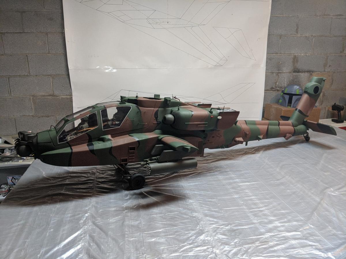

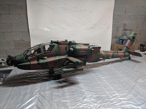

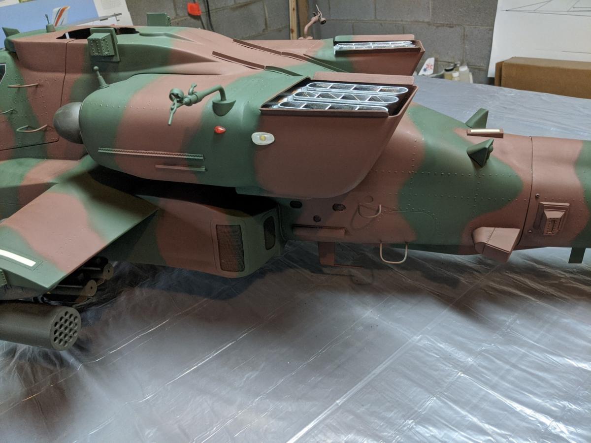

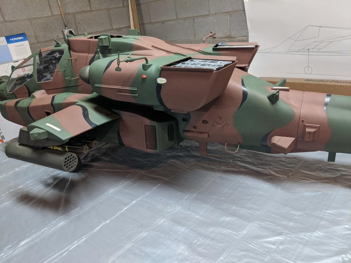

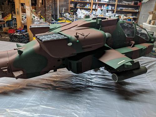

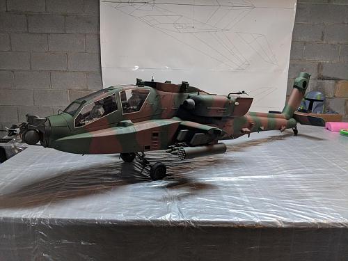

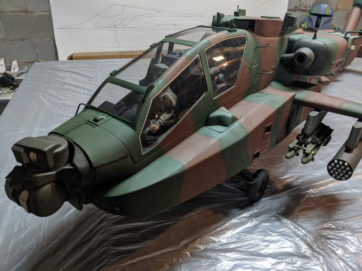

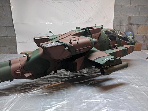

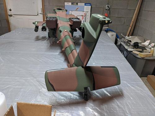

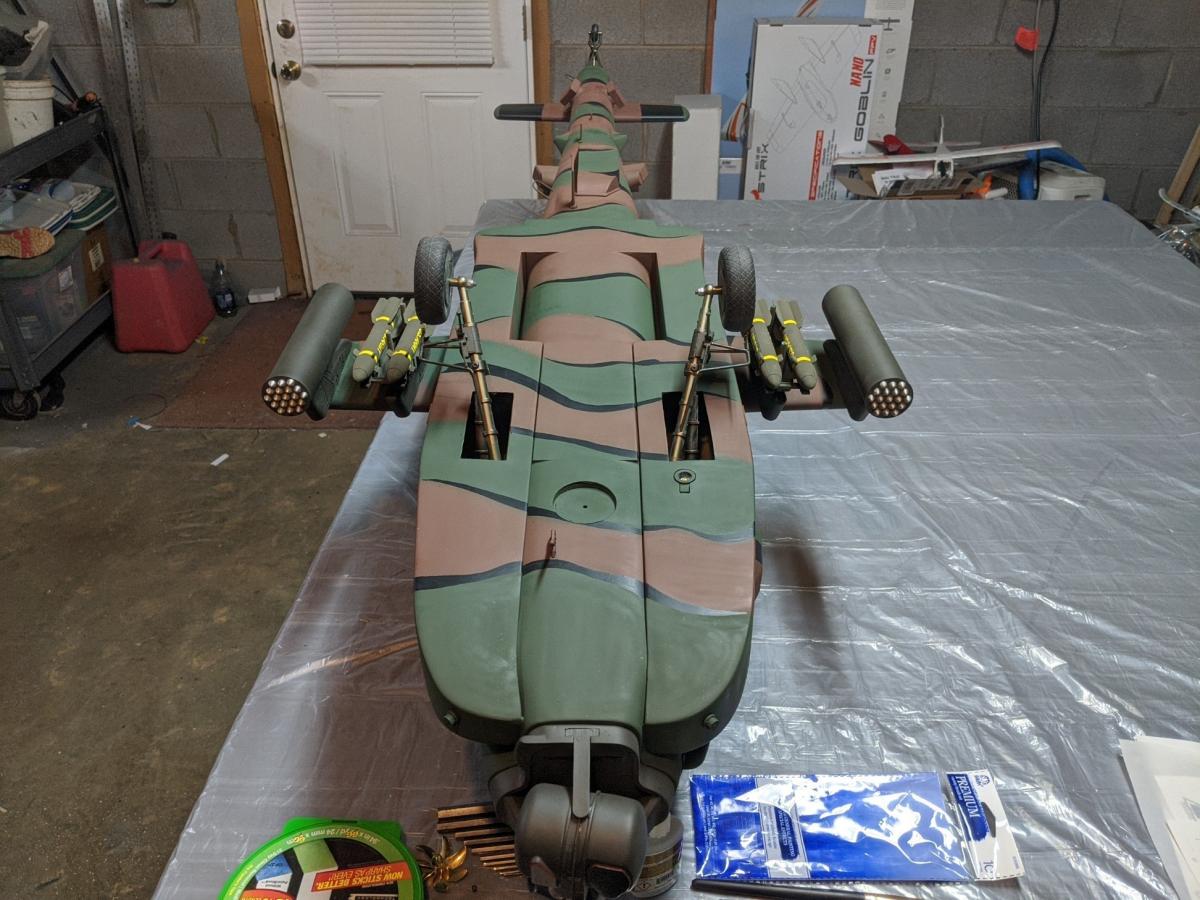

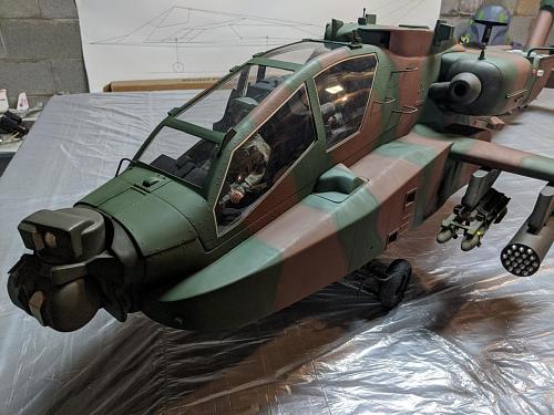

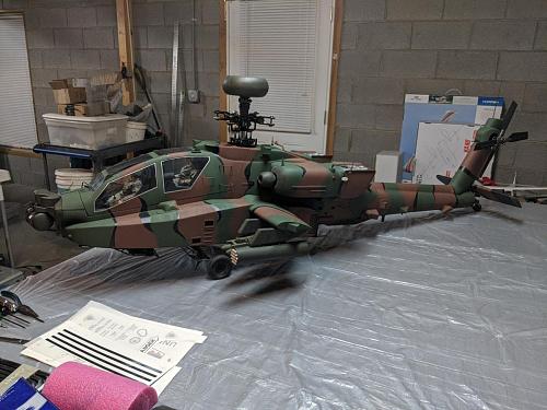

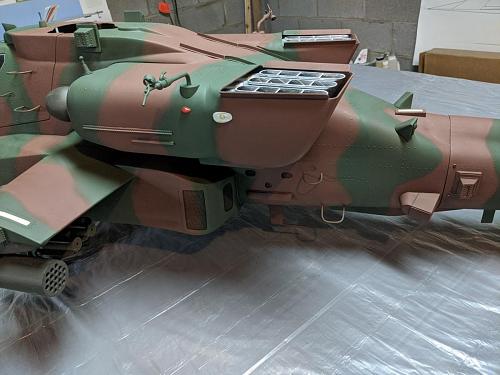

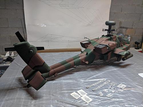

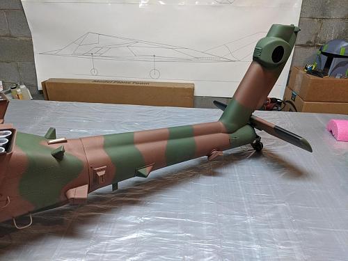

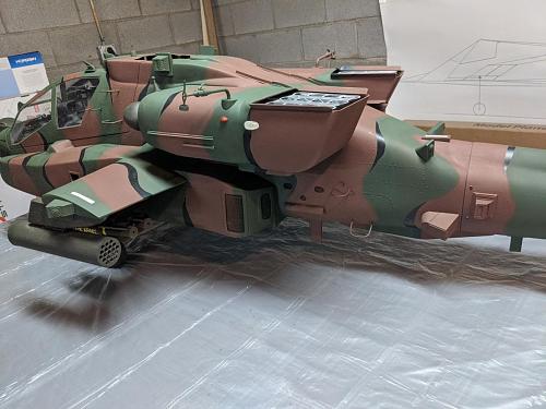

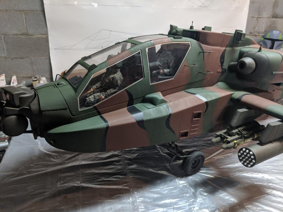

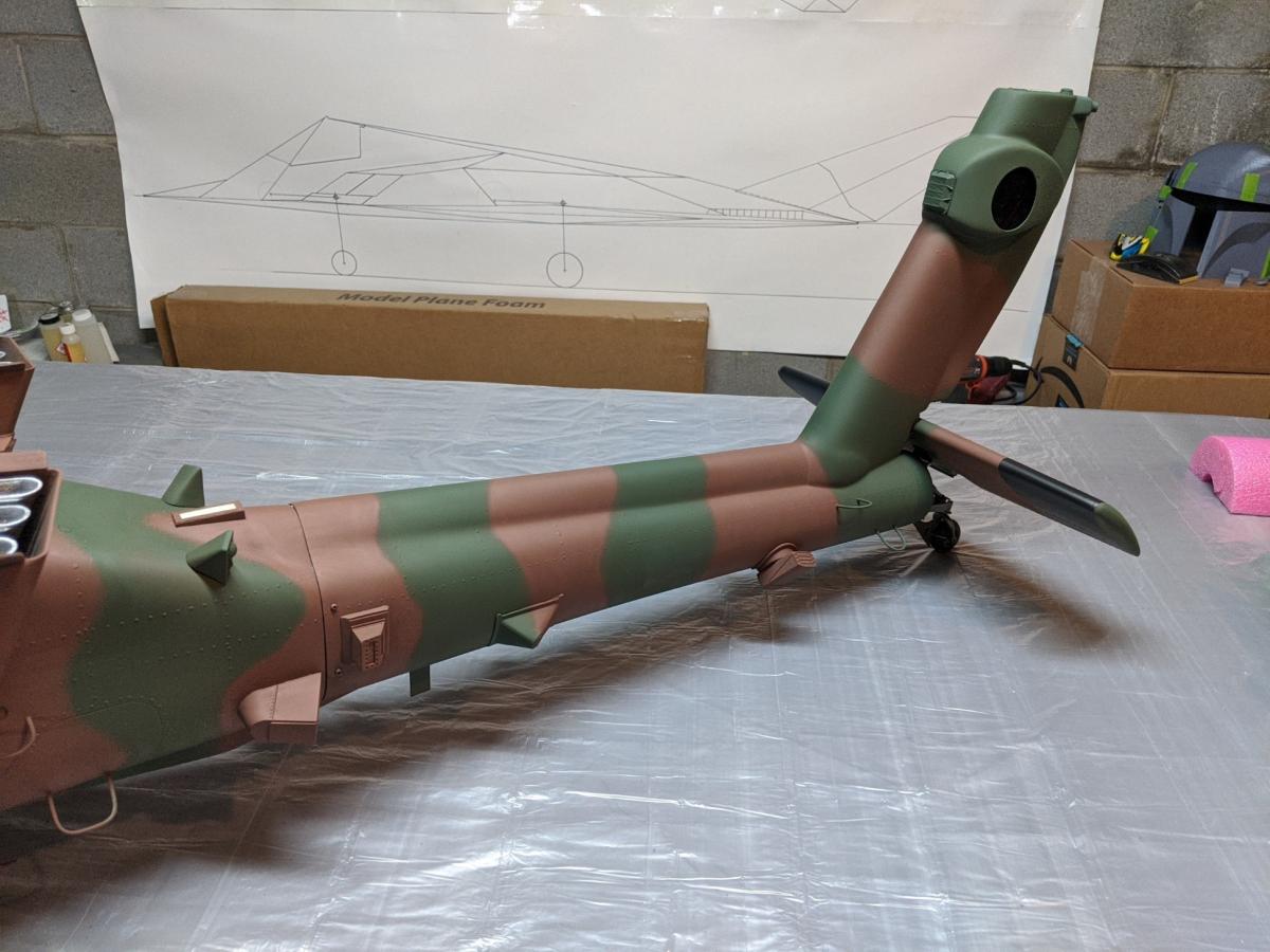

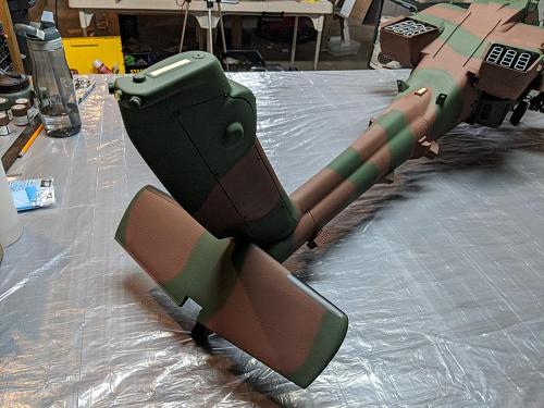

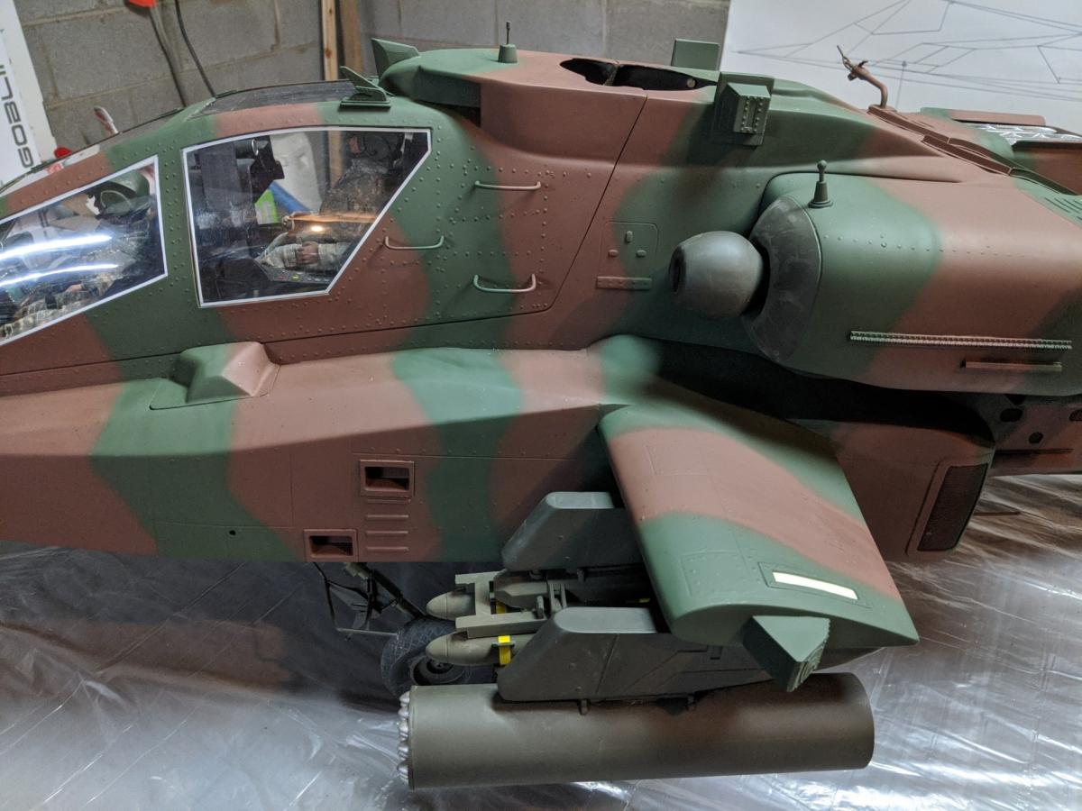

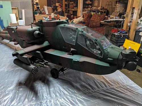

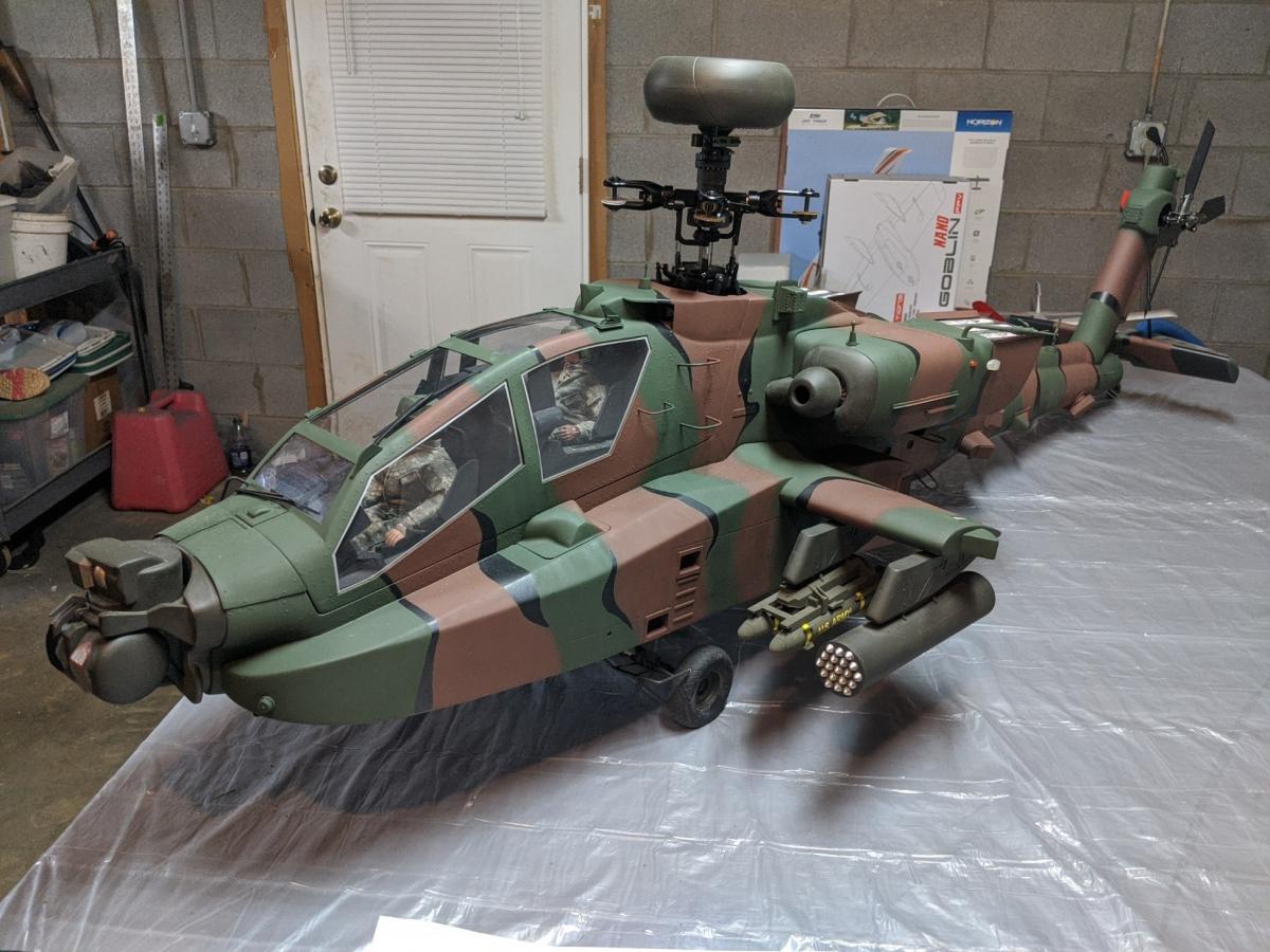

                  I finished with the base camo paint. Next is the black accent stripes. It's really looking good. Paint is Tamiya NATO Brown and NATO Green Acrylics free-handed through an airbrush.

                        Bang up ! Nice tight borders on that free hand airbrush camo. Keep going !

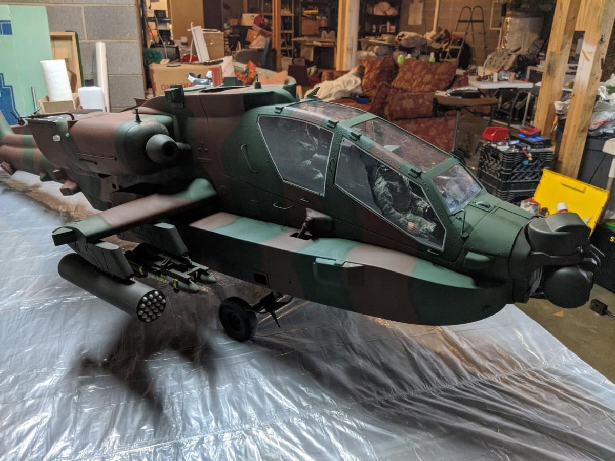

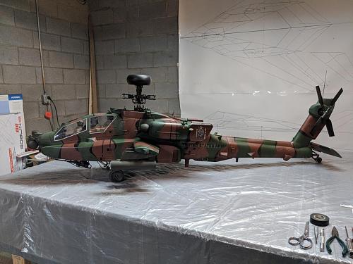

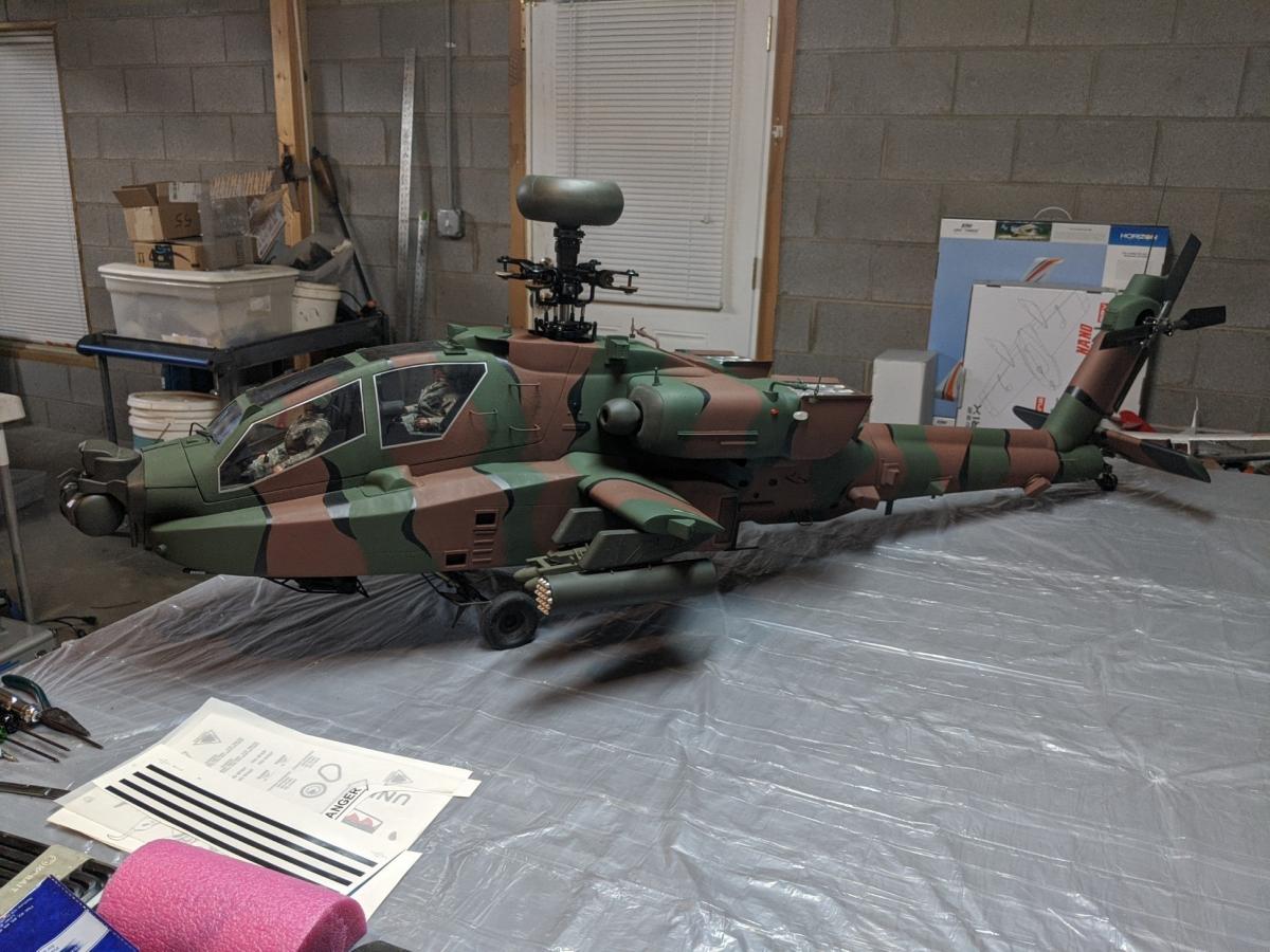

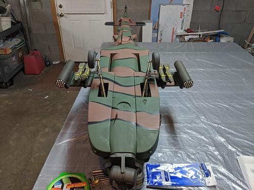

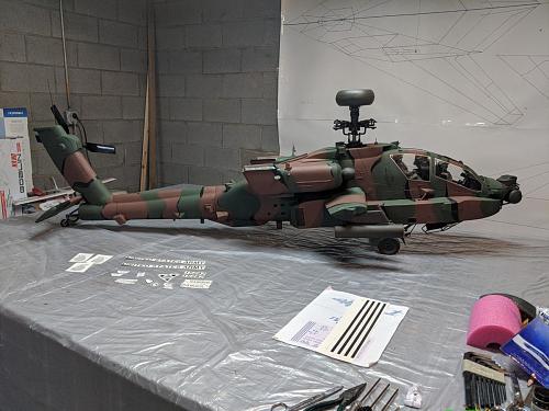

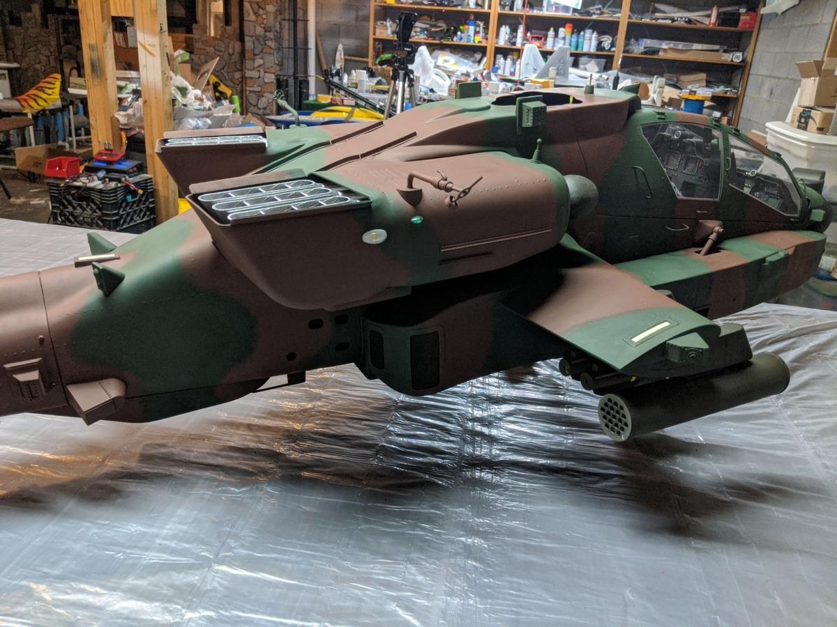

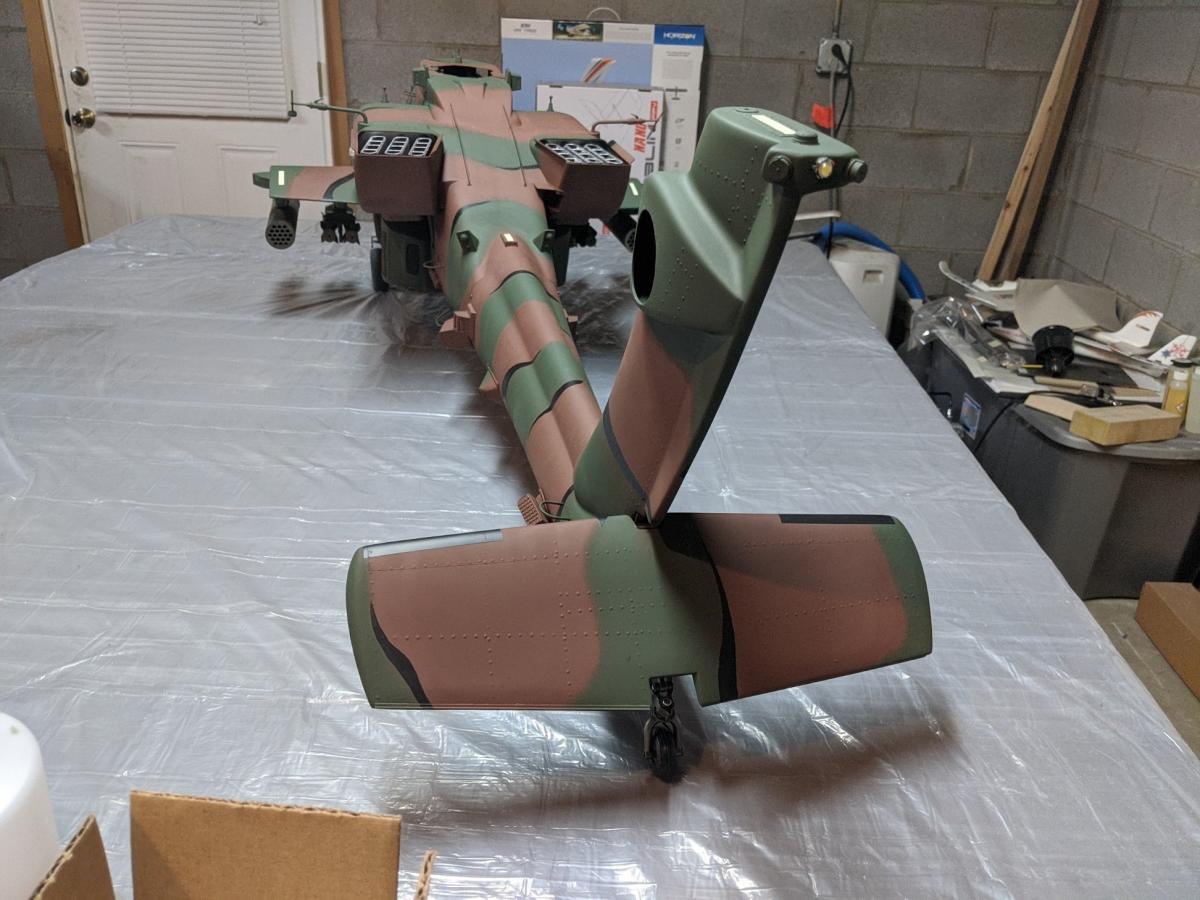

                          The black stripes really help it to 'pop'!

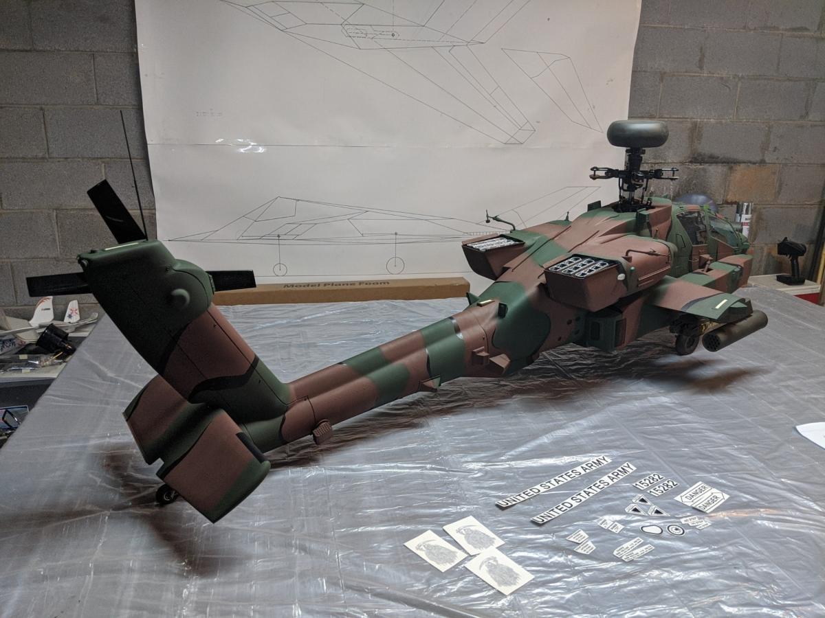

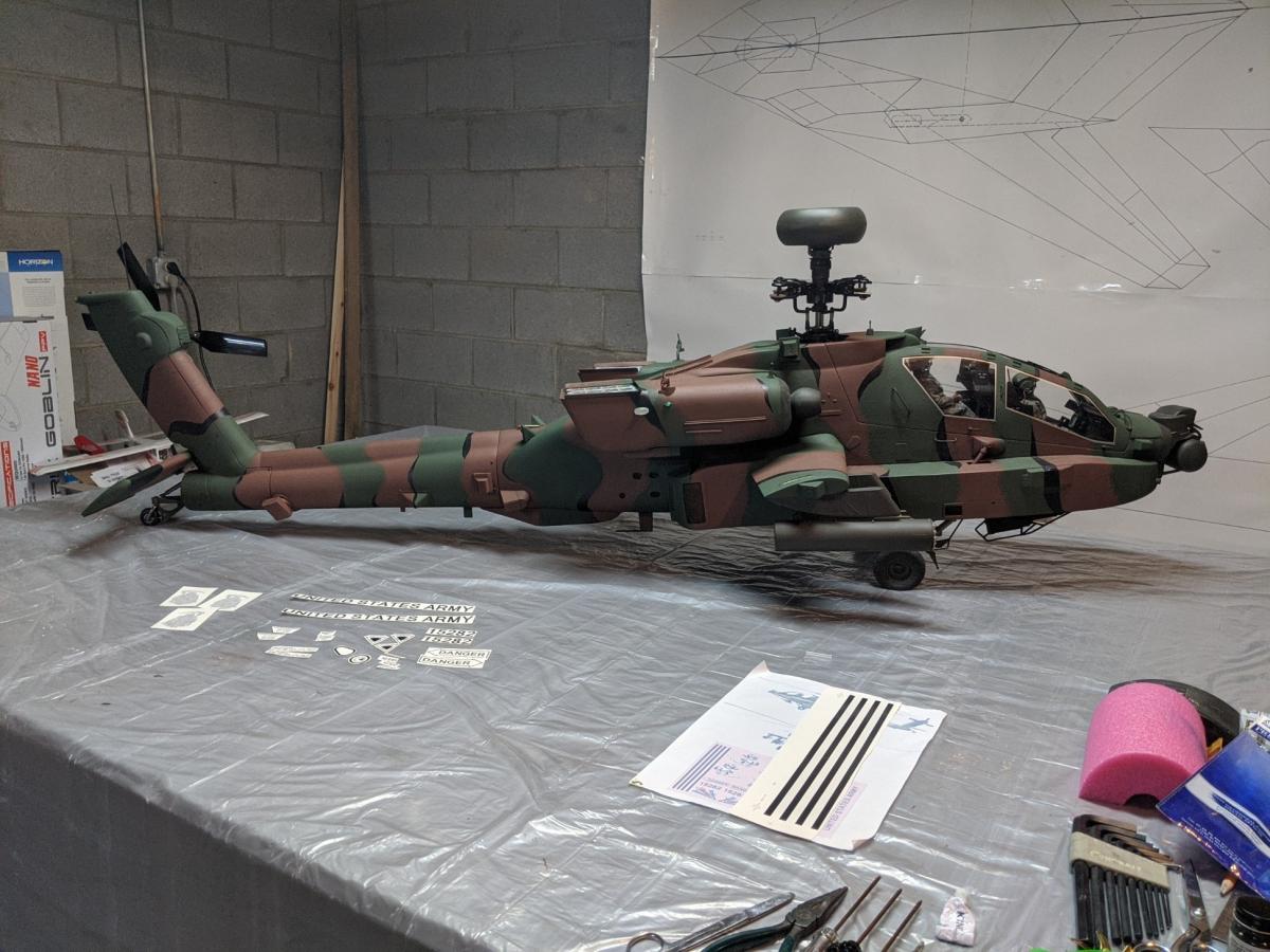

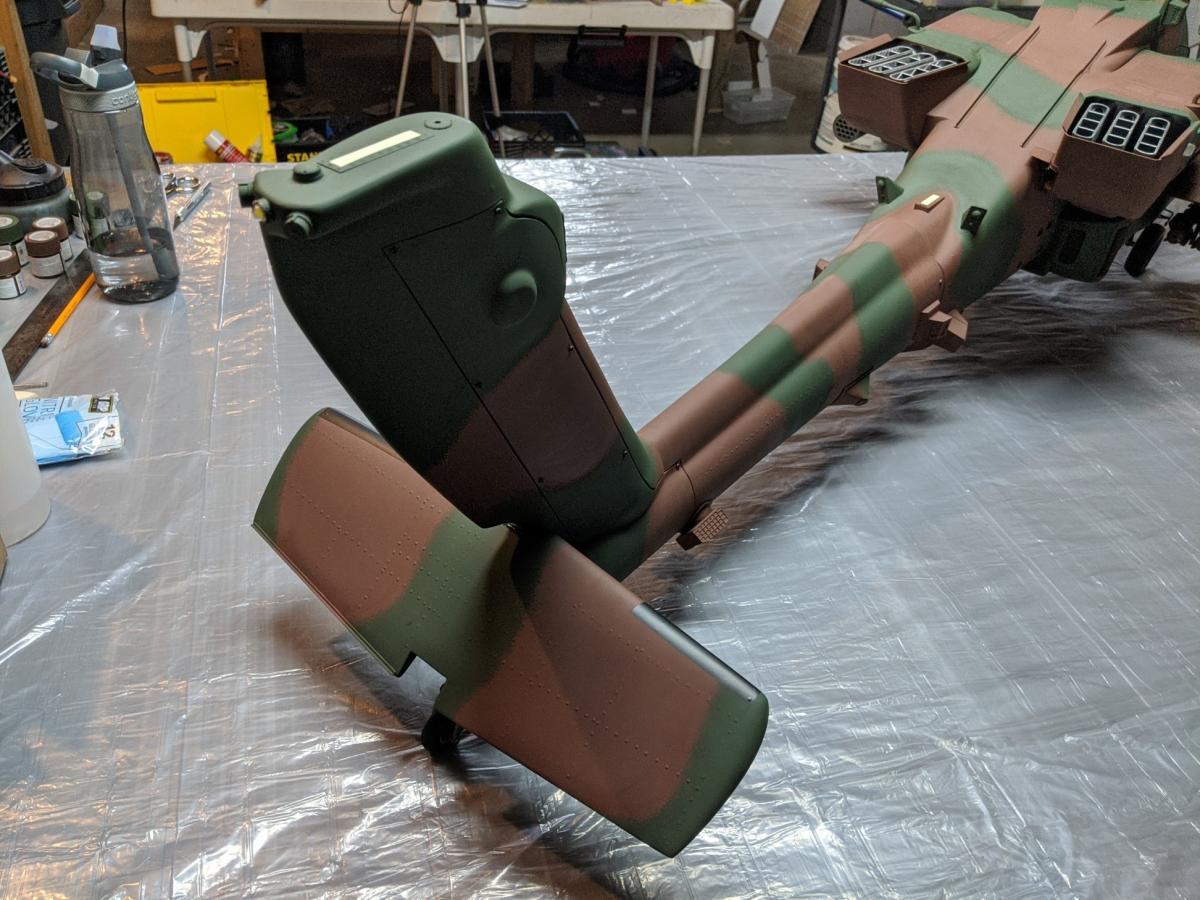

                              All the stripes are done. Now for some graphics, finally....

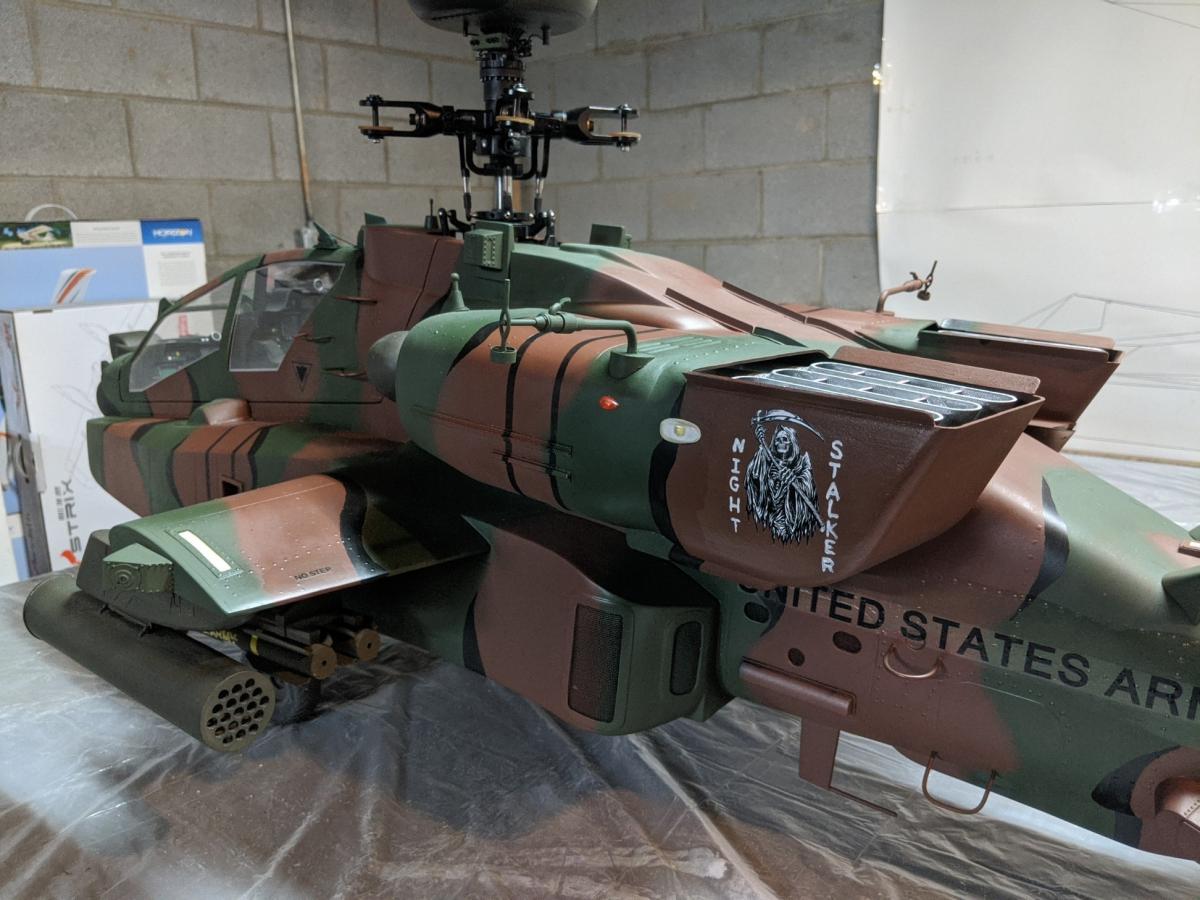

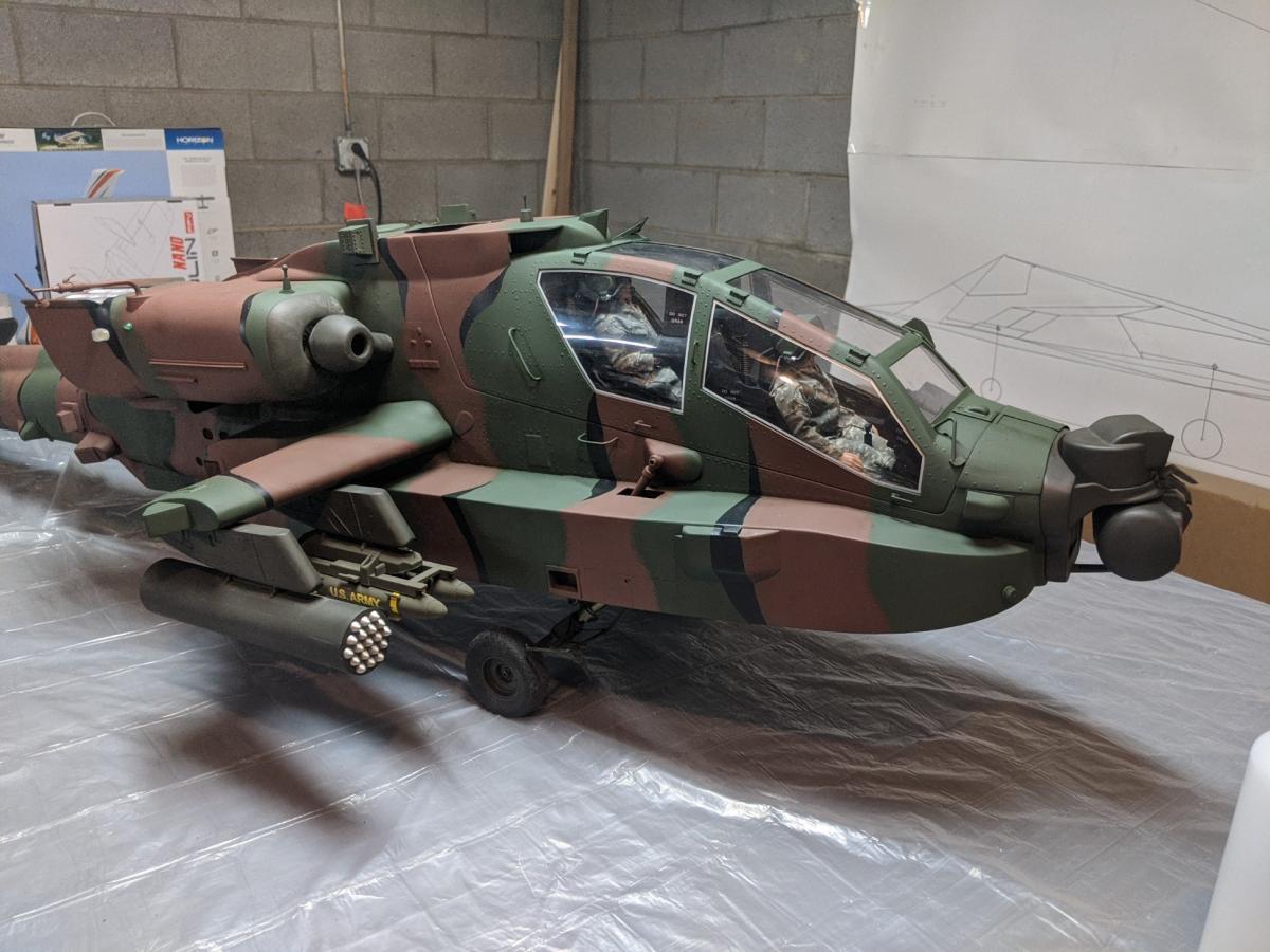

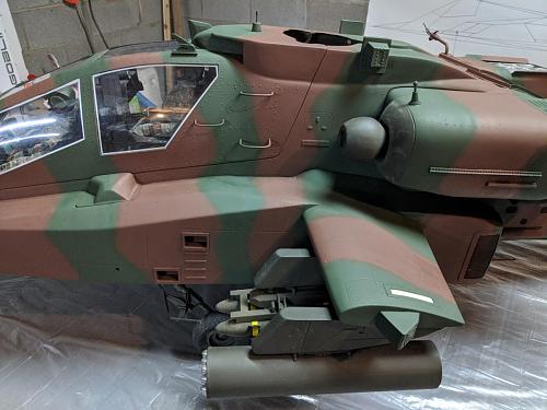

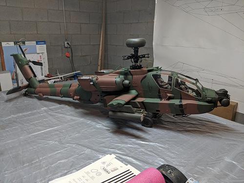

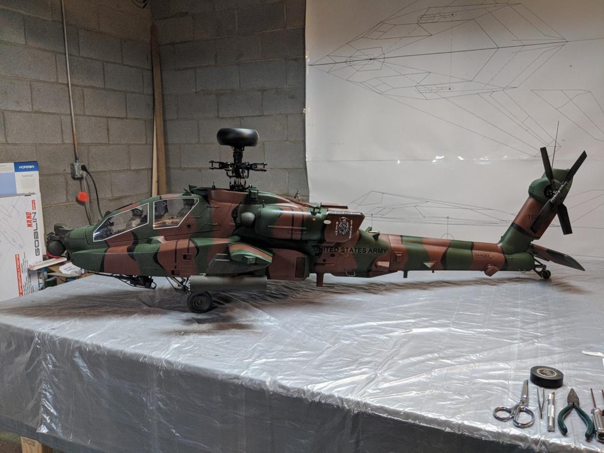

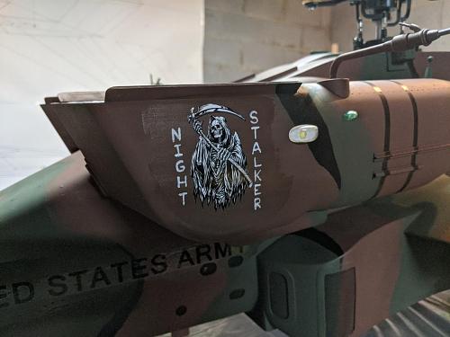

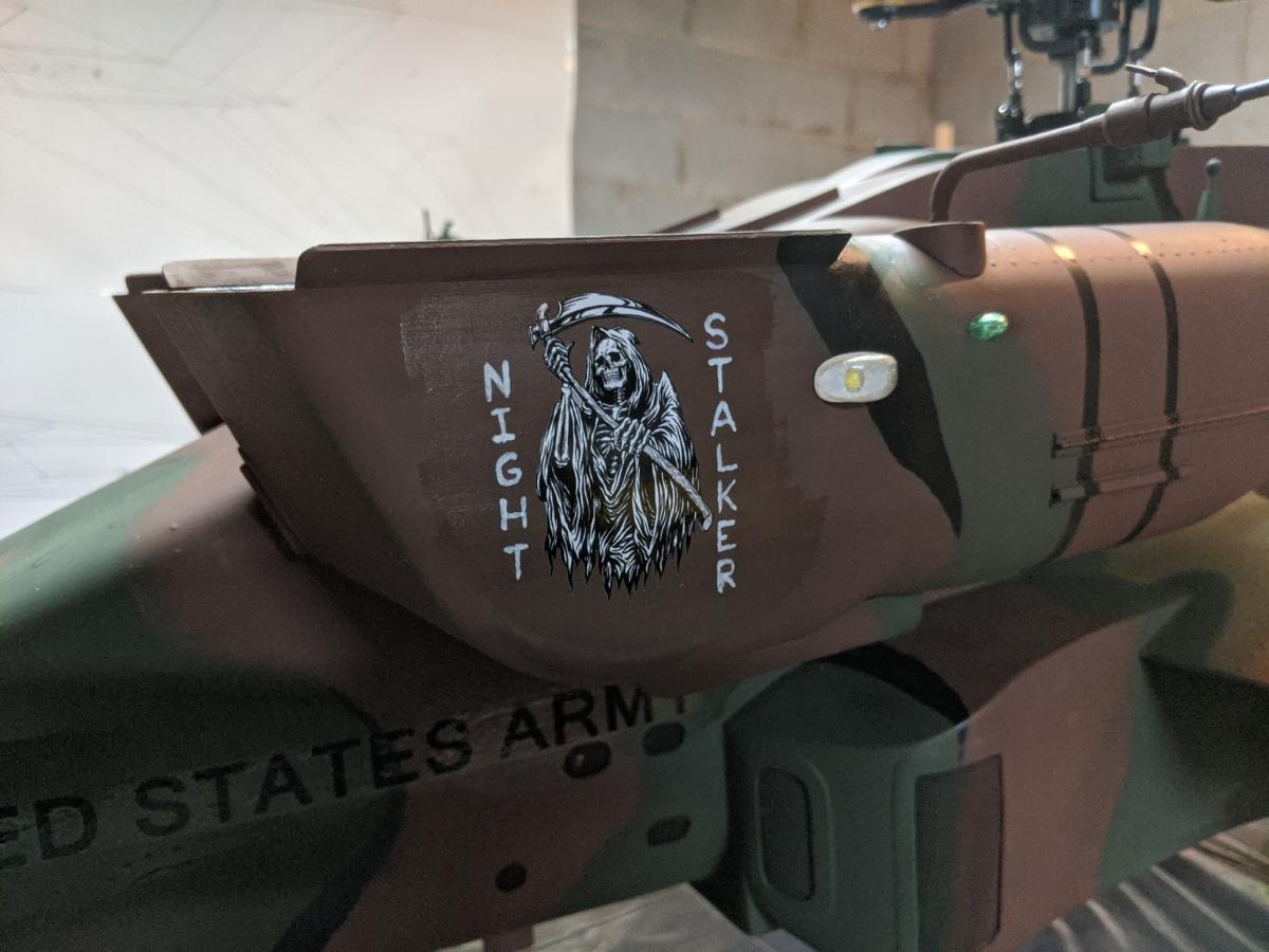

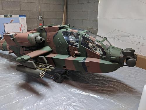

                                    Ok. Not terribly happy with how the waterslides turned out that came in the kit. I should have used some decal setting solution but live and learn. I am calling it done on paint. May do some weathering still but all in all it looks good. Now if that helical main gear would just show up.

                                    • #98
                                      I know what you mean about the water slide decals, I tried to put them on my AH-6, not so good, the next morning, they peeled right back off, sent an email to Callie with measurements and she came through with some nice ones, can't wait to see how they look, hope yours stay on your Apache, makes it really look great.
                                      • #99
                                        What if you went over the whole thing with some matte clear coat to capture the decals ? Looks great btw.
                                        • Originally posted by RCjetdude View Post
                                          Ok. Not terribly happy with how the waterslides turned out that came in the kit. I should have used some decal setting solution.]
                                          RCJD, You can still use a setting solution. Micro-Scale "Micro Sol" is applied after a decal is on the model. It will soften the decal and as it dries it will 'settle' onto the surface and minimize the 'silvering' you are experiencing. You can keep applying it, too, though it will be pretty much a 'one side at a time' task since it is best to let it lay it on a flat surface and allowed to dry thoroughly. It works, just takes time. Best, LB
