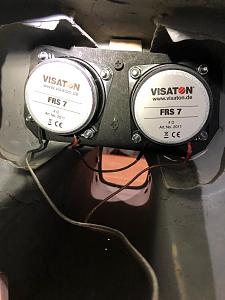

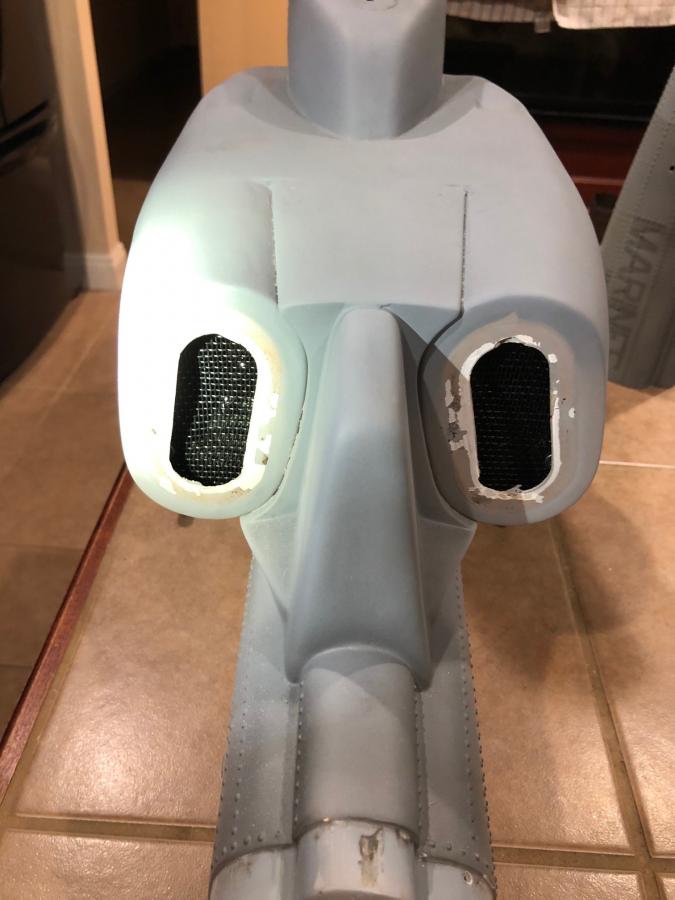

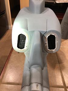

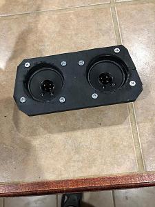

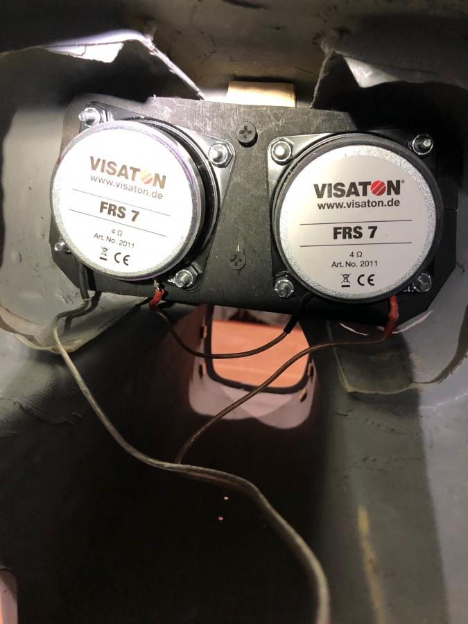

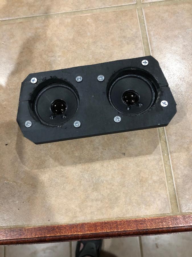

          This is the route I'm going with my cobra... So far I'm liking it...

            sfcfury, Very Clever, Sir. Well done. Best, LB

              Those look like they should work very well.

                Thanks, I watch all of you guys doing hella cool stuff!! Great ideas and awesome work here in the forums... and sorry I didn't want to re direct anything from your awesome Apache! I really like your idea of the depron foam and exciters, but I had already purchased these speakers... and was determined to use them. I can't believe there's not a cobra page! I guess I should start one, but I don't really take alot of build pictures.. or do much 'mods'.
