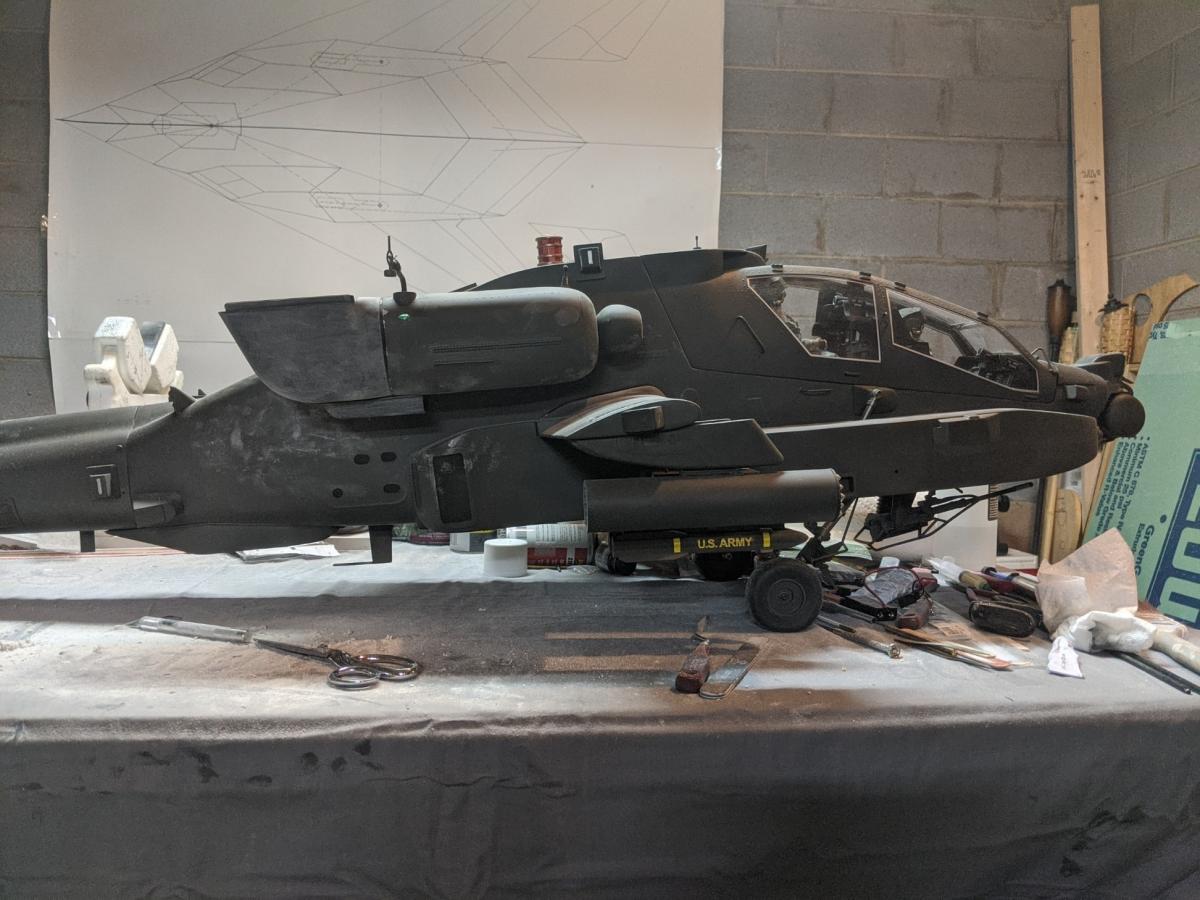

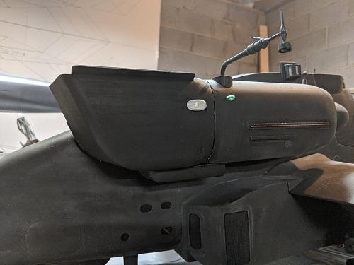

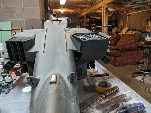

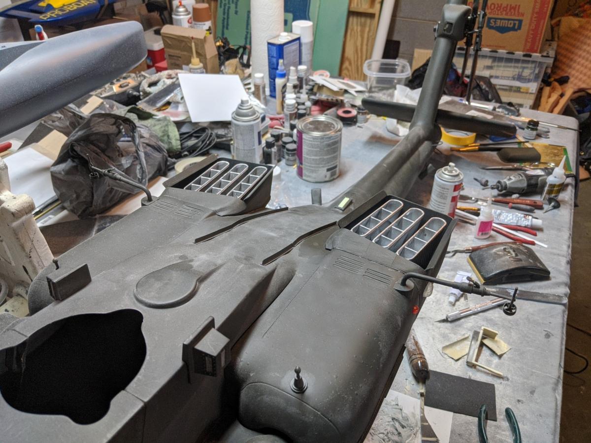

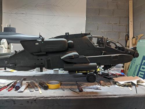

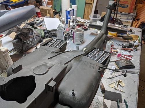

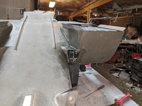

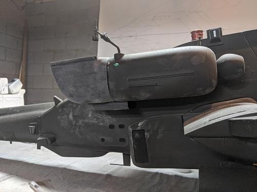

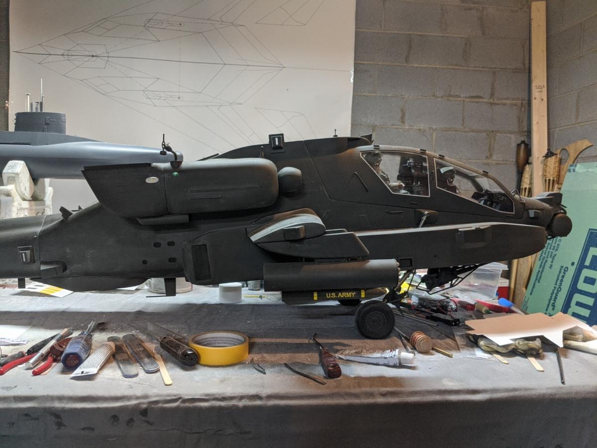

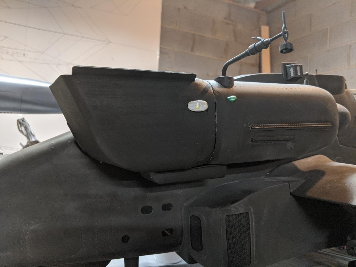

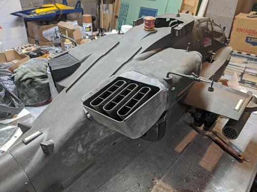

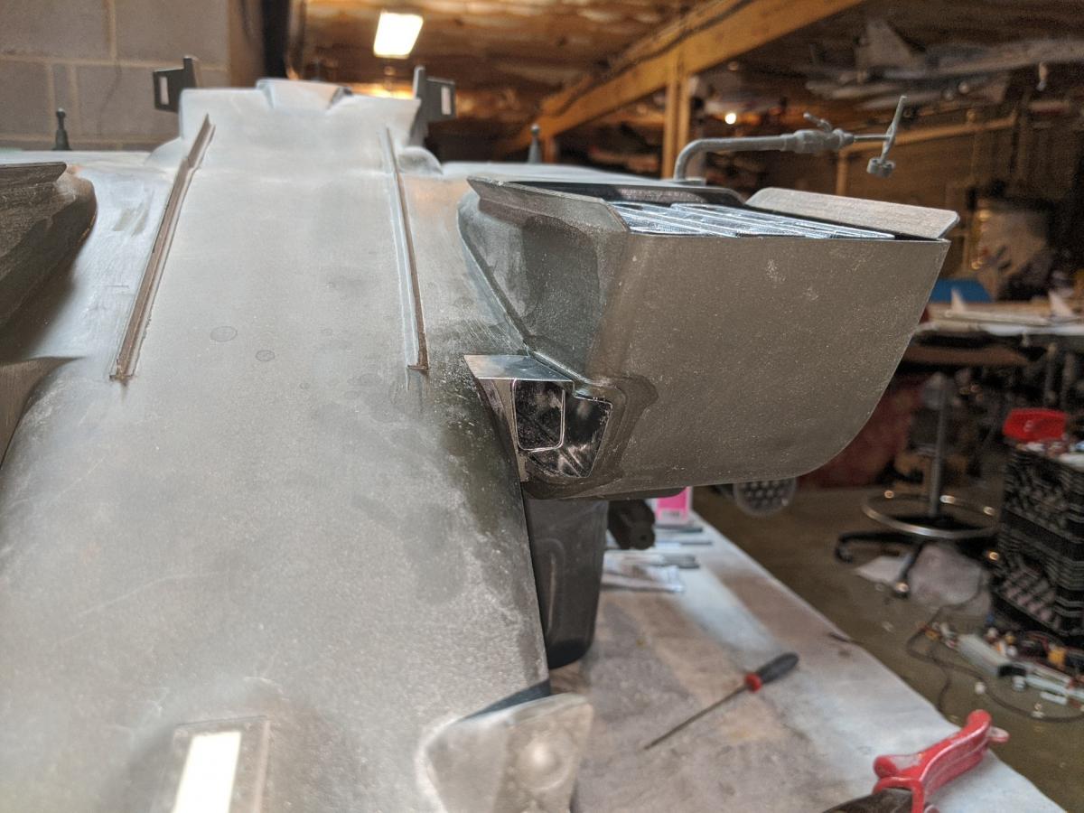

              Scaleflying.de got in more helical main gears so a I have one on the way. Working on the latest mod to add the up turned engine exhausts. They were designed by Michael Brown and printed in ABS. They fit perfectly!!! One side down, one to go.

                #67
                Merry Christmas bro
                  #68
                  Just loving the details!!! Very cool!
                    #69
                    Merry Christmas to you too!
                      #70

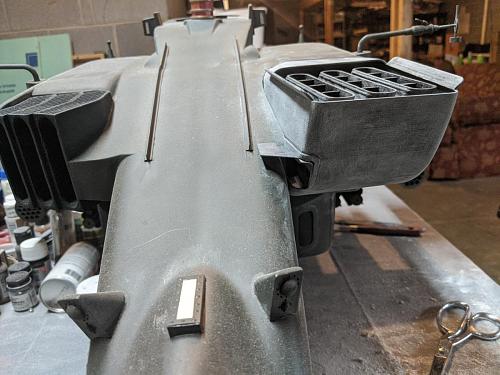

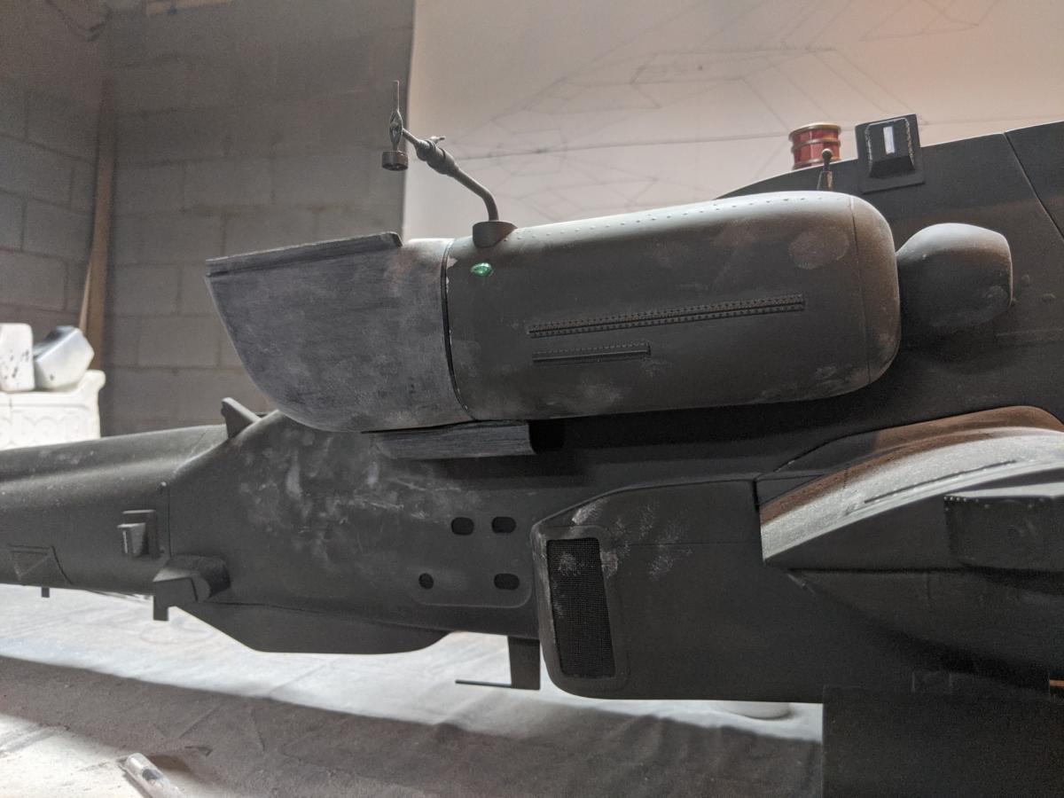

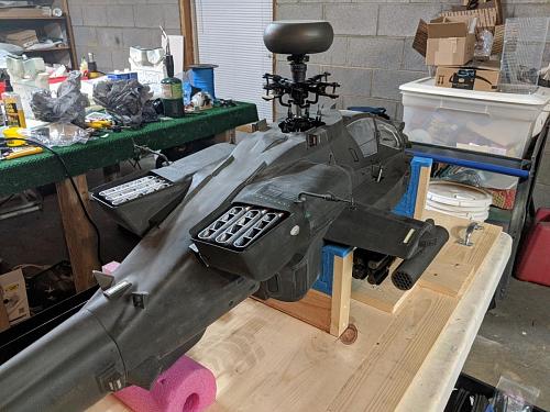

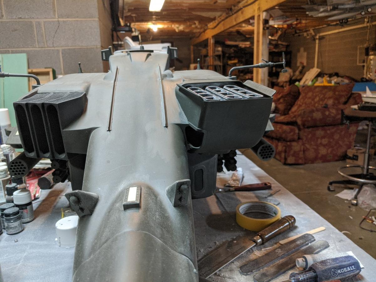

                      Right side is done.
                        #71
                        That changes the bird's entire look, I really like it and it blends well!
                          #72
                          Michael did a great job with the CAD work. He is working on his own Apache and scanned the fuse in to accomplish this. They turned out great! His son works on the E models and has been able to provide lots of good pictures. I am his guinea pig and have provided some feedback on a couple small items. I am not aware of another RC Apache out there with these exhausts but this is what they are all going to if not already. Once I get the other side done I will be able to start working on the 3 color NATO camo paint scheme. I need to decide if I am going to articulate the gun and MTADS, add bearings to all the wheels and make the tail wheel pivot. I have an idea of how to lock it in flight and it would be neat to be able to taxi it around. Still thinking on those mods.

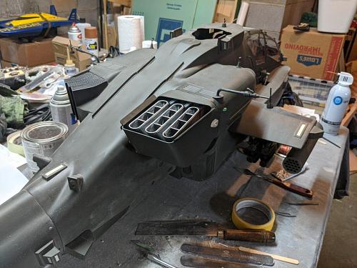

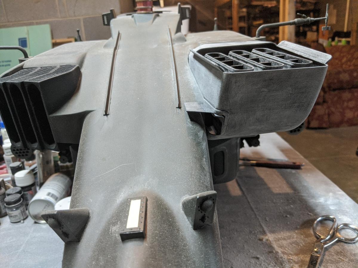

                            #73

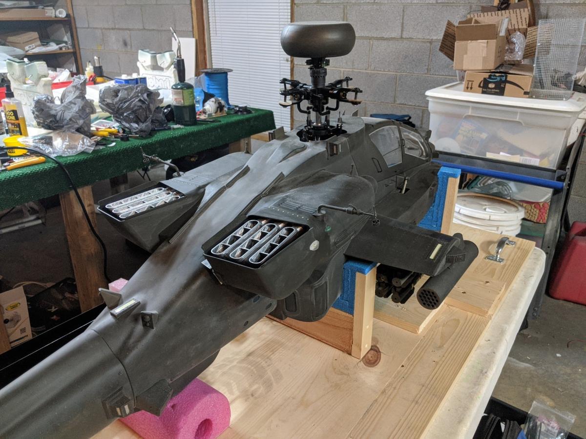

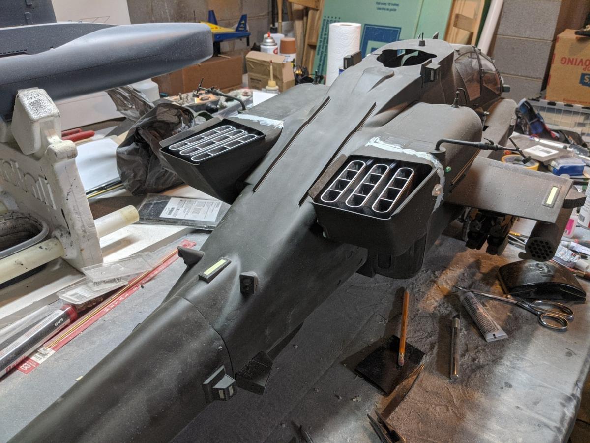

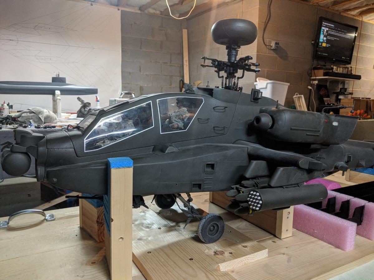

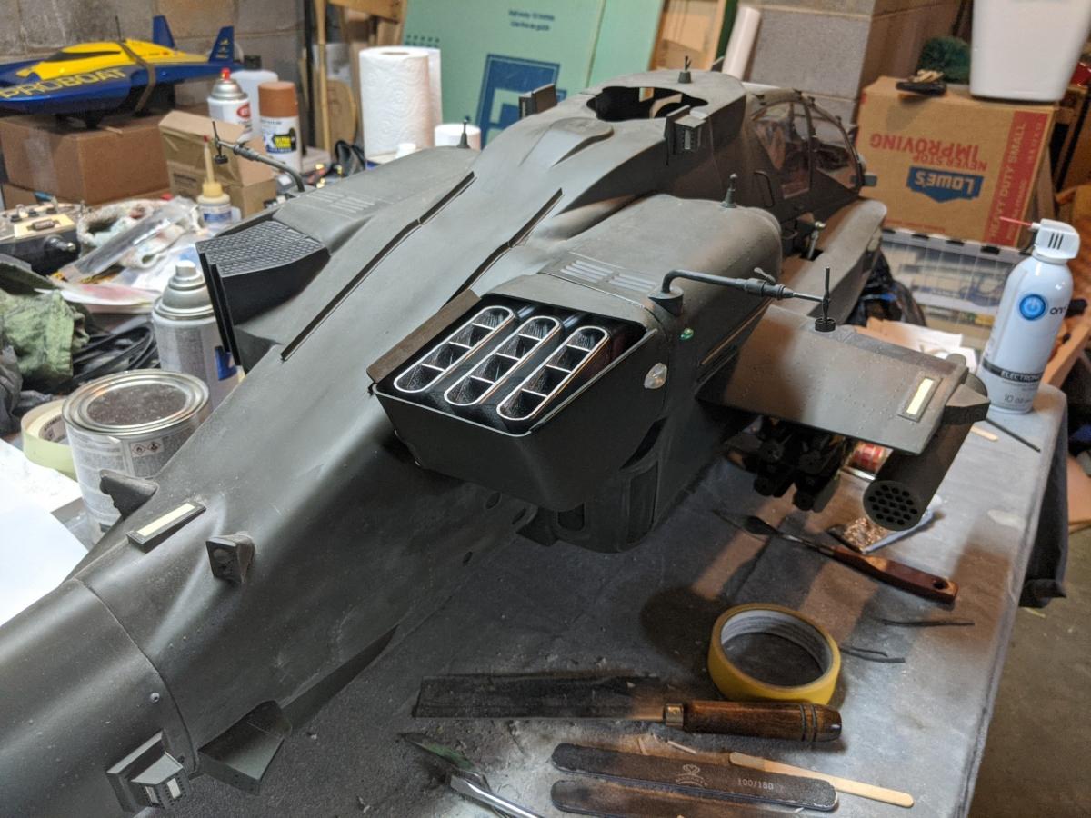

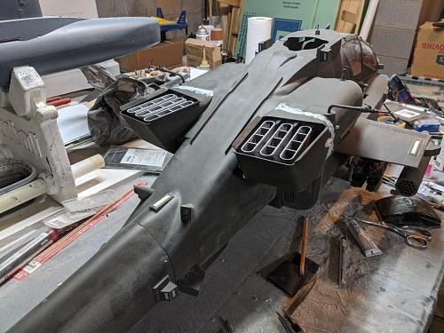

                            Almost done.

                            • Aces

                                  #76

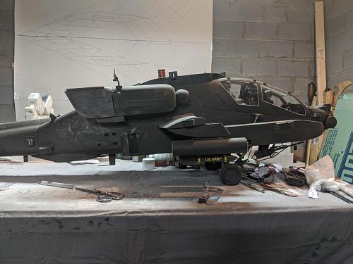

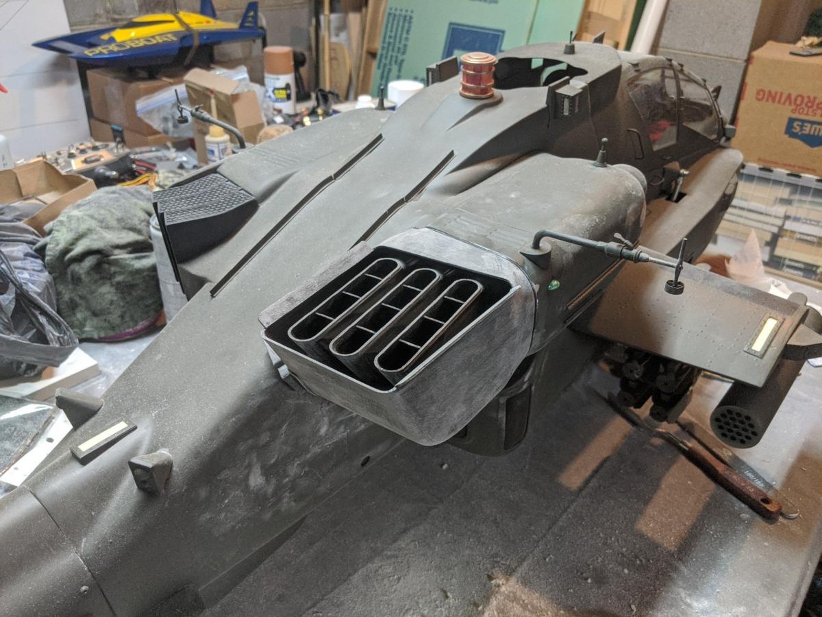

                                  All done....

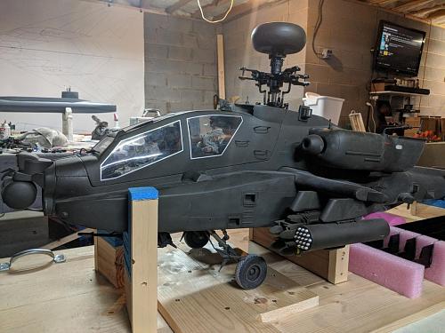

                                    #77
                                    Sweeeet, can't wait to see more video of it, looks awesome sir.....:ah-64::ah-64:
                                      • 4869
                                      #78
                                      Great looking build, RCJD. Love all the detail and 3DP parts, too. Keep the pics coming, please. Best, LB
