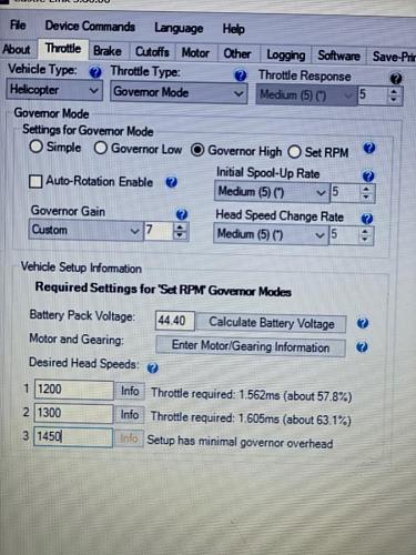

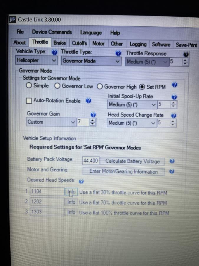

    Hello. So I have had some real issues with getting the tail to hold on this thing ever since purchase. I really need some help. I am using an Align BL800MX 520kv motor and a CC Edge 160HV esc. My gyro is the ikon 2 blue tooth edition. So the thing holds ok but the tail will drift slowly nose right. And if I dont manage the collective well (meaning have to punch the throttle a little it will turn 45 degrees on me. I am using the same flybarless unit for my Goblin 570 and it works fantastic. I am running basically 1100, 1200 and 1300 rpm. I even installed the tail gear upgrade to speed up the rpm of the tail.
    After all this I figured that maybe my head speed just wasnt enough to give the tail the authority it needs. But I see others here like DCCORSAIR running 1250rpm and everything seems to be good. Everything else is stock. Blades, pinion etc.
    Can someone please point me in the right direction. Here is a photos showing my current esc settings. Thank you in advanceClick image for larger version

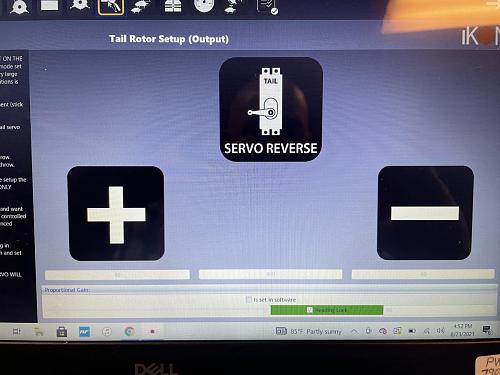

ID:	322900 Hello PawPaw. Mine is actually oriented right now face up and wires to the right. It does not move at all while sitting on the bench.

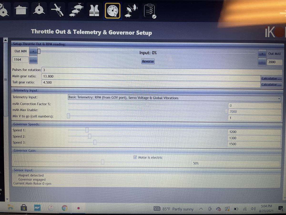

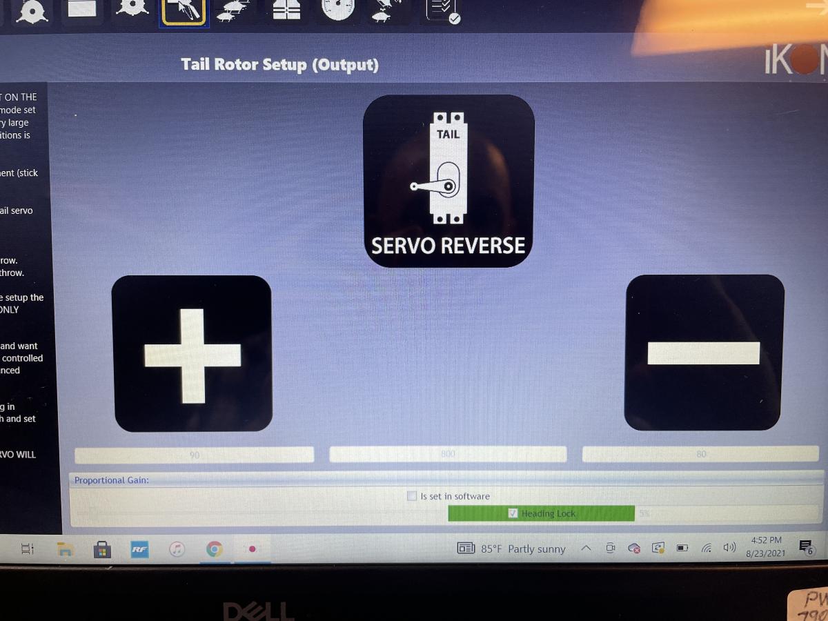

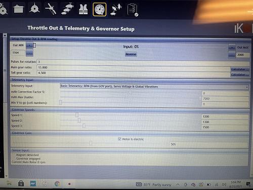

ID:	322904 Here are the tail settings from the icon unit. Also under the throttle out and telemetry governor set up I have some numbers in there but I don’t think that they are active.

            I also don’t see a way to increase the gains for the tail Gyro in the icon? Maybe I am missing it or maybe it’s not needed? But in some of the other fly barless units that I have used in the past, mainly Align ones, there have been gain adjustments

                You don’t have the governor mode “on” in the Ikon, do you? I noticed you have the CC ESC in “set rpm” governor mode so Ikon should be off, or if you want to use the Ikon gov mode then the CC should be “multi rotor” or “remote gov” mode.

                        Aces, jump into advanced menu for governor and make sure each of the three flight mode modes has the “use governor” block unchecked. Also, with the Castle Creations ESC you must go through the throttle setup procedure in the basic menu to teach the Ikon the actual low and high points of your ESC. For the gyro gain, I had it assigned to a slider on my Futaba tx. Find what channel your receiver has assigned to the gyro and set that up to a VR switch or you can just leave it in the Ikon software but much more inconvenient to adjust.
                        To be absolutely certain there is no conflict, I suggest you unplug the rpm sensor wire from the ESC to your receiver unless you have that aux wire assigned to a different function in the ESC. Can verify this by watching the Ikon screen with the motor running…should not see “magnet detected” or an active rpm value.
                        For the Ikon 2 BT I have that’s problem free (and I trust) it is set to governor mode and my Hobbywing Platinum Pro ESC is set to linear curve mode so the Ikon controls everything. Not saying that will be optimum for you, certainly, but I found a much more stable headspeed when configured that way. To my way of thinking, a stable headspeed is the first block that needs to be checked off for any flight problem diagnosis assuming, of course, that obvious mechanical setup issues have been corrected.

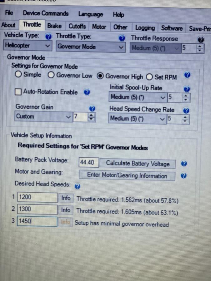

                                  #17

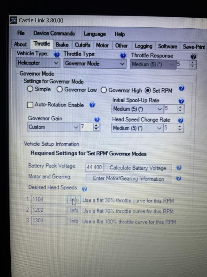

                                  Ok. I am trying to go back through my esc settings. I have checked the radio settings and there is no subtrim or regular trim dialed in. I currently am using governor mode in the esc. And after putting in my motor information and lipo info it gave me the headspeeds shown in the pic above (the first pic posted). However I have some questions. Be patient with me since I have really no clue about this stuff. A friend help me with these settings.
                                  1. If I increase the head speeds shown for each flight mode (the percentage of throttle) from current to 1200, 1300 and 1450 it shows the percentages to use for the throttle curve. But the 1450 head speed says "setup has minimal governor overhead" SO is this basically saying that is too high?
                                  2. Under Governor Gain in the picture my friend said he did a custom setting of "7" as shown in the picture. But I see others just using the standard "medium" setting.
                                  On a different note (not related to the tail) right now my setup is such that when i power up the esc does not arm until I flip into throttle hold. Then when I flip throttle hold off it immediately goes to its first headspeed (30%). I would like to manually control the spool up rate until it gets up to speed. I thought that if I just went in and set the "N" (normal) setting in throttle curve to a linear curve that I could accomplish this. But when i do so it has no effect on the esc. Is this not doable in governor mode? Maybe I have to be in "fixed endpoints"
