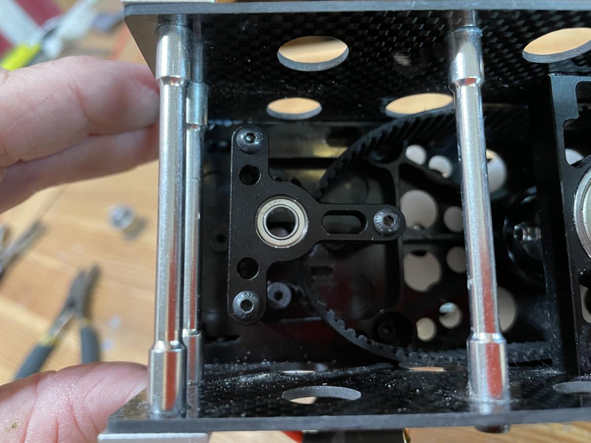

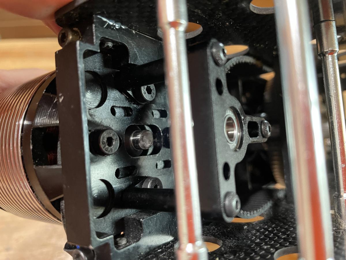

                                  I just watched the video on installing that extra bearing and it totally makes sense. I don’t know why they don’t recommend this. However there is no way that this motor will work with the shaft. So I either have to get a motor with a longer shaft or see if we can create our own shaft.
                                  but for peace of mind I am definitely going to install that bearing.

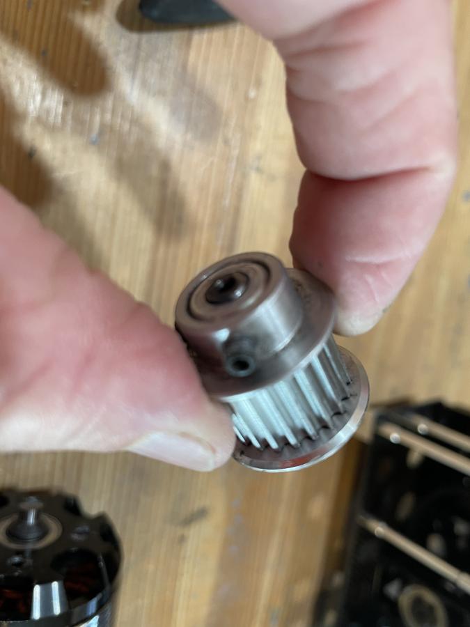

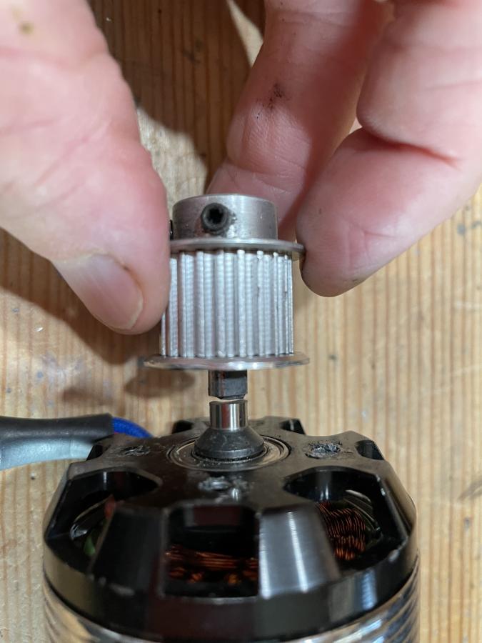

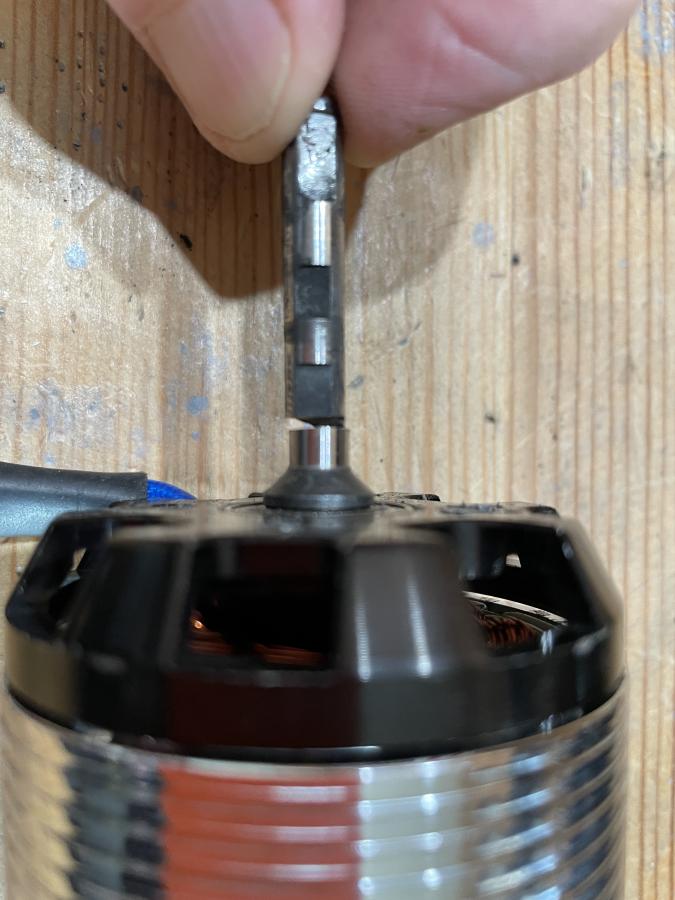

                                  Just wanted to show you some pictures of my motor shaft. I actually worked with my dad to create flats on the end of the motor shaft instead of up at the top of it the way it comes from the factory. Then I flipped the pinion around to make it easier to access the lock screws. But as you can see in the last photograph the shaft is right at the edge of opinion.

                                    They say, the flats are just barely enough to hold the screw. So that’s not an issue. But I did wonder if somehow flipping the pinion and having it so far down on the shaft created more tension. But I don’t think so. The Pinyan teeth part would still be in the exact same position it was for the belt to ride in the middle of the gear.
                                    adding the brace, if the south was long enough, would totally illuminate this. Assuming that you tighten the belt to the correct tension as well.
                                    I actually just got through building the brace and getting it ready for the new motor/shaft. Easy Peezy lemon squeezy.

                                      So you just said something in your remarks, you said you flipped the pinion and created a new flat spot?? So, do you think it is possible you went a little to much up on the shaft as for a flat spot or too deep?? I have done this many times but I just grind a slight flat spot just enough to hold the set screws. Not blaming you, just curious is all. Yes Kontronik is expensive, but you get what you pay for in my mind.
                                      Yes...
                                      If you did that both times... perhaps you went to deep; and without the support frame... just too much tension on the shaft. If you get a new shaft, flip it the other way and just drill some holes in that plate so you can tighten the set screws.
                                      • DCORSAIR
                                        • 1918
                                        • Selma, Ca.
                                        #59
                                        Ok, thank you for the pics, it broke where I thought it would, right at the edge of the flat spot, I have two of mine like that, that makes me nervous not being able to run that lower bearing brace, yeah it's easy to install once you figure out how it goes. Can't wait to see your Apache flying when your done with it.
