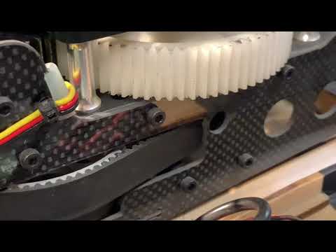

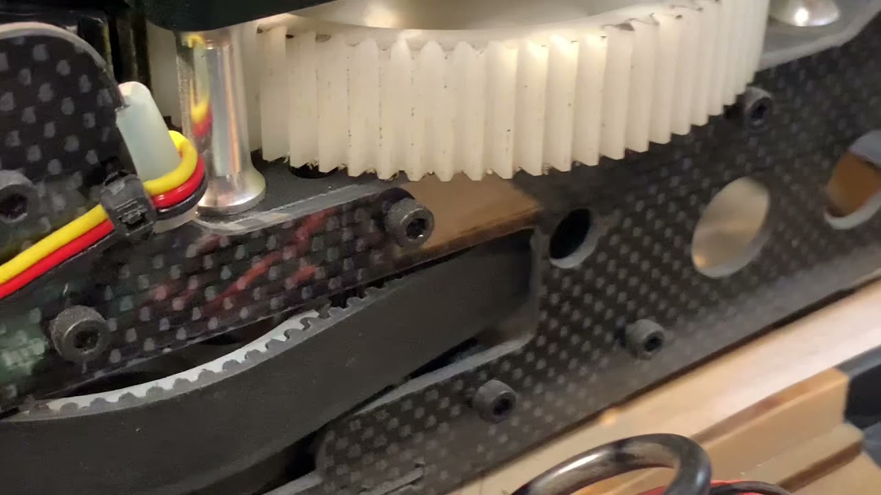

                                        I’d suspect the belt is too tight if 2 in a row have broken off the shaft. The Roban belts don’t need to be very tight. This video from Mike Spinner shows what correct tension should look like:
                                        • #40
                                          Thank you guys for all of your help. I am very nervous now about this motor. I don’t think it’s the motors fault. More likely mine somehow. But I may try a new motor. And, Deltadart, thank you so much for that video. That’s exactly what I needed. Unfortunately I actually would say that my belt was about that loose. But maybe not quite. But now I have something to go by. I know that everyone has different motors they are using but I believe motion RC’s website recommends the scorpion. I don’t want to break the bank but I want something reliable. Recommendations?
