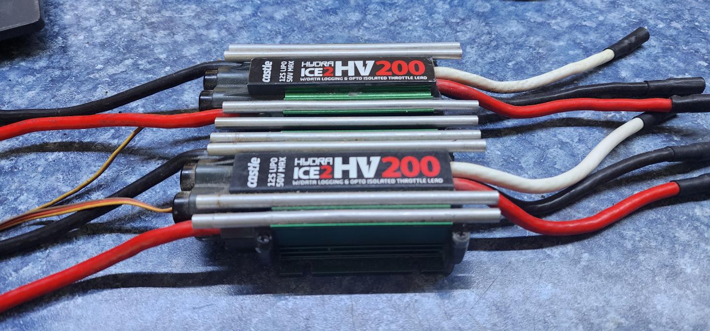

My plan is to test half stator conventional winds and hybrids fired at 180 degrees with dual inverters. I know through empirical experience that this tandem can easily pull 400 continuous and 760 amperes peak
According to Steve 's site the saturation point for this core is over 1000 amperes at 6 volts or 6000 watts. He is a honest vendor.
