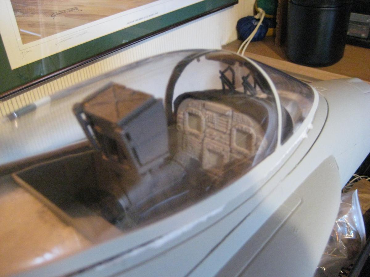

    LB, in post #768 is that the HUD Base w lens and camera v2, HUD frame v1, RG's Cockpit Coaming, full instrument panel and center instrument cluster I see in your picture? From what I compared to my list it seems I'm going to have to go back to DD and get a few small items I left off my list like the files you and RG did for the Canopy Bow. Where can I get some 3D bombs like the ones attached on the model?

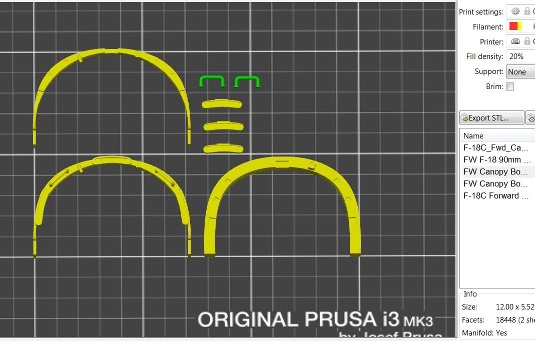

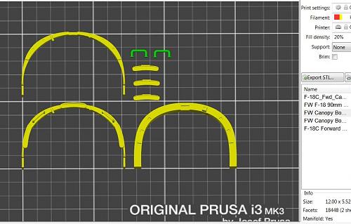

    Hey F-18C Owners' Society, These are the corrected Canopy Bow Frame STL Files which include the original Bow by Radar-Guy which fits great and the v3 updated version he and I worked on together. The file has a printable 'full-version' and a printable 'parts version' depending on your preferences. As always, let me know through this forum if you have a fit issue or a fix or a version you've modded. I think we are all served when we mod and share a better version of any of these files. Building a better 'mouse-trap' so to speak. Best, LB

    Hey Gang, I just did a quick dry fit of the Canopy Bow and it looks really good; however, it is a bit too tall to allow the OEM Canopy to fully seat to the foam I will remove the offending item from the STL File, mod it and get it back in the STL File asap. Best, LB
