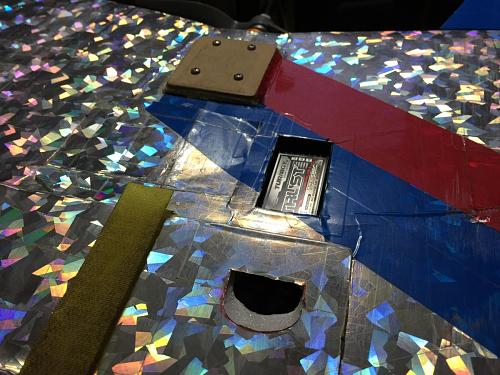

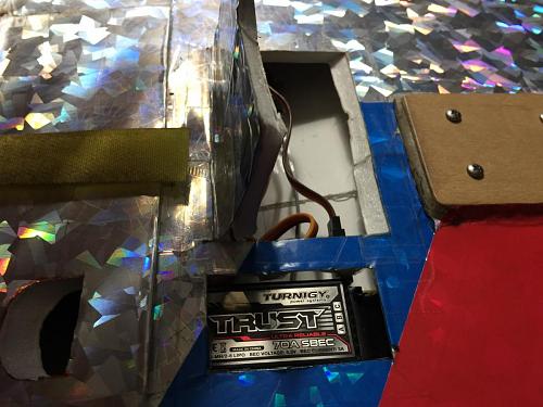

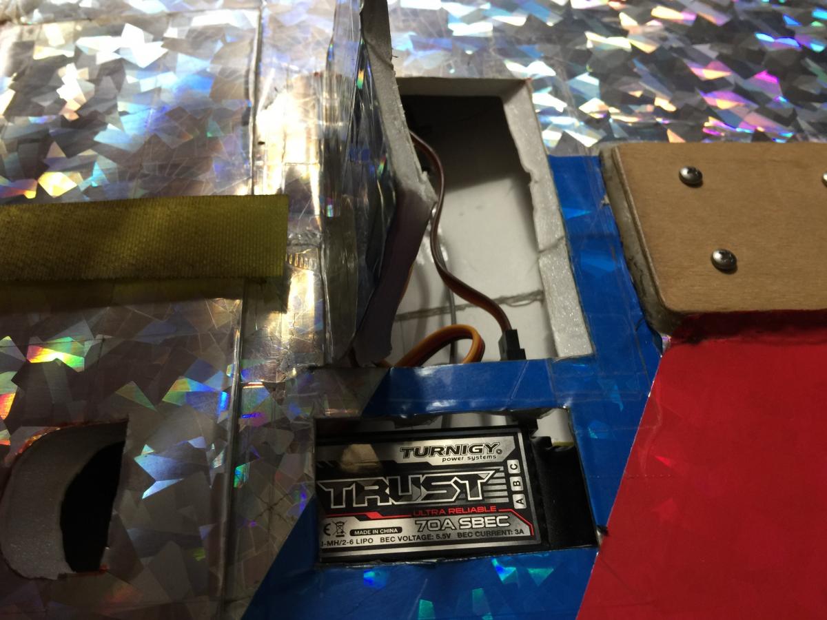

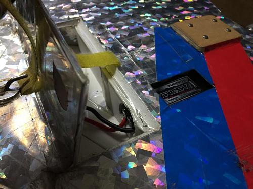

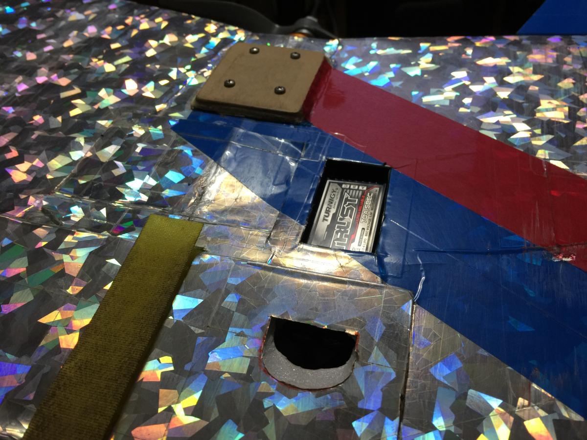

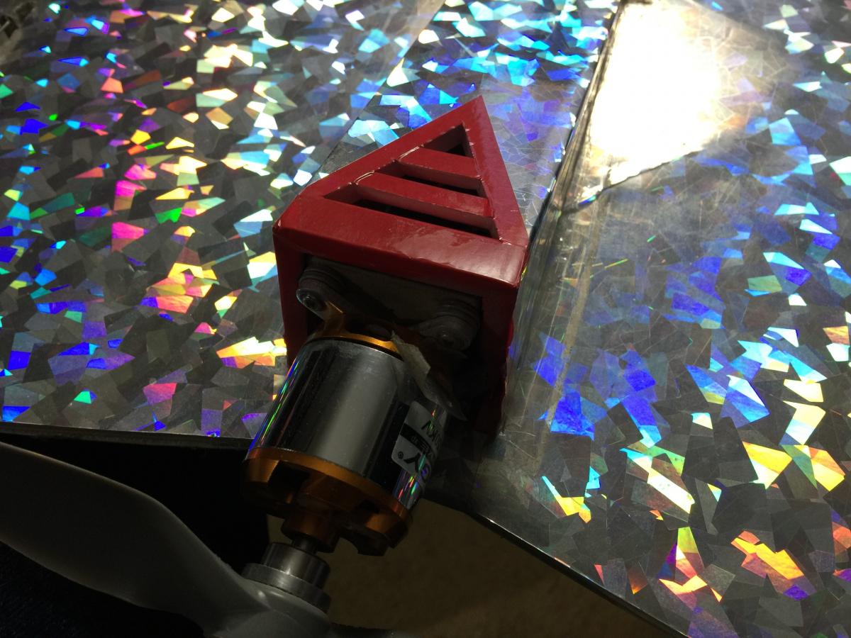

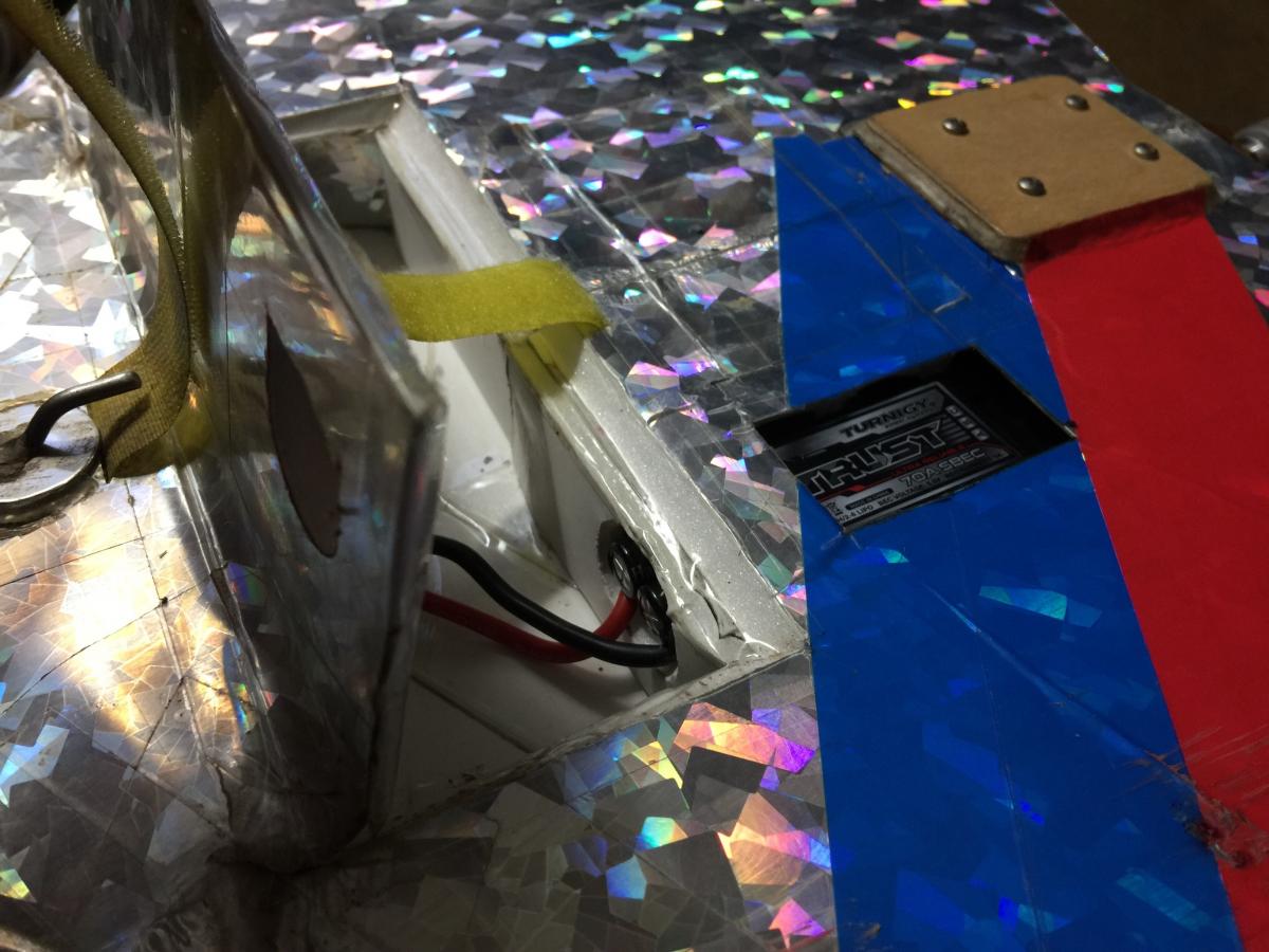

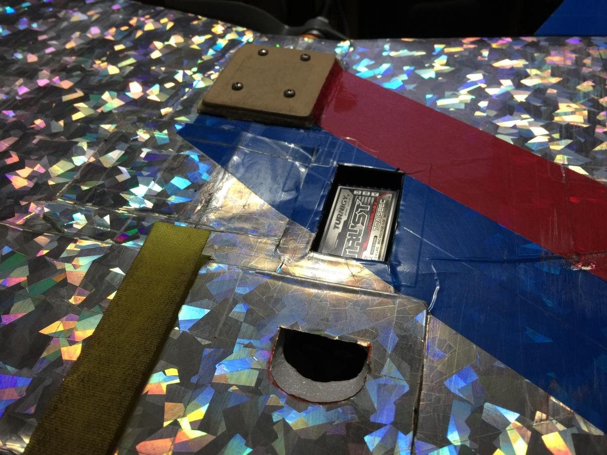

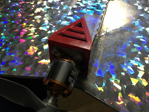

    I located my esc on the lower wing surface and ram air into it. The air exits through a grill in the upper motor turtle deck.
    Any place you need access in foamboard, cut the foam at a 45* angle on the sides and rear, make a cut on the inside of the foam at the front to create a hinge for the panel.
    My tip washout is at least 1/2” to 5/8” , giving superb slow flight and super stable high speed flight. I have also used no dihedral at all, the wing is flat...!
    Use a fish fillet knife to angle cut long tapered inside angles like the ones I use on aft spars at the glue joint.
    use only the clear hot glue! The milky white stuff is low tack, clear is high strength. Don’t get greedy, I glue one joint at a time while forming the wing on the jig table.
    A square trailing edge on the elevons has not cause flutter, at least not at 155mph...! I launch with a bungee cord and belly land in grass.

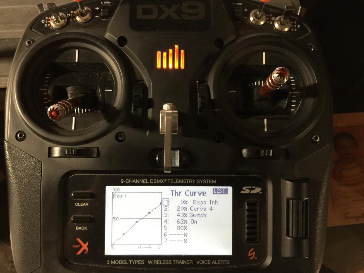

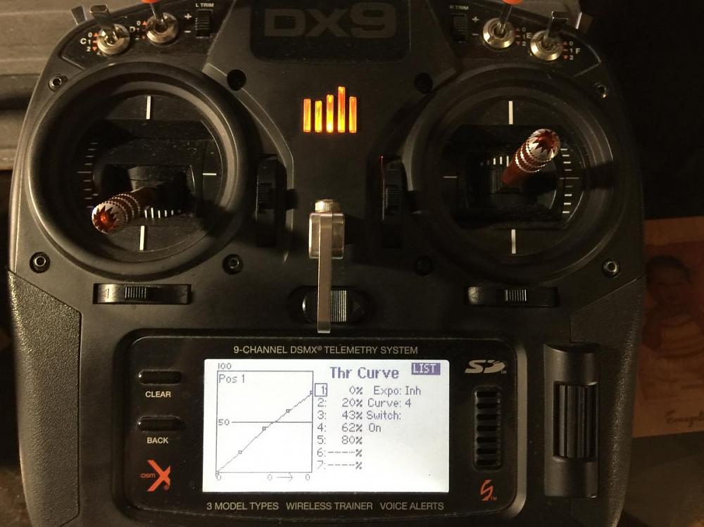

                          Having flown every type of electric model out there I’ve noticed they all share a common downfall. During amp draw tests, most do very well at the lower range of the throttle curve. It’s when the throttle is advanced above three quarter that amp draw skyrockets. Now there are models that may need that realm to operate in, normally when the model is underpowered or has induced drag issues. Consider your own experience and you’ll likely realize much of the time your flying is spent at half to three quarter throttle on a well designed airframe to power system. What I’m doing lately is creating a new throttle curve on some of my models to avoid the high amp draw at WOT. I fly the airplane and determine where the acceptable level should be set and trim back as required. It relieves excessive loads on your battery, esc, and motor that cause heat to build up which eats more power. Minutes can be added to flight time that way and your components are greatly relieved by it.
                          ‘My latest case in point is a giant scale Pilates PC-6 Porter running a 12s system. A standard stock power curve produces a 127amp draw at WOT. I have reduced that to an 80% curve so the draw is now 85amp at WOT. A huge difference and the model does not normally need that kind of waste going on as I fly the wing and not the prop.

                            I remember the days of old were certain vehicle engine applications were not allowed to go above a predetermined RPM with the use of a governor.
                            A good approach to making an electronic governor.;)
                            I'd be curious as to how much in prop rpm you dropped for that 42A current drop on the "reset of WOT".
                            I personally wouldn't do this because I don't need to jam the stick all the way to the firewall and it would take away my ability to have the FULL power if needed.
                            An old school precision aerobatics pilot in the club I used to be with actually had a notched detent in his throttle stick at around the 60% range.
                            I used that same principle but did it electronically on the DX9 with an audible beep when I hit 70%.

                                    Good times, and yes I have noticed the spike in amps over 75%. For some odd reason in my head I normally fly at 50-75% without even thinking about it. Only going wide open for show off passes or big loops and extended climbs. Other than that it's pretty much cruising at probably 60% or less. Also when at the upper limits you will see a major drop in voltage in your batteries when you hit those amp hungry wide open moments. Example here in my fpv osd footage from my 79" wing...
