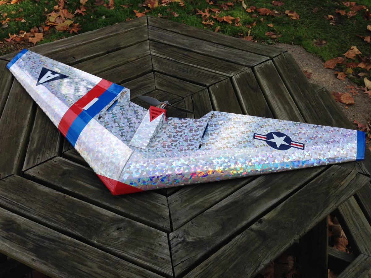

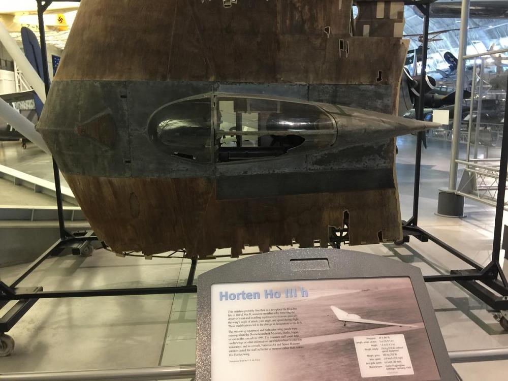

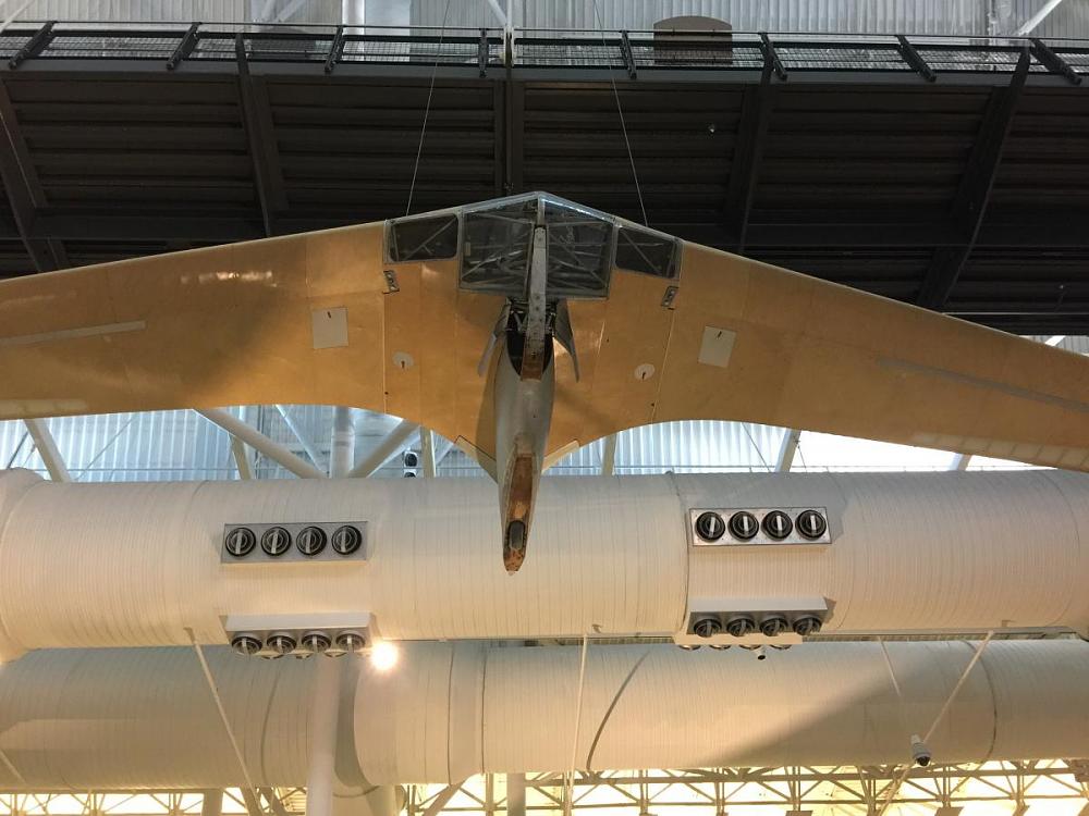

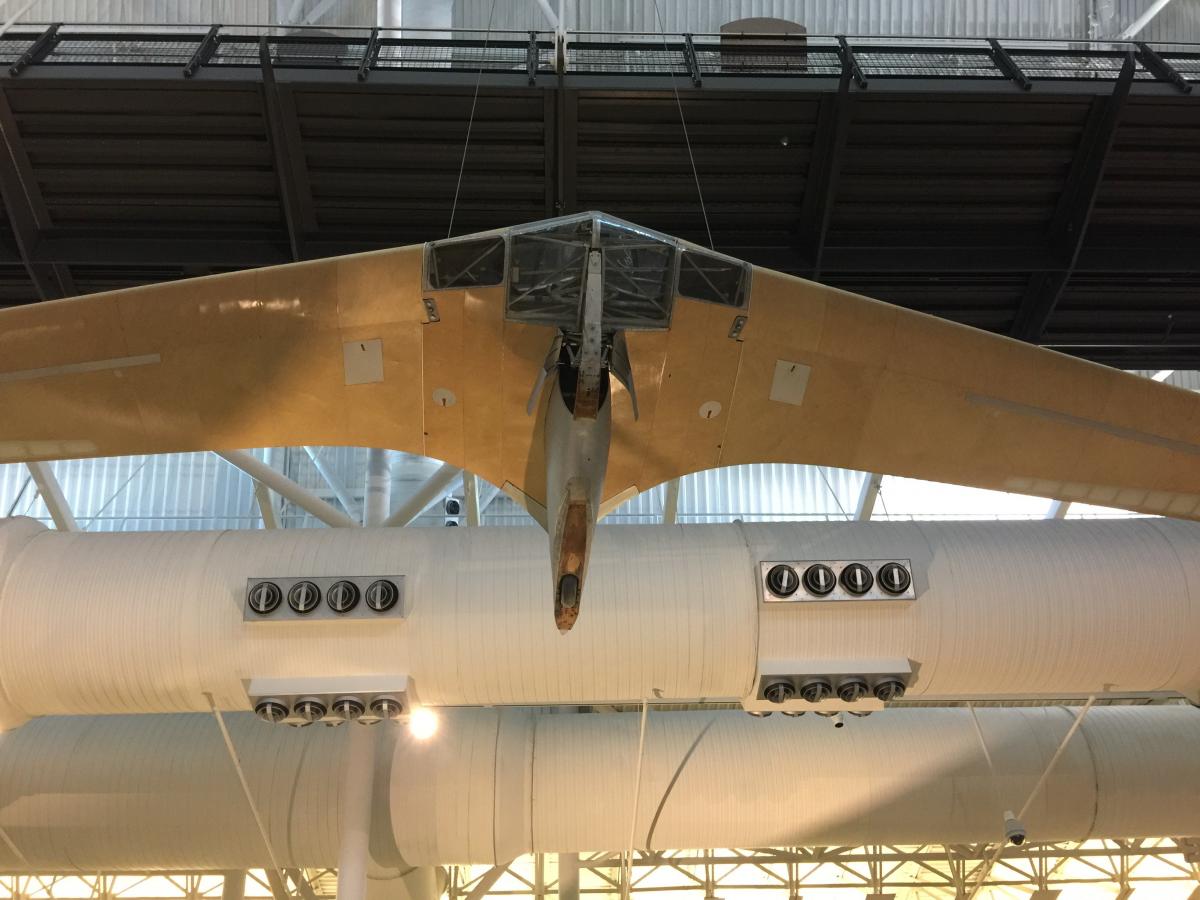

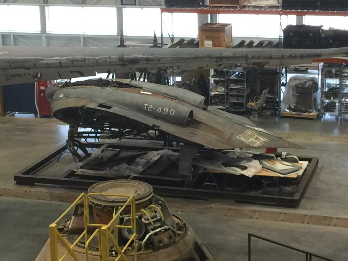

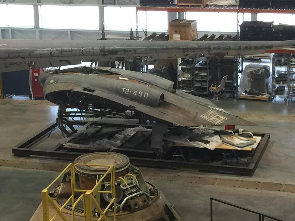

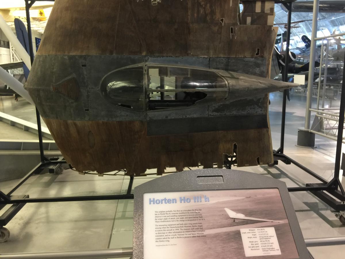

                  I studied the Horten brothers stuff a bit. Saw some of it first hand at Udvar Hazy last year. Built a few test wings powered with props.
                  This one has over a hundred flights on it. 155mph... GPS onboard. No gyro. 5’ wingspan.
                  The key to stabilization in a true flying wing is wingtip washout. Any design with little or no washout will waller visibly side to side. A fare amount of washout helps resolve this issue immensely.
                  I’ve never had serious stabilization issues without a gyro.This is made of holographic foam board and flies on a 4s 5000mAh.
                  Its super fast. I have no desire to muck up a good thing and go scale. I made up plans for a 200mph version.
                  If I can get the giant scale PC-6 done with some time to spare I’ll do the wing this spring...
                  Been a rough winter in PA plowing snow.

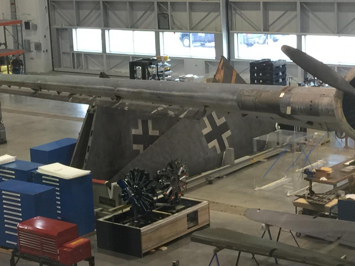

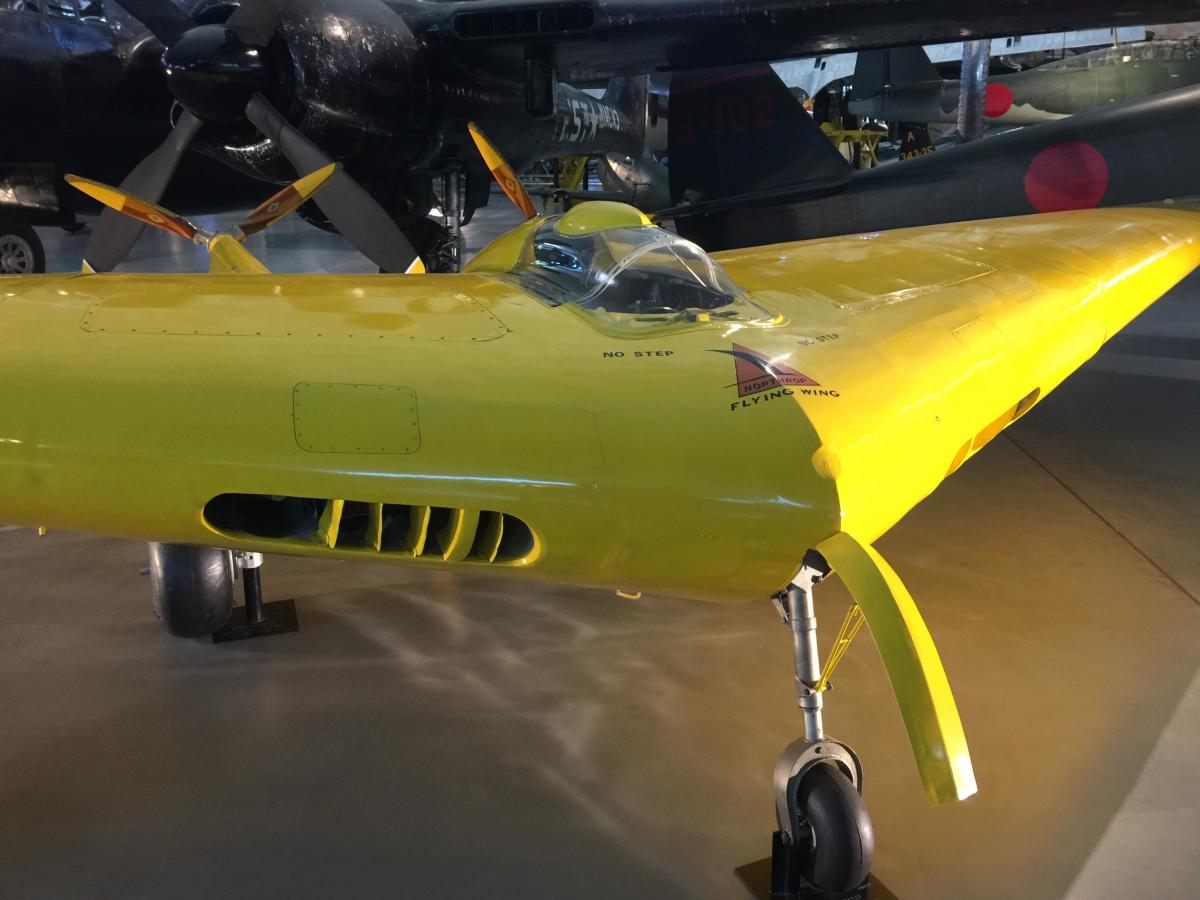

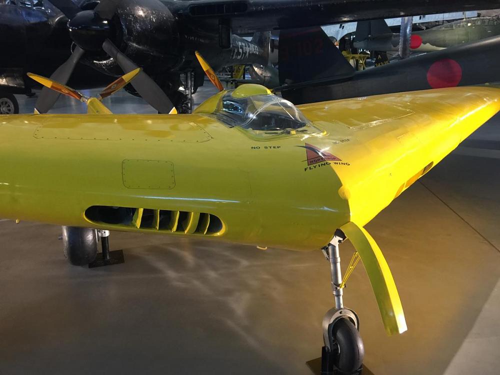

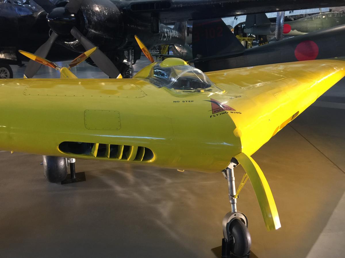

ID:	113068 Im blessed to live smack in the middle of the two greatest aviation museums in the world.
                      National Museum USAF and Udvar-Hazy NASM. Both of which I visited last year. Just so much to see!

                          My long time RC friend from childhood and I still fly together. He loves to build from foam board. It’s cheap and strong as hell. With some practice in technique it’s actually a great medium to build experimental planes with as it’s so cost effective and provides fast builds, days rather than weeks to complete. The guys at Flightest have many video’s to help you learn to ropes. This is where I learned the things necessary to construct foamboard planes and flying wings.

                            Typically in RC we build from the outside in. When you build a flying wing with very little room inside, you must design from the inside out to create and accommodate the necessary room to place the batteries while using the battery compartment structure as a spar.
                            Building wingtip washout into a foam board wing as you bend and hot glue it requires a table jig set up at the necessary angle.

                                  Flying a wing that moves at 150mph plus is a whole new experience that nothing else will prepare you for. I doubt an edf wing will ever be as fast as a prop wing. None of my edf jets would even come close to catching my wing. I have a Stinger 90mm and even on a 6s 8000mAh it’s a dog compared to the wing. The first few flights on the 3rd version which is the pictured wing, I was shaking like a chihuahua crappin’ razor blades, it’s that fast and it’s here n gone. Plus the stealth aspect of the wing only shape. If you get too far out the best thing to do is pop straight up and do an Immelmann back at yourself. I build washout into the entire aft end of the span, really locks the stability in.

                                      3542/1450kv motor
                                      70amp esc
                                      8x8 apc prop
                                      4s either 4500 or 5000mAh
                                      the holographic foam board has a plastic coating on it, super smooth finish for the laminar flow to just rip over.
