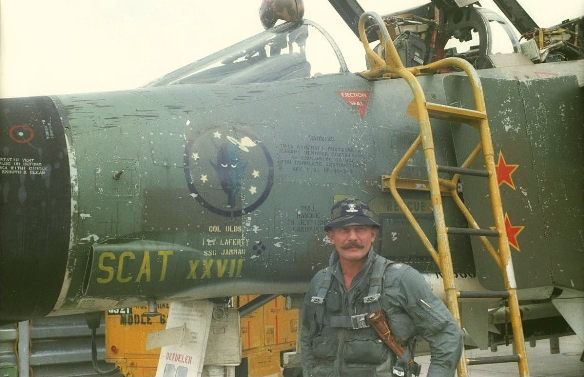

    Rex,
    Some photos of one of our favorite Phantom Drivers.
    Note the non-slip on the ladder rungs.
    Best, LB

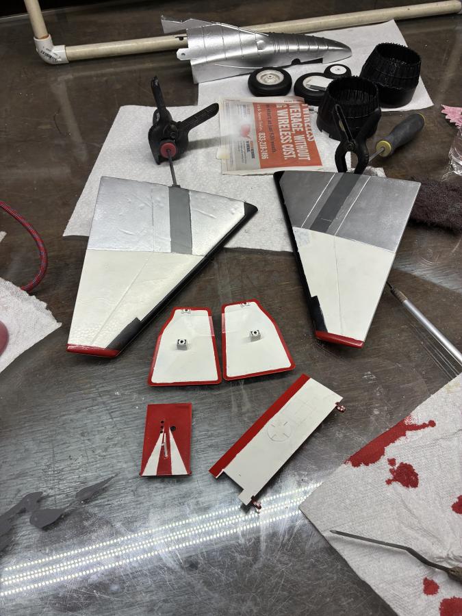

        The non-slip is 220 wet/dry sanding paper cut to 1/2" wide by 11/4" strips. Medium ca smeared on ladder steps and paper formed around the step. It came out nice and has the grit of the real ladders. Learned a new lesson doing this.
        Moving along I have the stabs. and gear covers painted. Having a heck of a time with bleed thru on masked parts. Touch up works but slows progress. Using auto green tape but guess I'm doing it wrong.
        Best Regards, Rex

          A trick you might use is paint the color you're masking before you paint the actual new color.
          The paint that bleeds through is the color you're masking.
          I did this on the Stars and Bars for my Desert Warrior B-25C.
          Works great, but make certain when you remove the mask to pull it slowly over itself.
          I did not wait for the actual color to cure before pulling the masking tape.
          All the paint was fairly green, sprayed within 20-30 minutes of each other.
          This works well with acrylics and lacquers, have not tried it with latex.
          Best, LB

            I will try the same paint before different color. Not much bleed thru just a headache. Thanks, Rex

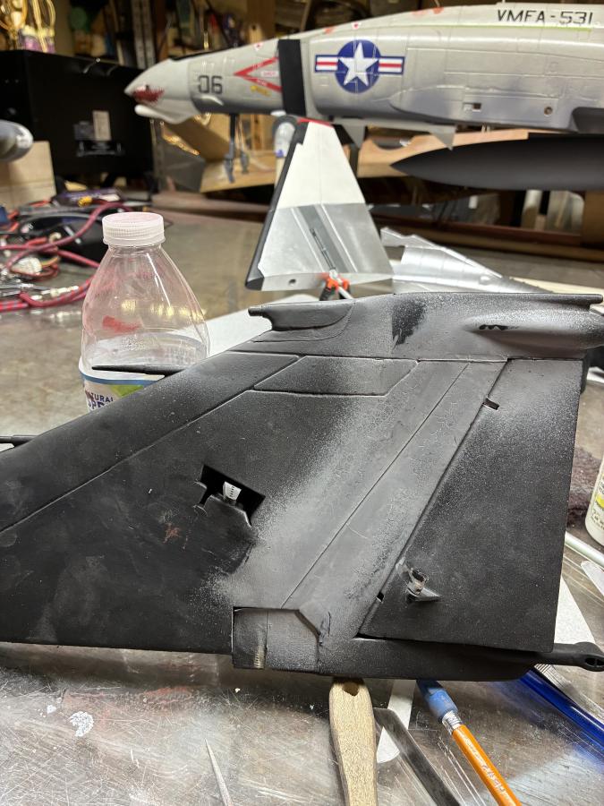

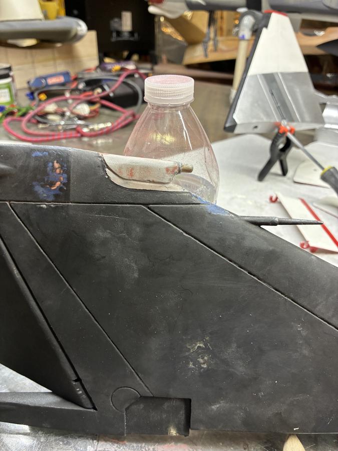

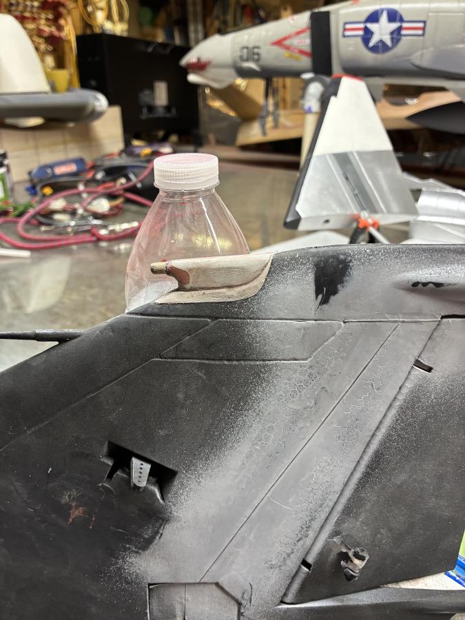

              Not 3d printed just ole fashion lite weight bondo, carving knife and sandpaper. I'm still in the dark ages but after final finish I think it will be OK.
              Best Regards, Rex

                Looks great, Rex! I'm with you, there is still a lot of value in years of experience doing it "the old fashioned way" with steady hands good mind as to the desired piece. One of my favorite woods is basswood, and I feel pretty comfortable carving and sanding just about any little part that I need. I still like 3D printing, and in some ways the final product is superior to scratchbuilding parts, but I think it still has its place in hobby work.
                Cheers
                davegee

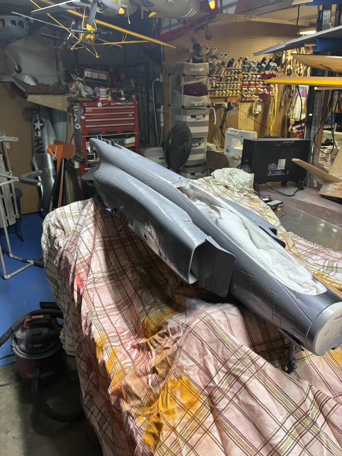

                      Moving ahead slowly. I sprayed the first coat of sandable primer on. Covered all the decals pretty well, will sand, fix imperfections and spray again. Needed to leave the skunkworks because of the smell, wife not happy.
                      Best Regards, Rex

                          Nice work, looking forward to the transformation. "Wife Not Happy", join the club, but that's how they keep us on our toes and eventually get everything they want! The sacrifices we make as "true" patriots is monumental!

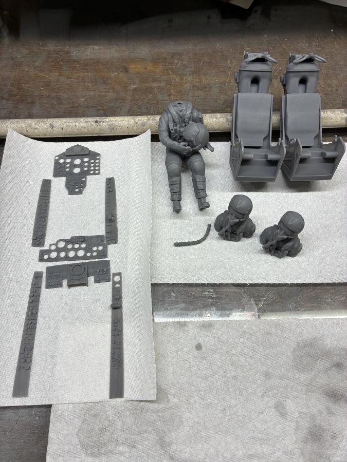

                            Received my pilot bust from Chris Wolfe plus his cockpit for the Jet Hanger F-4 I have and a full body 1/110 scale pilot for my Jet Hanger A-7.. All detail is fantastic, Thanks Chris.
                            Best Regards, Rex

                                Hi Rex: could you straighten me out on this? I thought you had an F-4 already completed and almost ready for the Toledo show next month. Is this a second F-4, or did you decide to redo the exterior and repaint it? Whatever, it is coming around great. I have a similar problem with bad paint and glue smells emanating from my workshop in the basement, especially on cold, windy days when I have to keep all the windows and doors closed. I lost my sense of smell over 15 years ago, so nothing bothers me, although that can be a bad thing if it is toxic. I have to just force myself out of the workshop at regular intervals for things to settle down. My wife is the constant arbiter of the paint/glue smell, and when to cool it for a while!
                                Thanks,
                                davegee

                                  Davegee,
                                  Same aircraft just not going to be able to finish for the show. With all the details it would be a shame to rush and disappoint myself with a poor job. I am working on it, but wet sanding takes time to get the surface the way I want it. Believe This will be ready for next year but the P-47 with Bob will be going this year. Showed the P-47 at club meeting yesterday and everyone thought it looked great. Will post on P-47 forum later. I had my Corsair for 4 years before I took it to Toledo so not upset to bad. EYES bigger than my Belly.
                                  Best Regards, Rex

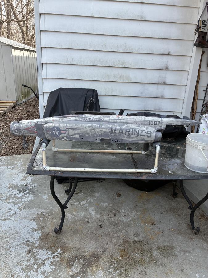

                                          Beautiful day so the Double Ugly is getting a wet sanding. Started with 220 wet/dry and will finish with 600 wet/ dry. It's getting really smooth and level.
                                          Best Regards, Rex
