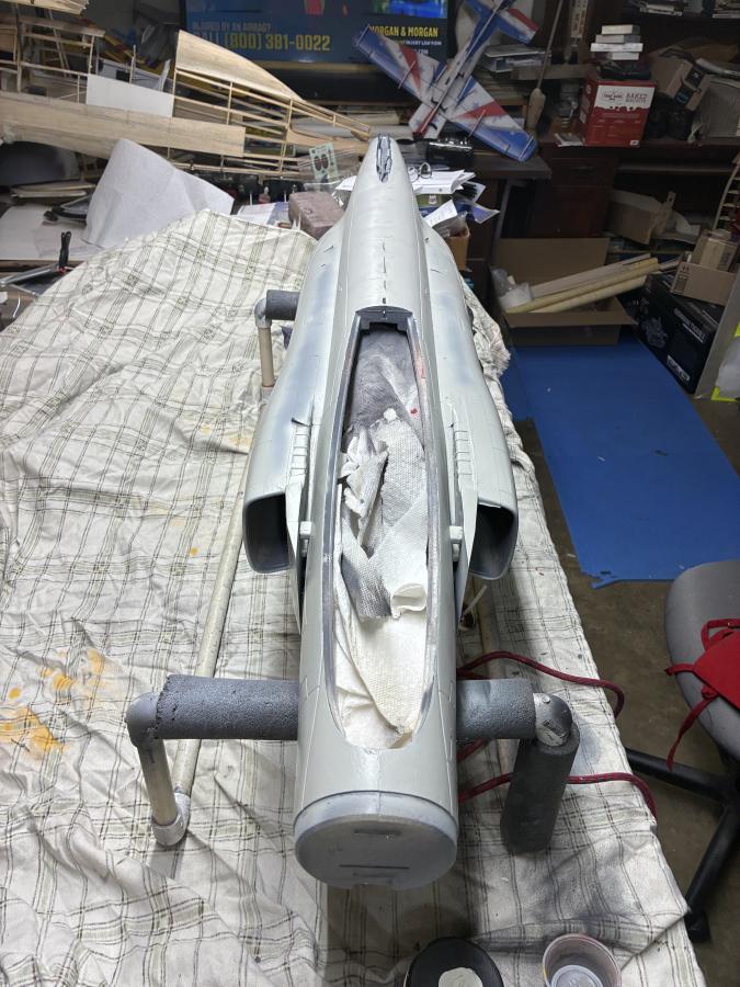

    Today I sprayed 2 final thin coats of regular primer. Tomorrow I'll lightly sand with 600 grit wet/dry paper then add a few 3d pieces and will be ready for paint.

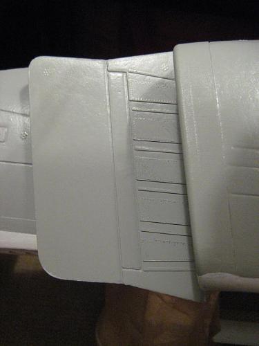

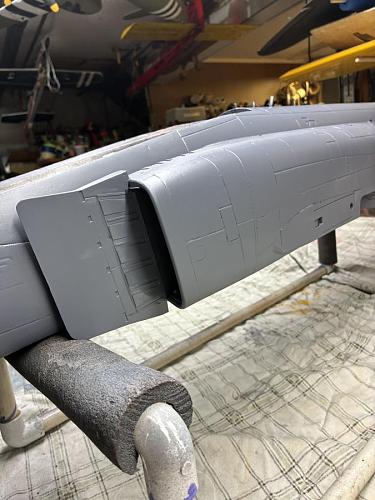

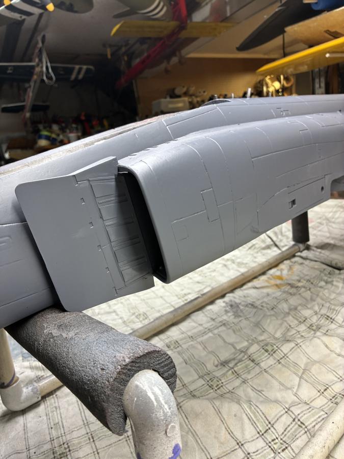

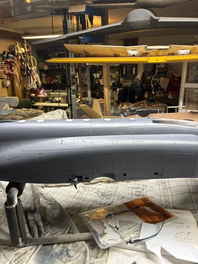

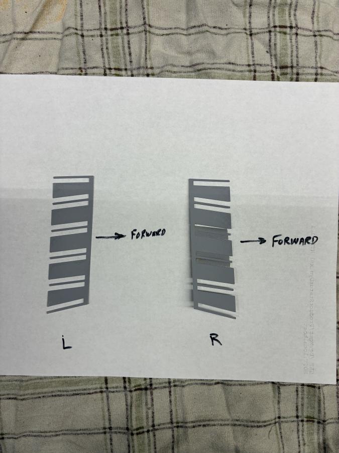

    Elbee, can you tell me which is the correct placement of these parts. The one on the right or left. trying to get the wide strip set the correct way. I think it's the one on the left for proper direction. Thanks in advance.
    Best Regards, Rex

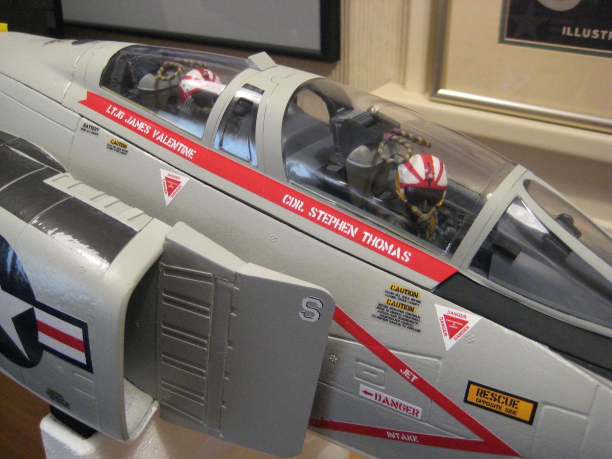

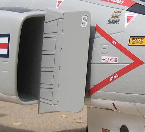

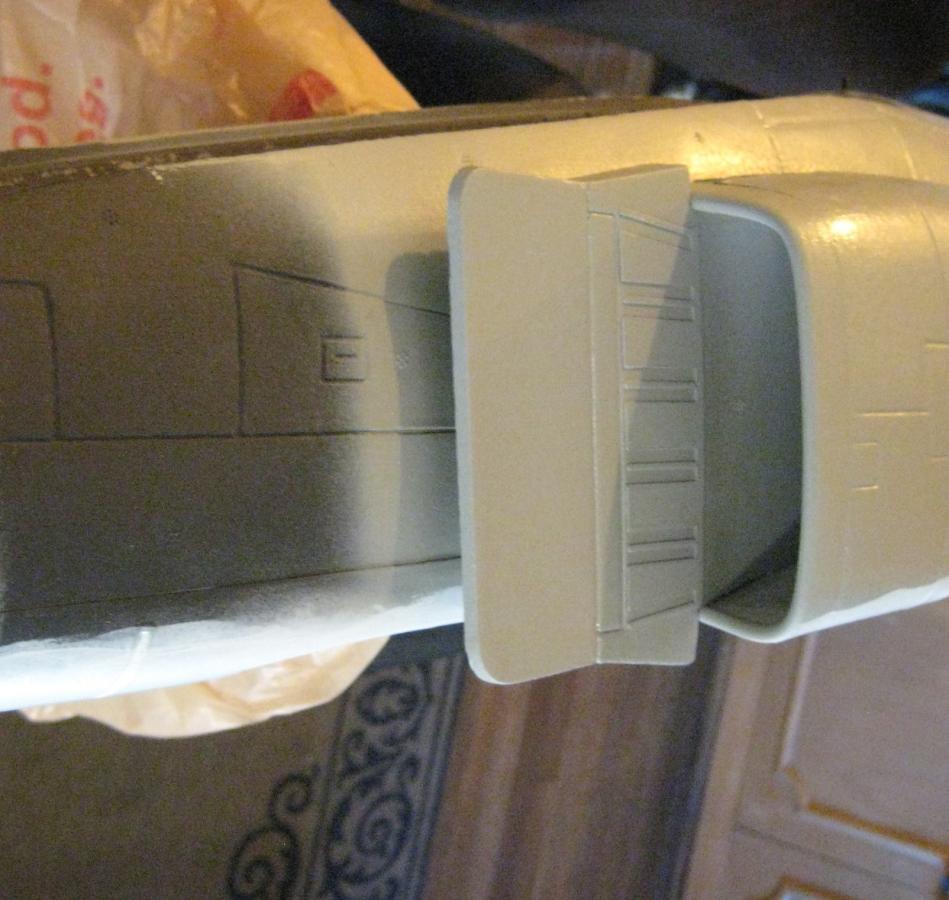

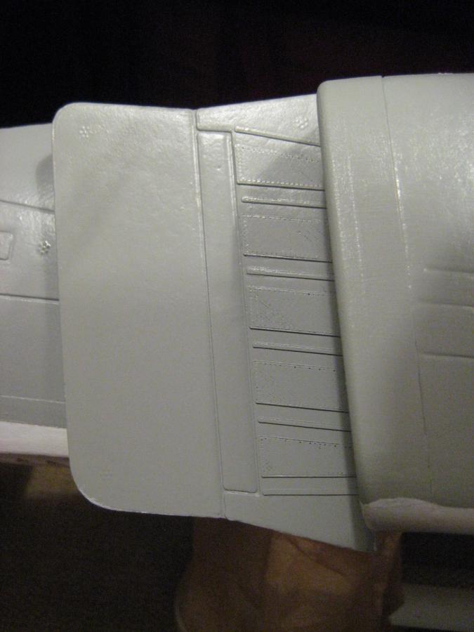

      Rex,

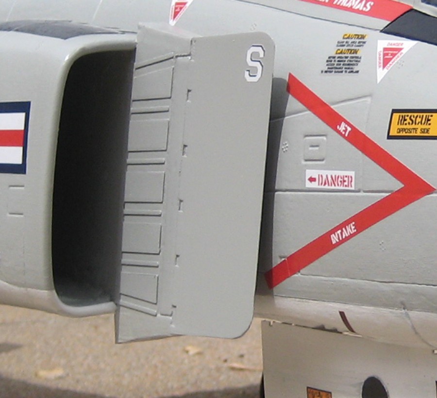

      The 'open' ends go forward, i.e., in your picture the one on the right is oriented correctly back to front.
      However, the angled side goes at the top.
      Th whole part is mounted just shy of the molded panel line.
      I do not recall which print sheet I used for your parts, but the smoothest side of the part should face outward.
      I have attached some pictures for reference.
      Any questions/comments just let me know.
      Best, Steve

        Thanks, Elbee. I will install these correctly per your instructions. Fuselage is very smooth and after adding some hatches on top of fus. will be ready for paint. Your model is still the goal I'm after.

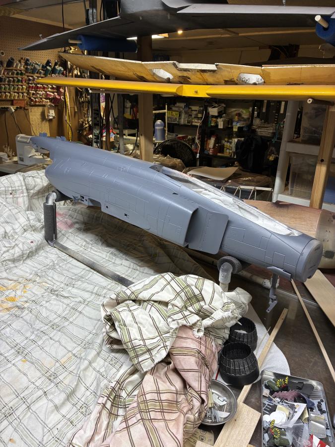

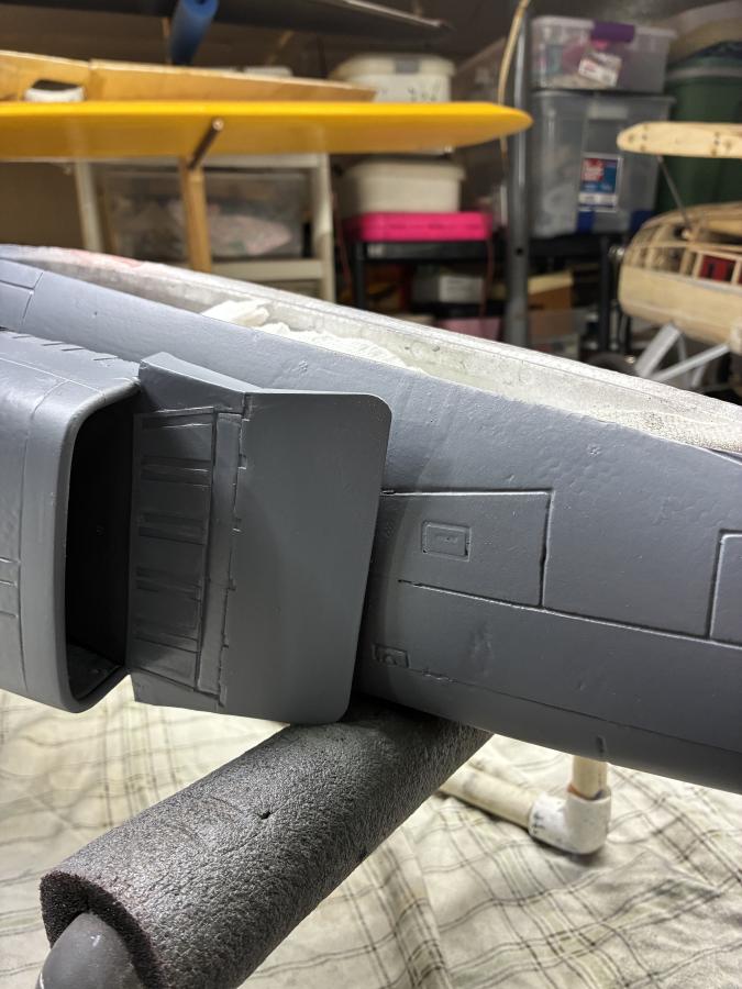

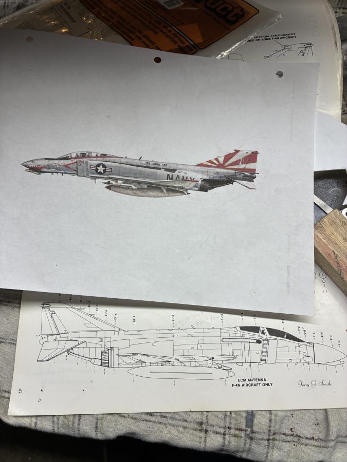

              Added a few hatches and antennas on the top fuselage per my 3-view and photo.

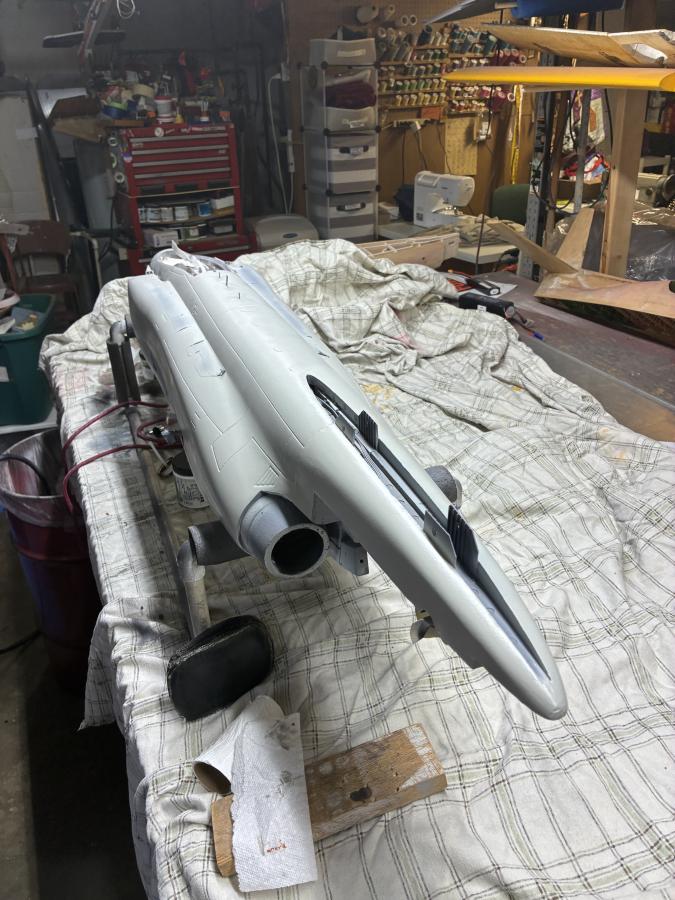

                    I think I have added the last 3d parts to the outside of the fuselage. makes the intake dividers more scale. Elbee that center seam is really hard to get seamless. I have sealed and primed, sanded but every time I prime some of it shows thru.
                    On my jet hanger F-4 the OS 91 would be a good fit but I believe the EDF would be best overall in today's world. Glow plugs are expensive.

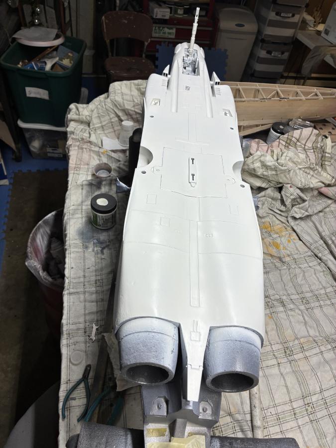

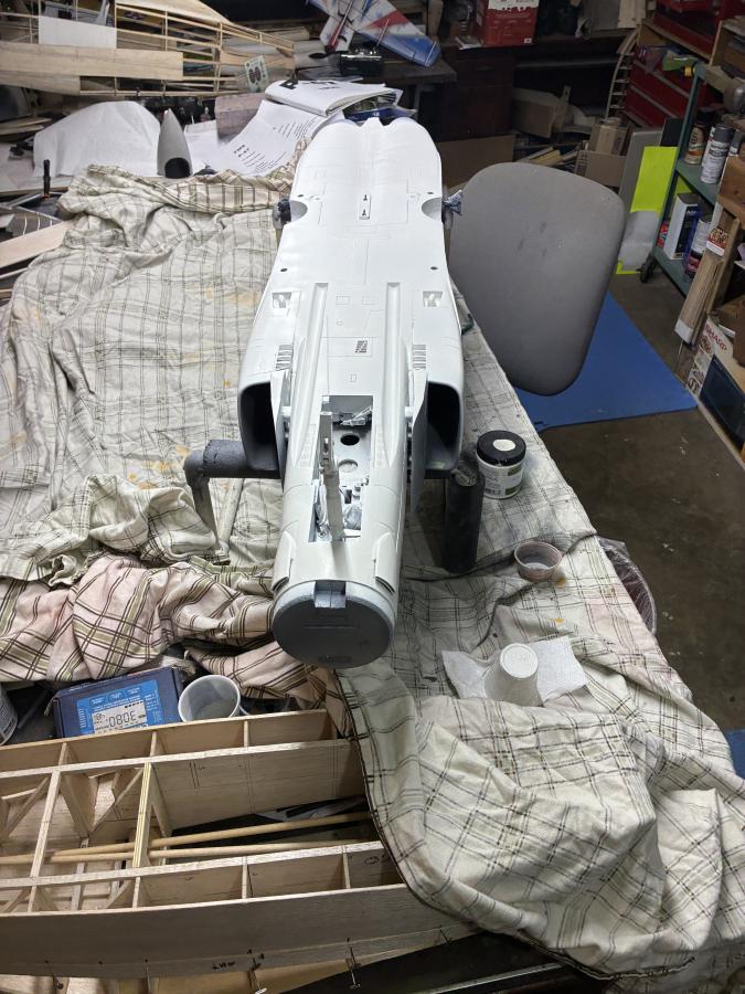

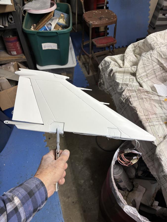

                                After several lite coats of scale white to cover the gray primer I have the stab/rud and lower fuselage painted. Still wet and drying in pics. Going to let dry out for a few days before I do the top
                                Best Regards, Rex
