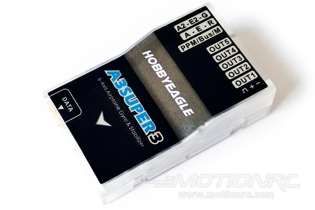

        Do you use gyros of this type (Super 3 V2 from Eagle) on your machines Thank you👍

          Those gyros are fine. I happen to use the AR636 receivers with gyro because I have over 20 of them and feel very comfortable programming them (which can be a pain at first as there are very few good instructions available). I happen to like the ability to have 3 different modes of gains programmed, and usually tie it to the flaps for more gains on landing and take-off. The programming app on my phone lets me program it exactly how I like it and on the Spektrum transmitters, there is a display window that shows exactly how much gain is programmed in each control surface and how much the receiver is giving in each mode. Just something more for the pre-flight checklist to make sure everything is responding correctly. But everybody has their favorite equipment, so that's just my 2 cents.

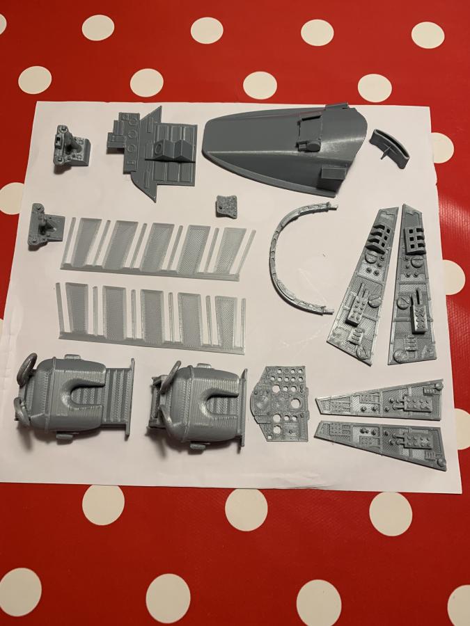

            Here are the prints of the weekend that goes more than painting ... the rest for the next ....

              LDV, Very nice work, Sir. I recognize a few of those parts Post more pictures, please, as you progress. Best, LB

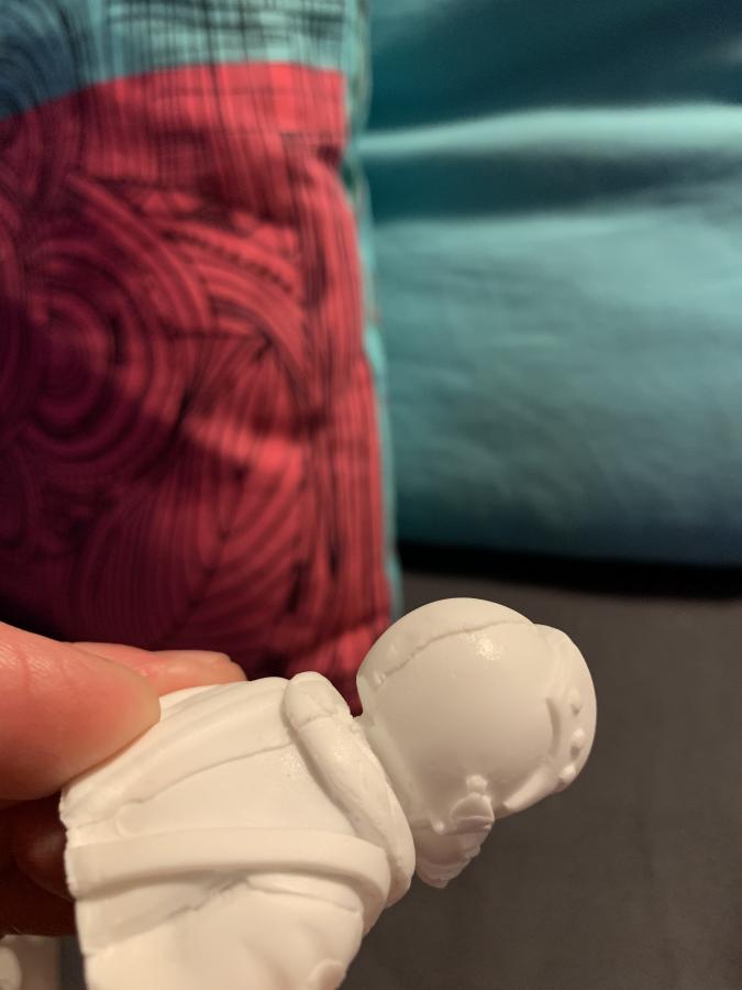

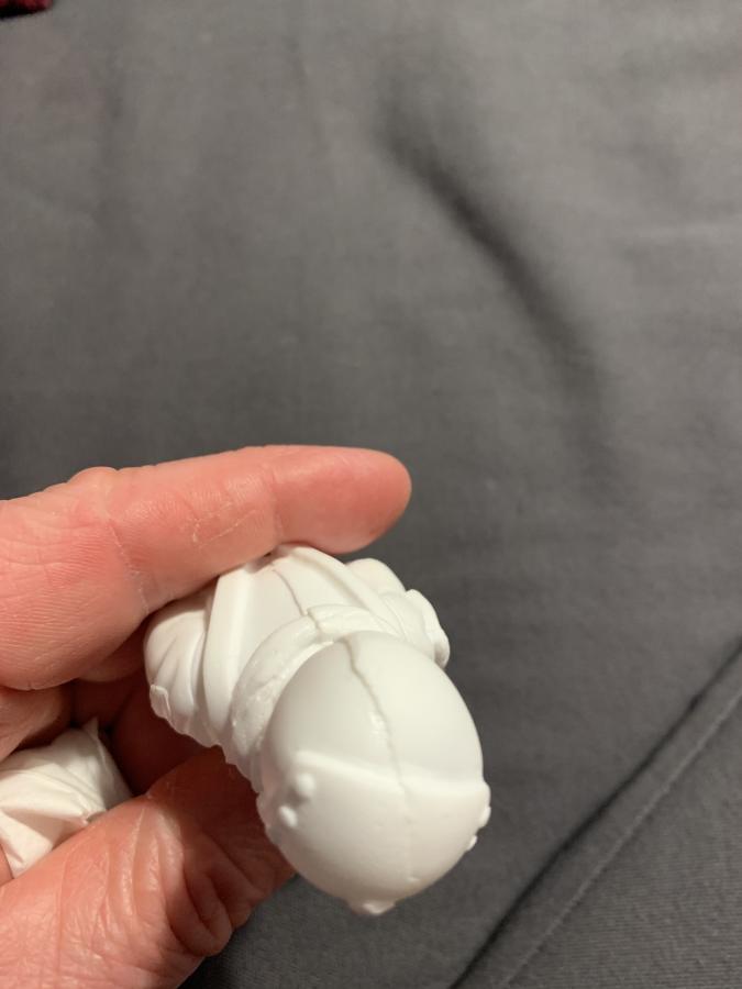

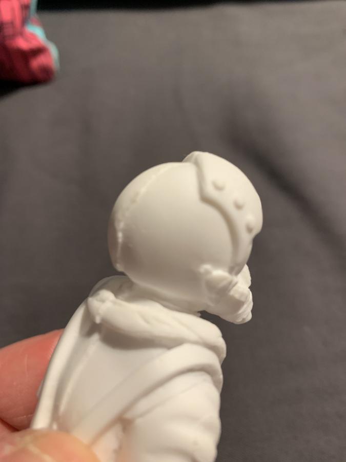

                Hello, I received my pilots from jet hangar hobbies 1/12 scale. I notice that there is a big deformation in the helmet. Did you also have this problem. See the pictures ? If so how did you proceed! Do I have to fill in or fill in with putty? Thank you for your comeback.

                  That is what I did. They are essentially rotocast in a rubber mold. If the separation line doesn't go back together just right that will happen. It has never been a big issue to overcome.

                    Steve, what do you apply as sealant to make up for the flaws?👍

                      Squadron putty or something similar.

                          LDV, I wanted to chime in on the JHH pilots. It is not uncommon for these pilot figures to come flawed in this manner. Not a big deal, I suppose, but just another reason why the hobby really needs both a better selection of pilot figures and 3DP pilot figure options IMHO. Best, LB
