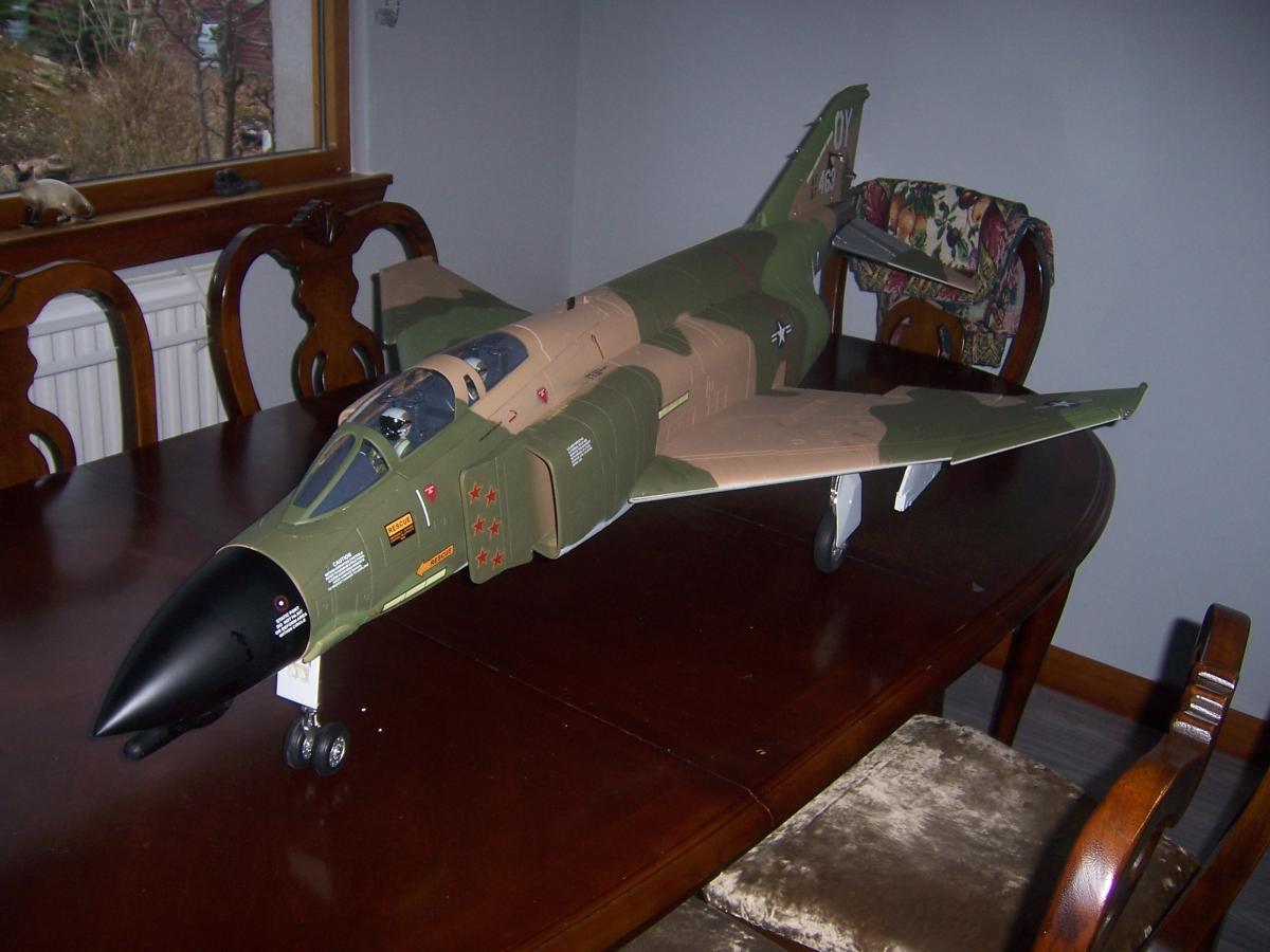

                                    #4057
ID:	240389 Big box is now empty !! Just need the FMS 12 blade 6s fan from China and it's good to go!
