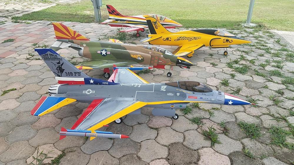

            It's too bad sfcbhunt that you got a lemon. I now have a dozen Freewing/FlightLine jets & props and so far I have been very lucky I guess. I have 2 F-4's, one I redid in the Blue Angel Scheme and both fly exceptionally well with only minor trim. To bad you may have been too late in working it out with Motion, I have had excellent customer care for anything that was even the slightest problem. I actually think their quality is better than E-Flight or FMS, but I guess that's just me. :hugging: Got 4 flights on one of my F-4's today (and 16 flights on 3 other FW jets including the F-16) in 18-24 mph winds and she blew through it with no trouble. Landing with the F-4 into a 20 mph headwind is a blast with full flaps, slows down great and gets into a high alpha with barely any ground speed. But I'd still rather have light winds. Just started using the RT 6250 mah 35C battery and I'm getting over 4 minutes or fairly aggressive flying on the stock outrunner.

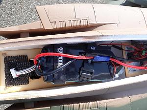

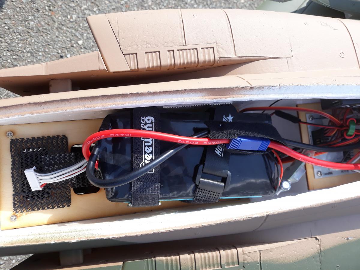

              I flew my maiden on my FW F-4 6s camo version today. I put it together last night and I thought to myself, this has an 8s version as well, so could probably benefit from more power. The FMS setup is 90mm 6s 3546 1900kv, per the website 3,500 grams of thrust at 119amps, and is lighter and more powerful than the 9 bladed FW stock setup. It was epic.
              She flew true on all axis except pitch. I flew her twice on my Hobbystar 8000mah 6s 100c packs. Both times my CG was 188mm back from the leading edge. I couldn't get it any further aft do to the lipo packs I was using. No big deal I trimmed her level and enjoyed the flight smooth as butter.
              2 things, first I configured for landing a minute early, as I normally do on maidens, however the 8mm up elevator trim with the flaps that the manual called for wasn't enough to keep her nose up. Second flight, I added another 4mm to the mix, still not enough. Since she was trimmed in level flight prior to configuring on both flights, so the 188mm forward CG isn't the issue. After the second flight I added another 4mm, so double what the manual calls for, we'll see how the next flight is at 16mm of up elevator.
              2nd thing is flight time, I'm only getting 3:30 minutes before setting up for approach, landing at 30ish percent battery left for the F-4, yet my 90mm FW F-16 with this same power system same day was getting 4 minutes. The F-16 is heavier and I was running 6000mah 50c packs in her yet getting 30 seconds more flight time. The only thing I can figure is a little more drag from the airframe and elevator due to nose heavy condition. Or the FMS fan is working really hard to suck that air through the F-4's fuselage and spit it out the bifurcated exhaust.
              I thought about that due to someone posting on here in one of the forums, can't remember which one, but it was recent, that cutting cheater holes in their airframe gave over a pound more additional thrust. Closer to a pound and a half if I recall correctly.
              So... I'm adding a cheater hole and louvers to the F-4's fan access hatch. My F-16 has 3 cheater holes.
              These same 8000mah lipo packs give me 6 minutes on my Venom 90mm, 7.5 minutes on my T-33 80mm, 6 minutes, average, on my A-10 80mm, 6.5 minutes on my Flexjet 90mm. All have cheater holes or much better airflow due to ductwork in the case of the Flexjet. So we'll see how it goes. Very happy with the flight characteristics of the F-4 though.
              Below is a pic of my battery placement.

                One more thing, I did the mod on the elevator beefing up the control rod, but decided not to swap the servo for a stronger one. MRC's website has it listed as providing 62 oz of torque, that's got to be more than enough, any thoughts? Specific oppositions?
                  Phantom surprised you're only getting 3:30 on the 8000. I'm using the Roaring Top 6250 mah 35C on the stock 9-blade and get well over 4 minutes of aggressive flying while leaving over 30% battery after taxiing to the pits. That battery weighs in at 790 g.
                  I like to fly both my F-4's at around 193 mm CG, so I'm slightly back of where you are. It get's into high alpha on landing very nicely there, as I found that at anything below 190 mm it's more of a 3 pointer landing.
                  On your trim, I'm at -15 for take-off flaps and -18 on landing flaps with deflections of 20 mm and 35 mm. Those % numbers are the amount of elevator servo travel from the servo travel menu, and not the number of clicks on the trim or compensation in the flap system, so it is a true representation of the % amount of travel. The "book" calls for 25 mm and 45 mm, but I felt that was a little too much. Get's off the grass with a nice scale take-off at 20 mm and I like the landing better at 35 mm instead of 45 mm. Still get's into a high alpha there and just didn't fell right at 45 mm for me, but that's probably just personal preference.
                  The other recommendation I have is to use flight modes tied to your flap switch (go to second menu screen and to Flight Mode Menu and set it there with spoken flight mode in another menu), assuming you have a Spektrum transmitter and go to the second menu screen under "Trim Utilities" and set the trim values next to elevator to FM. This will now allow you to set individual trim while flying at each position of the flap switch. You still "trim" in the same way during flight, using the trim switches on the face of the transmitter, but it keeps those trims you put in at each flap setting. You will no longer have to land, go to the flap menu screen, make an educated guess of how much compensation to put, then go try it out. You are able to trim at each flap setting in the air on the maiden. If anything changes (like a different battery or testing out moving it back or forth), you can easily trim at each flap setting during the flight and you're done. This set-up is a MUST for anyone using flaps. You can still put some estimated compensation in the flap menu settings, but that can be just a starting point. You then refine it to the EXACT trim you need in flight in seconds, BINGO. I also set the aileron to FM in the trim utilities because sometimes, both flaps do not deflect with the exact amount, causing a slight roll between settings. This lets you trim there for each flap setting. So on the maiden, you essentially then end up having to trim 6 things, the elevator & aileron in each of the 3 flap positions-kind of a busy maiden, but after the first or second flight you're locked in on all axis in each flap position. When I deploy flaps, I have absolutely no change in attitude or roll and just watching the plane/jet when you change flap settings you almost don't know you've actually changed the flaps. Try it out, you'll never go back to being without it.
                        Hugh, My go to radio for my jets is an old JR 10X with a Frsky modul, unfortunately it limits me to 10 models at a time, but I just love the touch screen and the programming to me is fast and intuitive. I purchased a Frsky Taranis x9d plus which I have my Flexjet and a few other birds on but although everyone raves about it's programming options with open TX, I find it like trying to learn a new language.
                        My flaps are on a slider switch, which allows me to gradually see the models tendencies in flight rather than flipping a 3 position switch and having something crazy happening that I have to recover from.
                        I don't have to worry about flaps matching left or right because I use the full mechanical range on all my planes, so they are physically matched from full up to full down.
                        I can't bring myself to buy another radio as I already have 9, the Taranis was my last attempt at modernizing this aspect of my hobby, and I consider it unsuccessful.
                        Thanks for the response though.
