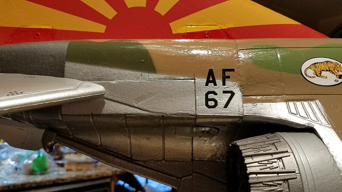

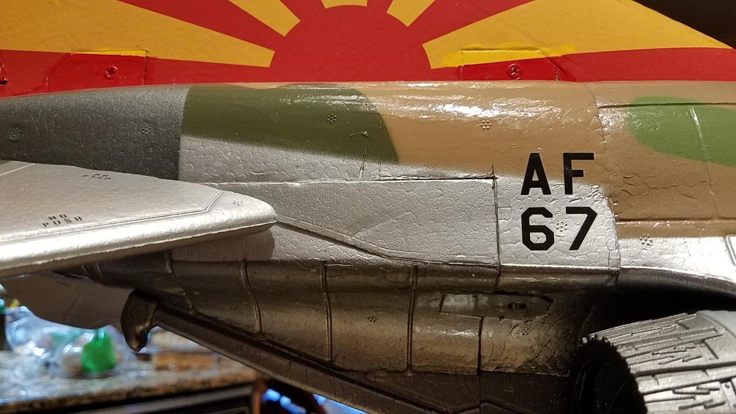

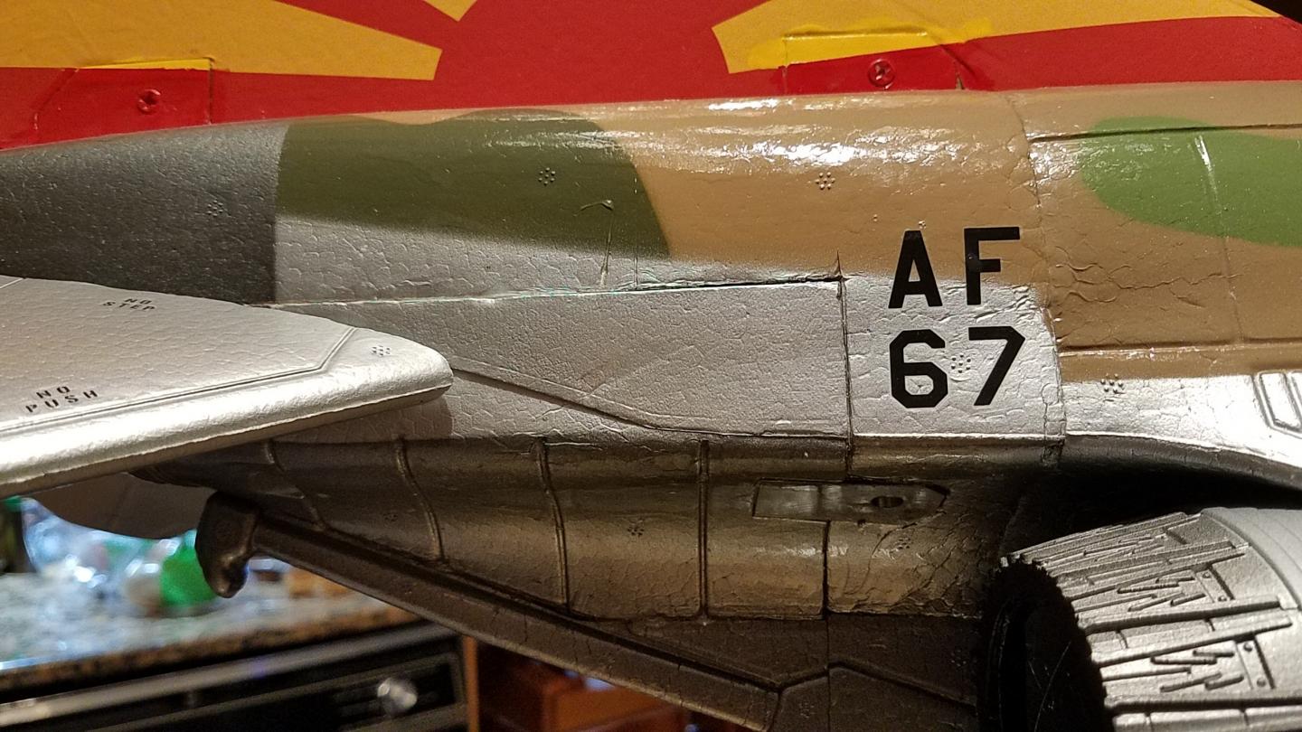

  • Sorry to hear that, enjoy your retirement, there is alot of peple suffering from this virus thing thats for sure. Your F-4 looks awesome though, keep painting them, you got the talent....
    • Originally posted by t33jetman View Post
      😆😂😝 GO BUCKS !
      Just wanted to show off my F4 repaint from last August.
      The Covid19 virus really changed things on my job. We lost alot of money. Click image for larger version
      So I retired from my job July 1st. Now what to do....paint more airplanes.
      Now you're talkin'. Who needs those pesky jobs, just gets in the way of having any RC fun! You definitely look more relaxed now William. Saw your F-4 in the March Madness contest, it definitely was one of the best, almost as nice as mine. Can't wait to see your next undertaking!

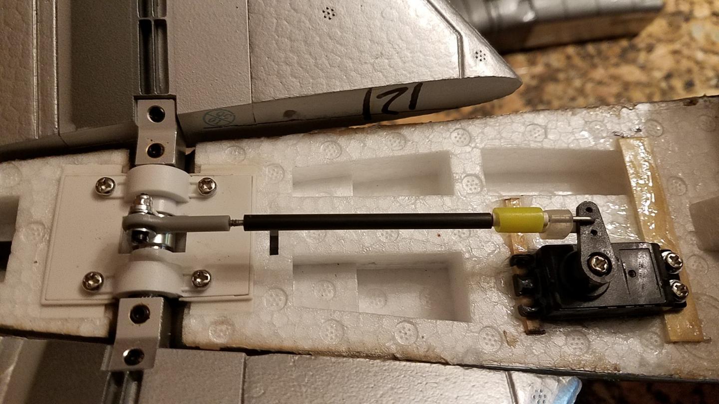

                          • And one more thing BenAtkinsonUK , after about 30 flights the elevator servo has a tendency to come loose out of the foam and the control rod ain't the strongest on the planet, so you may want to beef it up a bit. Many other squawkers have detailed this as well. I epoxied the servo in and added some wood mounts to keep it in place, then used a carbon fiber tube to strengthen the control rod and changed the clevis to something a little stronger. Also, make sure the 2 set screws on each elevator surface that tighten down on the shaft are nice and tight. On my 15th flight, one got a little loose and the left elevator surface shifted, causing a wild corkscrew or something that somehow I was able to get it nose up and ended in a hover 6 feet off the ground, then set it on it's tail with no damage. I don't want to try that maneuver again, makes it impossible to clean out my shorts.
                              Click image for larger version  Name:	20200321_183959.jpg Views:	13 Size:	167.6 KB ID:	265537
                              You may also SEARCH this F-4 forum for the word "dubro". You will see several posts with solutions for the somewhat weakish elevator hardware. I lost control an F-4 when the elevator servo came out of the foam socket...discovering no glue had been placed into the socket to hold the servo in. Luckily, the damage wasn't too bad, and MRC sent me replacement parts free of charge that were needed to get it flying again (wing spar and wing root plastic fittings). Great service MRC! Adding a bit of plywood to secure the servo isn't a bad idea either. As a post-crash modification to the F-4, I also used a section cut from a 4-40 threaded rod for the push rod...to mate with automotive grade Dubro hardware. Bottom line, do everything you can to make this part of the plane bullet proof...apparently there's a lot of stress on these components.
