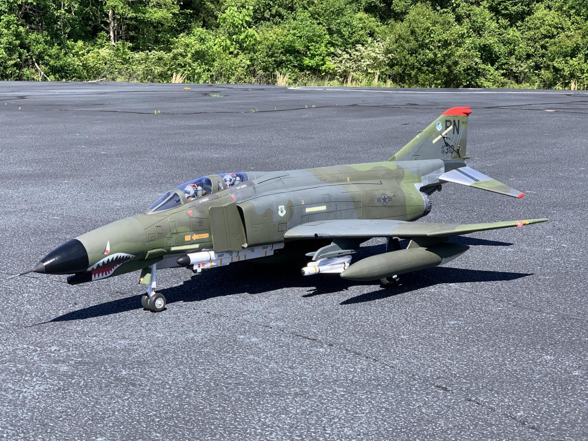

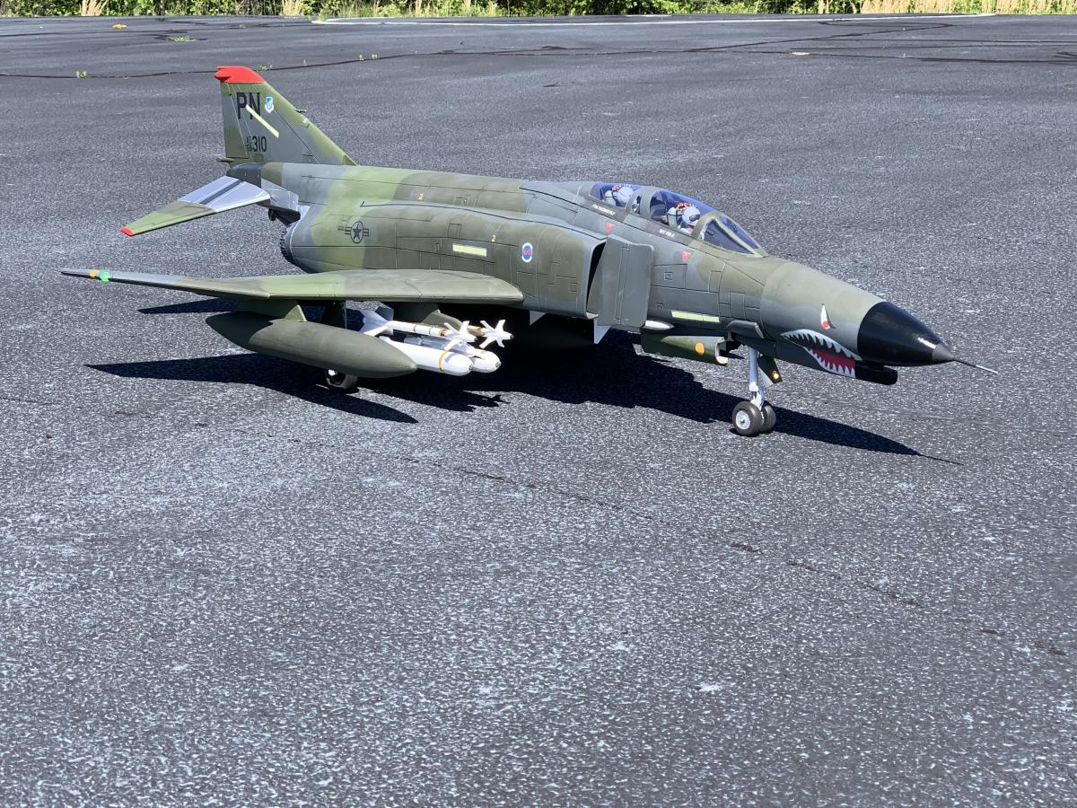

Ready for inspection! Here's the final product. Weapons, "E" nose, cockpit, pilots, TIESO and centerline tank are 3D printed. Only one flight on it so far. It has survived the maiden but was pretty nose heavy and I bounced the landing shearing the nose gear pin. Already repaired and ready for the next sortie.
Another masterpiece, vduniec ! Your conversion and loadout compliment the livery so well. :clap:Live Q&A every Tuesday and Friday at 9pm EST on my Twitch Livestream

637529 F-4C as she was at William Tell, 1982. 191st Fighter Interceptor Group out of Selfridge ANGB, Michigan. The bird is "wrapped" in Scotchcal 2020 self stick film, which is a touch thicker than the stuff Callie uses. Estimating about 400 separate pieces to do the job. Took about 2 months.
Maidened today. The 7.5" CG is no good. Second flight, moved the battery up as far as it will go and still not stable in pitch. Vicious roll to the left, ended up with 1/4" right aileron trim. Not impressed so far.
Will move CG further forward, and use combined flap and aileron trim 1/4" on the right side. Hoping to cure it this way and have neutral trim on the left. The adverse yaw associated with left aileron down makes turning right no fun.1 PhotoComment
Outstanding looking job, just beautiful. Your vicious roll to the left is very curious, especially having so much trim without stopping it. There must be something off centered, the F-4 isn't that messed up. This is probably going to sound stupid, but are you absolutely sure the elevators are perfectly equal in position and travel. I had the set screw come slightly loose on the right elevator once and it suddenly corkscrewed something awful, even from being only slightly off. Somehow managed to end up in a hover 6 feet off the ground (don't ask me how, it just happened) and killed the power with only minor damage, but "loaded" pants. :poop: First thought it must be something with the ailerons, but finally realized one elevator was slightly loose on the shaft.637529 F-4C as she was at William Tell, 1982. 191st Fighter Interceptor Group out of Selfridge ANGB, Michigan. The bird is "wrapped" in Scotchcal 2020 self stick film, which is a touch thicker than the stuff Callie uses. Estimating about 400 separate pieces to do the job. Took about 2 months.
