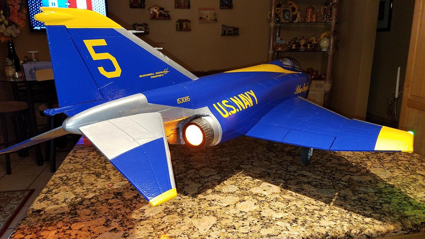

          Regarding the MRC nozzles, after removing the stock ones and before gluing in the 3D nozzles, line them up correctly as they are not perfectly symmetrical. They only fit correctly in one position, so rotate them on the foam and mark them before you glue them. One of the nozzles MRC sent me early on was way out of proportion, almost elliptical and had to send it back so make sure both are correct before installing.

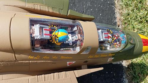

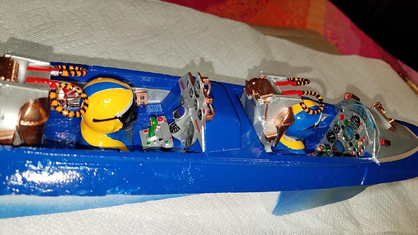

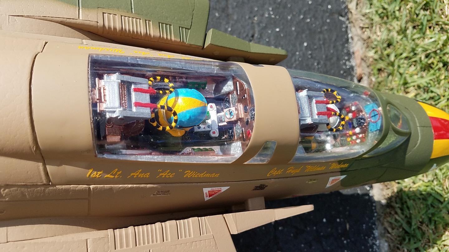

          The 3D cockpit parts are actually, as LB said, easy to fit in after you fix them up. His cockpit is very scale, so it is a good one to emulate. I tend to go the other direction, a bit gaudy. I figure if I'm going to do it, I want the pieces to stand out and hardly anyone at my field notices that they're far from scale but they do notice that it couldn't have come that way from the factory (even if they roll their eyes a bit). :rolling_eyes:

            Hugh Wiedman, Good call there, Hugh, on the Nozzle Alignment; I had forgotten. I almost glued the first one on incorrectly during my build. Thank you, Sir. Best, LB

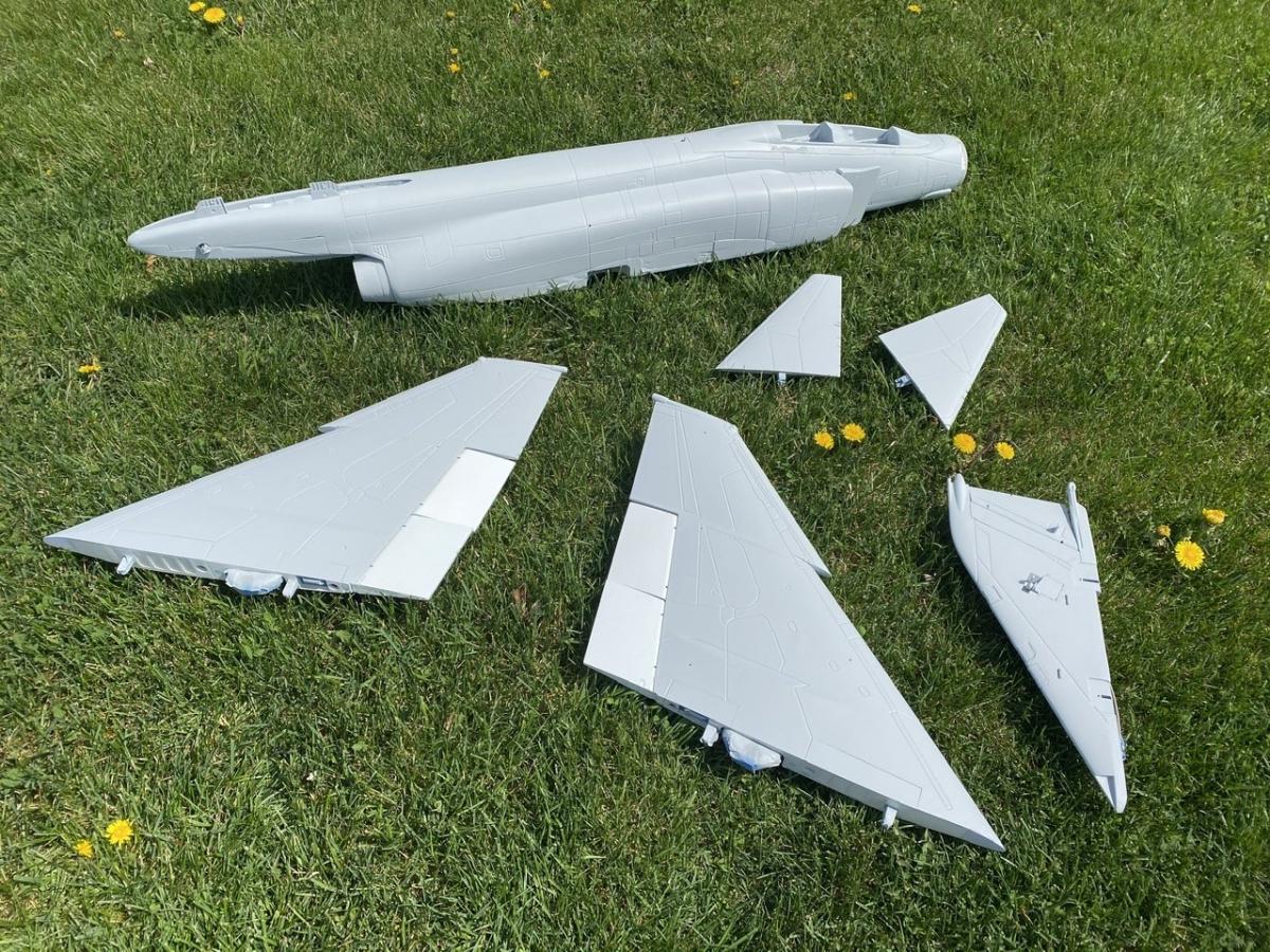

              I am working on painting my F-4,
              I have the bottom surfaces painted. The top color I had mixed is too dark. After looking at full scale pics I will have to lighten the gray quite a bit.

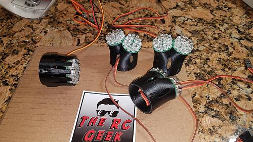

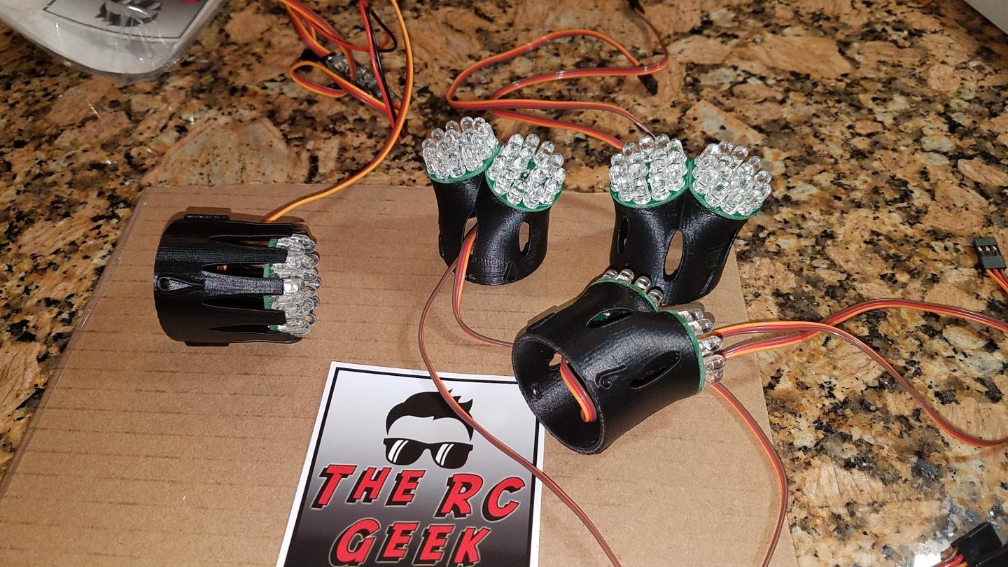

                    This being stuck inside and not being able to fly is getting to me. My New's Years resolution of "More Flying, less Modifying" has turned into a joke. Should have been "Spend all the rest of your meager funds on RC since you're about to go broke in the Stock Market so go out with a BANG :boom:. Just finished building out my F-18 3D cockpit and found out the RC Geek just came out with a "New and Improved" afterburner for the stock F-4 and F-18 outrunner with not one, but two split LED cones for the 2 nozzles. I had his original single LED cone in both my F-4's (and had the same ready to go in the F-18 when finished), but you just know that I had to have anything new and improved and received 3 cones yesterday. So now I'm modifying an earlier modification on the F-4's. For the F-18, I'll eventually end up putting an inrunner in that so in regards to the AB there, I'll be modifying a modification of a modification and I haven't even finished painting it's livery! Holey :poop:, I need to get back to flying. Anyway, the original AB in the F- 4's looked great, so we'll see how this new one burns. Any little bit extra is a bonus. I wish Chris would stop coming out with such cool new improvements, next thing he'll do is make an AB that shoots out flames and smoke; can't wait, I'll be first in line. He also just came out with a smaller AB for the twin 70mm SU-30, which of course I have the old (just 1 month ago) larger ones already in. May have to wait on that modification, but it reportedly does not reduce any EDF air flow as the larger ones do. Damn!!!!
                    Photo below shows the 3 new twin LED burners, versus the original single. There's 30 individual LED bulbs in the new twin, pointed directly out the nozzles, and only 21 bulbs in the original. Guess that's 30% more light, whoopee!

                      I just bought the same burner for my F-4 build. I am still in painting mode. I am on my 3rd jet in 2 months. I am going to go broke if this virus doesn’t clear out.

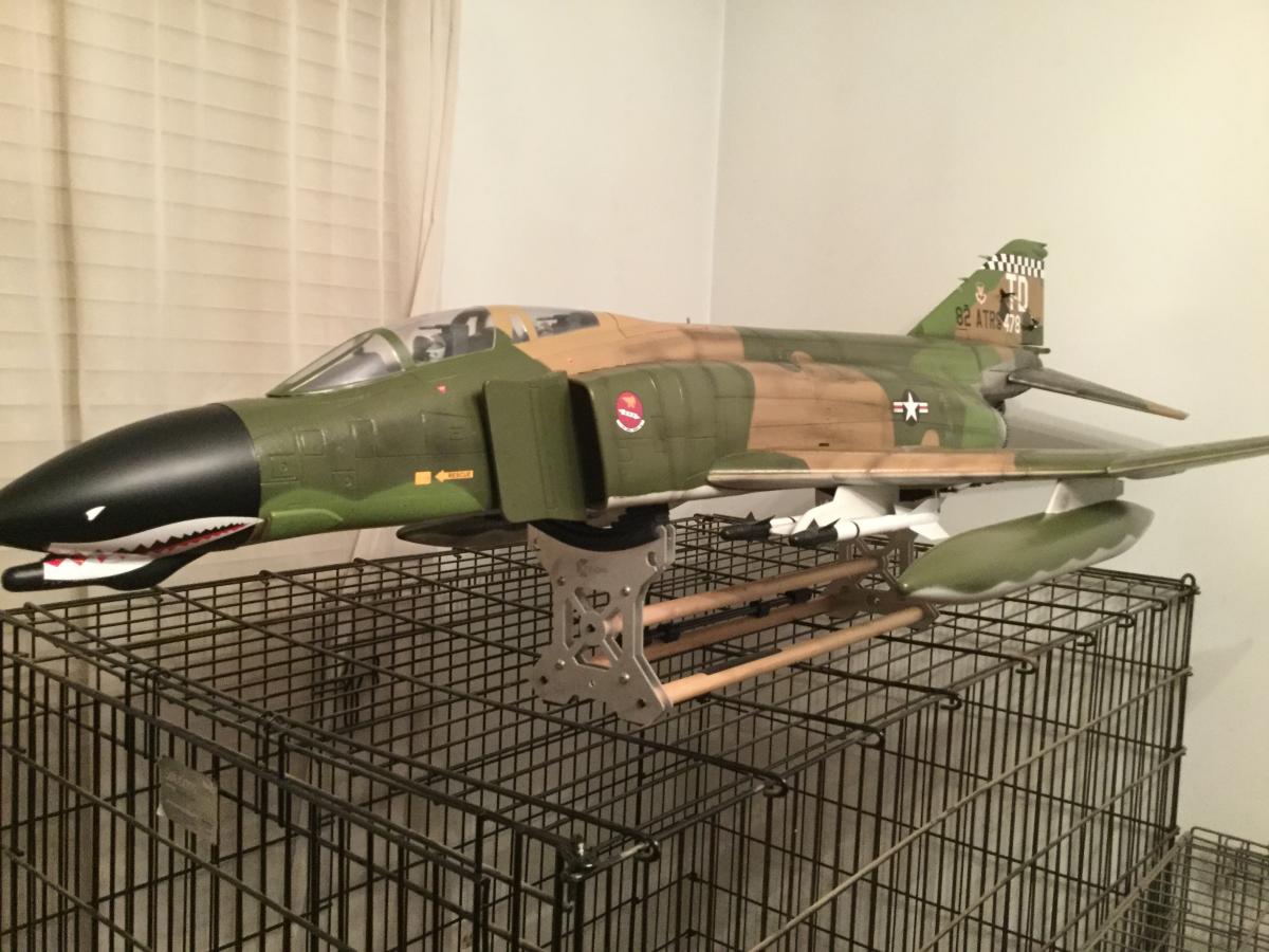

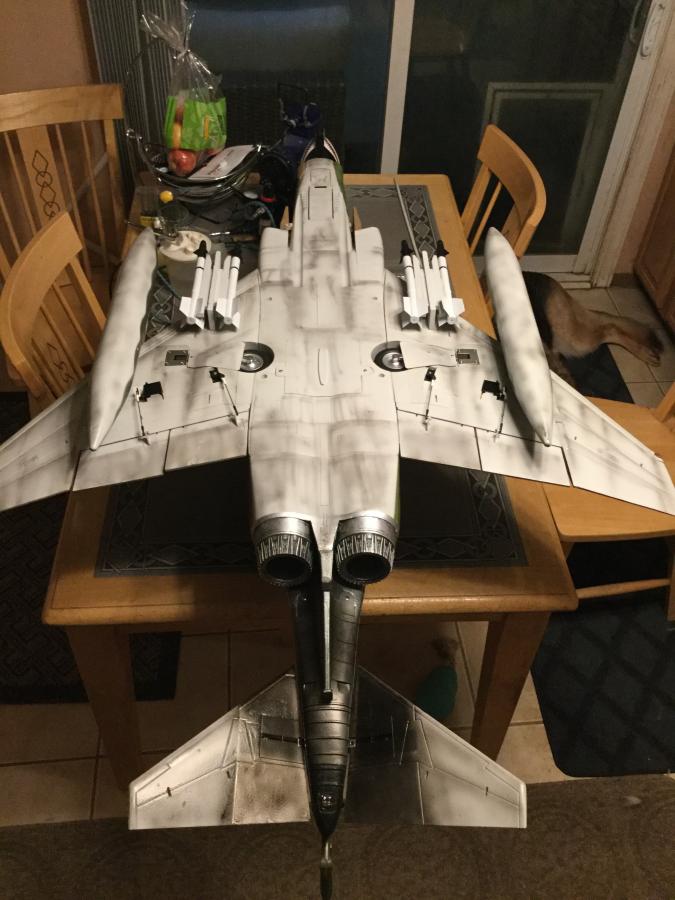

                          Well since I’m recovering from knee replacement I decided to dirty up double ugly.

                            Rcfiddy1 Best wishes for your speedy recovery! In the meantime, nice looking dirty bird. The acronym for the last four words in your previous post made me chuckle.

                              Rcfiddy1, Lovin' the 'grime', Sir. Best, LB

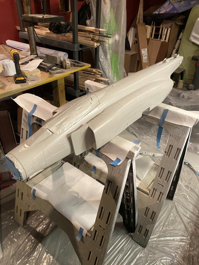

                                Hi guys,
                                It took me 3 hours and 6 test sprays before I finally got the color I wanted for the top of the F-4. It’s been a nice 2 days weather wise and the plane is going to cure in the sun the rest of the day.
                                I will let the latex paint cure until Friday before I start working on the panel lines and other details.
                                I called Larry at JHH and he had 5 pilots left in stock, he now only has 3. I will work on painting the 3D cockpit bits while waiting for the paint to cure.

                                  WN, If it's Gull Grey (FS 36440), it's the same as the '70s Navy Phantoms and the Behr HD Code is 221419224369 for the semi gloss. Anyway, looks like you're' bingo' on changing colors at this point. Lookin' good, Sir. Best, LB

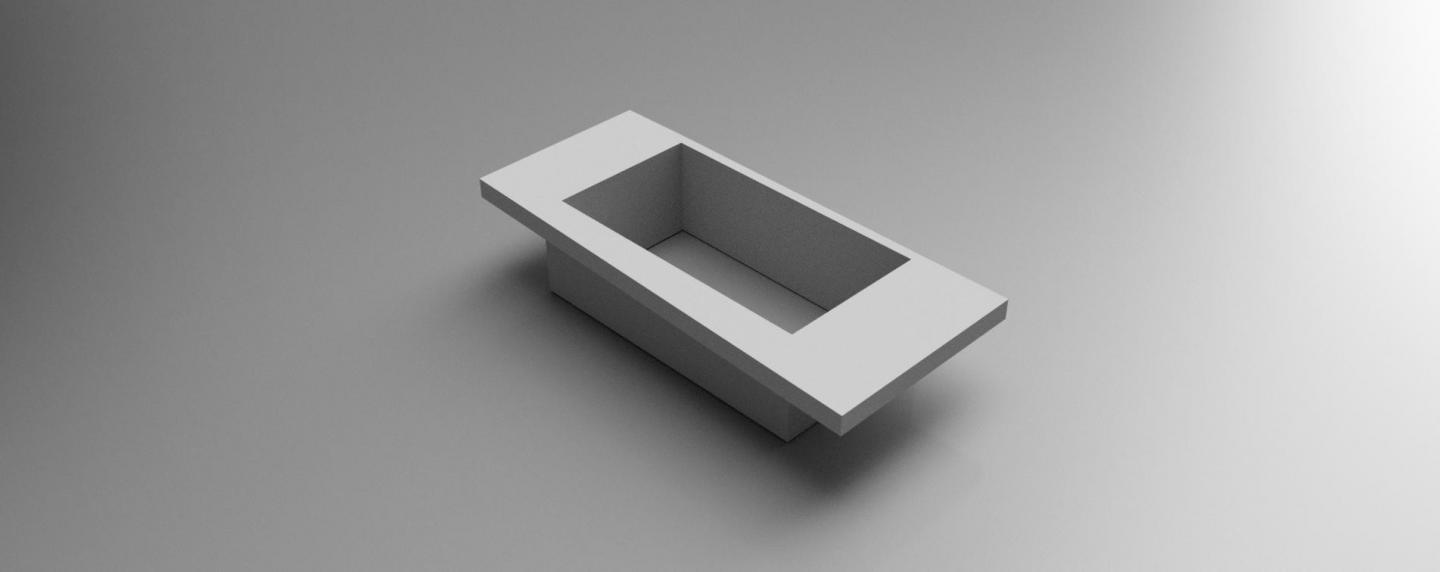

                                    If anyone is interested I made a servo tray for the elevator servo. Gives a bit more area to glue into pocket. I drilled holes for servo screws. I suggest printing it solid top/bottom and perimeter.

                                      Rcfiddy1, Thank you. Best, LB

                                        Very nice Thank you
