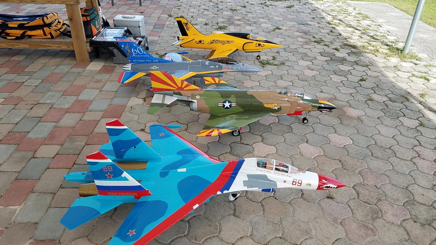

                                  Agree with Evan D , I fly mine on a RT 6250 mah 35C (stock outrunner) at about 195-197 mm and get about 4 1/2 minutes of aggressive flying. Got 4 flights in today on the F-4 and four flights each on 3 others, the more I fly it, the more I like it!

                                      Hugh, I meant to also say your jets look great. Love the phantom. I'm waiting on Callie Graphics for this scheme
                                        • 2690
                                        #4259
                                        That's going to be one sharp looking Phantom, I love all the different graphics Callie has for this and you picked a great one.
