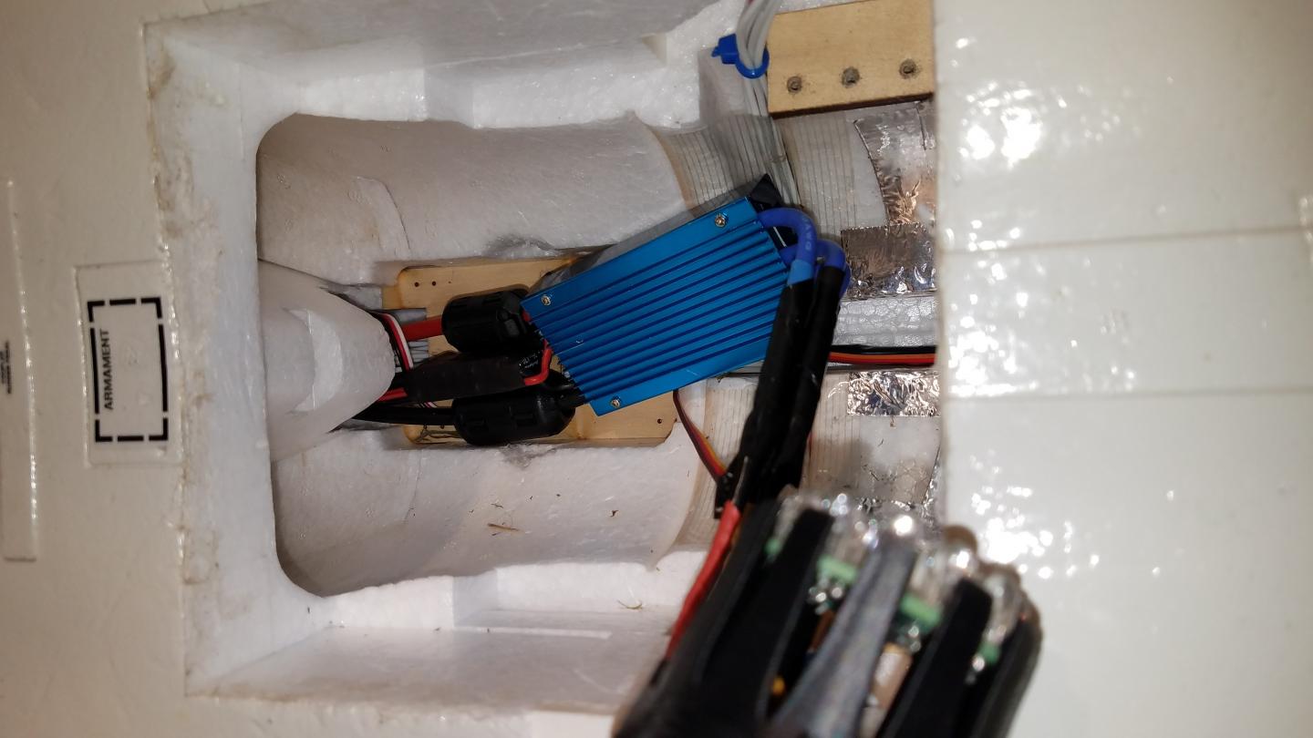

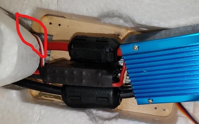

                            OK GliderGuy I finally got the RF chokes you posted about after BenAtkinsonUK lost his F-4 on a set-up and programming I had recommended to him:face_with_symbols_o, which of course I have the exact same receiver, positioning, AS3X programming and sent him my .spm TX files on the 2 that I have, so hopefully most guys will learn not to take my advice on anything! :triumph: I put the chokes and also a remote satellite carbon fiber receiver in both F-4's and am fitting them in others as well (so far found the 7mm & 13mm most useful). Although I have yet to have a signal loss on anything except one jet that I stupidly ran the active antennae RIGHT ALONG SIDE OF THE BATERRY (can you say clue-less) , but after Ben's experience and your post, I felt it was better to be over cautious. Heaven knows I don't need a signal loss to bring one of my birds down, I do that quite well on my own.

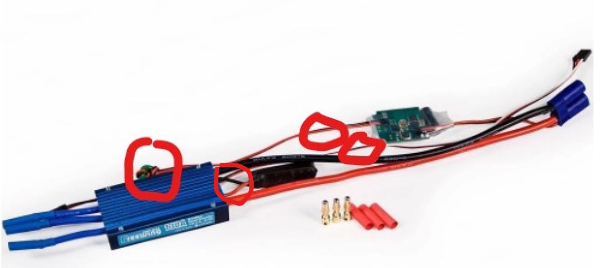

                              Hi Hugh...Looks good, Be sure EVERY wire going forward has a small choke on it or at least a green ferrite ring on it. Place the added chokes as close to the ESC as possible. See red circles in the photos for the wires I am talking about. Note: I am not showing the position for the chokes, but just pointing out all the wires that probably benefit by having a choke. Most especially important is the wire that connects to the receiver/throttle port. No need to move the position of the green ferrite ring. It's fine where they put it, I reckon. I didn't move its position on my bird's installation. Small chokes on the small wires is sufficient. You've got the big wires done right!
                              I did not put any RF chokes on the motor side of the ESC (3 blue wires to motor), and I have not had any issues. If you have room, putting a choke on the 3 blue wires placed near the ESC would make your system even more bullet proof...but it may be overkill and not necessary. Like I say, I didn't put a choke on the blue wires.
                              Bottom line...do what you can and what you have room for.
                              -GG

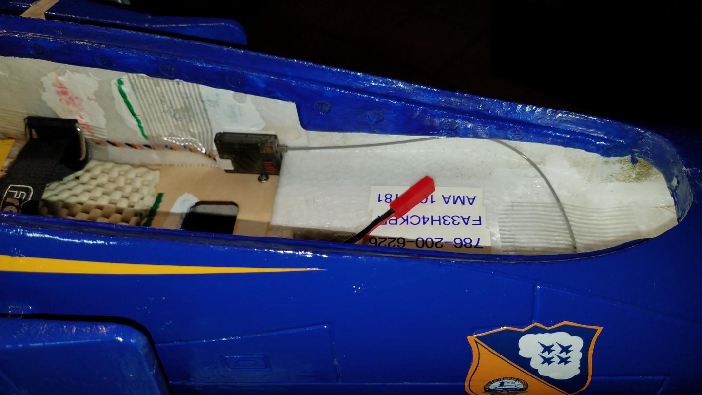

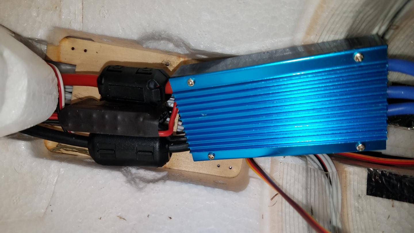

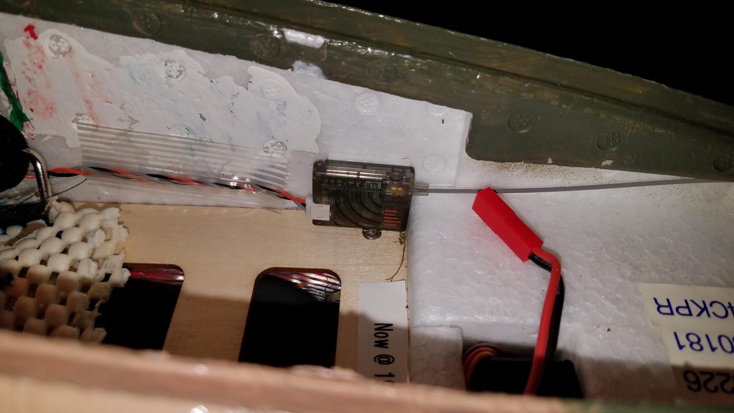

                                  Hey guys!!
                                  SO....positive update...I've got the bird back together - looking good so far.
                                  Now...electrics....bit of a rats nest but I've done my best to keep it neat and away from the RX antenna.
                                  I've installed ferrite clips/rings - everywhere...haha. Both sides of ESC, right up against the esc - and on throttle cable. As described above. I've installed the RX away from the ESC - but it is under the battery tray, however the main antenna is in a similar place to where I mounted last time (RX was behind the main board). I found under the battery was easier to get to (and I have changed the orientation in the app, so the AS3X corrections are made in the right way). Extra cables from the RC Geeks Multi burner.
                                  I'm gonna range test it in all orientations before I fly. I have also fitted a satellite Rx too for extra insurance.
                                  The antenna are all at different angles so should be good.
                                  Any feedback welcome....
                                  Whats everyones CG measuring?
                                  Again - thanks to everyone so far for your help its been brilliant.
                                  Things are moveable to an extent though I have taped (with gorilla tape!) the rx in place. Most other bits moveable (so would the rx, but just be a pain)
                                  Thanks - ben

                                      Nice Rebound, now go out and show us how it's done. GliderGuy I did get the wires you circled in red "choked" down in my photo that you circled (thanks again), that's why the choke on the black lead is larger, it also includes the throttle RX wire. As far as CG BenAtkinsonUK and at the risk of giving you more erroneous information on top of my previous batch of "winners", I moved my CG back from the book value about 4 mm to 5 mm. If I remember correctly, the book CG is 190 mm, so I found, for me anyway, I liked the way it flew at 194 mm.
