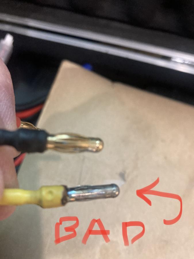

            Most interesting as in….this is a first for me!
            1) The ESC on my F-4 failed to initialize (no beeps).
            2) Grounded the F-4 and got her home to trouble shoot.
            3) Had another ESC, so opened up the belly to perform the replacement.
            4) Noticed the Yellow connector between the motor and ESC was discolored. Not bad, but noticeable.
            5) Replaced the motor and all is fixed. The ESC initialized and the new motor worked.
            I have never seen high-resistance connection heat damage in an “always mated” connection of this type. The damage is significant and seen in the photo below. The male connector was melted.
            Factory defect? Who knows. Something was amiss.
            It took a couple of years to fail. This bird has well over 1,000 flights on it.
            Note: When I corrected the “problem” on the original motor (new connector), the original motor worked fine.
            -GG
