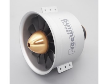

                              Think I'll be stuffing this into the new F4.........Freewing Metal 90mm 12 Blades EDF with 6s 4068 1750KV ...all opinions appreciated....:punch::f4: Click image for larger version

                                #5535
                                Mine is the same metal frame, alloy i think,, with the 1835 kv.... dont forget to reset cg cause its heavier than the plastic one..

                                  #5536
                                  f4u...You talking about the FMS 1835? Have that in my new unflown camo F4...good motor..... this Freewing 1750 has redesigned blades and is supposed to deliver more static thrust. Unfortunately, I am so simple that I read it as "able to get off the grass better" That is why I need help !! :punch::f4:
                                      I've got the FW 4068-1835Kv 12 blade inrunner in both of my F-4's. As a matter of fact, put those in my FW 90mm F16 and both of my FW 90mm F-18's. Love that fan and the sound of a 12 blade is sweet. I'm sure the 1750Kv will be similar to the 1835Kv, so you should enjoy it. More power than what was in those aircraft stock (although several were purchased early on when they came with the outrunner :thumbsdown:). I fly off grass so any additional punch at take-off is well appreciated. I'm now flying all of those on the new 740 gr SMC HiV 5900's (used to use the 6200's which weighed 840gr). On the F-4, I have my timer set at 4:00 and usually come down there or at 3:50 (as much flight time as the 6200's or better since it lost some weight). Suggest you balance it close to the manual recommendation of 190mm. I'm at 195mm and like it there, as for me the F-4 really gets squirrely any further back, unlike all the other EDF's I have balanced 20-40mm further back. Just my opinion though.
