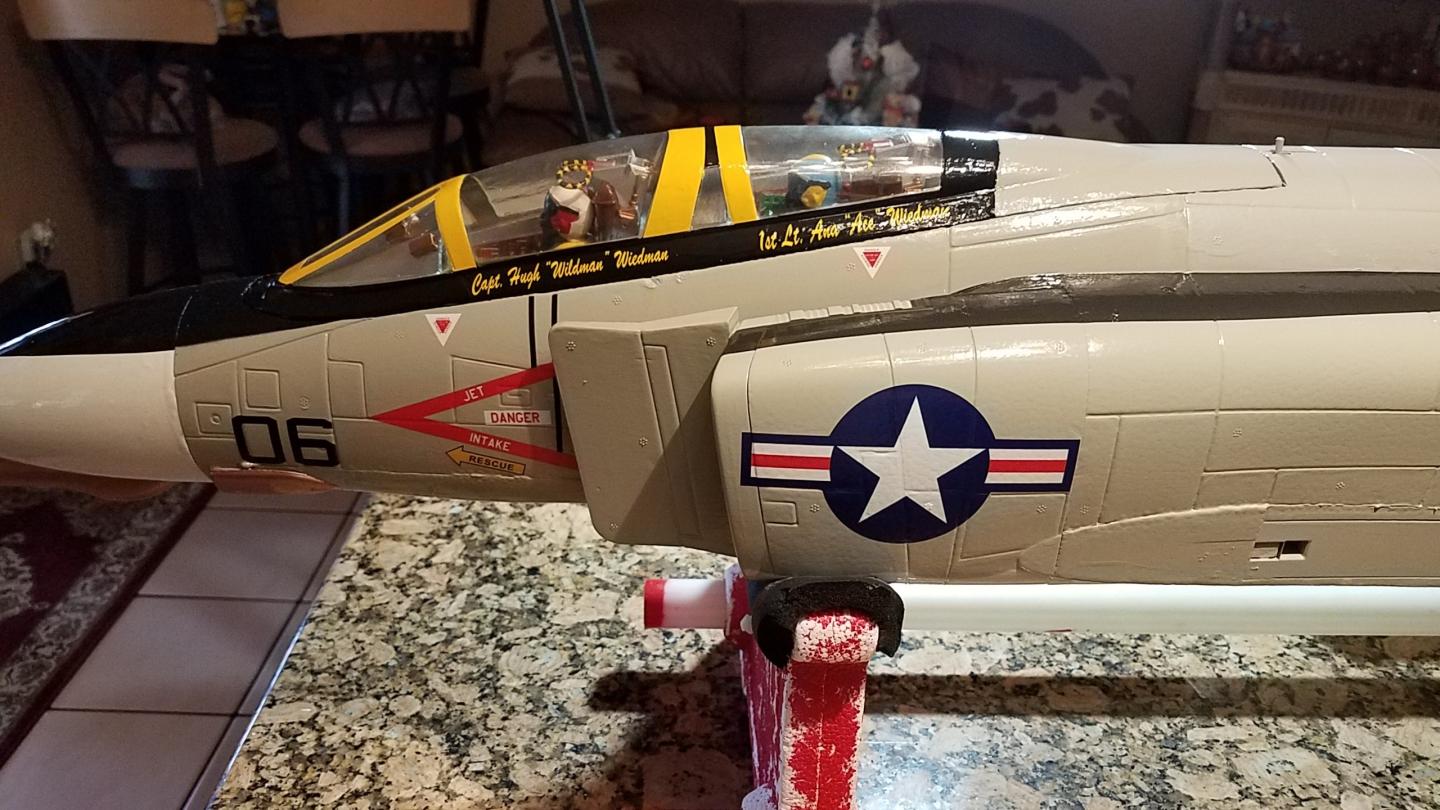

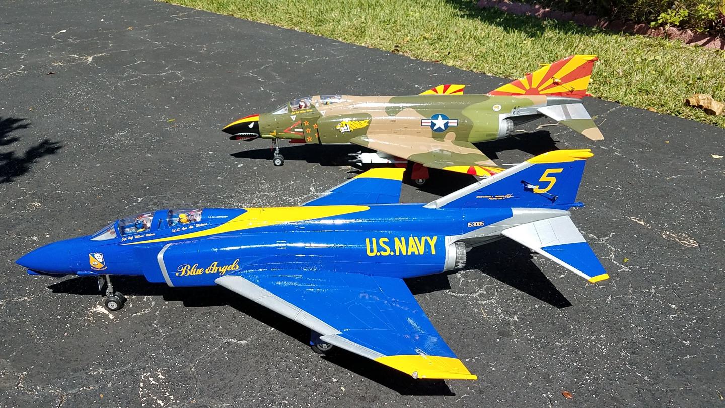

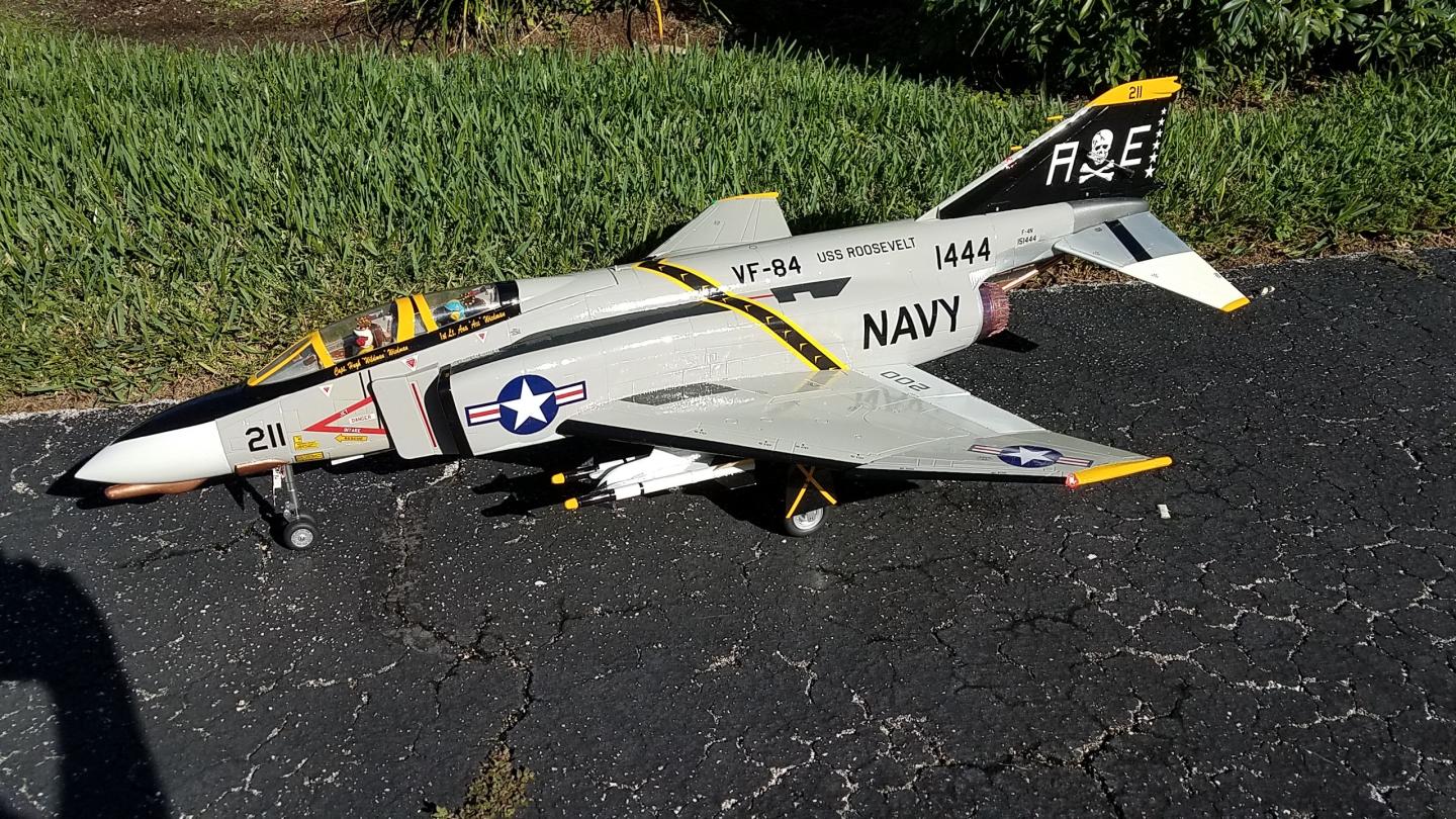

                  Obviously I love the 90mm Freewing F4, have 2 of them, both with the 12 blade inrunner. :f4::f4: So I just finished a 3rd, this one in 8S. :f4: Did the Jolly Rodgers scheme. Unfortunately the Grey Ghost comes with decals applied and tail painted :face_with_symbols_o which makes redoing it all the more difficult. Consulted with the "Master Builders" Elbee and davegee on what to do with unwanted decals and both agreed that removing them was almost impossible without damaging the foam, so I took their advice and just painted over them. First I applied some clear Varathane Spar Urethane (same as the MiniWax others use), then primed the area and painted with a decent color match from HD. Would've saved a hell of a lot of time if they just left the decals off but I guess there's more guys out there that just want to put it together and go.
                  Did this to all the decals:

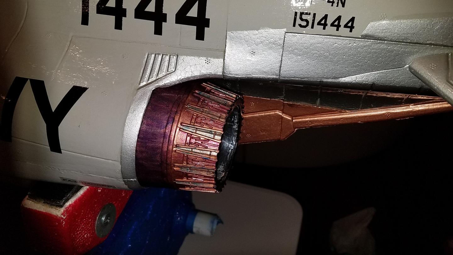

                  One thing to watch out for, when I removed the fan to install the afterburners, the wood mounts just fell out. Virtually no glue holding them in. Also strengthened the elevator rods and mounted the servo in tight.

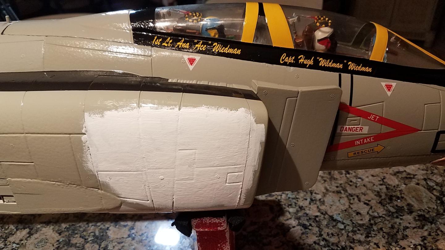

                  Used a spare 3D cockpit I built out earlier for now, but planning on doing a cockpit specifically for this one, maybe after Christmas. Added a little bit on the underside for visibility but it's ready to go for now, just need some decent weather as the last 2 weeks have been horrible. Most likely won't maiden until after the Holidays as I'm also planning a road trip after Xmas to N Carolina, Tennessee and Georgia. Good things come to those who wait. Just got some of Danny's new SMC 8S HiV 5900 packs for this one, can't wait to try them out, weighing in at 940 gr. The other 2 6S F4's are flying on the SMC HiV 6S 5900's which only weigh 740 grams. They fly awesome on those lighter weight packs so we'll see if the heavier 8S packs seriously hurt the flight characteristics.
