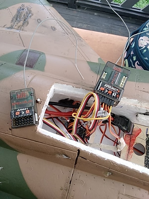

                Hi phantoms replaceing my ar631 6 channel rx with ar8360t+ so excited bout that will now have thrust reverse,, awsome.. its a telemitary rx but will take me a bit to get goin..on that cya Click image for larger version

                    And you can use channel 8 for nosewheel steering. The AS3X+ firmware adds nosewheel stabilisation. Note that most of the new style AS3X receivers can be updated.

                        I only have an nx7e at the moment,,,(tighta???) Me,, should spent extra couple hundred for 8 or 10.... :rolling_eyes: but with the plus receiver its been said(extra channels)??? So question is can i still have seperate channel for steerable nose wheel inc still having reverse

                          The AR 6/8/10 RX's have 14/12/10 "Ghost" channels in addition to the "plug in" channels, so all have 20 total channels. The plus upgrade did not change this, only making the gyro more responsive and allowing a separate programmable gyro for nose wheel and additional separate gyro capability for something like Thrust Vectoring nozzles.
                          In addition to their RX upgrades, Spektrum also upgraded several of their TX's via online downloads. I know for certain that included my IX 14, making it a 20 channel TX (Sweeeeet, saved me $1,200 by not needing an IX20). I believe the NX also can be upgraded to 20 channels, but not sure about the NX7e.
                          Regardless, you can use your 7 channel TX if not upgradable, the way it is for nose wheel steering and 6 other plug in servos with an AR8360T. Or use that 7th channel for reverse. With an AR637T in the F4, no separate nose wheel or thrust reverse. If your NX is upgradable with more channels, you can have both with an AR8360T.
                          Why have so many ghost channels and only 6/8/10 plug in channel? I use ghost channels (aux 1-15) for all kinds of 💩. Right top knob, aux 3 (for example) gives me the ability to adjust gains in flight. My flaps are tied to switch D with delay on aux 1. I also designate switch D to aux4 and use that to change gyro flight modes. So my switch D does 2 things, first deploys flaps with a programmed delay of 4 sec, and increases gyro settings (without that delay) for take off flaps and even more on landing flaps.
                          There are many other goodies to assign to the ghost (non plug in) channels as long as your TX has those channels.
                          Enough of my mouth diarrhea 🤮

                            f4u ausie. Just looked up the Spektrum TX upgrades. Your GOLDEN!!! Your NX7e can be upgraded online to 14 channels! More than enough. Others to 20 but you saved a bundle by not getting a 14 channel TX, so now it's free! The only real difference with a 14 vs 7 channel is the 14/20 has more switches, trims, etc.
                            So you can get an AR10360T, use 10 plug in servos, etc. ports, use another 4 ghost channels for stuff, all with a 7 channel TX. So whose the smart one now, the guy who bought an IX20 for $2000 US, or you who saved mega bucks, ended with 14 channels, and can use the saved money for more aircraft? Very devious of you!
                            I have enough problems with 2 sticks and several switches, more would just blow my punny brain. :exploding_head:
