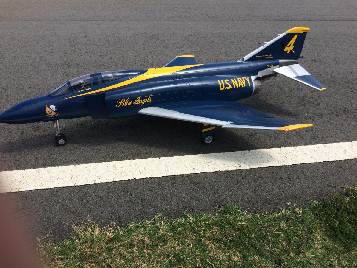

                                          • 5415
                                          #3780
ID:	209889 Welcome A.B.! Mine did four air shows this weekend. Spectators were standing and cheering... :)
