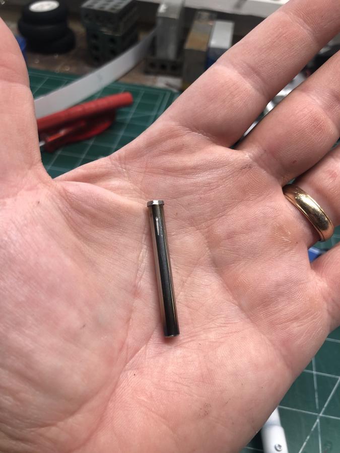

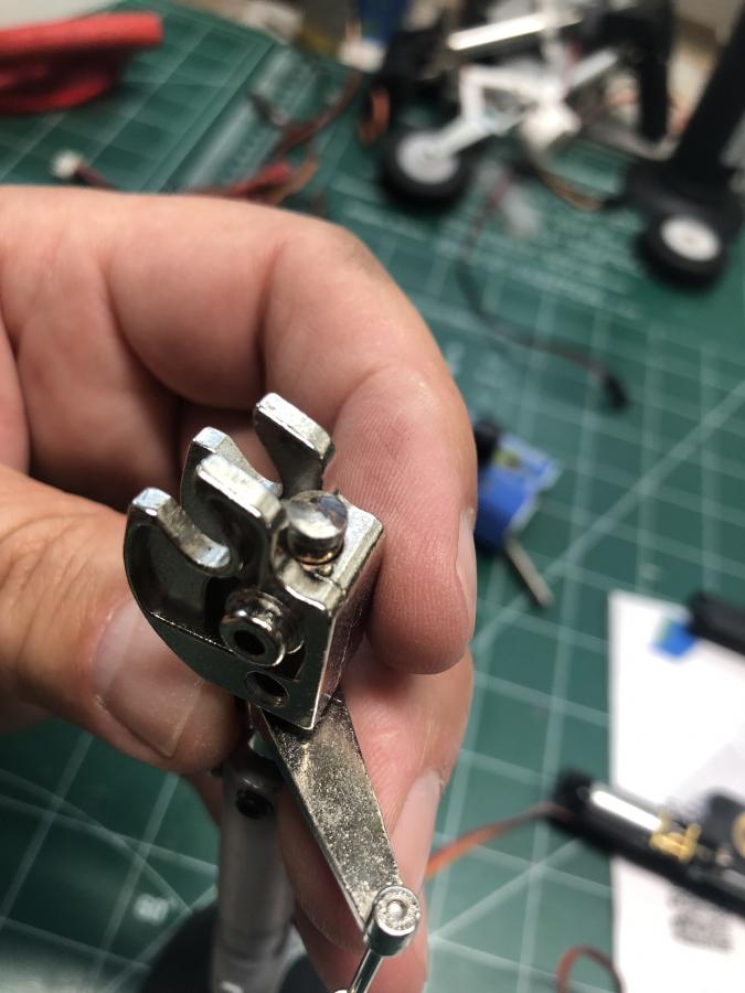

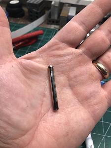

                                    #3737

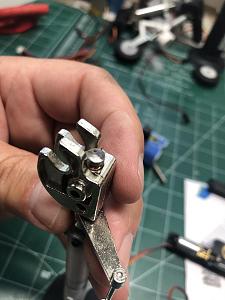

                                    Hey guys wanted to share a fix for the F4 Nose gear. I sheered the pin on my second F4's 1st flight. X wind and blew me off the runway in to the grass ... Was not rough at all. Fairly gentle landing I wouldn't call it a greaser but hit was nothing excessively hard. I was really surprised that I broke the nose pin.... Well after inspecting the pin I noticed the pin is ( or looks like) pot metal on the inside.

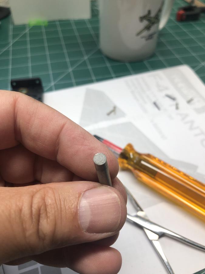

                                    I ordered the following part from Mc master car, Part # 90224A155 10.99 each (WELL WORTH IT)

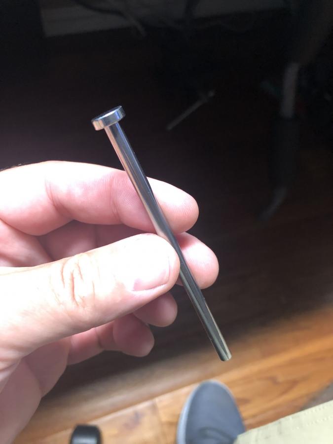

                                    With a bit of Dremel work, you can turn this 5mm case hardened steel pin in to this.
                                    This should not bend or break!

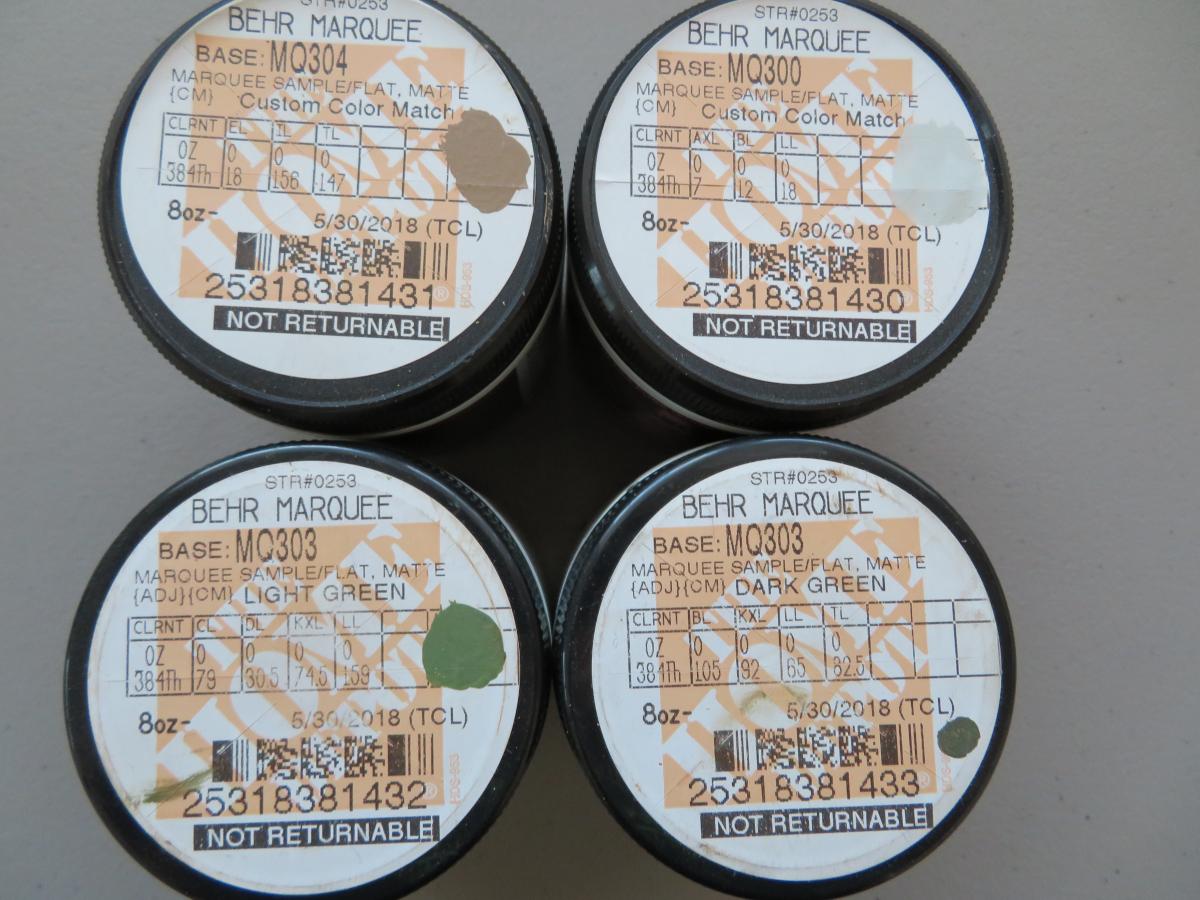

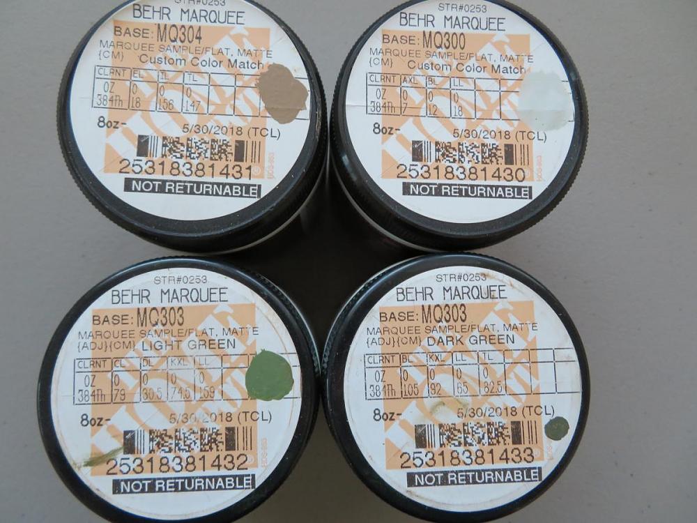

                                      Originally posted by Tom Lasko
                                      New guy question....I was told somewhere in these 185 pages that the a Home Depot Behr flat paint codes are in here for a factory paint match.
                                      I was hoping someone could help me identify where they might be. Thanks
                                      I hope this is what you are looking for.

                                        #3739
                                        Thank you okcrcpilot, that’s what I was looking for exactly!
                                        The guys behind the counter at my local HD vary greatly in skill level color matching paint, so this should help . Question: did you feel that the samples above where a “spot-on” match to the factory paint ?
                                          Yes, these colors matched my camo F-4 to a "T". Now I bought my F-4 in March of last year and don't know how consistent Freewing is with their colors, so YMMV. Glad I was able to help.
