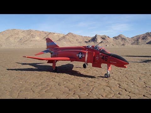

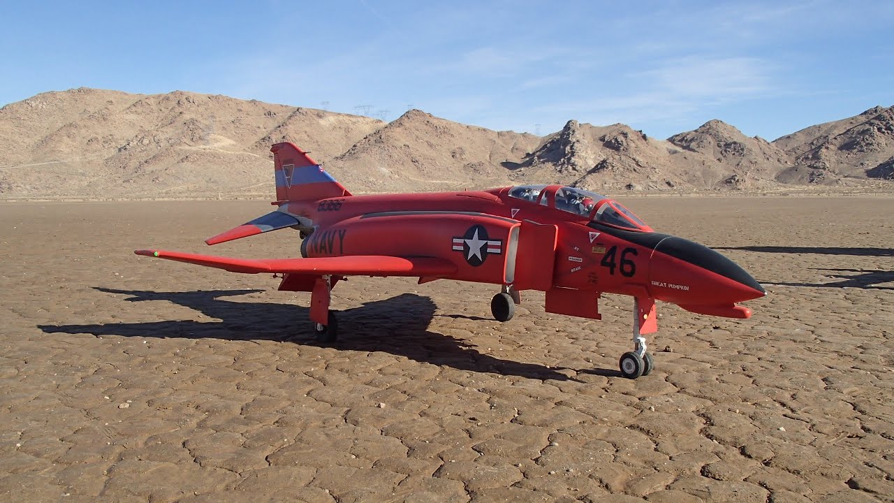

                  Chris Wolfe's (aka "The RC Geek") wonderful repaint of the Freewing F-4D, done up as a QF-4B drone over Rabbit Dry Lake...😎
                  This one's on 8s and flying on a Jetfan 90mm...
                  Enjoy 😁!

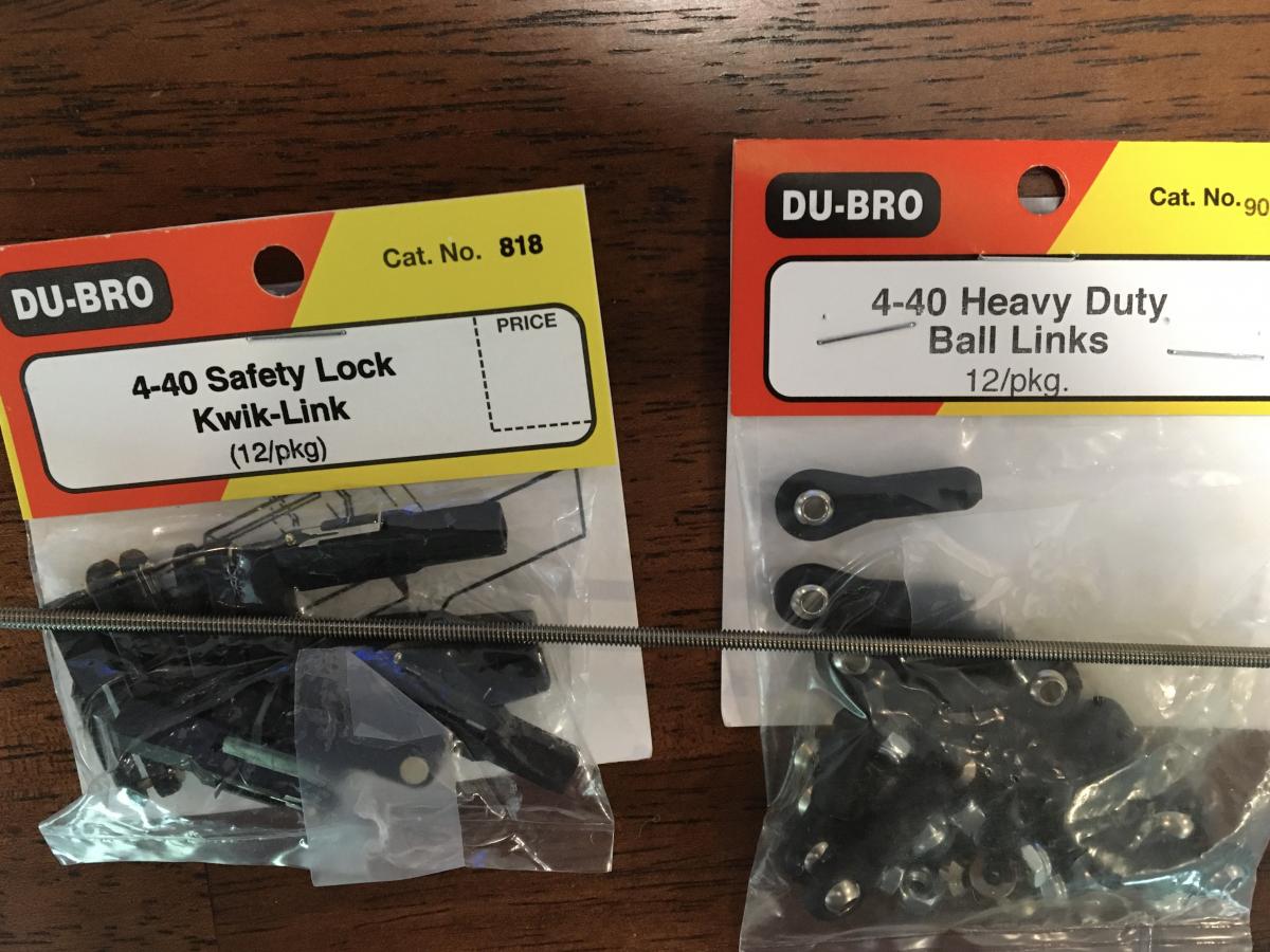

                        Hi everyone! I've been trying to read all the postings to look for recommendations for the elevator servo of the F4. Have gone thru lots of goods stuff for sure! Probably the answer to my question is still on the unread threads but I'll ask anyways, is better to replace the elevator servo with something better or just beef-up the rod and clamps? I got my F4 last Thursday and I want to make all improvements while is still brand new. Thanks!
                        • GliderGuy
                          • 1416
                          #4732
                          Congrats on your new bird! Not aware of issues with the servo that might call for an upgrade.
                          I lost an F-4 due to a ball link breaking, so definitely upgrade the rod to a 4-40 and heavy duty linkages. Consider better glue for the elevator servo or even add some plywood around it to screw in to. Beef it up....bottom line.
                          Search on “choke” or “RF choke” or “ferrite” and consider installing these as detailed in the posts. Lost another F-4 and an A-10 before installing them....no losses of planes with high current ESCs after I began to use them.
                          If balanced at the book CG, watch for the nose to drop if you chop the power on final...so ease off the power slowly on approach. Ref what others have posted about the best CG location.
                          Buy a few spare nose connector gear pins (MRC F-4 spare parts). The brittle metal will snap on a hard landing. I embedded some metal onto the bottom of the under-nose radome to act as a skid plate for when this happens.
                          Pay attention to book throws and the amount of flap-elevator mixing and elevator trim amount. Make sure both FFSs (elevators) are aligned identically and use thread lock on the FFS’s screws.
                          -GG

                              Thank you for this awesome information!

                                Hey Glider guy what was the choke you purchased for the F4, by the way great info much appreciate

                                  Suggested reading are posts #4428 and #4455.
                                  Especially the photos are helpful.
                                  Here is the link to the RF chokes. A cheap, easy, small, light weight “prevention” thing. I have over 1000+ flights each on the F-4, AL37 and MiG-29. No radio glitches on these since installing the chokes. Lost an F-4 and an A-10 twice due to unexplained radio things before I began to use them. A HAM radio guy suggested this “solution”.
                                  NOTE: Only seem to be needed on high-current ESC EDF jets.
                                  https://www.amazon.com/Cedmon-Pieces...8870654&sr=8-4
                                  Link to the MRC hardware page for the 4-40 rod and links:
                                  https://www.motionrc.com/pages/searc...ts-page?q=4-40
                                  -GG
