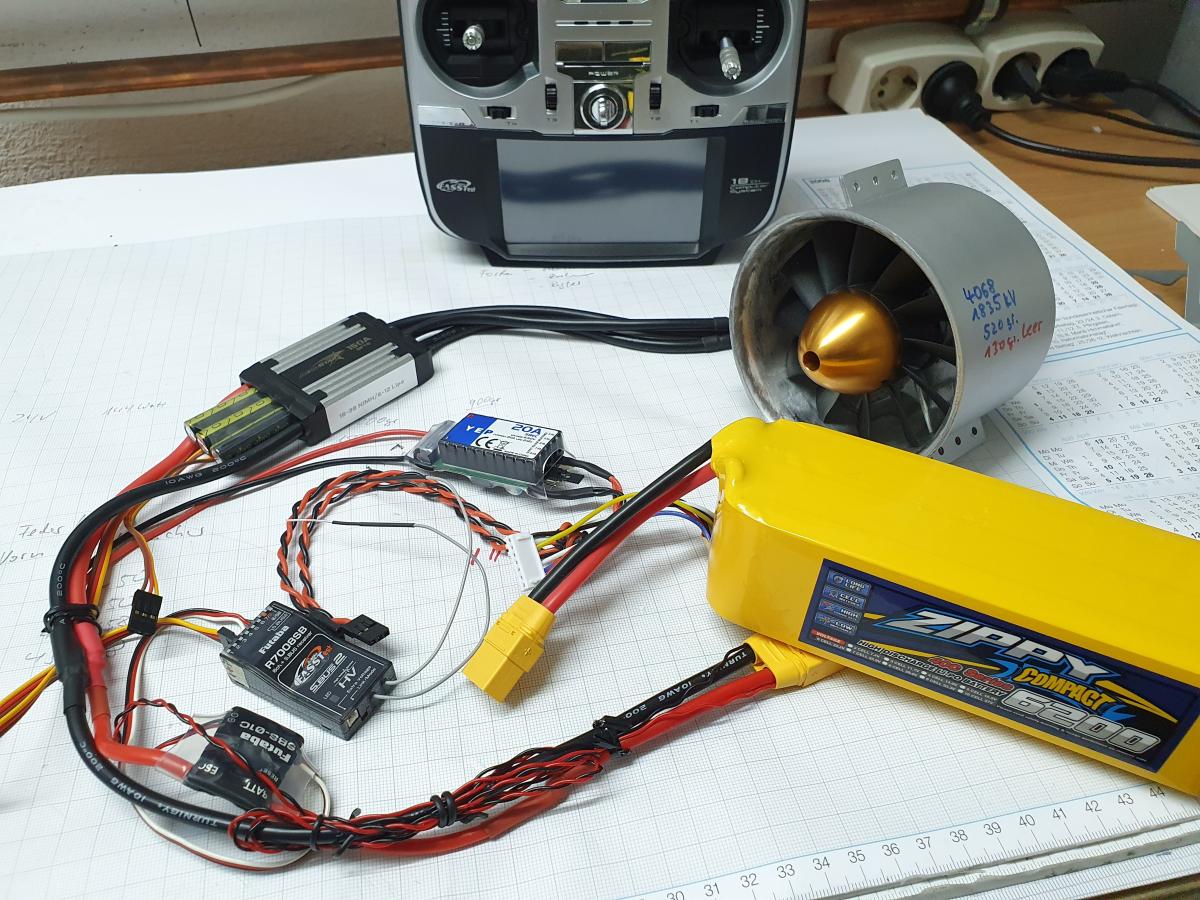

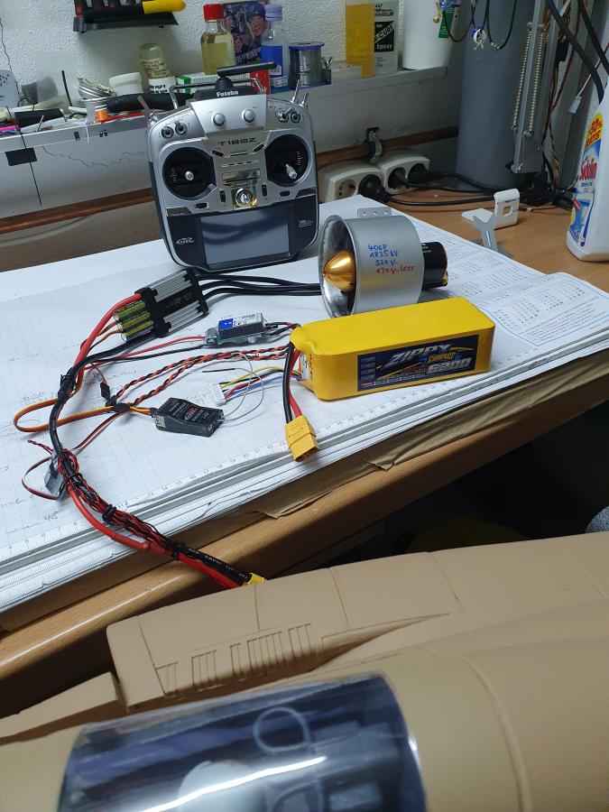

                • for my second Phantom I have chosen the recommended FW 12blade inrunner w/1835KV driven by thick 4068 inrunner
                  will add some weight on all components but hopefully resulting power will satisfy
                  driven by 150A w/ext. BEC and Futaba current sensor Click image for larger version

                  • That's same fan as I have in my F4. I run it on a 150Yep esc on low timing...........bags of power ........especially when using the 5400 Turnigy Bolt 4.35 cell lipo. 6000 HRB 50C is also a great battery for this unit.
                    • Flamingo and locharrow, same fan I'm now using in both my F-4's, as well as the F-16 and F-18. THE ONLY 90 mm fan for me as I've finally upgraded all my 90mm's to the 12 blade inrunner. The F-4, IMO, is a beast with that fan, 4 minutes of exhilarating flying on an HRB 6000 and the sound is sooooooo sweet. It was completely transformed from using the original 9 blade, "whining like a school girl", 1750 Kv outrunner, so in my case it was a huge upgrade. Without any experience with the 9 blade inrunner, can't say what the difference is, but now it gets off our grass runway like it's being chased by a cheetah!

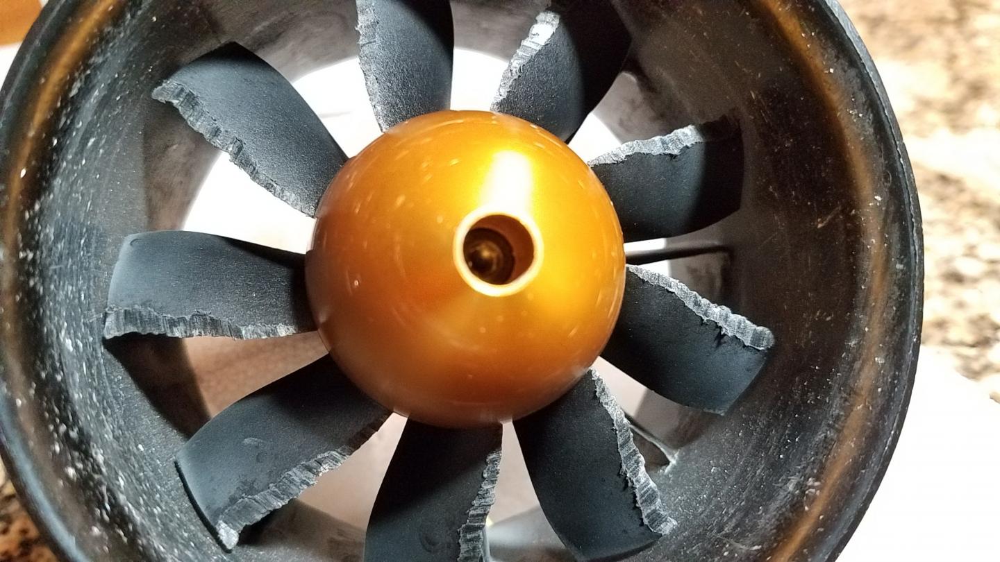

                              • Finally got around to installing the last of my upgraded 12 blade inrunners. Now all my 90mm's have this beast. Already got a bunch of flights on my 1st 4-F and really love it, especially compared to the original 9 blade 1750 Kv outrunner. The final bird was my F-4 Blue Angel and the fan I pulled out had the blades that didn't exactly look like new. This happened on it's last flight as I had to set it down in a agricultural field (that's a long story I'm not going to bore anyone with) and it must have sucked up enough dirt and rocks to choke a horse. Good thing I waited to install the new fan instead of taking it out again, doubt it would have gotten off the grass, and if it did, who knows how it would have (or have not) flown.
                                Anyone need a slightly used 90mm 9 blade 1750 Kv outrunner? I'll even include free shipping! Nothing a new fan blade couldn't fix.
