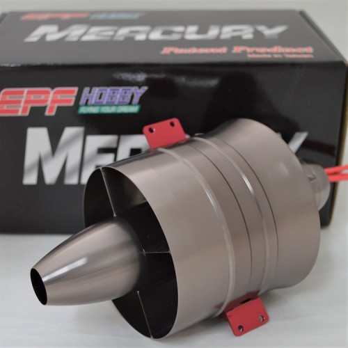

          Anyone using this motor? .......thinking of using it in my Sunday best F4 :f4:..........will have to be better than the wonderful Freewing 1835kv though !!

                    Looks lightning fast and quite nefarious just sittin there. What is it and what are the specs?

                      EPF Hobby Mercury II 12 Blades 90mm EDF Ducted Fan + 1900Kv Motor 6s Narrow
                      Length (mm): 185.5 mm
                      Weight (gr): 412 gr
                      EDF thrust (categorization) 4-5kg
                      Direction of Rotation (EDF Rotor) Classic Counter Clock Wize (CCW)
                      EDF Diameter Class (mm): 90
                      Blades: 12
                      Turbine shroud Metal
                      EDF Rotor Metal
                      Turns/min/Volt (Kv): 1900 kv
                      Motor Type: Out-Runner
                      Battery Cells: 6s - 22.2v
                      Looks verrrrrrrry interesting :f4:

                          I suspect it may require a bit of foam surgery to get the aft end of the shroud to fit properly as it looks like it has a fairly significant flare on that end. It seems to be significantly lighter at 412 gr vs the FW 12 blade inrunner (also with metal housing) at 530 gr and the FW 9 blade inrunner (with composite housing) at 434 gr. That significant weight difference kind of makes me wonder though.

                            They are heavy and most require surgery to install and to figure out how to run the motor wires. But they do make good power though draw a lot of power to make that power.

                              So the 412 gr listed weight must be a misprint (or maybe just the weight of the motor itself). Didn't make sense why it would be 120 gr lighter than the FW metal housing 12 blade inrunner. I like to buy my EDF's like I buy my prime meat, based on a higher price per pound for better quality, but at +$200 for a piece weighing 25% less, it better be hand massaged Kobe beef!
