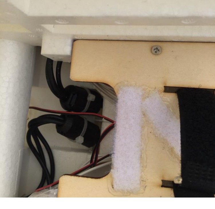

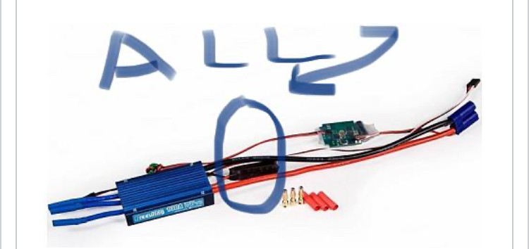

        Hi Glider Guy: I was looking on Amazon for a RF choke ferrite device. But I'm not sure what size will work for my Freewing F-4 Phantom. Can you supply any info for the correct size that will fit the ESC for that plane for me to order?
        Thanks,
        Davegee
        • GliderGuy
          • 1416
          #4824
          Thanks,
          Davegee
          Purchase the variety pack. Then use the ones that will fit. Search Amazon for "clip on ferrite choke". You will see variety packs of from 20 pcs up to 50 pcs. Pick at least a 20 variety. You'll be glad you did.
          You can run more than one wire through a given choke. Here's an example of the ones I used on the AL37 ESCs...
          You will note this photo shows the "motor" side of the ESCs, but I also put chokes on the other side...hidden by the wood tray.
          Place them as close to the ESC as possible on the one side...The "ALL" means run all of these wires through a choke. The important side is the side going forward. I'm not sure there is much benefit from putting the chokes on the motor side of the ESC, but..it can't hurt.
          Note: I do not use them on the motor side of my MiG-29 or F-4. From what I've read, the RF noise on the 3-phase side <motor side> of the ESC is minimal.
          For the AL37, I put them on both sides of the ESCs because it was easy to do. For the F-4, I put them just on the one side (forward going side) as that is the more critical side in regard to RF noise.
          If you have a LONG servo lead, like in the MiG 29 and the AL37 elevator servos, I put a choke back by the elevator servo, for good measure. I don't have one on the F-4 elevator servo. But, if you want to...by all means. I also added a small one by the green ferrite ring up by the receiver on the throttle line on all my high-current ESC birds. Overkill...possibly. But several thousand flights on my high-current ESC birds without a radio glitch is proof enough for me that they just might be a good thing. Especially after 2 A-10 crashes and an F-4 crash BEFORE I began to use them.
          Aside: When I purchased my SR-10 servo reverser from Futaba for my MiG (when I upgraded the servos)..it came with a clip-on RF choke already installed on the wire that connects to the receiver. Hmmm.....
          -GG
          More Details
          A HAM radio guru explained it to me this way...The high-current ESCs generate common mode RF noise. The wires coming from the ESC are like radio antennae and transmit the noise into the nearby environment. This noise may, ON RARE OCCASIONS, be enough to upset the TX to RX binding, which is in effect a pointer table hand shake synchronization. So, place the chokes close to the ESC to minimize the length of the wire acting like a noise radiating antennae.
          Once the pointer hand-shake is upset, radio control function is lost...until the TX and RX get synched up again. This can take several seconds, and...depending upon the radio design...might even require cycling the power on/off.
          I fly so much that if it "CAN' happen...it "WILL HAPPEN", even if only rare in the probability of happening. He convinced me, and I haven't had a "glitch-caused" crash since I began using them.
          The F-4 crash I had a few weekends ago (prior posts) was due to a servo going bad...since repaired and happily flying again.
