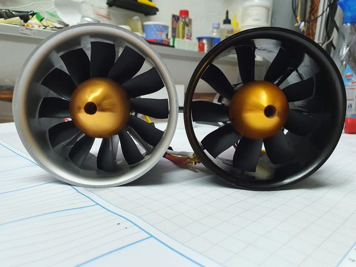

    Originally posted by Flamingo
ID:	311897Click image for larger version
ID:	311898 old stock outrunner vs. 12b inrunner upgrade from motion rc
    Now your cooking the right strudel my man! Got one of my F-4's out yesterday and just more and more impressed with the 12 blade. I now have 4 of them and just ordered a 2nd Hornet and a 12 blade for that as well. Their expensive, but IMO, worth the price of admission!
    With the old stock outrunner, if our grass was wet, it was always a 50-50 proposition if it would get off. Now, nothing stops it!

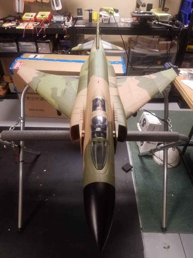

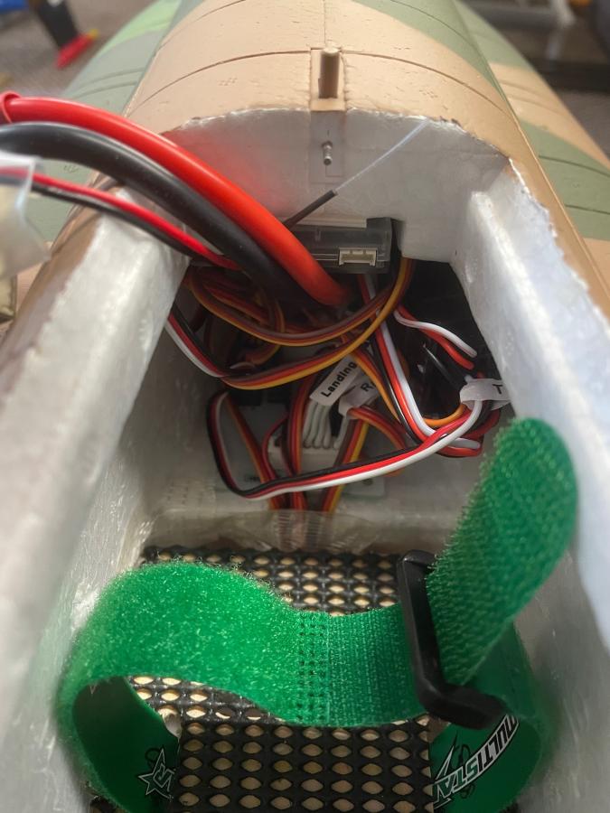

            Click image for larger version  Name:	E5AC7D84-C4B0-4725-99B6-A19A382552A5.jpeg Views:	0 Size:	75.6 KB ID:	311991
            My first F-4 is nearly flight ready. Wow this is a fantastic looking model. I’ve been so impressed by it I’ve already ordered an 8s version... haha
            This one is equipped with a JF-90 V3 fan, HET-709-68-2100 motor and an Aura 8. I have a set of vinyl graphics from Callie I will apply.

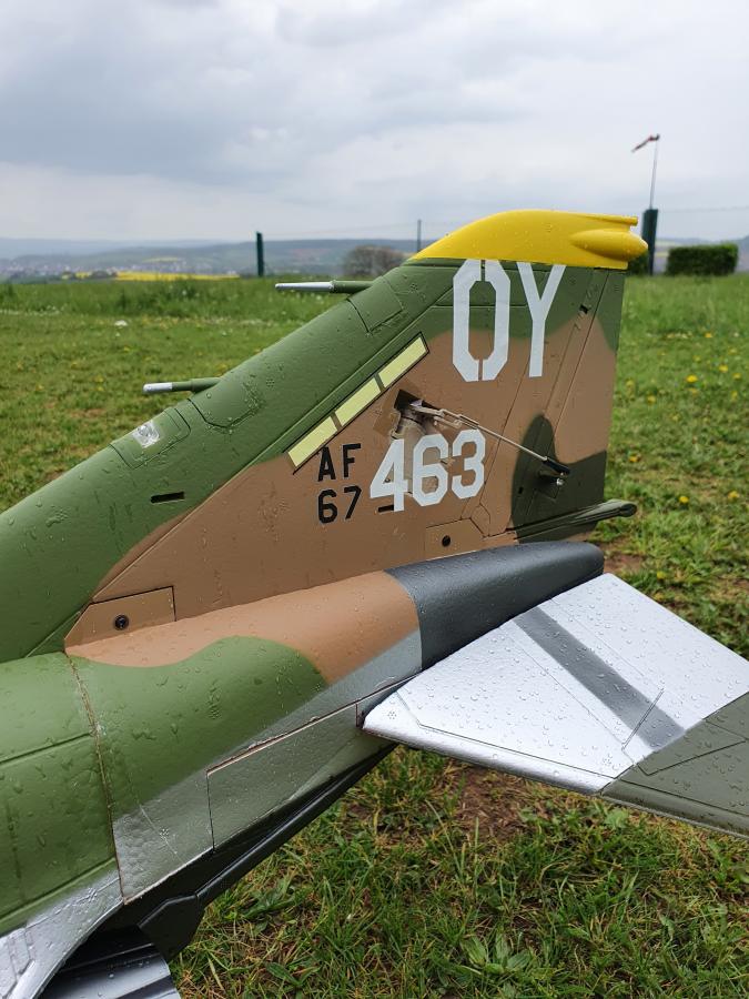

                  I just realized I have to paint the tail blue instead of some decal... Same for nose black? I have never had any luck painting foam as the paint comes off with the masking tape. I guess for the tail I can take it off and paint the whole thing, and re-wire the rudder lead... What do you guys do to paint the nose? I guess I could just paint the cone and forget the canopy part... Thoughts?
                    • 5415
                    #4929
                    I'm sure there are better ways but since I have blue painters tape I use that. I cut small 1/4" wide (or thinner) strips to mask off the areas. If worried about paint I'll stick it to my shirt to remove some stickiness but usually don't. Once I get the outline I tape newspaper to that 1/4" wide strip.
                      Give the surface a couple of coats of satin varnish before you try to mask it. Use low tack tape used for masking graphics on motorbike tanks. That way the paint stays put !

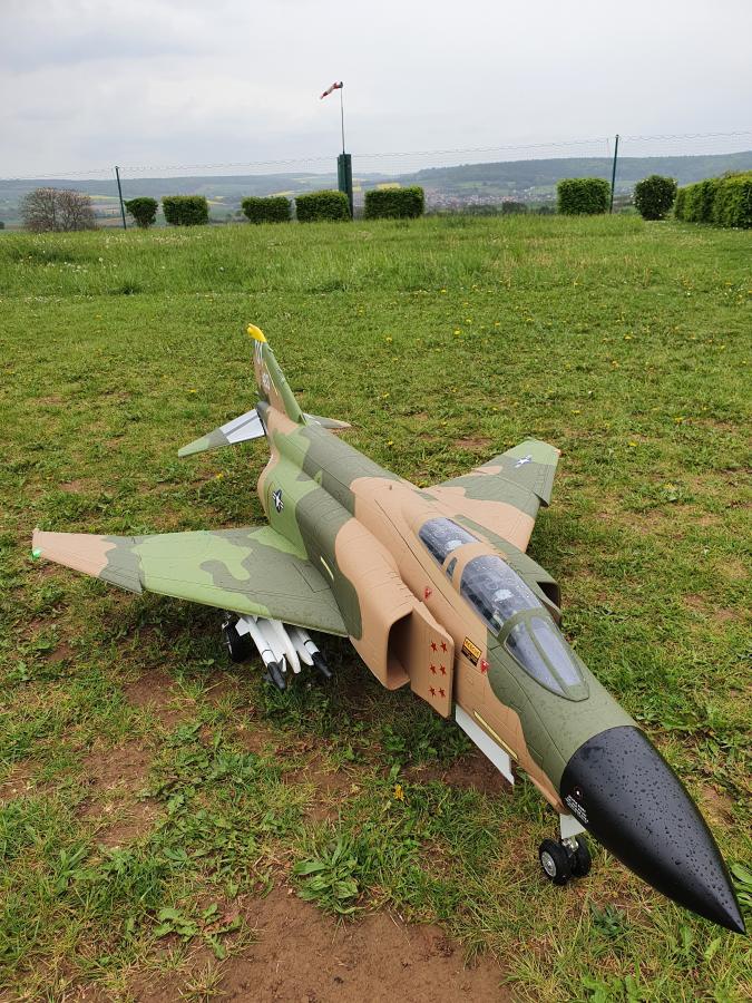

                        #4931

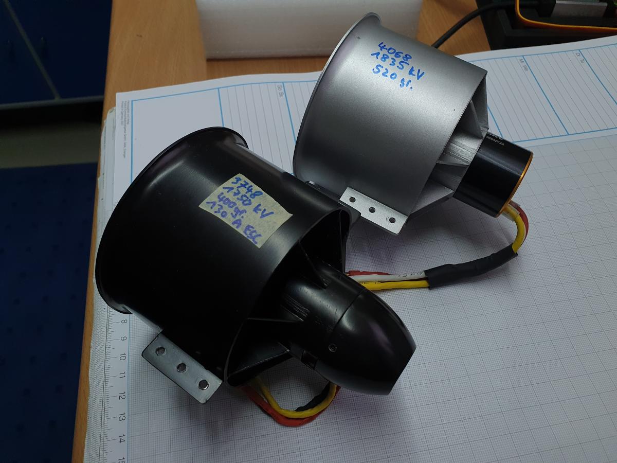

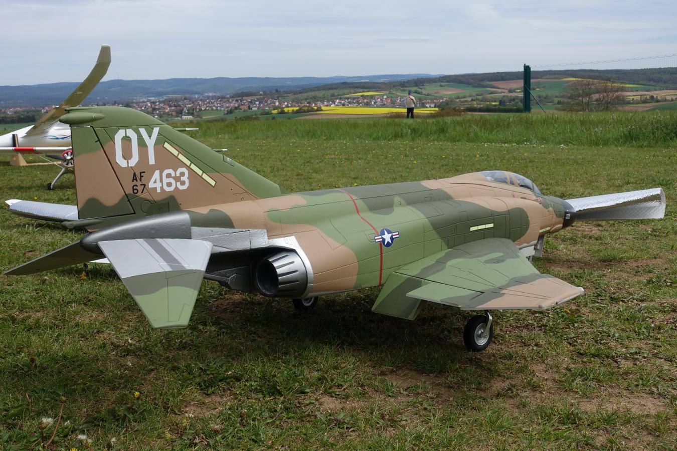

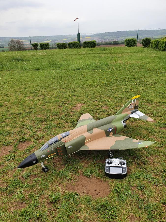

                        have maidened my 2nd Phantom
                        upgraded with FW 12blade 4068 1835KV on 6s
                        worked great on wet long grass Click image for larger version
ID:	312416Click image for larger version
ID:	312417Click image for larger version

                          Awesome, congrats!
                            worked great on wet long grass Click image for larger version  Name:	20210512_152556.jpg Views:	20 Size:	95.8 KB ID:	312416Click image for larger version  Name:	20210512_152503.jpg Views:	16 Size:	166.4 KB ID:	312417Click image for larger version  Name:	20210512_152826.jpg Views:	16 Size:	157.9 KB ID:	312418
                            Excellent, welcome to the 12 blade F-4 inrunner Club! They certainly have incredible power. On weekends when I'm not flying, I hook my two F-4's up to a plow a trench my garden. :lying_face:

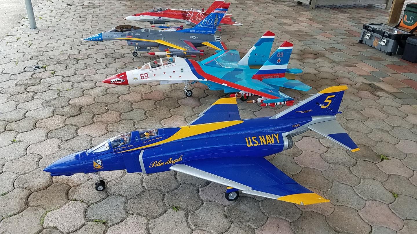

                              Got out with my F-4 Blue Angel. First time since upgrading to the 12 blade inrunner. I've been flying my F-4 camo quite a bit with that same fan, so needed to make sure the BA would perform the same. It does, love that fan! Also got a bunch of flights in with the F-16 and F-18 Canadian, both with the same 12 blade inrunner, and my SU-30 with it's upgraded FMS fans. Finally got all my EDF's performing nicely!
ID:	312622Click image for larger version
ID:	312623Click image for larger version

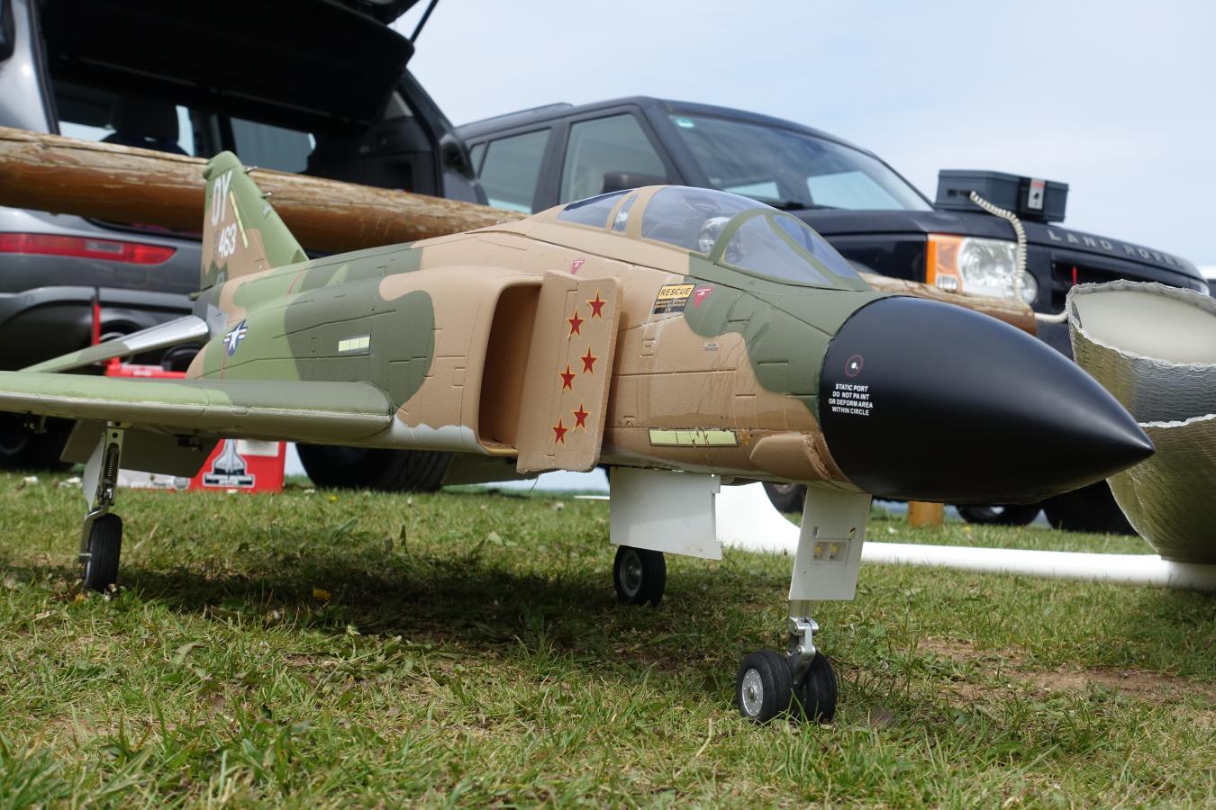

                                      #4938
                                      Hugh Wiedman that's actually awesome and great information, thank you so much! I will be getting the 8S version again in ghost grey as I want to customise her (clearly the F-18 experience wasn't painful enough 😱🤣).

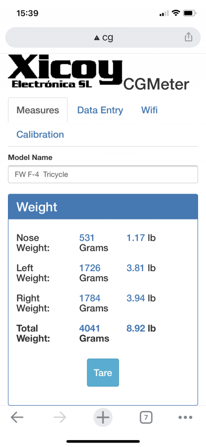

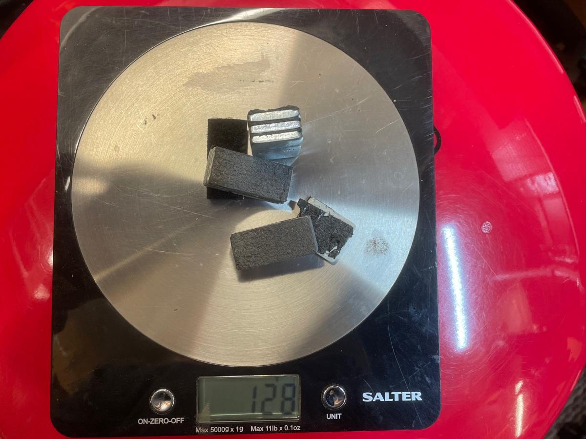

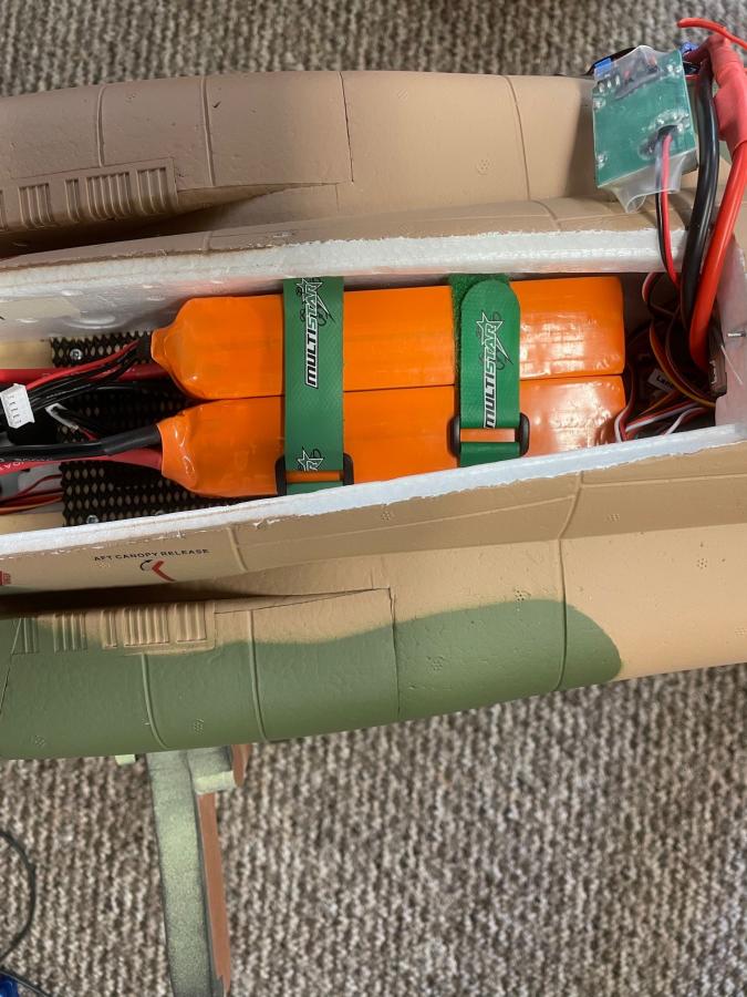

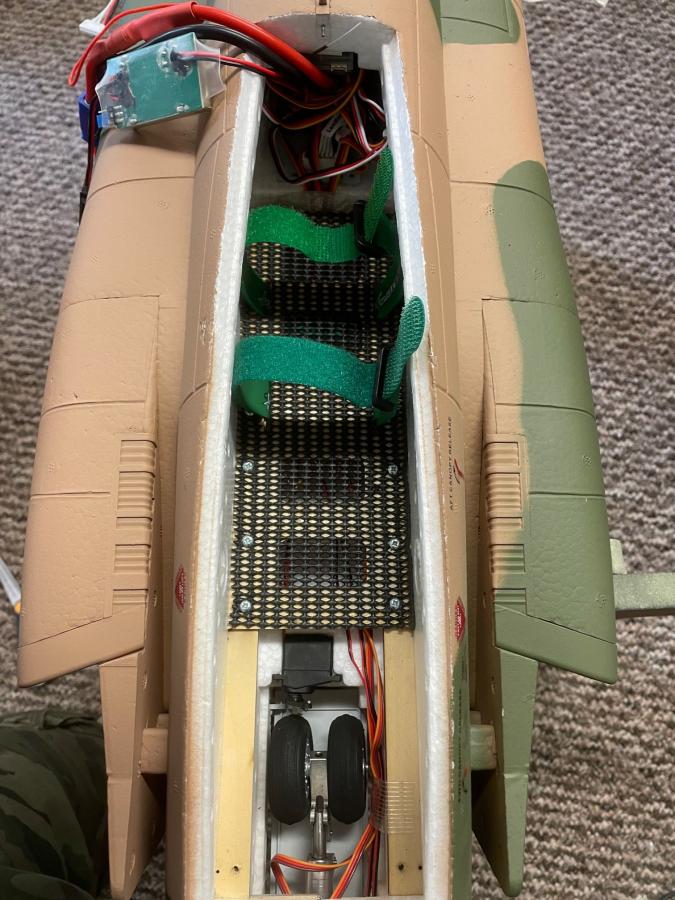

                                      So a few updates, over the lunch hour today (possibly it might have extended to two... but who's counting) with some advice from mister Evan D I moved the battery tray back. I have broken 2 nose wheel pins on perfectly good landings and suspected it was nose heavy. When I measured the CG it was at 172mm which was as far back as I could get the batteries. So I carved out the foam box that the control board stood on, pushed the control board back into the fuselage and it's now at 195mm. The alternative was adding 128 grams of weight to the tail (which I never want to do):
                                      Click image for larger version  Name:	IMG_8476.jpg Views:	0 Size:	74.4 KB ID:	313056
                                      Click image for larger version  Name:	IMG_8475.jpg Views:	0 Size:	105.7 KB ID:	313057
                                      Click image for larger version  Name:	IMG_8474.jpg Views:	0 Size:	95.4 KB ID:	313058
                                      Click image for larger version  Name:	IMG_8473.PNG Views:	0 Size:	92.0 KB ID:	313059
                                      Click image for larger version  Name:	IMG_8472.PNG Views:	0 Size:	87.7 KB ID:	313060
                                      Click image for larger version  Name:	IMG_8477.jpg Views:	0 Size:	114.2 KB ID:	313061

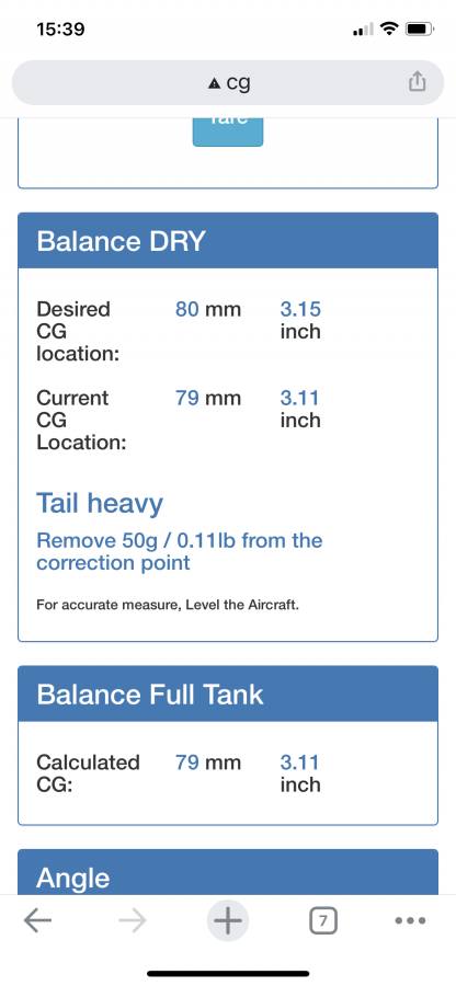

                                          [QUOTE=The43rdHammer;n313055 I have broken 2 nose wheel pins on perfectly good landings and suspected it was nose heavy. When I measured the CG it was at 172mm
                                          [/QUOTE]
                                          Andy, 172mm is definitely too nose heavy, except maybe for a snow plow. I seem to like 195 to 200 mm, allows for a nice nose up landing.
                                          If you want, you can change the front stock nose pin to the 1600 mm Spitfire main wheel axels. Requires grinding a longer flat spot for the set screws and grinding the end to a smaller circle to allow free rotation in the retract, but no big deal. The axel is a softer metal that will bend but never break. The stock pin will take a little more abuse and never bend, but instead when it goes it just breaks. I used those for maybe the first 50 flights or so on each, but went back to the stiffer stock pins the last 50 or so flights. With your further aft CG you should get more use now out of the stock pins, but the axel is always an alternative, at least it keeps from damaging the nose and gear door with a broken pin.
